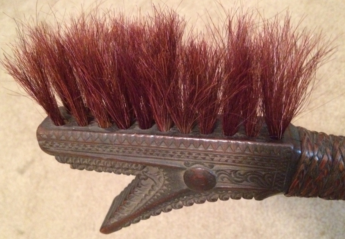

Greetings folks,
I got this kampilan off of ePrey with the blade on backwards (which put a split in the wooden guard), the bells re-attached with thin wire, and most of the hair missing.
So I replaced the missing hair with hair I dyed, reversed the blade, took the rust off the blade, and replaced the wire with thick brass rings (hammered from a brass rod) like the old ones had.
There are 2 plain bronze bells, and one with large okir swirls and one with small okir swirls.
You will also notice the great carvings and that it has an iron double guard.
According to the okir, my guess is this is Maranao and from the late 19th century.
Enjoy!

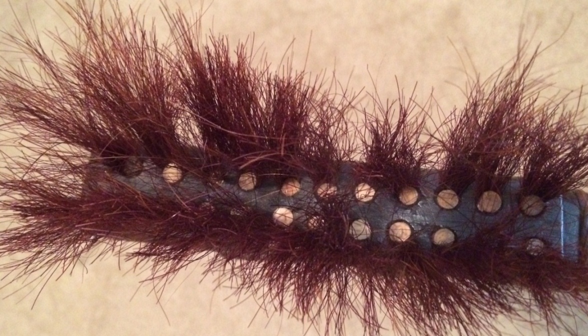

What a beautiful kampilan after the work you have done on it!
Can you show a close up from the hair attachment? The double guard, the beautiful old bells and the very nice carving at the handle make that it is an outstanding kampy! Congrats.

Thank you very much! Do you have the hair in the traditional style with wooden pins? Look's like this.

Good question Detlef:
Yes this is in traditional style. However there are several traditional styles from what I can gather. The range seems to be from this (and a little shorter) to very long. Hair also seems to be a variety of colors from black, to dark red/brown, to red, to orange, to mixed white/light brown.
As far as the pins are concerned, yes this is what I have seen over several years of both working on kampilans personally (including my own) and seeing pictures. I have observed remnants of wooden plugs with some hair left. In this case, I based my hair color and length on a couple of remnant plugs with the length intact.

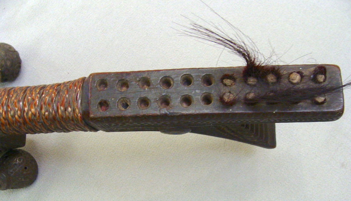

Old 6th August 2016, 01:20 AM   #16
Posts: 7,416
Oh! I almost forgot - here are a couple of before pictures:
(BTW - notice the thin recent copper wires connecting the bells. They would have easily broken off!)
