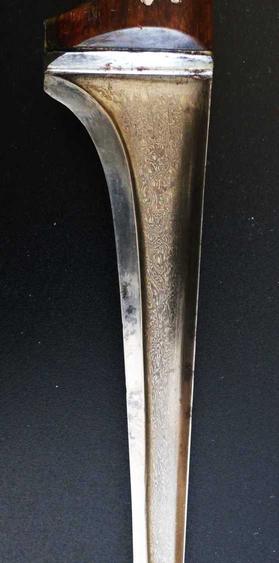

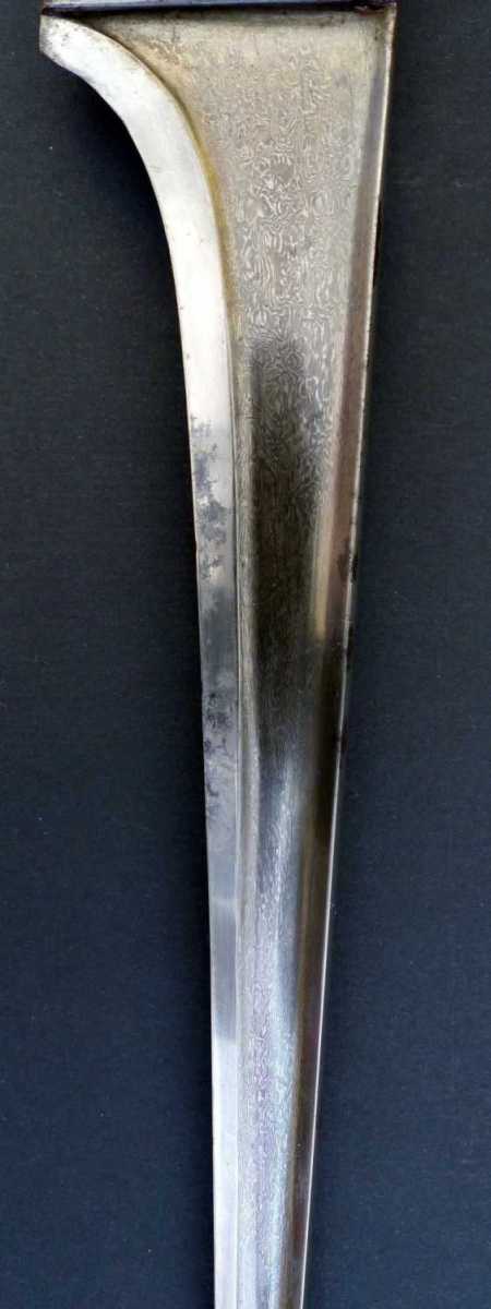

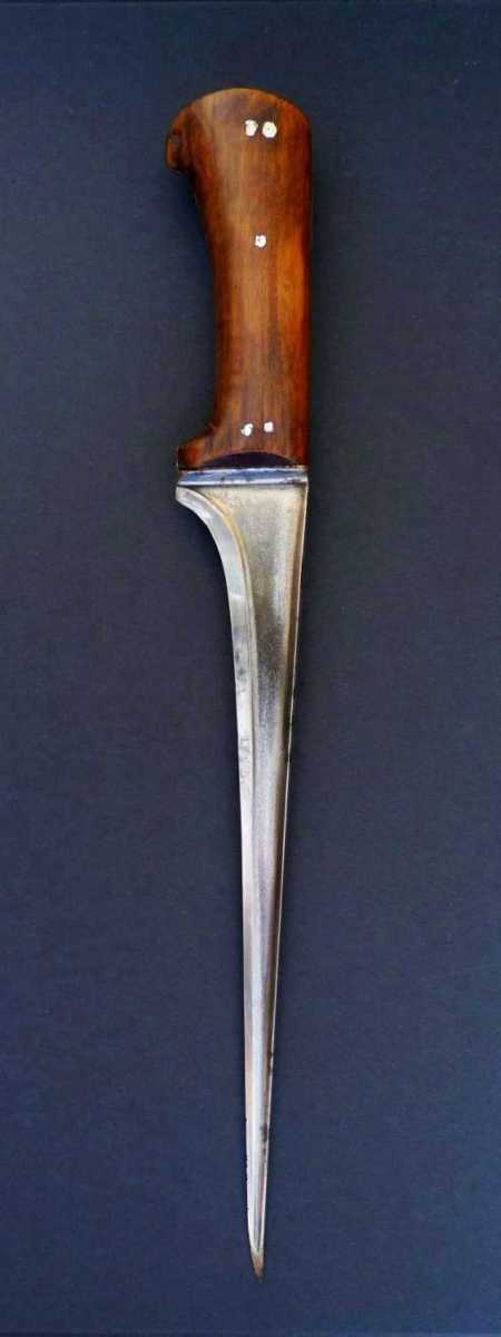

Today is very dark outside and I arrived late. And in order o take some relevant photos of the Kard I need plenty of natural light.
So I am posting some photos of a Pesh-kabz I etched.
PS: I find it is much more difficult to take good photos of the etching than to do the etching.

It is a very nice dagger, and I think you have taken some very good pictures of the wootz - thank you very much.
I will have another look at the to morrow.

Thank you for the pictures, very nice blade and etching job!
Now I remember, that you already showed the pictures to me and I would be happy, if my blades are look as good as yours.

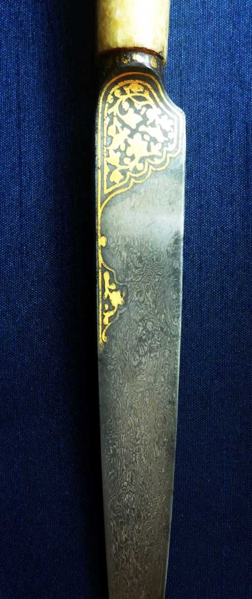

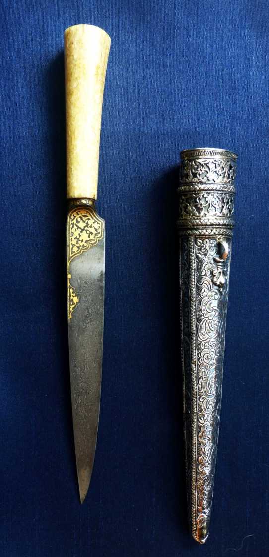

Default Kard
An the Kard I was talking about.
You notice the round lighter spot near the koftgari and slightly lighter tip. Those wouldn't get the same dark/black patina no matter what.

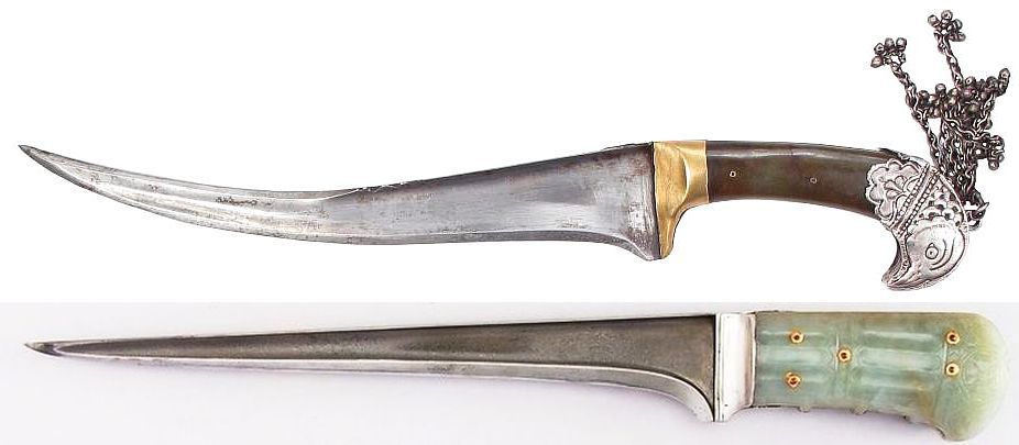

I would call this a karud, the straight bladed version of the pesh-kabz.
Nice looking one.
Nice looking one.
Hello Estcrh,
To which one you are referring? I assume the first one, right?
The term Karud does not exist in any of the languages of people that use this type of knifes and it probably appeared as a misnomer for Kard (at least that's what I know, but I may be wrong ). So I would rather not use it and stick to the term Pesh-kabz.

Hello Estcrh,
A lot of terms that we use to describe different weapons (and armors) do not exist in the language of the people that use them as far as we are able to know from the scant evidence available us. You can use any term you want but there is a stark difference between the weapon called pesh-kabz and the weapon called karud in our times.
Do you really think that these two daggers are the same? I certainly do not and many very knowledgeable people do not. These terms are used to differentiate between various types of weapons and are not necessarily tied to any other cultures use of the same term.
