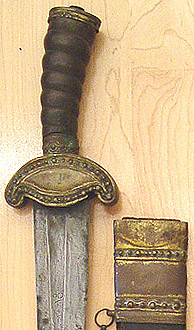

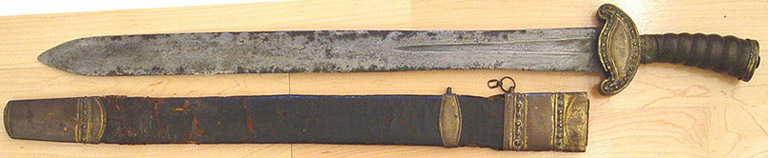

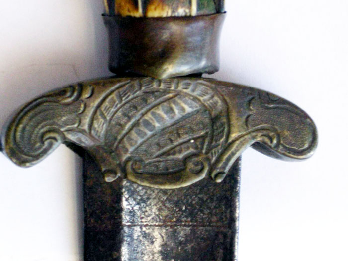

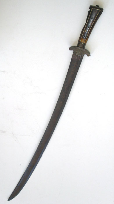

Hi!
I've been offered that puppy and I don't actually know what it is. Seems a german reinterpretation of a turkish yataghan The hilt is ivory? and the quillon section seems verry german to me or might be actually turkish simpler design of their WWI ordonance swords. The blade i verry plain and no decoration on it apparently. Is tat some sort of turkish ordonance short sword/dagger ith obvius simplified design?

Looks almost like a hunting sword

The guard has a Chinese look which I am not sure is quite right it just seems a little ill fitting. I am also suspicious about these file marks? Tim

I am really sorry, I am hitting this pretty hard. The lanyard hole in the handle does not look as if it is through a tang, central to the blade or from the blades back. I am not sure the handles are blind like this on yataghan, if that is the correct terminology. Tim

This looks like a composite sword to me? Yataghan blade with a European style hunting sword hilt.

Yeah, I'm with you Louie on composite puppy.

It might be wise not to write this sword off too quickly as an assembled piece.
I recall there was a thread a few years back regarding the Pandors, in fact there was even a photo of one forumite dressed as one? They, among others, used such hybrid weapons-- or influenced them, in any case. There was endless warfare throughout the 17th and 18th century between the Turks and most of the Eastern European powers. This is probably a captured Ottoman blade fitted up for a German or Austrian. The bladeform is consistent with an earlier dating, and this type is also often pattern welded.
Though the grip is provincial relative to others I've seen, I will venture a guess in the latter 18th century. Someone who is more knowledgeable about this form of guard can probably place it within a decade or two.

I would agree with you if it werent for the crossguard and the ferrule. The crossguard looks more chinese modern to me.

I am with Battara on this one. I suspect this has been assembled fairly recently. I too feel the guard is Chinese and recent, just have a look at the guards on some of the Chinese offerings from ebay.

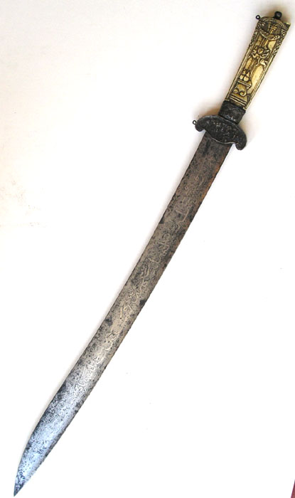

Tim, before you sip that bitter have a look at this:

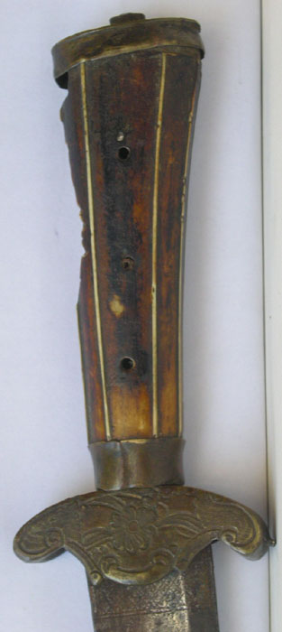

An early-mid 18th century German hunting sword fitted with a heavy double edged blade. Note the close similarity in the guard, also the one-piece grip.
There is another similar with a different form of blade ending on eBay shortly. When it does I will attach the link for further comparison.
Your observation regarding hunting and the aristocracy is a reasonable one. What it does not take into consideration is that though such swords began as hunting implements, they quickly became popular with officers and then, as is usually the case, with common soldiers as sidearms. Further, we are not seeing the sword above in its pristine state. The hilt parts are heavily worn-- note the corrosion on the ferrule. By contrast, the guard is bright. It has been cleaned over time, so that any embellishment which would originally have been found there is long gone.

That is very interesting Ham and I will agree that you have shown a similarity but just look how weak the handle of the one in discussion is, and then compere it to the one you have post. What do you make of the fresh file marks? Tim

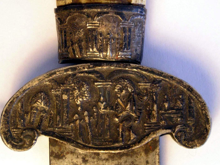

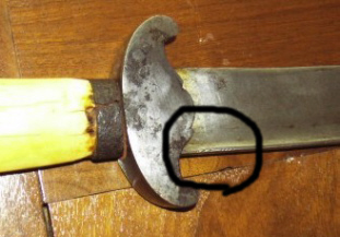

As for the scratches on the guard, I can barely make them out I'm afraid. However given the condition of the ferrule relative to the guard, I would suggest that the scratches are indicative of cleaning which was more enthusiastic than skilled. Finally, I don't seem to be able to find any Chinese swords in any of my references with guards that bear more than a vague similarity with that of the one under discussion. Can you provide an example please?

Oh boy I know I am gonna get it now, taking on both Jim and ham, But, this one smacks of a pieced together specimen. At minimum it has been heavily and poorly messed with. 1) I will start with the corrosion on the hilt lanyard rivet and ferrule are completely different than the guard and the blade. Accepted that the guard and blade have been heavily cleaned, but I would expect more pitting if it started the same. 2) the ferrule is broken, that is usually a sure sign that the hilt has been switched and did not fit correctly. 3) the ferrule does not fit the guard ie; it doesn't curve to conform to the curve of the back of the guard. is that a piece of leather in between? lastly and the weakest 4) the over all appearace is "off". Now I will brace my self for the replys . As ham has stated this is a pleasure.

Jeff, my thoughts exactly. The handle although ivory is so clumsy on this weapon especially as it is purporting to be a gentleman's accessory.

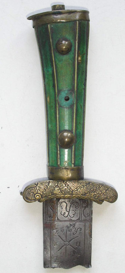

Dear All!

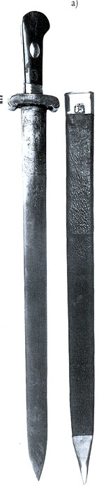

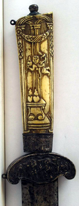

I'm happy to see discussion on this particular kind of hangers. I was always curious of this type because there are rarer and there is almost lack of any informations about them.
I haven't much time to watch discussion very carefuly, but if I understand well, we've got two problems.
First one is about genuineness of Valhjun's hanger. I'm not taking voice here about it, but I can say the hilt is quite poor. Such hilts were usually decored with engraving and repusee. But maybe such exceptions existed, though its out-of-style appearance is somehow strange.
But I will second ham's and Jim's thoughts about hangers. Such ones with "chinese" hilts existed, and were produced in Europe, probably in central Europe, and it was somehow connected to oriental fashion popular on courts. Below you'll find more examples. First and second one are from book "Hladno lovacko oruzje" by Dora Boskovic. First one was made by Clemens Weyersberg in Solingen, 1730-1740 y., second is dated on 18/19 c., so it's quite late. Other ones are examples from my museum, dated around 2nd and 3rd quarter of the 18th century. One is with yataghan blade, with etched inscription looked like pattern, other one is with badly damaged, broken blade, but you can see some magical signs in there, used mostly in Germany.

My hat is off to you, Wolviex, I guess you solved this one, pan Michalko... I wouldve probably throw it as one of the Russian potentates hunting dagger, two-three centuries ago.

Wolviex, thank you for an excelent lecture, and thank you for exelent pictures.

Thank You Michal for the excellent dissertation and pictures, and to everyone else for the information on these interesting swords. I will be honest and admit I had never seen these before this thread.
