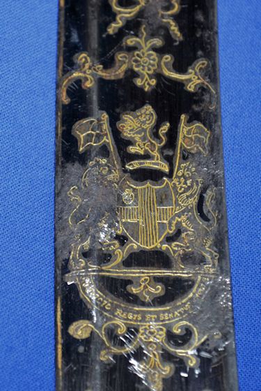

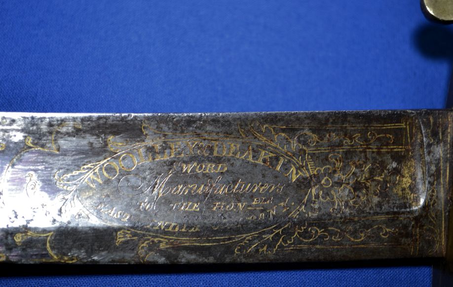

Pictures of the blade of a 1796 Light Cavalry Officer's sword. Marked on the ricasso with 'Woolley & Deakin Sword Manufacturers to the Hon. East India Company'.
The blade is marked with the crest and motto (Auspicio Regis et Senatus Anglia) of the East India Company.

Fantastic Robert!! Thank you!
What a beautiful sabre . I saw this in my 'travels' last night as I searched for examples or evidence of any sword blade with EIC markings. This one is unusual as the blade motif does incorporate the logo. There is a conundrum with this one though......Wooley & Deakin were only in business with as that partnership for the years 1801-1803. It seems there has been disputing evidence to that, but cannot recall particulars.
The main thing is that you see the rampant lion at the top of the arms. At this time, EIC was still using the quartered heart bale mark, and in about 1808 began using the lion. Even then, its transition in use was rather slowly adopted.
I would suspect with this sword's blade as evidence, that Wooley and Deakin as partners clearly must have existed as such either later than 1803.....or more likely, the lion over the arms was a regular component of those arms and adopted as the logo as noted.
With officers, these swords were private purchase, and as the link attached by Ibrahiim shows, hilts often had EIC features, and the blades were of course highly decorated as seen here, just as those to regular officers of the British Army.
What I am trying to determine is if the rank and file weapons, or even the fighting weapons of officers if EIC, were stamped with either bale mark.
These marks were of course 'property' markings, and would have been placed only on 'issued' items. However, as seen, the firearm sector of equipment with its higher value in importance were indeed marked.
Hi Robert,
Taking on board the information contained in this thread, I put forward that my understanding of the term "bale mark" is such, that it represents the identification of a merchant, or merchant company in this case the EIC.
The sword you illustrate is marked (etched)with (by definition) a coat of arms; and this representation can be split into six different elements:
1. The shield of arms
2. The supporters
3. The crest
4. The wreath or torse
5. The motto
6. The scroll
Referring to the overall achievement as a crest & motto is not correct; it is a "coat of arms", and the lion 'crest' is only part of the coat of arms however, without a coat of arms there can be no crest.
The crest is only the lion holding the crown; the representation below the lion is the wreath or torse (not simply a line as sometimes described); the crest is described in heraldic terms as:
A lion rampant guardant Or supporting between the forepaws a regal crown proper.
When the crest is displayed in colour, the wreath is coloured alternately using the main metal colour of the shield (in this case it would be silver (Argent)), and the main tincture would be Red (Gules).
The scroll is the object on which the motto is displayed.
My particular area of interest is somewhat later than some of the items under discussion, and much to do with officers swords however, as yet I can definitely say I've not seen a sword bearing a bale mark. Having said that I do have three or four blades with EIC view marks.

Extremely well put Gordon!
I am in complete accord.
