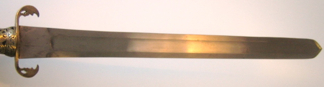

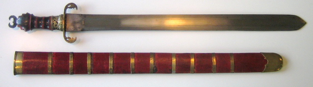

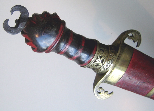

Old 20th August 2007, 12:16 PM   #13
VVV
VVV's Avatar
Posts: 1,637
I managed to find one for my collection (Thanks Stefan!).
This must be a Pedang Jenawi Besar, based on it's size (Jenawi is straight and Besar is big).
It's both huge and heavy. The blade is supposed to be inspired by Arabic swords but this one reminds me more of old European swords?
"Banjarmasin red and black" colours on the hilt.
Old 20th August 2007, 03:10 PM   #14
I would suggest that "Jenawi" is just another transliteration of the word used to define straight Moroccan swords: Jenawi, genoui etc, etc
It all means "Genoese" and referred to straight blades ( European, mostly) vs. curved "Oriental" ones.
I guess this word might have been brought to SE Asia by the Arab traders and just stayed there.
Old 20th August 2007, 03:58 PM   #15
VVV
VVV's Avatar
Posts: 1,637
Ariel,
That sounds probable as south of Borneo had a lot of visits from Arab traders and this sword was used by the Muslim Malays, not the Dayaks.
Old 20th August 2007, 10:14 PM   #16
Dajak
Dajak's Avatar
Posts: 952
Hi Michael an nice hard to get piece
And you are correct the muslim people
are settled in bandjamasin and also the Chinese influence in the sword that was never Used by the Dayaks
same as in the big coast place s from sarawak where they also settled for trading etc.
Ben
