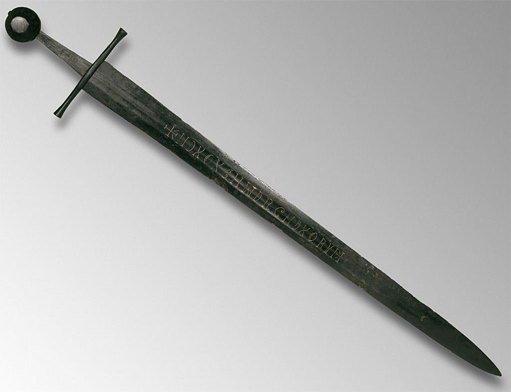

The Smithsonian magazine has an interesting article about a sword in the British museum. They are looking for help in deciphering the inscriptions the blade. The full-text article can be found here:
http://www.smithsonianmag.com/smart-...NjIwNDYzNDI3S0
A crappy URL, but hopefully it will work.
Harry

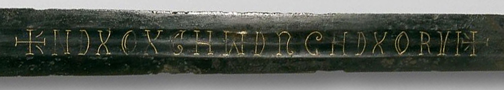

This sword is included in Oakeshott's Records of the Medieval Sword as X.15 (page 34) where there is also an image of the reverse showing a similarly prepared series of symbols. Mr. Oakeshott proposes an earlier date in that work, though I must admit some personal skepticism about that. Besides the possibility of being coherent in an unknown language, the inscription may possibly also be either an acronym (likely of a religious phrase or prayer) or entirely decorative in nature.
Old 7th August 2015, 04:34 PM   #4
Posts: 10,867
Lee, it is wonderful to have you posting on this, and of course most appropriate to have you here on this topic!!!
At first I thought this Smithsonian reference was to the Witham swords, which though newsworthy over a period of time, occasionally have been brought to the fore rather sensationalizing the 'mysterious' inscriptions. However, this seems clearly a separate case.
It seems Oakeshott included mention and drawings of some of these 'inscriptions' in his "Archaeology of Weapons", and that he was somewhat of the opinion they were acronyms probably of sacerdotal or other religious significance.
What is interesting is that these apparent acronyms or otherwise sequenced letters and interpolated either glyphs, symbols and perhaps flourished letter characters indeed defy any sort of reliable interpretation.
In the discussion of such inscription on a presently concurrent thread, under "Odd Sword", attempts are made to decipher the letters into some tangible order of translation. Again, it is difficult to determine exactly which alphabet, or combination thereof, might be employed.
I think what we need is a "Rosetta Sword" !!!
In the case of many Italian blades from Brescian regions, with makers Caino and Picinino in particular, there were alphabetic letters used in groupings, but often in repetitive fashion, and reductive in letters removed progressively in some cases. Also, often second lines were using the same letters though shuffled into anagram style groupings.
Obviously this practice defied any tangible acronym decoding, and suggests the letters may have been given numeric or other values or used in symbolic sequencing. The truth remains unknown. What is known is that the practice seems to have been employed in other centers, and in particular may have been filtered either to or from Spain.
While it is tempting to note that Germany certainly must have copied this practice in kind, as of course they spuriously used many Spanish and Italian markings and motif...it is important to recall that this mysterious practice seems present in degree in Frankish weapons earlier and somewhat on these English swords.
A remaining and possibly significant factor is that of the Kabbalah, and the use of gemetria, that is the use of alphabet characters with numeric value and various symbolism representing Kabbalistic dogma and esoterica.
It seems as I understand that the use of acronyms in Hebrew were often pronounced in some degree as words.
Though not suggesting that this particular blade, nor the inscriptions on the others mentioned might be associated to Kabbalist words or phrases, it is worthy to note as possible source of influence.
Again, thank you for adding this Lee,

I think it also peculiar that the M is probably upside down.
I think a grouping of all the excavated swords in this broad category would enhance our knowledge immensely. Unfortunately I have a hotel and 17 businesses to run not to mention a new railway to construct. Perhaps someone from our panel of experts could attempt this task...? I suggest the right location could be on the European...

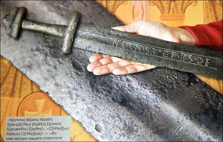

Default The VLFBERHT Sword
If I may begin to collect to Forum documents there are available in terms of these ancient swords and inscriptions starting with The Vlfberht Sword which from Wikipedia I QUOTE "Vlfberht or Ulfbehrt is a modern transcription of the inscription +VLFBERH+T, found on some Early Middle Ages Germanic swords of the 8th to 11th century. Swords so inscribed have been found in many parts of Europe, most numerously in Scandinavia. They are believed to originate from the Taunus region of Germany in what was the Frankish realm.
There are many variations of the inscription, including +VLFBERHT+ and +VLFBERH+T. The inscription is a Frankish personal name and became the basis of a trademark of sorts, used by multiple bladesmiths for several centuries.
In a 2008 paper, Anne Stalsberg, of the Museum of Natural History and Archaeology of Norway, argues that a blacksmith is unlikely to have been literate, and that the presence of crosses in the signature suggest an ecclesiastical or monastic origin. She discusses how the swords may have reached Scandinavia, suggesting smuggling, looting by Vikings, or as ransom for dignitaries captured by Vikings. Much of this work was re-presented (though uncredited to Stalsberg) in detail in the PBS Nova 2012 documentary, Secrets of the Viking Sword.
Most Vlfberht swords are of Oakeshott Type X form. They are forged from excellent steel with a very low content of sulfur and phosphorus and up to 1.1% carbon. This steel was most likely acquired through trade through the Volga trade route, which could have supplied ingots of the steel, obtained ultimately from central Asian cultures, who were producing crucible steel to emulate the famous wootz steel of India.
A 2012 documentary, Secrets of the Viking Sword, showed a blacksmith who specializes in ancient techniques successfully create both a high-quality steel ingot and an inlaid Vlfberht sword from it."UNQUOTE.
It is noted that Anne Stalsberg stated that the blacksmith was unlikely to have been literate and that the material was imported possibly from Asia...This poses two difficulties; firstly in deciding if the blacksmith had made a mistake in the inscription and secondly that trying to tie a sword down to a particular workshop through analysis of the material would be much more difficult...when the materials were being drawn from far afield...i.e. not locally. I also find it interesting that Ann Stalsberg suggests a monastic link because of the crosses because if the swords were associated with a place of learning would not the letters be correct...at least at the time of going to print; so to speak? It would appear that the puzzle we run into in Ethnographic Weaopons these days associated with the "whats in a word" syndrome was as common then as it is now...

Thoughts about the inscription from others
Some think it may say, in ancient Welsh, "No Cover shall be over me." as though it was never meant to be scabarded, always out and ready to fight.
From the discussion at various links.
Interesting
Not unlike what we see of later terms such as
"No me saques sin razon; no me enbaines sin honor"
"Draw me not without reason; sheath me not without honor"
It is also not unlike some biblical scripture, which is what many are considering. Gloat not over me my enemy, etc
Cheers

GC
Salaams Hotspur ...Yes it could be old Welsh but...as the report goes on to say...there is more to this than meets the eye.
Please see http://www.gizmodo.co.uk/2015/08/can...ear-old-sword/
For example the W from one persons perspective wrote..
Quote ''Any symbology that might appear on that side is very important. From an alphabet perspective, I was immediately struck by the inclusion of the letter W as it wasn’t in general use in that form until some point during the 14th century when it began shifting from begin written as the the digraph to being written as the ligature more frequently as the 15th and 16th centuries approached. I don’t think I would have stopped if it weren’t in the form it is in. In the early versions of the W ligature it is most commonly written as two V’s whose legs cross over each other. Time and scribal laziness eventually eliminate the crossed sections for ease of writing. This particular W letter form has an apex that is half the height of the arms of the W letter suggesting that the engraving was added nearer the 15 or 16th century. It is important to note that the W letter form is used natively in: German, Dutch, English, Welsh, Polish, Walloon and Maltese.
Most romance languages including the Latin of the day did not use the W.
One particularly interesting note, from Marc van Hasselt of Utrecht University’s Hastatus Heritage Consultancy, explained how similar swords have been found all over Europe, bearing similarly inscrutable phrases. According to Hasselt, it seems the “most likely” that the inscriptions are in Latin, though:
Using the excellent research by Thomas Wagner and John Worley, an image of a hugely successful medieval workshop was created, making ‘magical’ swords for the elite. The swords themselves are of a high quality, but what most catches the eye are the inscriptions. Both their mysterious contents and the similarities in the lettering are striking. A sword from Sweden might use the same slightly curved X as the River Witham sword. A sword currently in Berlin has an I-S contraction also used on a sword found in the Netherlands. These similarities go so far as to suggest the same hand in making the inscriptions.
However, their contents are still a mystery, regardless of their origins".Unquote.
Ibrahiim al Balooshi.

Hello Ibrahiim
I think I post on the train of thought that a simple phrase the most likely translation we will find.
I agree with Lee on his impression that the sword is not unlikely to be of a later century. While Oakeshott lists this sword as a type X, it is truly as easily placed in a type XVI category, or even a tweener of a XIV, or XVII for that matter. I believe it is in Oakeshott's later book (Age of Chivalry) he starts to question his own earlier categorizing and dating. I'll be honest, I own only his first title and Records, on which all now seem to attribute "truth" to this particular sword. I look at this sword and see it easily 14th if not even 15th century work.
My own focus of swords is a mere few decades of early modern swords, and further narrowed to eagle pommel swords of the US market. As many times as types and origins of those have been pigeonholed, not just trends but reuse of favored styles often need reassessment.
As to prettier and emblazoned swords belonging to the rich and famous, of course. A peasant grade sword in England during the XIVth century could be had for a few weeks wages if a freeman. Also by that time, barrels of blades imported, manifested and registered and taxed in the port of London. So many arms and armour imported into England that there was concern and laws made restricting trade by the XVth century. In that regard, I see no great mystery that a sword found in an English river (inscribed or not) mirrors swords found on the continent.
Cheers
GC

Yes I agree it could be of a later century as detailed in my previous post in particular regarding the W detail...in paragraph 1 and 2 and I also line up with the possibility of it being linked to swords found on the continent in paragraph 3... noted in my previous post taken mainly from the website http://www.gizmodo.co.uk/2015/08/can...ear-old-sword/

Salaams all... Another sword comes to hand...or view at http://siberiantimes.com/science/cas...-the-terrible/
Members are urged to consider this one please.

The Sword of Ivan the Terrible or....?
Salaams all...On rereading Heraldic Symbols I am reminded of the shorthand nature of that entire structure but I am also inclined to use the same analogy on blade inscriptions... Mediaeval Shorthand. What I find amazing(and there are many amazing twists with these blades ) is that there appears to be a network; perhaps a monastic linkage across vast regions where it seems sword-makers possibly attached or part of the clergy moved with freedom practicing their art-form ..was this a way of funding a particular religious body?...was this done to fund religious visits/pilgrimages?...or was the work done in different countries and regions by sometimes the same craftsman purely a co incidental affair?...I doubt the latter.
Since I harp on about shorthand here is what the report at reference says about the script...
Quote"The main inscription reads: N[omine] M[atris] N[ostri] S[alva]t[ORis] Et[eRni] D[omini] S[alvatoRis] E[teRni], with an additional one on the same side of the blade saying C[hRis]t[us] Ih[esus] C[hRis]t[us]. This means:'In the name of the mother of our saviour eternal, eternal Lord and Saviour. Christ Jesus Christ.'
The inscription on the reverse side is harder to read, but the first word 'NOMENE' - clearly seen - helps reconstruct the rest as 'N[omine] O[mnipotentis]. M[ateR]. E[teRni] N[omin]e', which means 'In the name of the Almighty. The Mother of God. In the name of Eternal"
.Unquote.
Applying that key to the project sword here at #3 gives a similar string that will decode to illustrate a religious incantation or saying which you can all have a go at...
