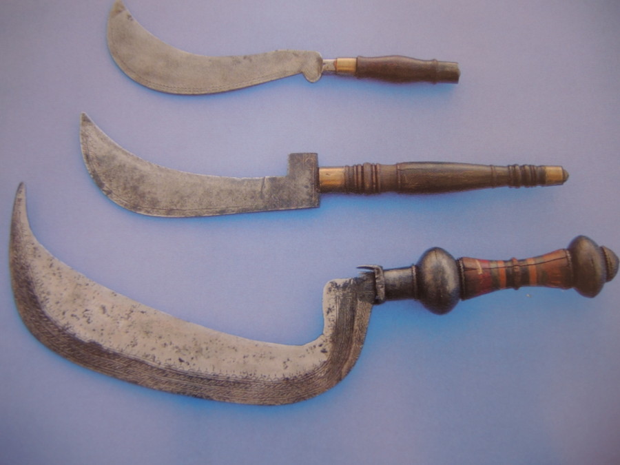

Old 31st March 2015, 04:29 AM   #6
Posts: 2,832
OK here is the pic. Hope no copyright infringement but if so then Mods please remove.
Old 31st March 2015, 01:16 PM   #7
drac2k
Posts: 1,332
Wow, you nailed it, especially the third one, with the painted handle.I wonder if the colors have any significance, since they seem to be similar.Red, black and yellow;only the sequence is different
Thanks Again !
Old 31st March 2015, 04:23 PM   #8
Posts: 4,736
I agree that this is most likely southern Indian in origin, and the Malabar Coast area is a possibility. The Tirri picture shows three examples, and while I am familiar with the top one as definitely being a Moplah chopper from the Malabar coast (I have a very similar example that I purchased privately in Bangalore), the other two look more like sacrificial instruments rather than weapons to me and their origins are more widely distributed than the Malabar Coast. I would be cautious about attributing the original item of this thread to the Malabar Coast based solely on Tirri's description.
I also agree with Charles that a Ceylonese origin is possible.
Ian.
