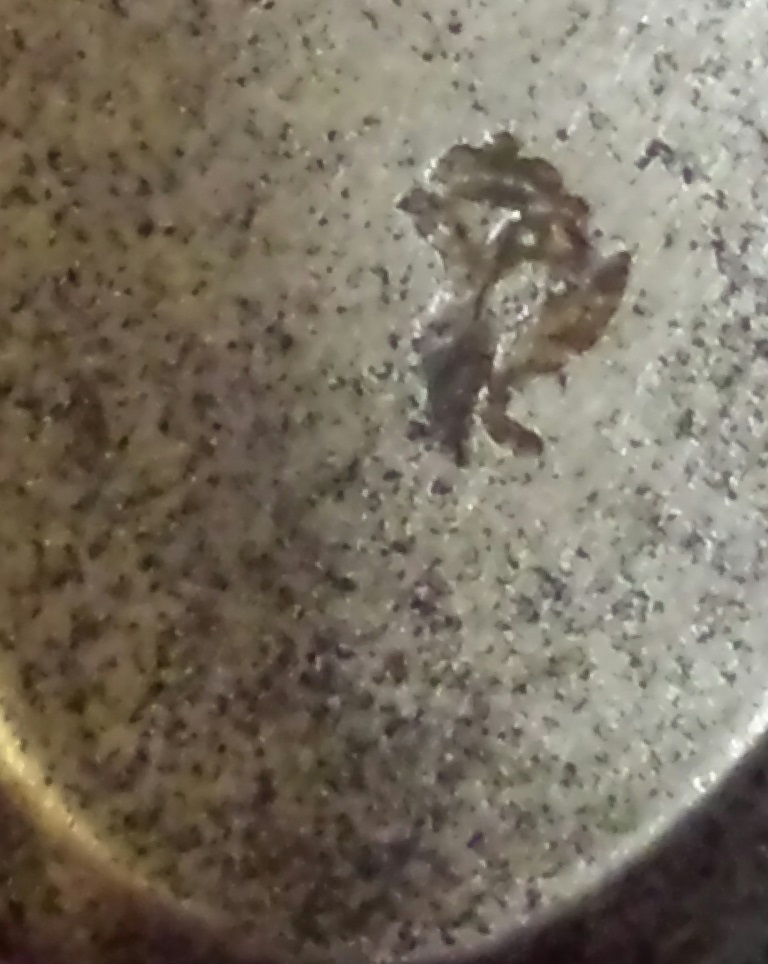

I found an eagle mark on the lock so I believe it could be a pistol for the American market.

No, this eagle mark is the proofmark of Vienna!

So we have that Lean-Luc's (Cerjak) pistol bears the Liege proof mark on the barrel and the Austrian eagle and date of manufacture on the lock.
What does this bring us to ? If it was sent to Liege for reconversion, is it plausible that Austrian flint locks were sent together with the pistols ?
Or is it that Liege workshops were instructed to mark the new Liege made locks with the the Austrian eagle?

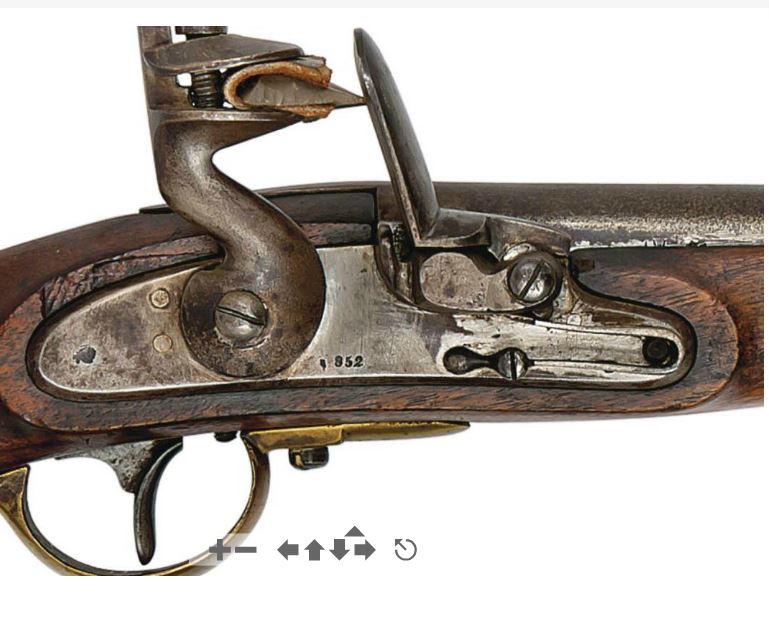

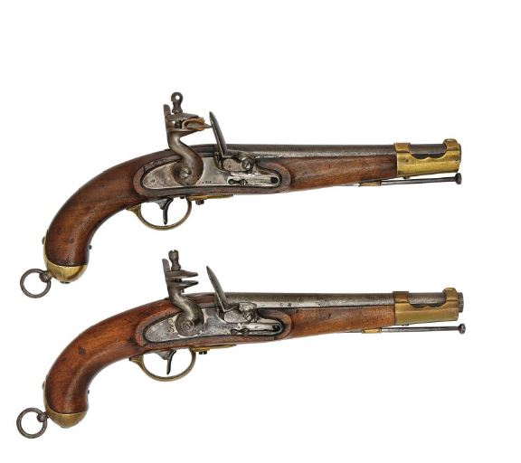

I found same pistols sold by christies
see below description and pics
A BRACE OF AUSTRIAN 16.9mm FLINTLOCK SERVICE PISTOLS
EACH MARKED '852' FOR 1852
Each with tapering barrel, iron tang, flat bevelled lock with date mark, iron pan and double-headed eagle stamp on the tail, beech full stock, iron trigger-plate, brass mounts including fore-end barrel-band also incorporating the fore-sight and pommel fitted with an iron lanyard-loop, and iron ramrod (iron parts discoloured with some light corrosion marking), numerous inspection marks and Liege proof
9 7/8in. (25.1cm.) barrels (2)

It is very, very simple: All Augustin pistols had this Vienna proofmark. After 1866 these pistols with this proofmark have been sold as percussion pistols with the Augustin system to Liège gunmakers and dealers. After the reconversion to flintlocks they had to be proofed according the Belgian laws. So they got the "ELG" mark on the barrel. Quite simple, isn't it!
corrado26
Old 16th February 2015, 04:13 PM   #12
This meaning that the (Austrian) plate of the lock remained the same; only the firing mechanisms having being replaced.

All this flintlock pistols are no original Austrian ones, they have been created in the arms facotries of Liège out of former Austrian percussion pistols M 1851 System Augustin. Their lockplates rermained always the same, only a pan and a flintlock cock had to be added, that's all.
Unfortunately lots of these "fake" pistols are sold by auctioneers and dealers as originals................. although it was very easy to check it: The years of making the pistols in Austria is stamped on the lockplate as a three Digit number as "851" or "852" for 1851 or 1852, and a serious collector of flintlock or percussion pistols should know that in 1851 the time of the flintlock in Europe was over since at least 10 years!!
