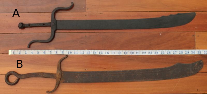

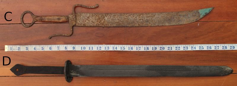

Some examples (see pics):
A: Tang has rivet holes. Tang is narrow and fairly square. Looks like the (two piece) grip would have enclosed the tang, and been wrapped with cord.
B: No rivet holes in tang. Two piece grip would enclose tang, wrapped.
C: Grip slabs rivetted to tang (this is the single-slab sword noted above, but it would look the same from this side with two slabs). Maybe this grip would be wrapped too, but it's optional.
D: No rivet holes for grip, tang is wide. Two grip slabs, wrapped?

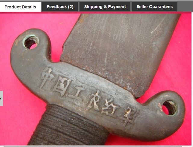

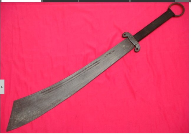

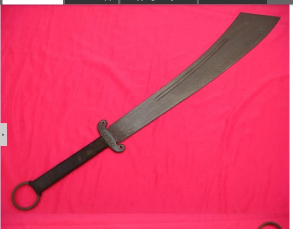

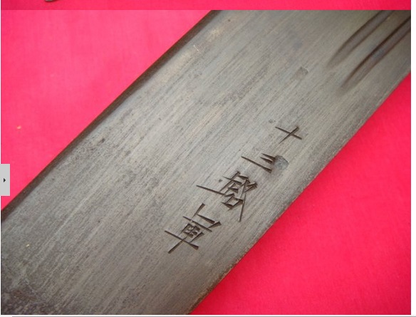

It just occurred to me to mention, the Dadao I have coming, and in the pic. is a 1937 dated Chinese Army piece, which is why the guard is somewhat "Industrial" in form. I am hoping it is the real deal, so I shall see what it is like when it arrives. See photo below for type of Dadao.

Yours looks like the usual ebay fakes. Compare the guard with the ones in the picture of the Chinese troops (or, http://mandarinmansion.com/republican-dadao ). I've seen these both in cast brass and forged iron. While these "curled tip" guards aren't the only ones used (plenty of disc guards, some S-guards, some other guards), I've never seen one like the one on your incoming dadao on a known-to-be-genuine old dadao, but have seen plenty on known fakes.
(When you get it, can you post (or PM to me) some details of the blade thickness and cross-section. Basically, how much does the blade taper in thickness, and how close to a triangular wedge is the cross-section.)

I have my reservations as well, but at a price of a quarter that asked for a repro. I thought it worth a punt. I will post pics and details when I get it. More pics from the seller.
