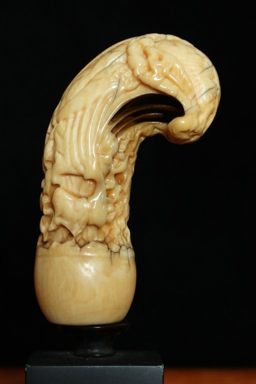

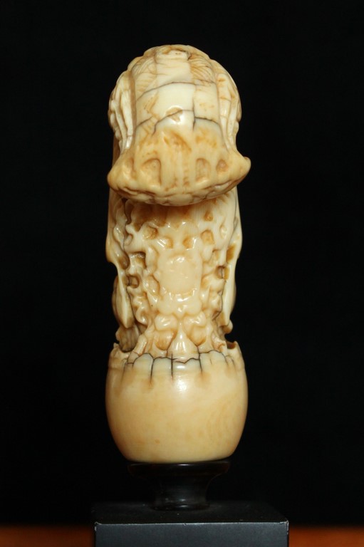

Few months ago I bought a very old & worn marine ivory hilt with sound materials but very filthy and I could not clean it with alcohol so I did it with a tooth brush impregnated with Cif cream (used to clean sinks, etc), it worked very well and without damage to the ivory after rinsing it immediately and applying oïl (see result).
