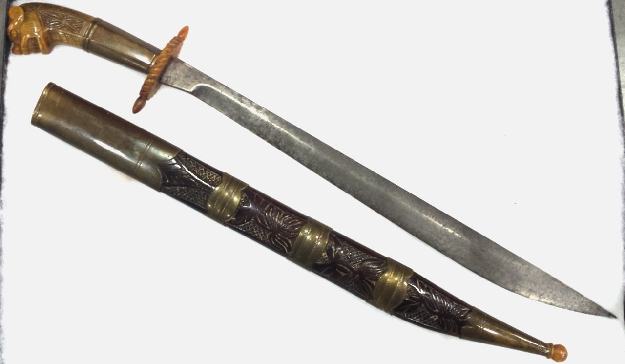

Here's one for the Philippines aficionados in the group. This is not really my area (when i buy filipino weapons they are usually Moro and insurrection era), but when i saw it at the antique mall today it just sorta called me. My guess is that it is end of WWII based on the use of aluminum on the ferrule and eagle crest and the fact that the banner says "Victory".
The blade is fierce and razor sharp. The length is about 19 3/4 in. and the thickness is about 1/4 in. at the base. It is flat on one side and sort of convex on the other, not unlike a mandau. Feels very good and well balanced in hand with a nice weight.
The guard and bands seem to be brass. The guard is quite solid, firm yet springy.
The hilt appears to be horn with some paint on it (note the red around the mouth).
Sorry about the photos. Just quickies with the iPhone, but hopefully they are good enough for an ID.
I would like to know more about what tribal affiliation this blade might have, it's proper name and if you think i have the dating on it correct. Thanks!

Interesting WWII-era piece. Looks like a dressed up sword from the western Visayas--probably from Panay. As you say, the aluminum decorations are a good guide to age. It's not the traditional daemon figure on the hilt, but there are quite a few examples with mythical creatures as well, "dragons" and such.
Good find.
Ian.

I think that I would call it a tenegre. If it wasn't for the tapered scabbard tip I might have guessed that this could have been an older sword refitted to a more modern taste. Either way I like it. The antique malls around where I live have little to no edged weapons at all anymore. It seems as if everyone thinks that ebay is the answer to where to dispose of Dad's or Granddad's old junk. Congratulation on your new addition.

nice catch, David! yes, definitely WW2 era. a lot of these were made not necessarily for tourist consumption, but rather as souvenirs for G.I.'s during that time period. on the same note, i'm starting to think why moro weapons became more flamboyant at the turn of the century, which is for the same reason...

agree with the others, a WWII area tenegre, nice one. Here my one with an other blade shape from the same time frame: http://www.vikingsword.com/vb/showth...hlight=visayan

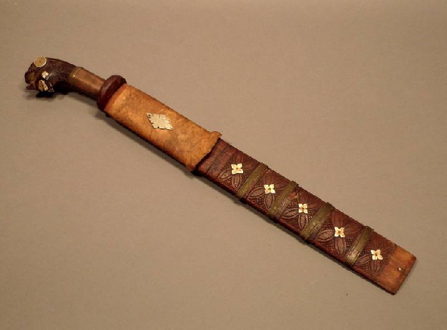

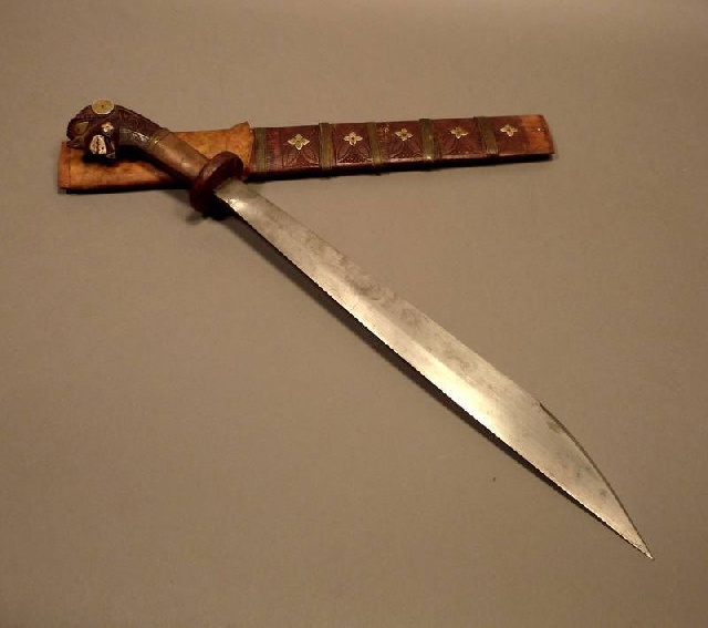

Here one which was sold not so long ago by ebay. I believe that this one is from the same time frame.

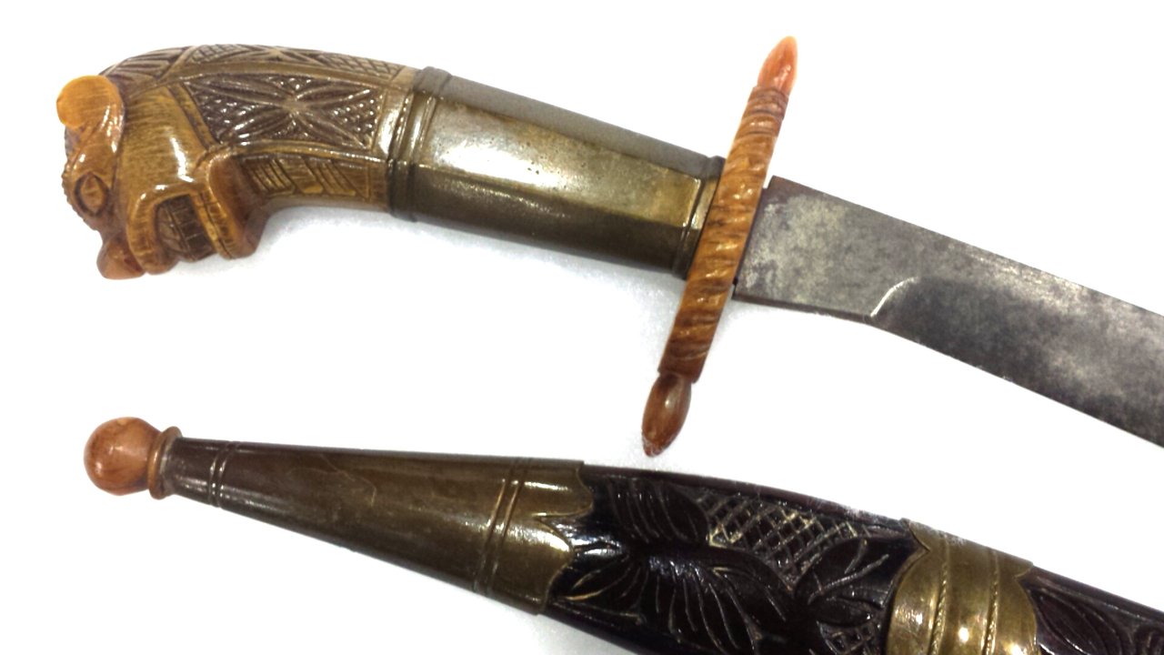

not quite the same blade style, but the scabbard is identical. instead of leather chaff like yours, the one on mine is brass.

Yes Ron your mounts on this one are brass. Ron's is a great example and rare - the horn is albino carabao horn!
There were a lot of these blades made for GIs, but this one is nice.
