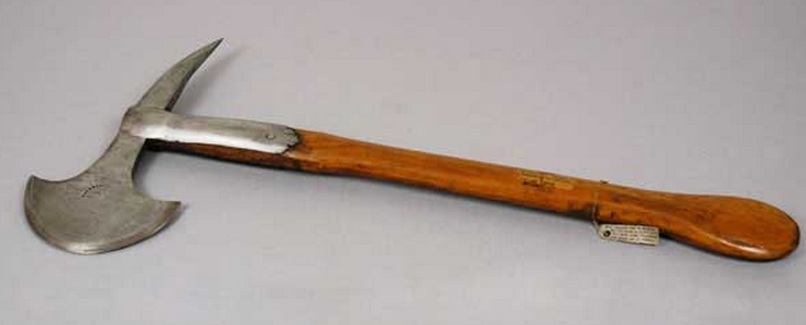

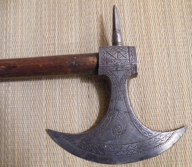

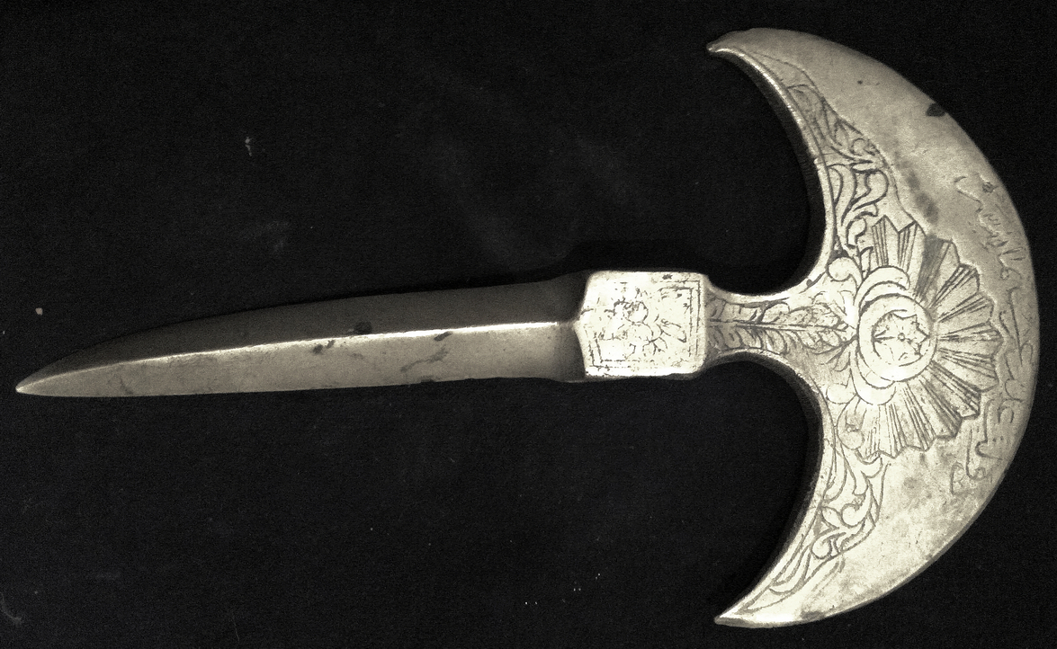

Hi
I acquired this Indian axe recently, and would like to ask if someone can tell me about it please, such as... age range, area in India from where it originated, use (from horseback ?), etc.
Any other comments or information about the axe are welcome.
Thanks in advance.

Any information/comments on this axe ? India specialists....

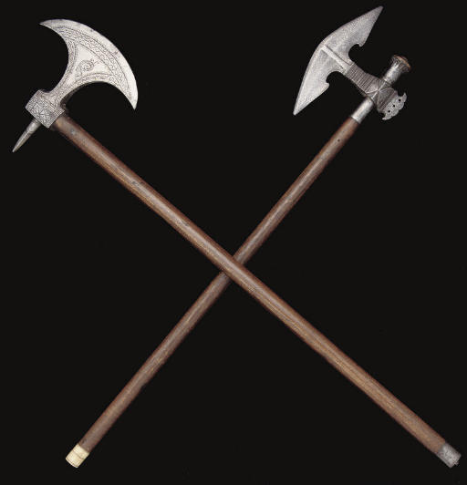

Colin, I looked through my images of Indian axe and found one that was almost identical (maybe it is yours!), from a Christies auction, 2007, it is described as being "Northern" here is a link. I have only seen a couple of Indian axes with a rear spike. Unfortunately I can not add any other information.
http://www.christies.com/lotfinder/a...3-details.aspx
A BULLOVA AXE AND A BATTLEAXE, NORTHERN INDIA, 18TH/19TH CENTURY
The first with crescent shaped steel blade, scalloped and pierced back segment, on a wooden shaft with ivory end - 27in (68.5cm) long; the second with incised lunar-shaped blade on a wooden shaft - 28 1/4in (71.6cm) long.

Thanks for your post. What a surprise...it looks like the same piece. Interesting how objects can go round in circles. So, Northern India then, and 18/19th century.

This intriguing axe shown by Colin has had me struggling for days through notes etc. as this curious motif is so familiar, yet as I found, so elusive.
There are interesting clues however in the entry with similar (perhaps exact) item shown in the vague Christies description.
While the term battle axe is used (another term about as useful as descriptions using northern, southern etc without qualification) it seems the implication is that this is an Indian 'tabar', which it is not.
The Tabar was a larger and heavier axe, a much more conservative blade (not 'lunar' as cleverly noted for 'crescent') and a blunt poll at the back of the head. It was its smaller cousin, the tabarzin, which was a saddle axe of same shape only smaller.
What has been most telling is the Christies entry, which shows the example of this type axe along with a bullova. The bullova is a much varied in form axe, used by tribal groups in the Chota Nagpur plateau in Central India.
The most commonly seen form of head on these is the 'moustach' shape, though other variations are often profound.
What is key is the motif found on many of these 'bullova' axes, in particular the wavy lines with dots in each wave, as well as other linear geometric type accents. The curious bird image is also something seen in motif with many weapons often seen in places from Madurai, and into central eastern regions as noted, and of course farther north in cases.
The same type stippled dot linear motif profiling certain devices, triangular shapes etc is seen on what appears to be a variation of bullova (the traces of red paint as often seen still remaining) which has an almost bell shaped head. This shape is familiar as a Nagan form of dao from Assam in the north. Again, the curiously incised designs prevail, though the blade shape is clearly borrowed.
I think this axe is probably fashioned in central regions surrounding Chota Nagpur, and borrowing from the notions of a 'battle axe' of forms using the crescent head primarily parade or ceremonial style in other parts of India. The examples of these with double crescent axe heads are known in courtly settings seemingly for dramatic effect .
Naturally with this 'interpretive' example the spike at the rear is in my opinion added for effect in that sense, as most of these axes for combat had blunt or hammer type features which were indeed for compromising armor. The spike would probably become lodged in mail or armor, and the smashing of armor in the case of plate would render its occupant unable to move effectively etc.

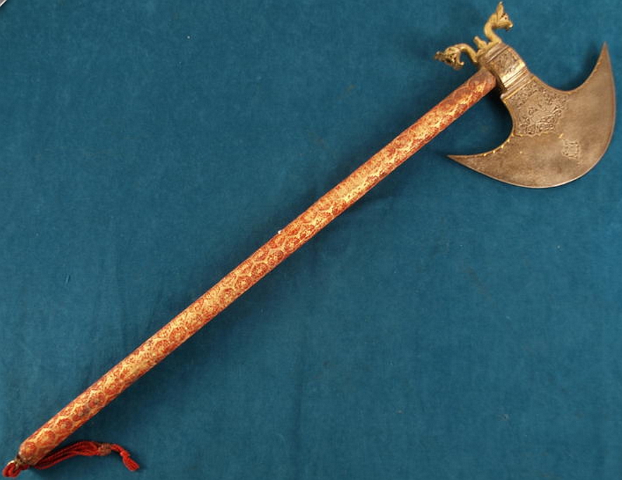

Another well seasoned collector once told me years ago, that virtually none of the various 'battle axes' he had ever examined had been sharpened, a most telling factor in determining their actual purpose . Also, various references noted that the crescent shape head was not a favored type for actual combat.
Also, I am curious about lanyards on these, most examples I have looked into do not have such a feature, and I would like to know of examples that do.

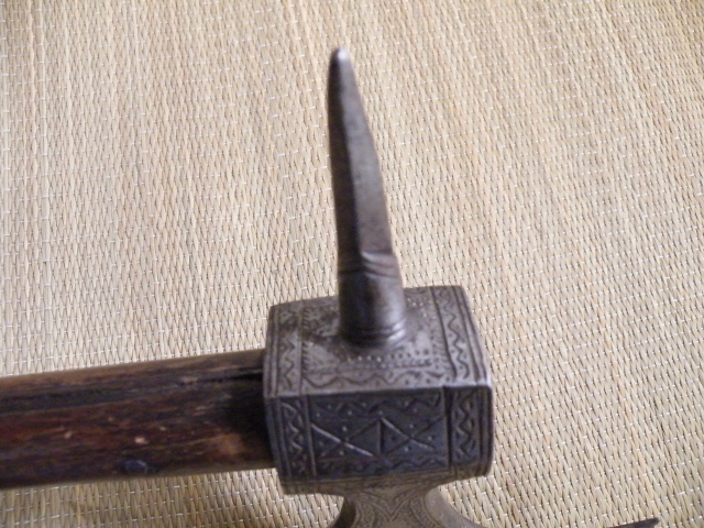

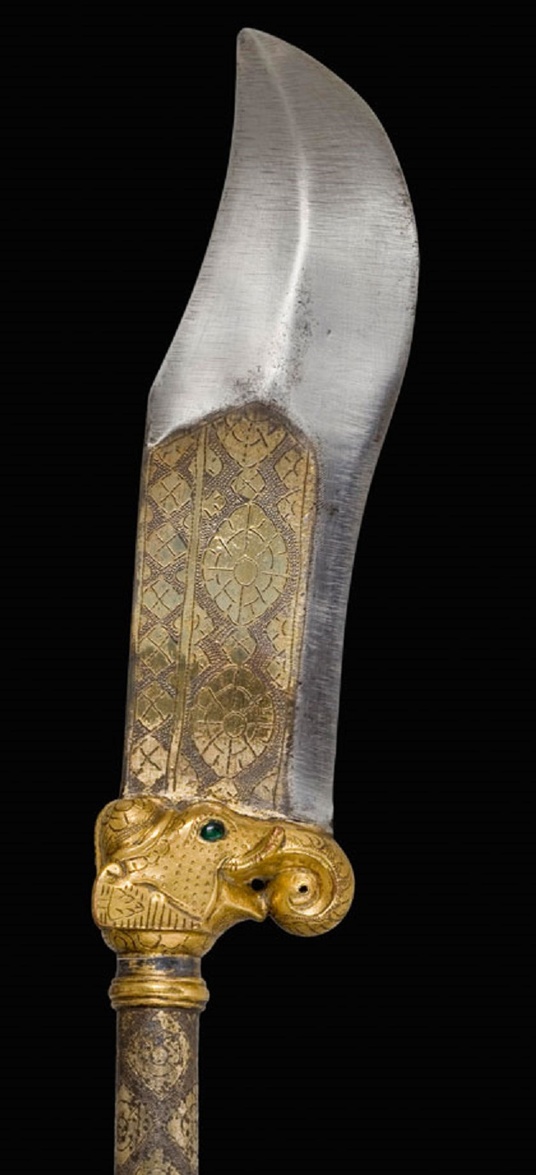

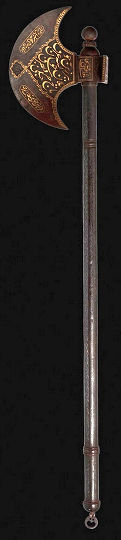

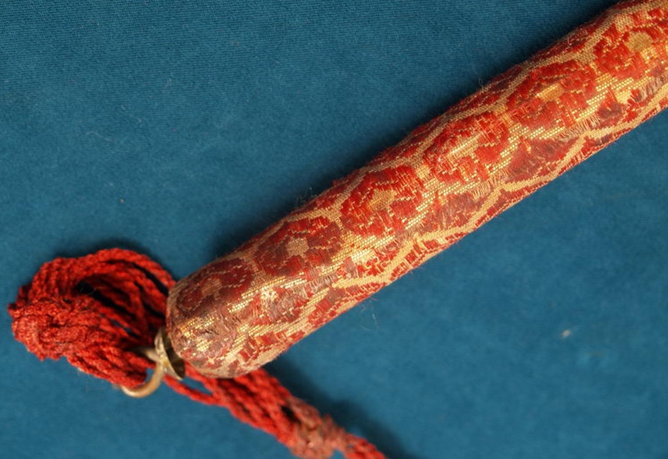

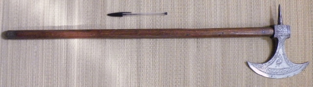

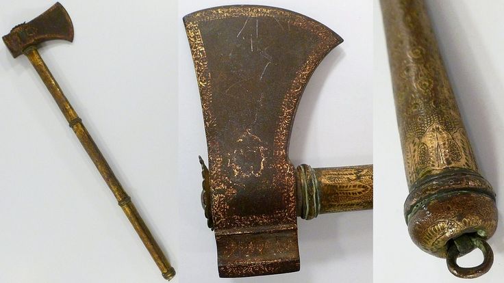

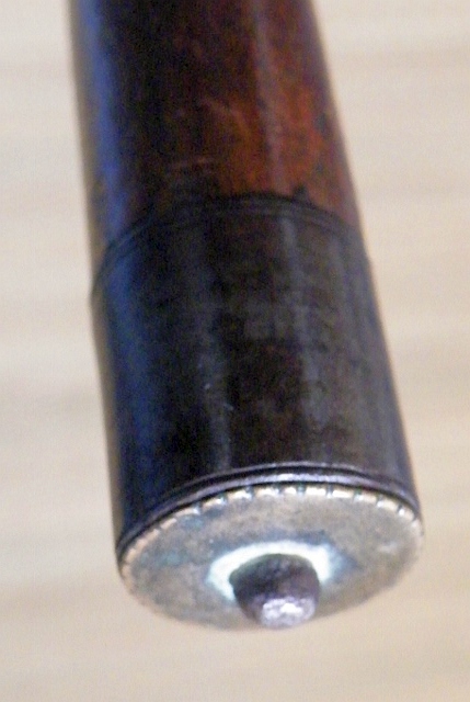

Here are a couple of crescent shaped axe with loops for a lanyard, besides an obvious hole in the shaft or a loop at the end of the shaft you have to look for an enlarged butt that a lanyard could be tied around, some axe have a completely straight shaft with no means of attachment for a lanyard, these were obviously not meant to hang from a saddle, Collin's axe seems to be of this type.
The last image is what would be I consider to be a real "battle axe" / "tabar-zin", not dull, it has a lanyard loop, not overly elaborate.
#1. Persian axe.
#2. Persian axe.
#3. Persian axe, shaft end.
#4. Indian axe, shaft end, (Colins).
#5. Indian axe.

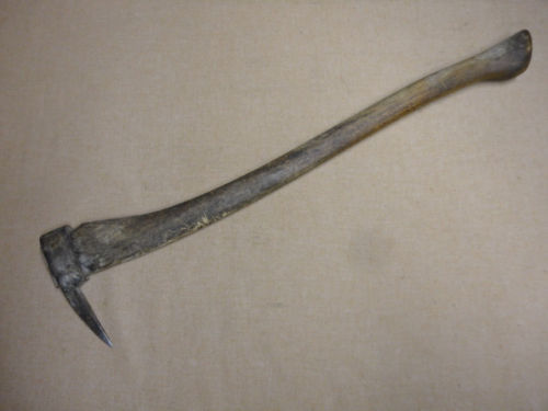

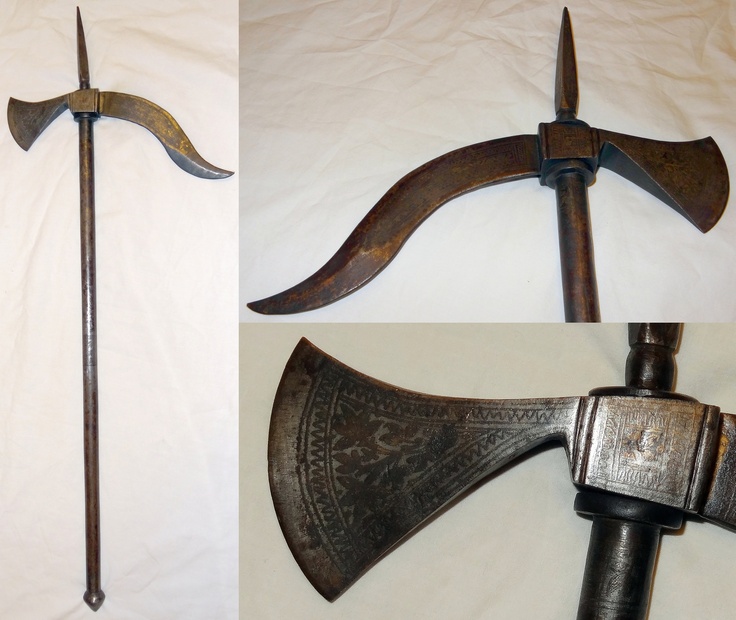

The exception would be the bhuj, essentially a dagger axe which was indeed for penetration, particularly through textile armor or turbans. These were primarily Rajput though used by other groups.

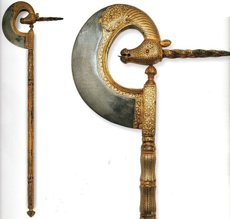

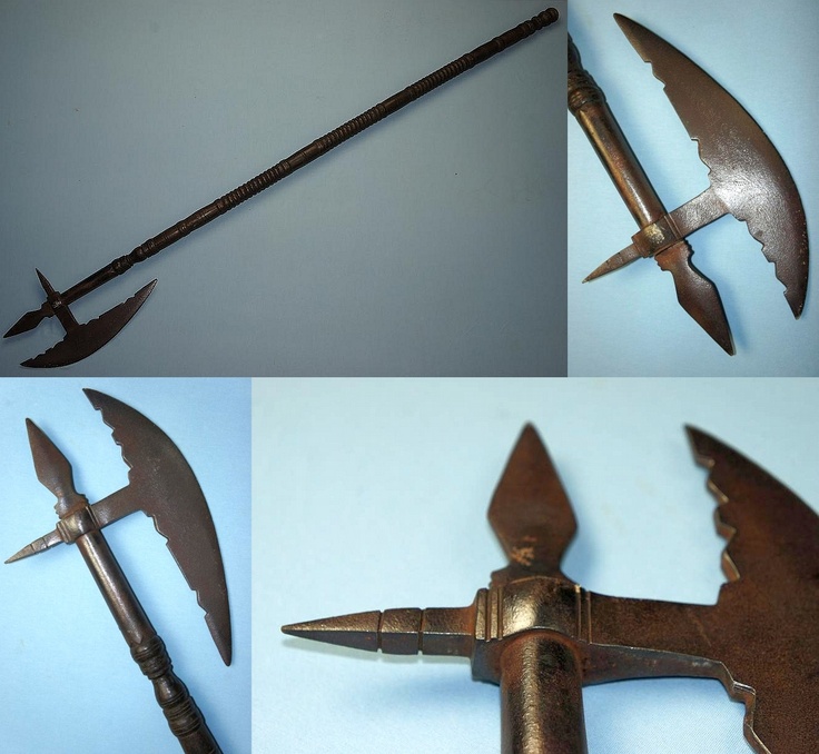

While images of spiked axe are rare there are a few, also I think that zaghnal and war hammers often had more of a spiked, penetrating form than the bhuj.
Here are a couple of spiked axe, tabar-zaghnal, double spiked zaghnal, Ottoman war hammer and bhuj for comparison.
#1. Ottoman axe with rear spike.
#2. Indian axe with rear spike.
#3. Indian antelope axe with rear spike, Furusiyya Art Collection.
#4. Zaghnal, double bladed, The Wallace Collection.
#5. Ottoman war hammer.
#6. Indian bhuj.
#7. Indian tabar / zaghnal.

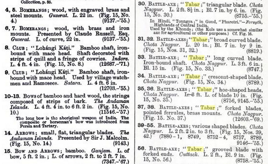

Depending on the source "tabar" simply means "axe", Egerton in "Indian and Oriental Arms and Armour" uses tabar to describe crescent, hoe, triangular, long curved, forked and short curved axe heads.
Interesting and most salient point, the use of certain specific terms for various weapon forms is indeed a slippery slope in the study of ethnographic arms. Much of this is the result of transliteration, semantics and other disruptions in using terms used locally in their respective cultures. In other cases, there is the instance of common parlance used by collectors and those historians who study these weapons, and often errors perpetuated by subsequent writers on them.
Case in point here is Egerton, who is a venerable and most respected author whose seminal work on Indian arms has stood as a benchmark for many serious students of these weapons. It must be remembered that he wrote in 1880, and there has been considerable research done since then.
It is indeed intriguing to see these entries in Egerton's catalog, in which this entire series of axes are termed 'tabars', to which I would agree that the term is indeed a Persian word for 'axe', hence the diminutive 'tabar-i-zin which means effectively 'saddle axe'.
In todays studies of ethnographic weapons, we would recognize these varying forms of axe as 'bullova' and known as forms from the tribes of Chota Nagpur as previously noted.
Egerton probably was unaware of the now accepted term for these axes as 'bullova', as they are referenced in Stone who wrote in 1934, and listed as his reference, "Sport and Adventure in the Indian Jungle", Mervin A. Smith, London, 1904.
With regard to the use of terminology on weapons, Stone did unfortunately follow Egerton in due course with his use of the term katar, for the transverse grip daggers well known to us by that name. In an ironic twist, Egerton shows the original plate (Plate 1,p.23)of the early reference on Indian arms, the "Ain -I-Akbari", a treatise on arms at the time of Akbar, where these type daggers are termed properly 'jamadhar'. In his subsequent entries, Egerton consistently uses the term katar for these daggers, which spurred the incorrect use of the term by following writers, including Stone.

In "By My Sword and Shield" (E.Jaiwent Paul, 1995, p.84), it is noted that G.N.Pant (op.cit.) stating that "...tabar consisted of a triangular blade with one broad cutting edge"
However, in defense of the use of the term widely, in "The Tabar of a Turkish Dervish" (A.S. Melikian-Chirvani, "Islamic Arms & Armour" ed. Robert Elgood, 1979, pp.112-115). ..the author describing a piece shown in Paris in 1886, a crescent head with sweeping downward 'beard', and that"..this remarkable piece is indeed a tabar, which is Persian for 'axe'".
He also notes the tabar is of larger size traditionally than the tabarzin.
Also noted is that while this piece is a tabar, Islamic India can lay no claim to it.
It is interesting that these would be called 'tabar' as the Turkish word for axe is 'balta'...but it seems that term is used more specifically to the double crescent head axes carried by the Sultans bodyguards.

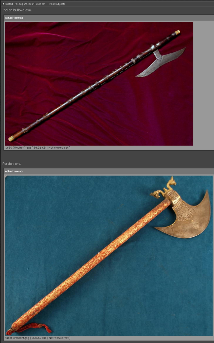

Jim, I am not sure how to add text along with the images on this particular forum, there is no "inline" attachments feature that I can find. You or anyone else can follow this link for any of the images I posted along with what descriptions there are.

Here is an example of how to overcome this hurdle: http://www.vikingsword.com/vb/showthread.php?t=18957

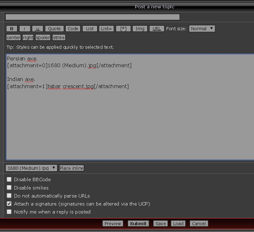

Jim, actually "attached" images are stored on the forums server and will not be lost, "linked" images are what disappears. "In line attachments" is when you can actually see your attached images in your post when you edit it, you can write above and in between the images and actually move the images around, the images appear over each other in the order you want and you can change the order, they are still stored on the forums server, its just a much easier way to add descriptions etc. Some forums support this, this one does not I guess. Of course attaching images is the best way to keep the posts for future research.
Here is what it looks like.

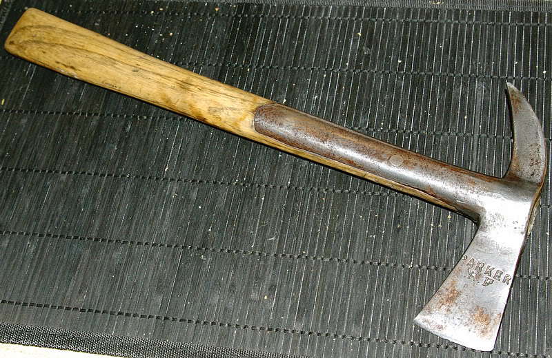

Colin,

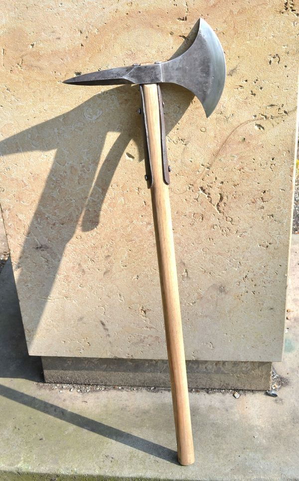

The configuration of the head of your axe is very similar to that of the traditional farrier's axe, altho' your one does seem rather small to be used on a horse! Perhaps it is associated with some other form of animal husbandry.
Just an idea.
Richard

Originally Posted by Richard G
Colin,
Just an idea.
Richard

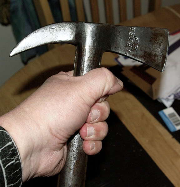

Interesting, here is a picture of an Indian farrier's axe, while I do not think the Indians who made this axe even had horses maybe they saw a British one and liked the design.

there is a tale of robert the bruce, leading his troops into a set piece battle against the english on ground of his choosing and preperation (bannockburn, 1314), getting seperated from his infantry shiltroon while scouting a portion of king edward II's cavalry (500 men) he had cut off including a new knight,Henry De Bohun.
the knight noted the bruce's apparent vulnerability, robert being ahorse armed with his spiked horseman's axe rather than a lance. the knight charged the bruce who on seeing him also advanced to him, both sides cheering their man.
ultimately they met in between the two opposing forces. robert parried the lance and struck the knight in the helmet with the spike on the axe, thru the eye holes, breaking the haft in the process and leaving the spike embedded in the now dead henry. robert the bruce drew his sword and rode back to his men. immensly heartened, the shiltroon did the most unthinkable thing possible. they charged the english cavalry.
the english were so disheartened they easily lost the battle and fled the field.
robert retrieved his favourite axe after the battle and had it re-hafted. the spike had gone thru the helmet, the knight's eye, brain and was stopped ultimately by the other side of the helmet. bit messy.
p.s. - i have a few spike axes, i love them. my latest is however likely a bit newer than yours.

Boarding axes can have the sames shape as well, this is an English boarding axe from the 1800s.
Old 31st August 2014, 07:38 AM   #24
Posts: 4,285

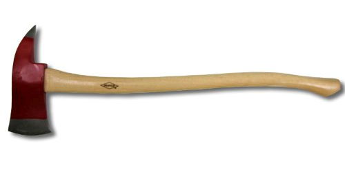

the axe & spike on boarding axes was mainly for clearing wooden wreckage from battle damage, the spike being used like a logger's picaroon... also a handy weapon if you were being boarded, or boarding the enemy and needing to break thru doors and barricades. the french used a similar boarding axe, but the langets were not integral, and were mounted fore and aft instead of side to side like the english one shown. the cutlass and pike were preferred weapons tho as the axe took a big man to weild effectively.
these are the forerunners of the fireman's axe, initially very much like these boarding axes, and still used today, but developing into the more mundain fire axe used by most fire crews and found behind glass in public places. the spike used again for hooking debris and breaking thru barriers. UK use a smaller hand axe, more of a hatchet or tomahawk, which leads us back to the americas, where the spike tomahawk was a favoured weapon.
1. french boarding axe. (not mine - yet.
2. maine style picaroon.
3. std. red fire axe.
4. UK fireman's axe (hatchet) - mine.

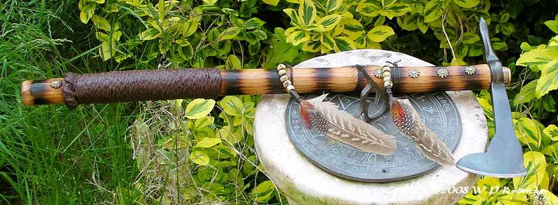

5. same as 4 in hand for scale.
6. my spike tomahawk made from a railroad spike. the ultimate spike axe.

Default Inline images
Hello
VBulletin code has built-in HTML tags that can place an attached image inline with text using the [attach] tag.
Whenever an image or file is attached to a post, it is given an attachment id (ex. 126345). The poster would upload the file, and then simply write Attachment 126345 in the text wherever the image is needed. This would move the attachment from the bottom of the post to wherever the tag is written.
This option is not available in this forum's code list.
Perhaps moderators can look into activating this code.
Emanuel
