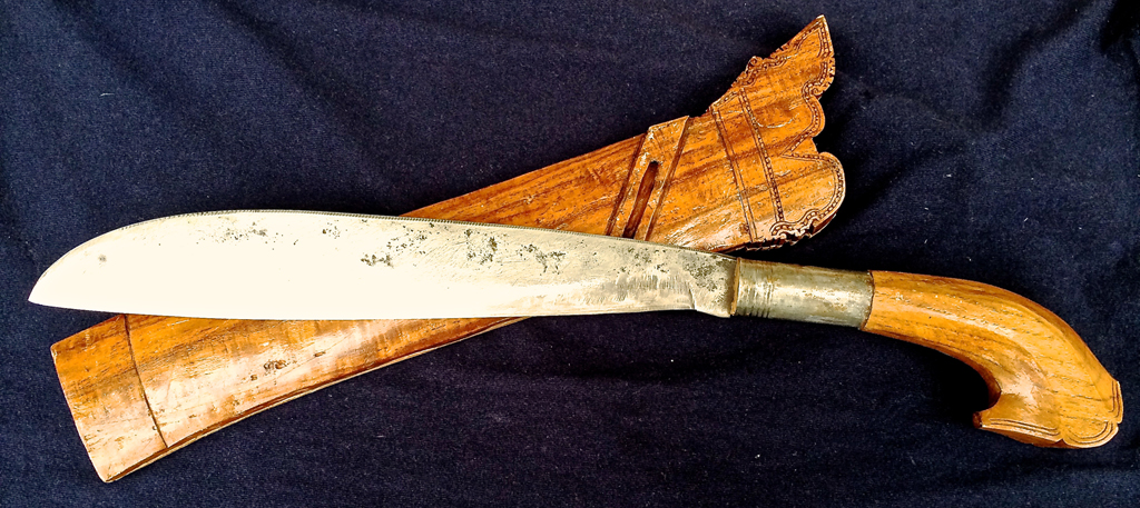

Hello all,
Here is a photo of a weapon I just acquired but not yet in my hands. Am I correct in thinking this is a Moro bangkung? The seller identified it as a "banyal" but I cannot find any substantive reference to a sword of that name that looks like this. Is banyal another word for bangkung?
Overall, this sword/knife measures about 17 inches with the blade about 11 inches. At the widest portion of the blade, it measures 1 ¾ inches.
Thank you in advance for your comments.
Best Regards,
Dave A.

It doesn't quite strike me as a bang kung. So I guess it would be a banyal, which is a new word at least to me.

Old 10th August 2014, 03:57 AM   #4
Posts: 4,747
Dave:

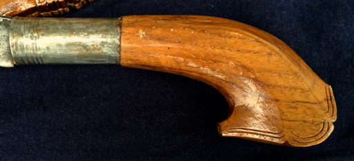

I looked at that knife/sword also when it was up for sale. Could not make up my mind if it was Moro or Visayan because it seemed to have a chisel edge. However, if it is Moro then there may be a clue in the scabbard as to where it came from.
Moro weapons of the Sulu archipelago and Mindanao do not usually have a drilled through "hanger" to tie the sword or knife around the waist. Generally the weapon is tucked into the waist band or a sash. However, this hanger arrangement is seen on scabbards from Palawan and from N. Borneo, so that may be where this sword/knife came from.
The hilt also has somewhat of a N. Borneo look to it as well, especially the shape of the pommel and its carving. That would be my preference for its origin if the blade turns out to be V-ground.
As to what to call it, I think it's a bit small to call it a bangkung, because the bangkung is regarded as being of sword length. But, hey, what's in a name really?

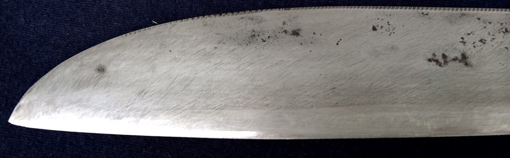

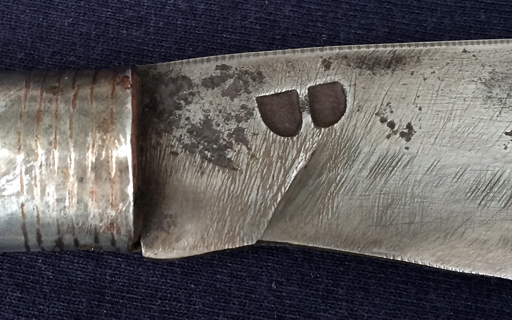

Default Not a Bangkung, all cleaned up!
The item arrived and I've given it a good wash and superficial rust from the blade. It cleaned up nicely!
Old 15th August 2014, 09:48 AM   #9
Look much better on your pictures as from the seller ones. Nice sword however you will call it!
