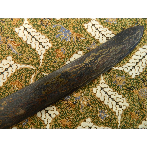

Here is an example, notice how the pamor of this blade has a golden color, could such a pamor result from a more exotic pamor alloy possibly containing gold or other metals as in the video?
Pusaka is offline   Reply With Quote

I could be mistaken, but i thing that yellow hue is more likely the result of a bad staining job.

As David has indicated, the yellowish stain that shows in the pamor in post #9 is the result of failure to get the blade perfectly clean and white prior to staining.
Another way that we can get very peculiar colours in a finished stain job is by using other than proven warangan, or other than laboratory quality arsenic trioxide.
However, what I'm looking at in post #9 gives every indication of failure to clean adequately prior to staining.

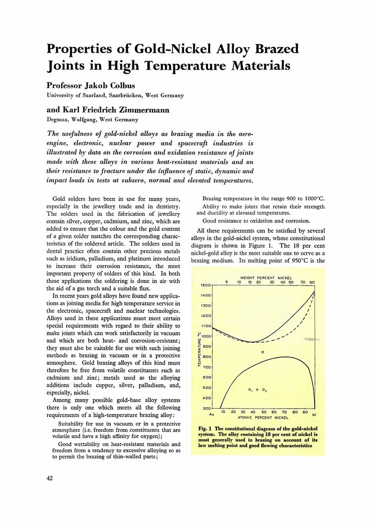

Did a search for gold-nickel alloy and it confirms gold will combine with nickel to form an alloy, so it would appear there is a high possibility of the gold forming an alloy with the nickel component of the meteorite.

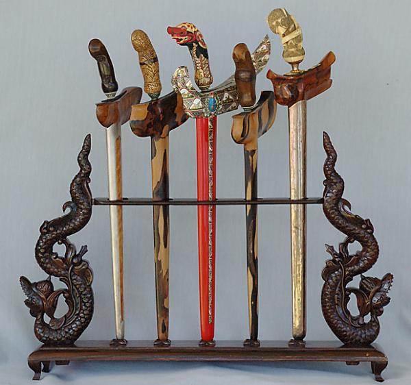

at the end of this article are two little pictures of five keris in a ploncon.
That picture has been lifted from my site.
Not the first time my site has been pirated by people in Indonesia, Solo tourist office lifted something I wrote and included it in their blurb. I don't really mind this, but it would be nice if people asked first, before just taking.
Anyway, here is the pic in full:-

There is nothing special about meteorite Iron chemically, its just a lump of Iron-nickel but we must put ourselves in the place of people who's only way to categorize metals or different Irons types was where it came from, its taste, its smell, its color, its texture and its sound.
A good keris is one that is physically well formed, has a good pamor and when struck rings like a bell. Since I am not qualified in this sound Science I cannot say if a keris made from unusual metallic blends inc meteorite, gold,silver,brass etc might be endowed with a quality of vibration that sets it aside as being something special or not.
