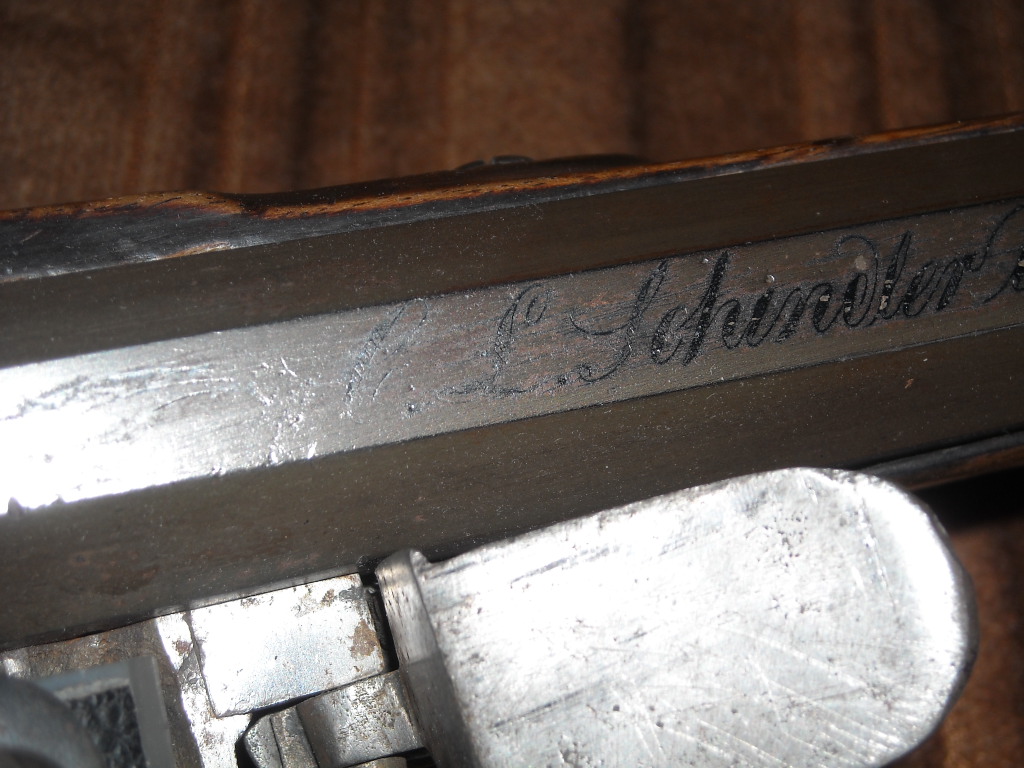

Hallo Michael,
danke
The writing is on the barrel, the lock is not marked.
I found out that in a past Wendl auction there was a C.L.Schindler percussion rifle. With the same spelling Zella bey gotha.
Unfortunately there was no picture anymore.
Hope thatIi will get some photos, then we may have more clues
mit den allerbesten Güßen
Dirk

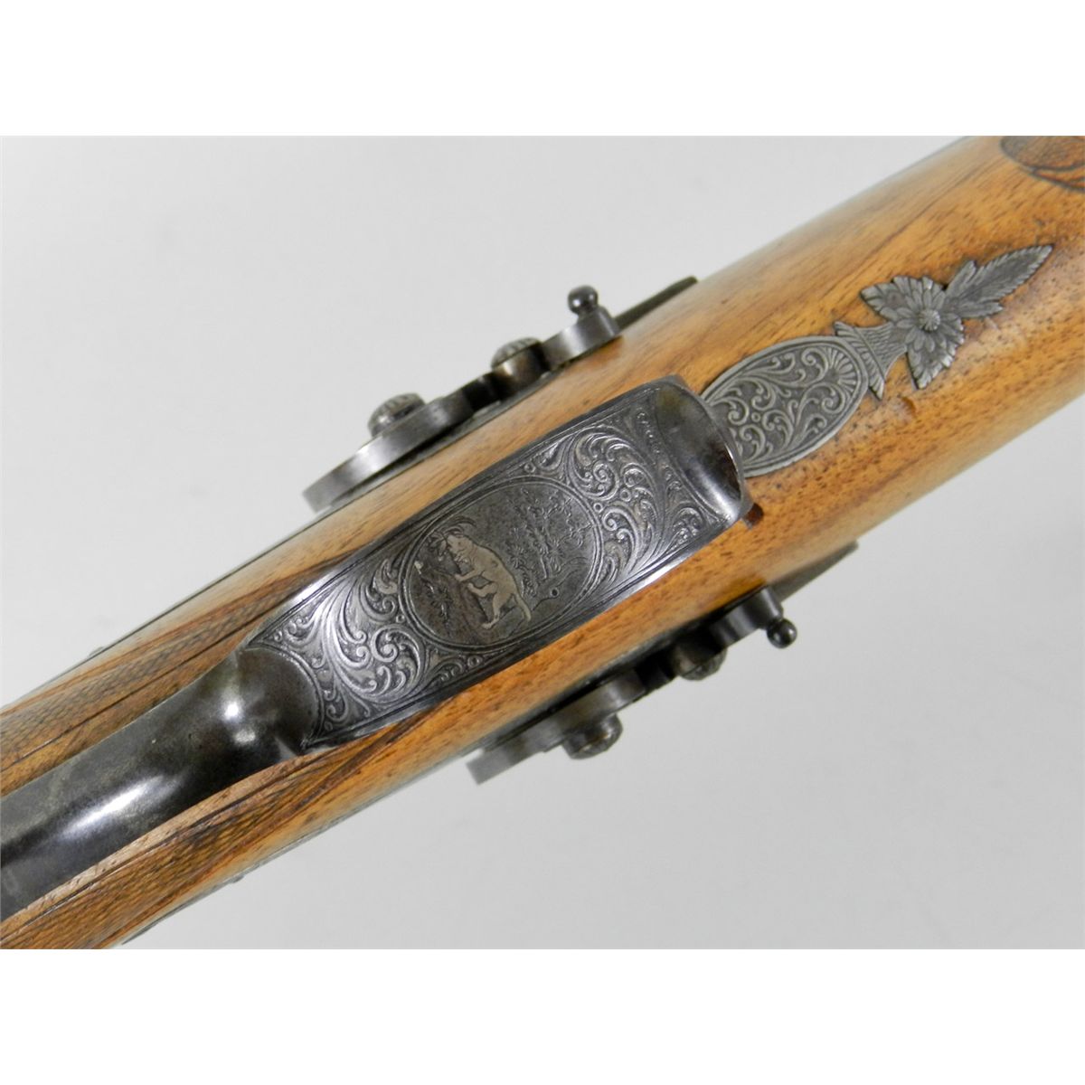

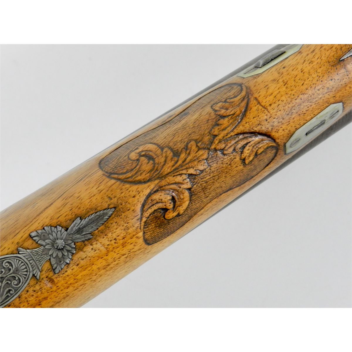

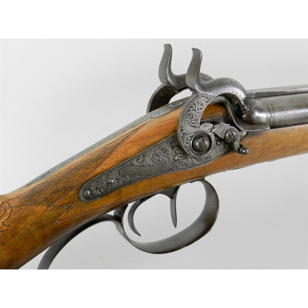

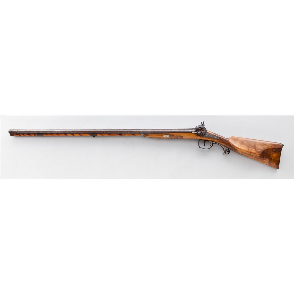

Hi Dirk,
I have more than a passing interest in German sporting firearms of the 19thC, I hope these images will be of interest. A percussion sporting gun mid 19thC.
My Regards,
Norman.

Hi and Hallo, Dirk,
Hi Norman,
On reading your posts, and after a glance at Norman's images, I can tell for sure that the overall appearance of the double-barreled side-by-side percussion shotgun doubtlessly allows for assigning a date of ca. 1840-50 to it, with all of its parts, including the Neo-Gothic style of the signature, definitely being contemporary, and preserved in fine condition. Only the original shellac varnish seems to have been removed from the walnut stock.
Anyways, I am glad to find my information concerning '... records of a certain gunsmith C. Schindler in Zella St. Blasii in ca. 1840' proven right.
It is true that this item is far out of the field of expertise I usually plow, but so is the originally supposed late-18th century period of manufacture.
Danke insbesondere Dir, Dirk,
and special thanks for 'callin' (me) out to the lunatic fringe' (from: Johnny Cash, The Last Gunfighter Ballad) of my Late Medieval centered interest,

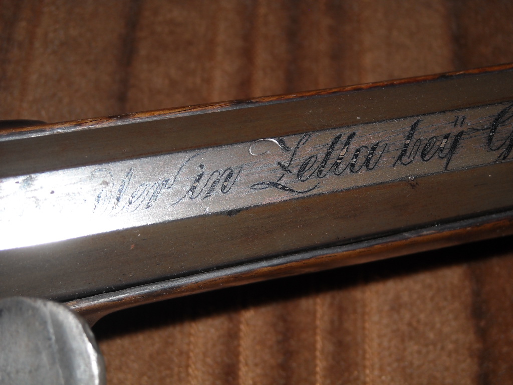

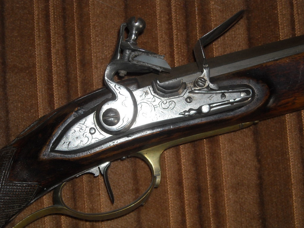

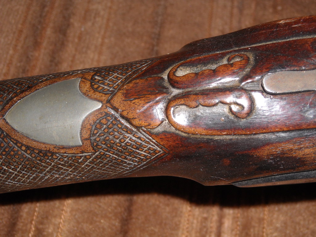

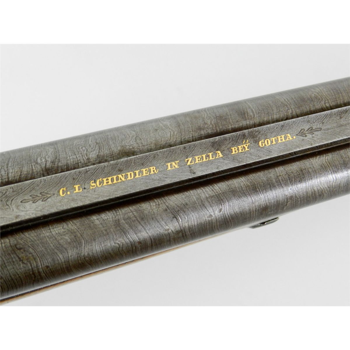

Hi Michael,
Thanks for your reply and for looking after the name.
Finally I just get some photos of the Item, which I like to share.
The name is on the barrel, the lock little decorated but without marks.
Best
Dirk

Hi Dirk,
To that flintlock shotgun by Schindler in Zella, I can assign a date of ca. 1730-40, mainly based on the shape and the (quite simple) engraving of the lock plate.
The walnut stock, though, seems to be a late 18th/early 19th century working time replacement; the rear screw for the gun sling is missing from the underside of the butt stock.
The overall condition of the item cannot not be exactly called fine; the engraving on the lock plate (Late Baroque scrolls) has been much overcleaned.
Best, und schöne Grüße,
