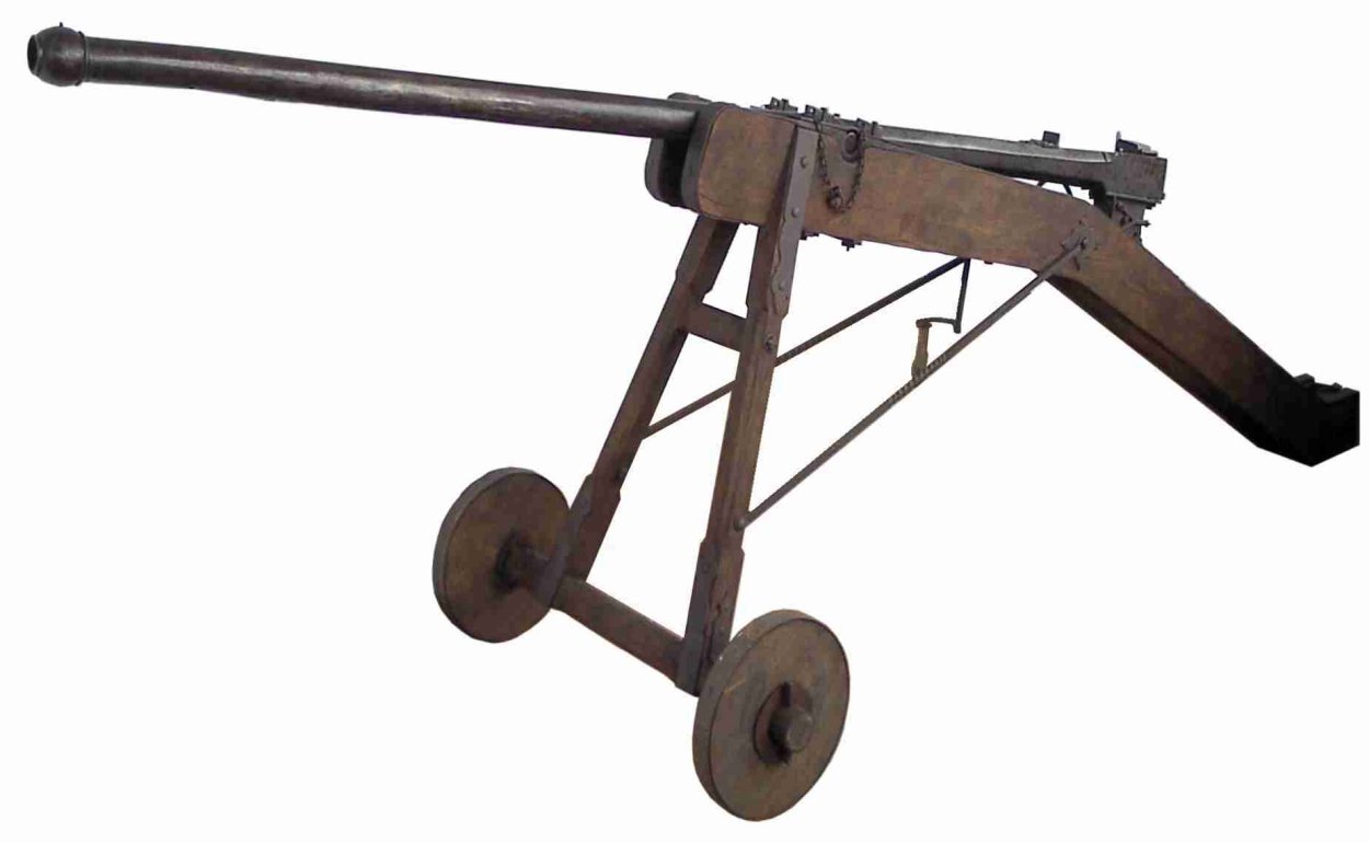

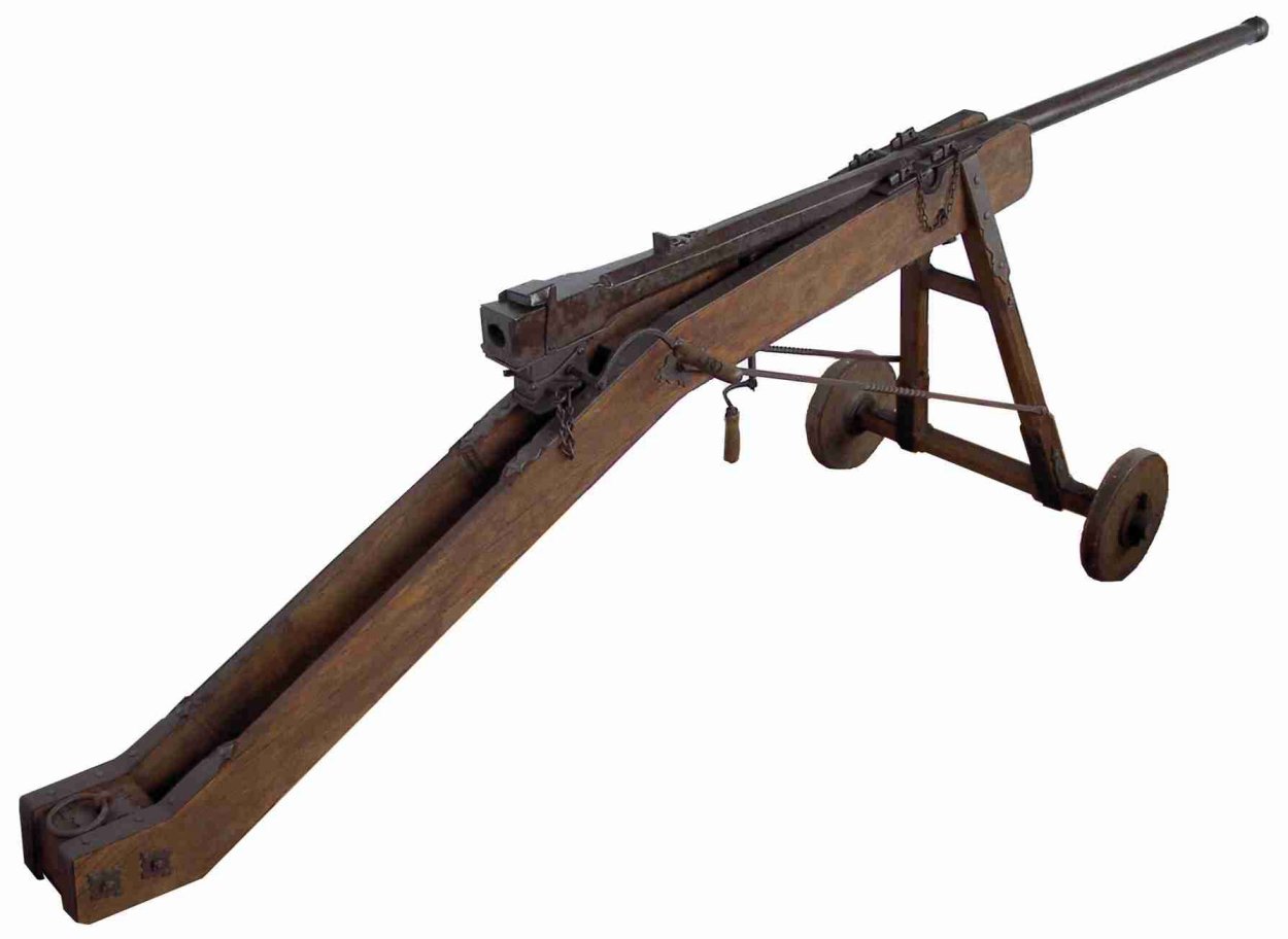

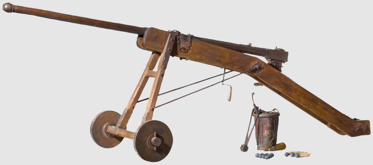

Hi Marcus,
Yes, I do have records of hollow iron balls/grenades fired from pieces of ordnance from at least the 17 through the early 19th centuries.
So your guess that that piece might be a falconet ball is also backed up by the diameter of ca. 30 mm of the piece.

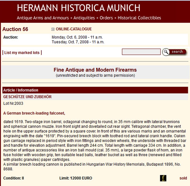

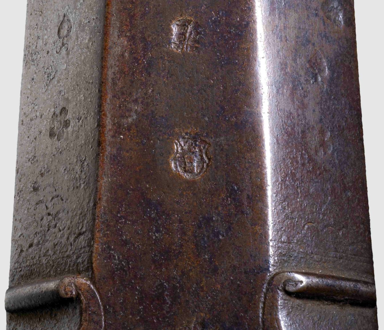

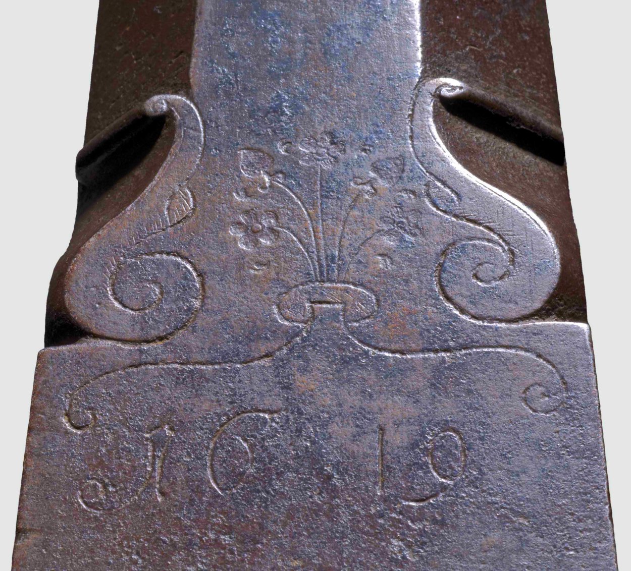

Until 6 years ago, there used to be a huge and complete original breechloading falconet (German: Bockbüchse auf Lafette) in my collection. The barrel was dated 1619, the second year of the Thirty Years War, and struck with a maker's mark wuith the initals VR in a shield, Zella, Thuringia, and the Saxon coat-of-arms (Zella was part of Saxony in the 17th century). The bore was 35 mm.
The whole ensemble was purchased by the museum of the castle of Burg Stolpen, Saxonia, Eastern Germany, where it is on exhibition today.
Next to that singularly complete ensemble, the first attachment depicts my friend Armin König, who builds the finest replicas of earliest arsenal arms worldwide, many of them made after originals from my collection.

The first photo is copyrighted by Armin König, the others are copyrighted by Heinz Grodon and Hermann Historica.

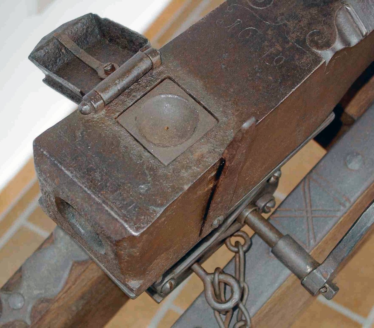

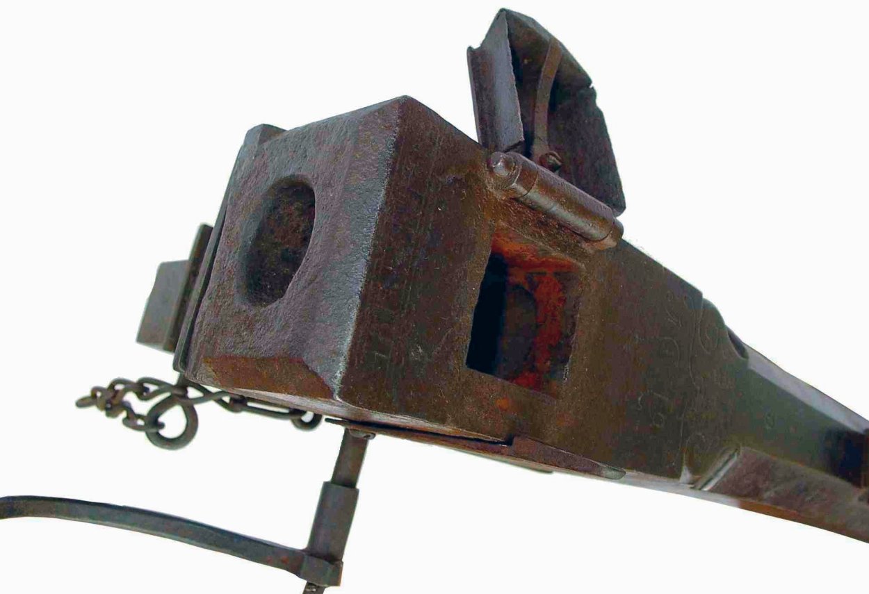

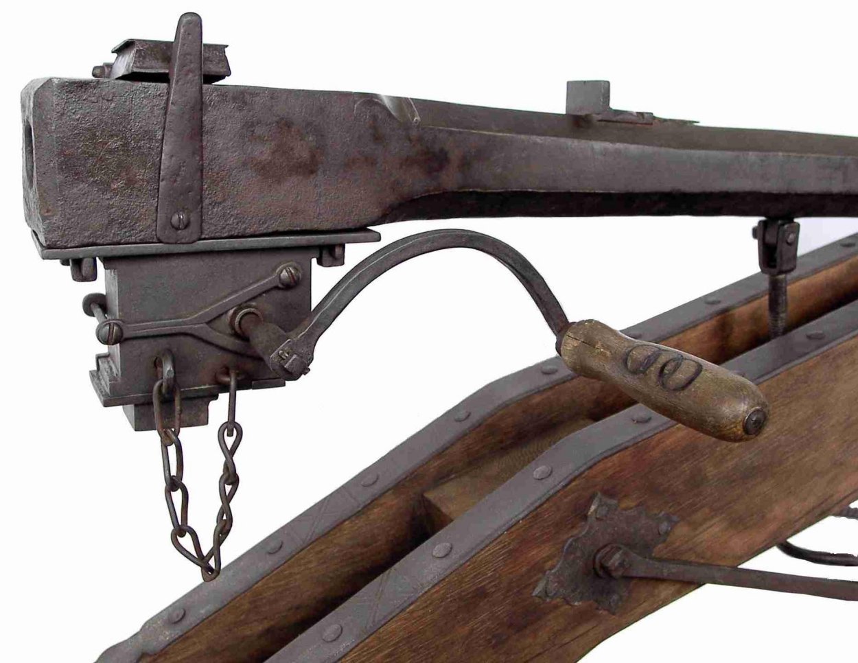

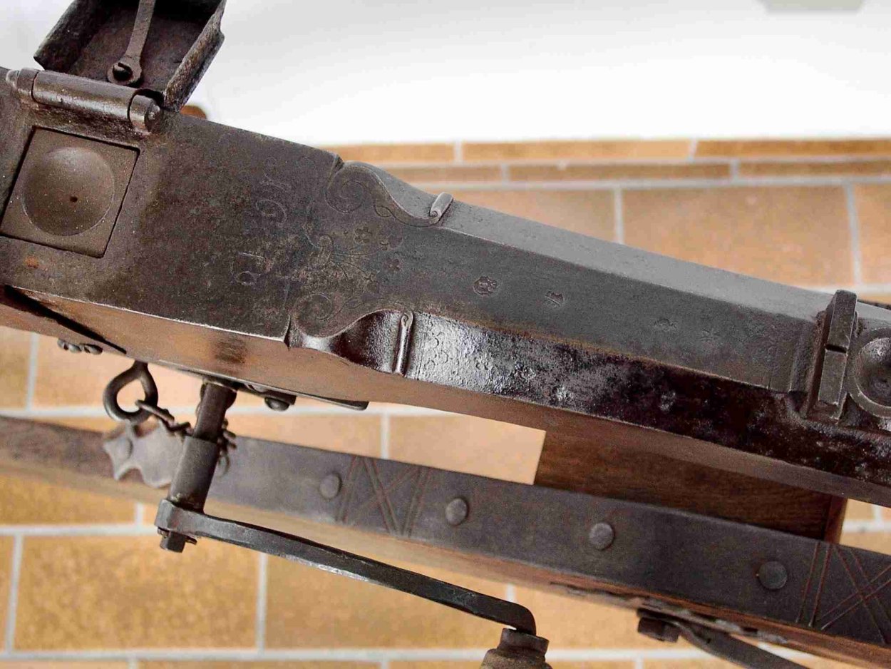

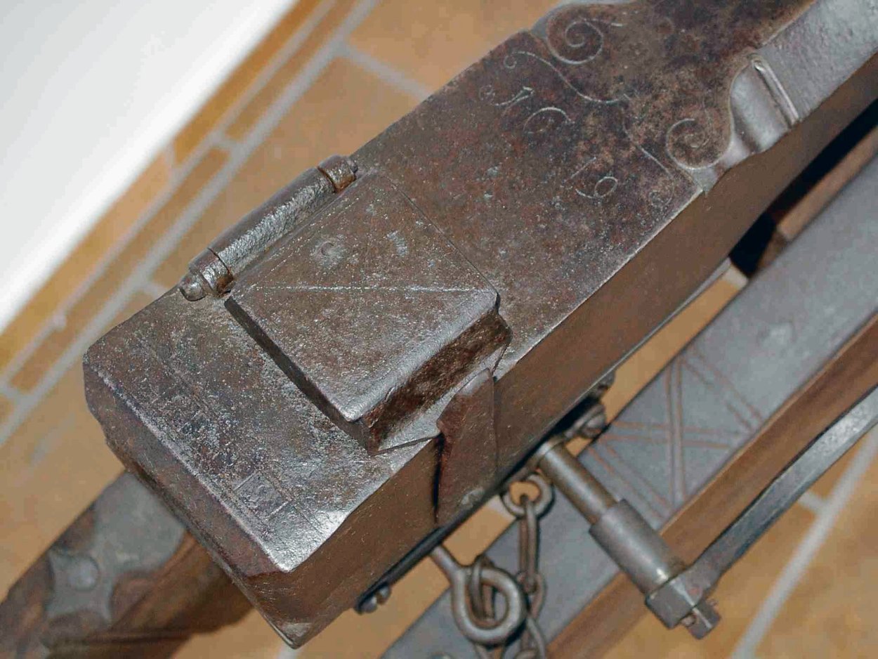

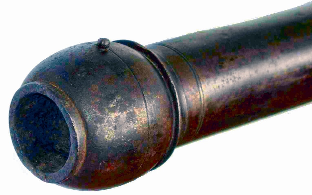

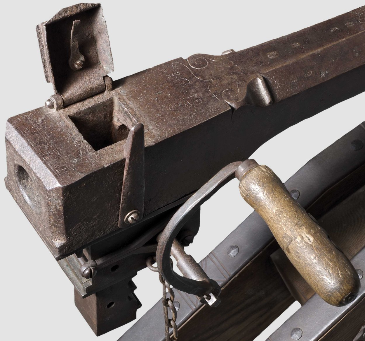

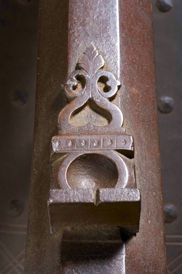

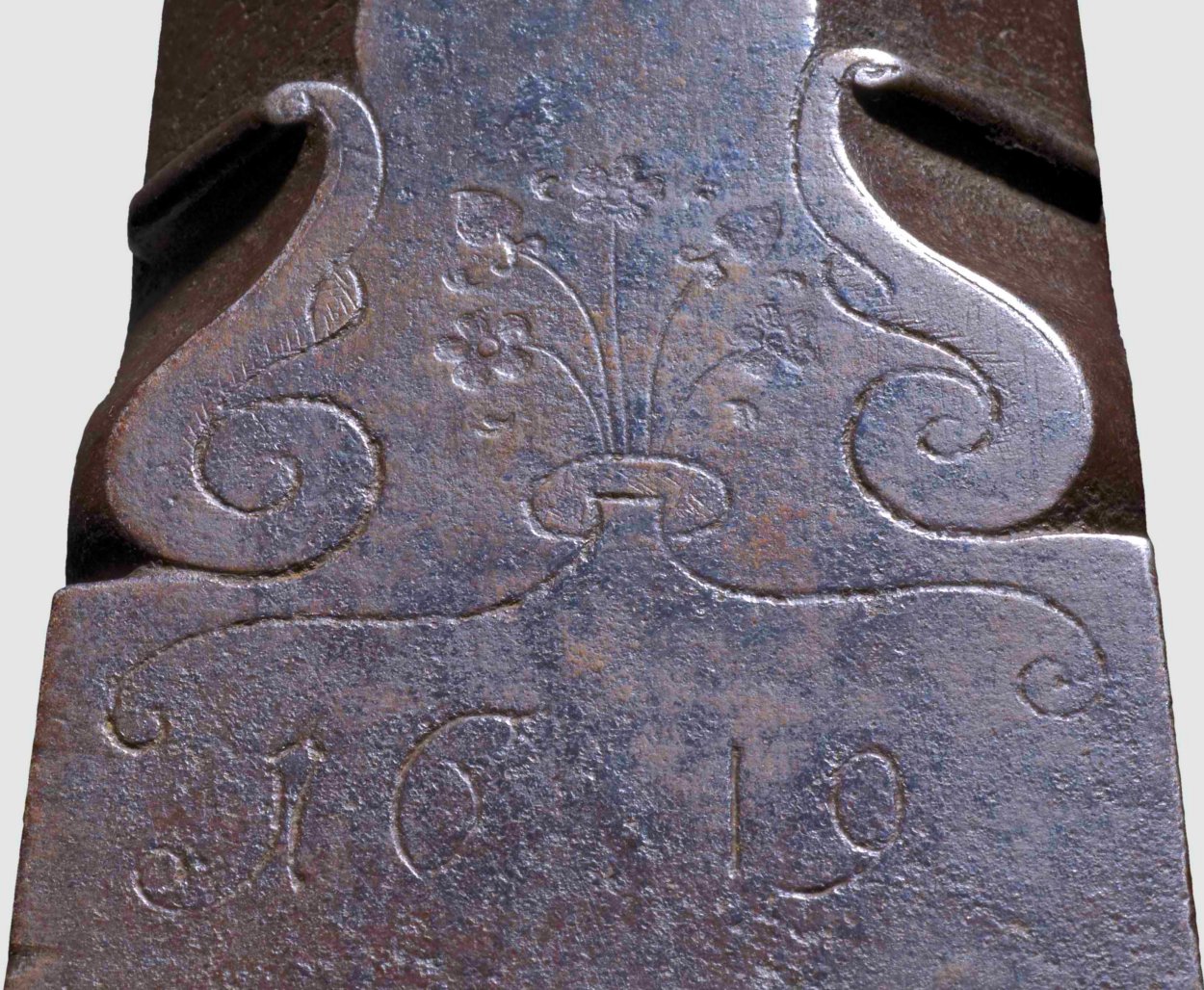

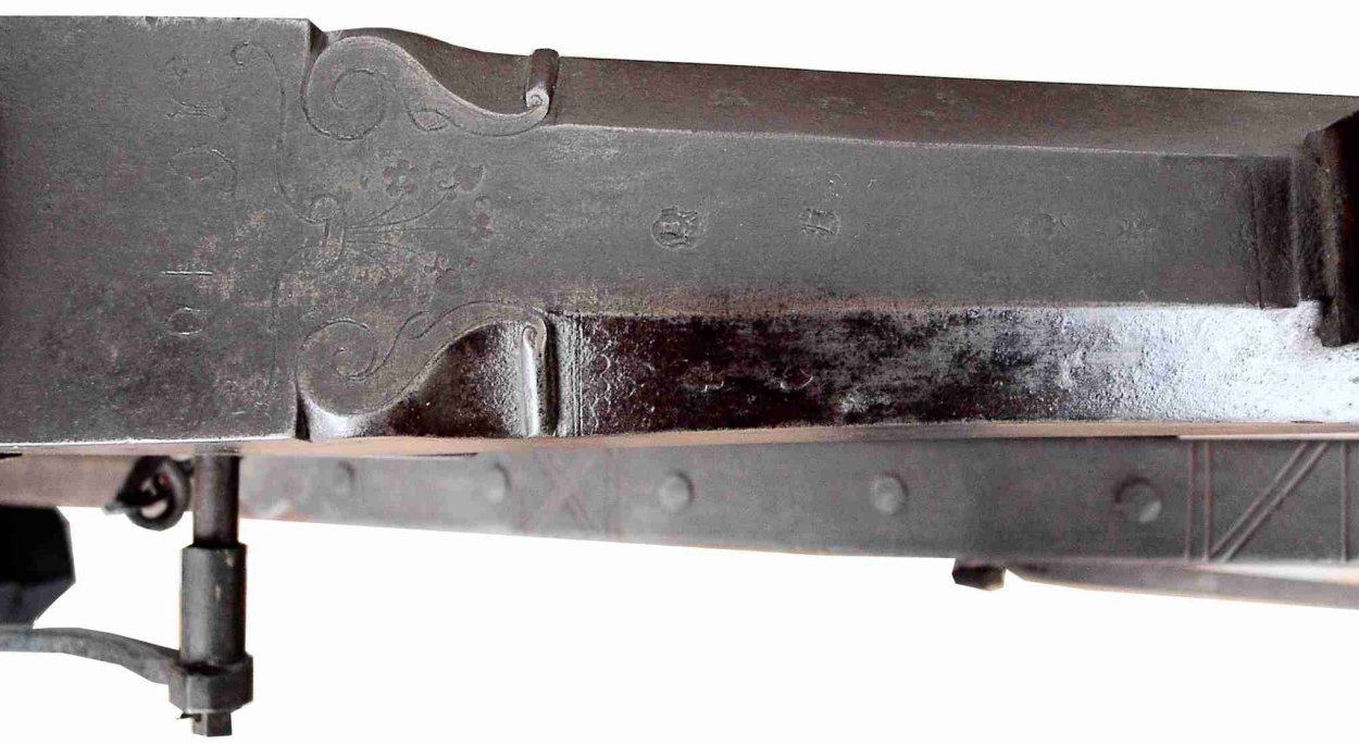

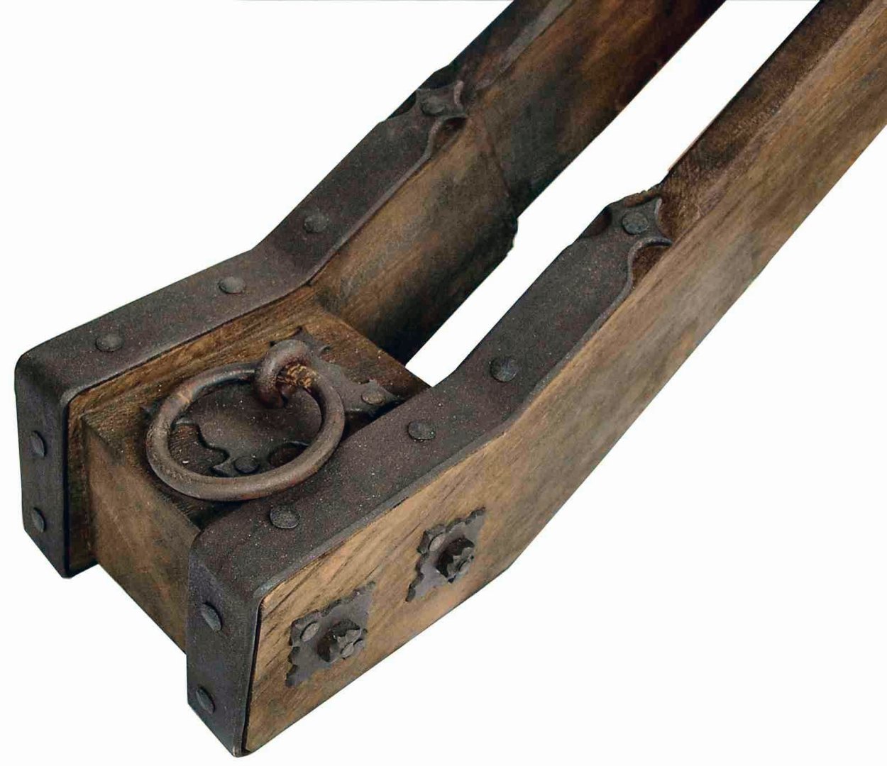

More views of that piece of ordnance dated 1619.
Enjoy the high-quality images.
The dovetailed backsight had the size of a pack of cigarettes!
m

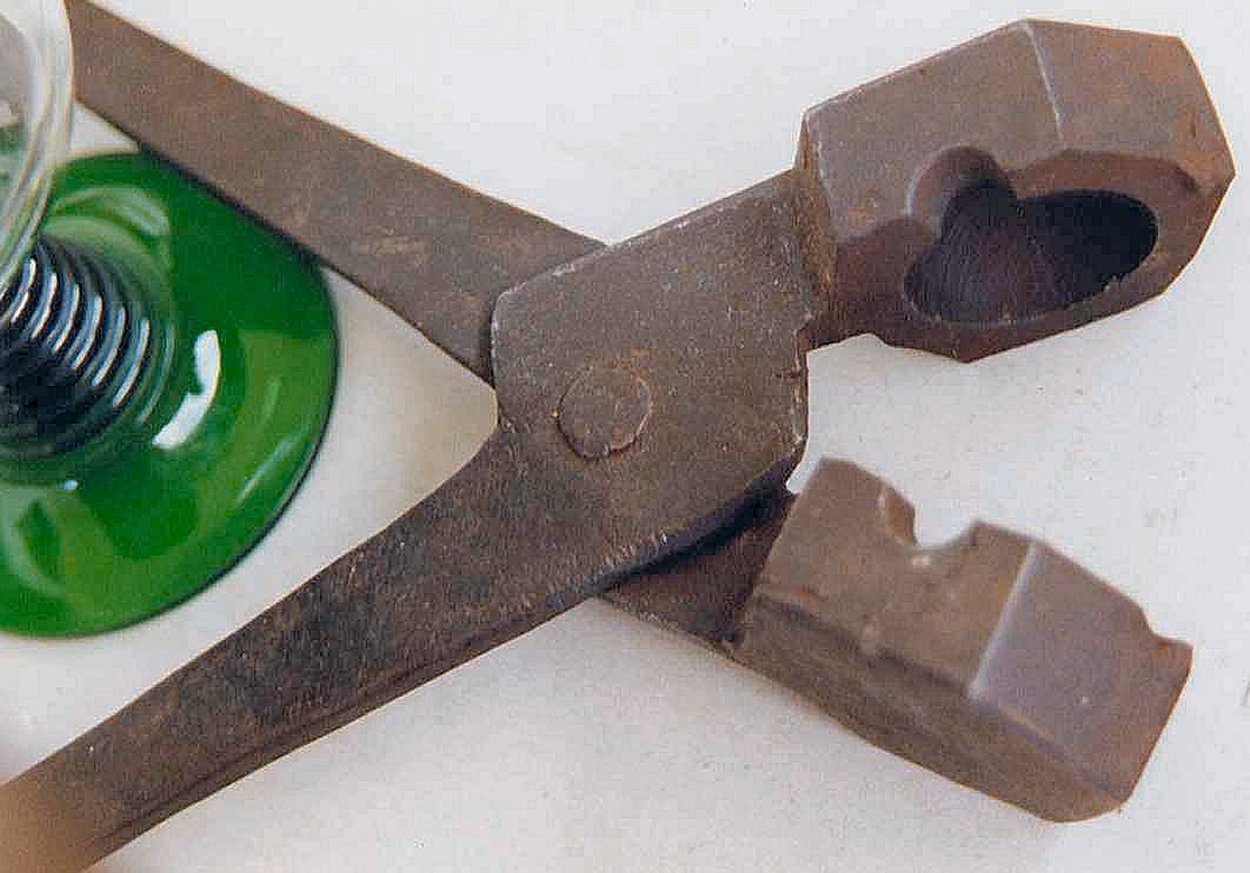

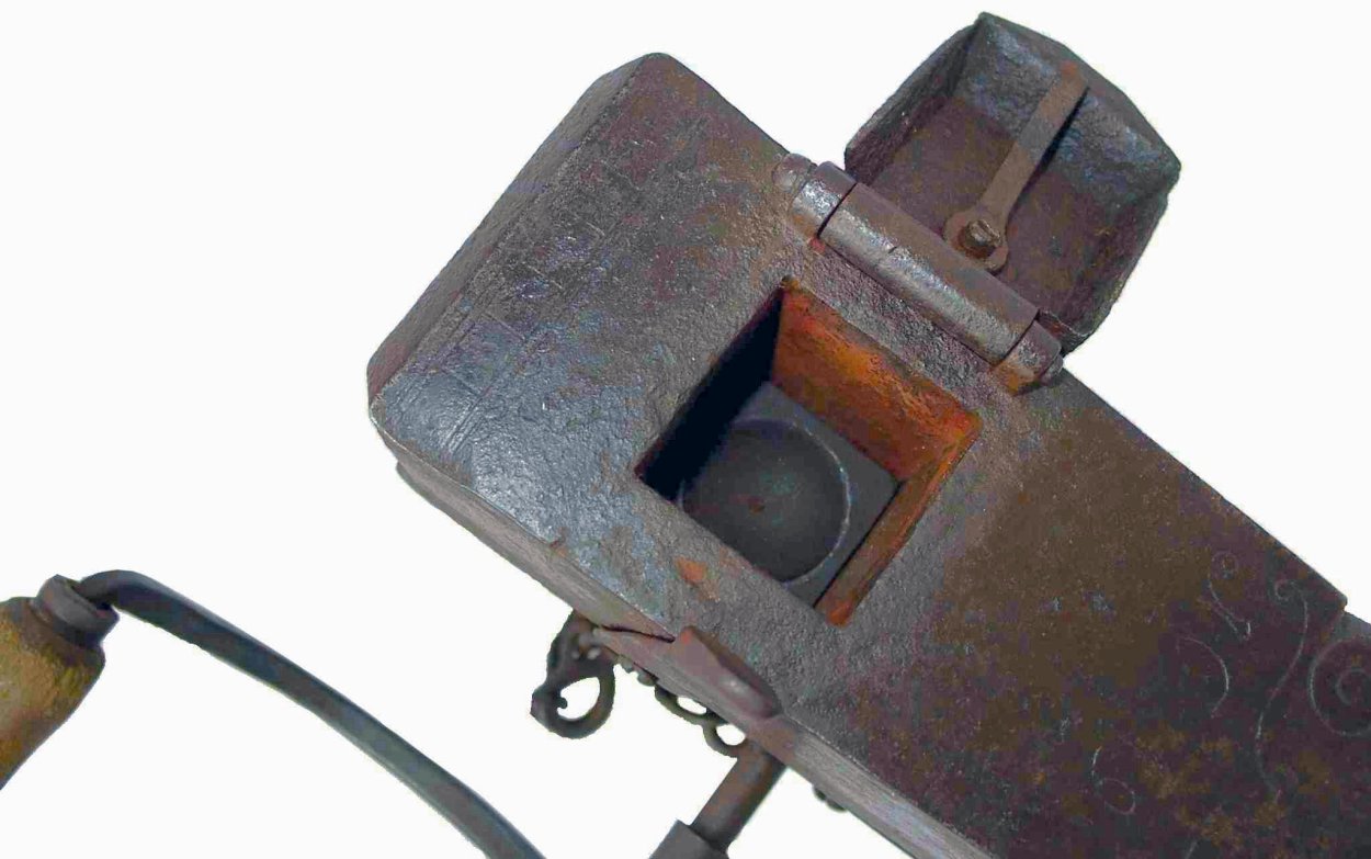

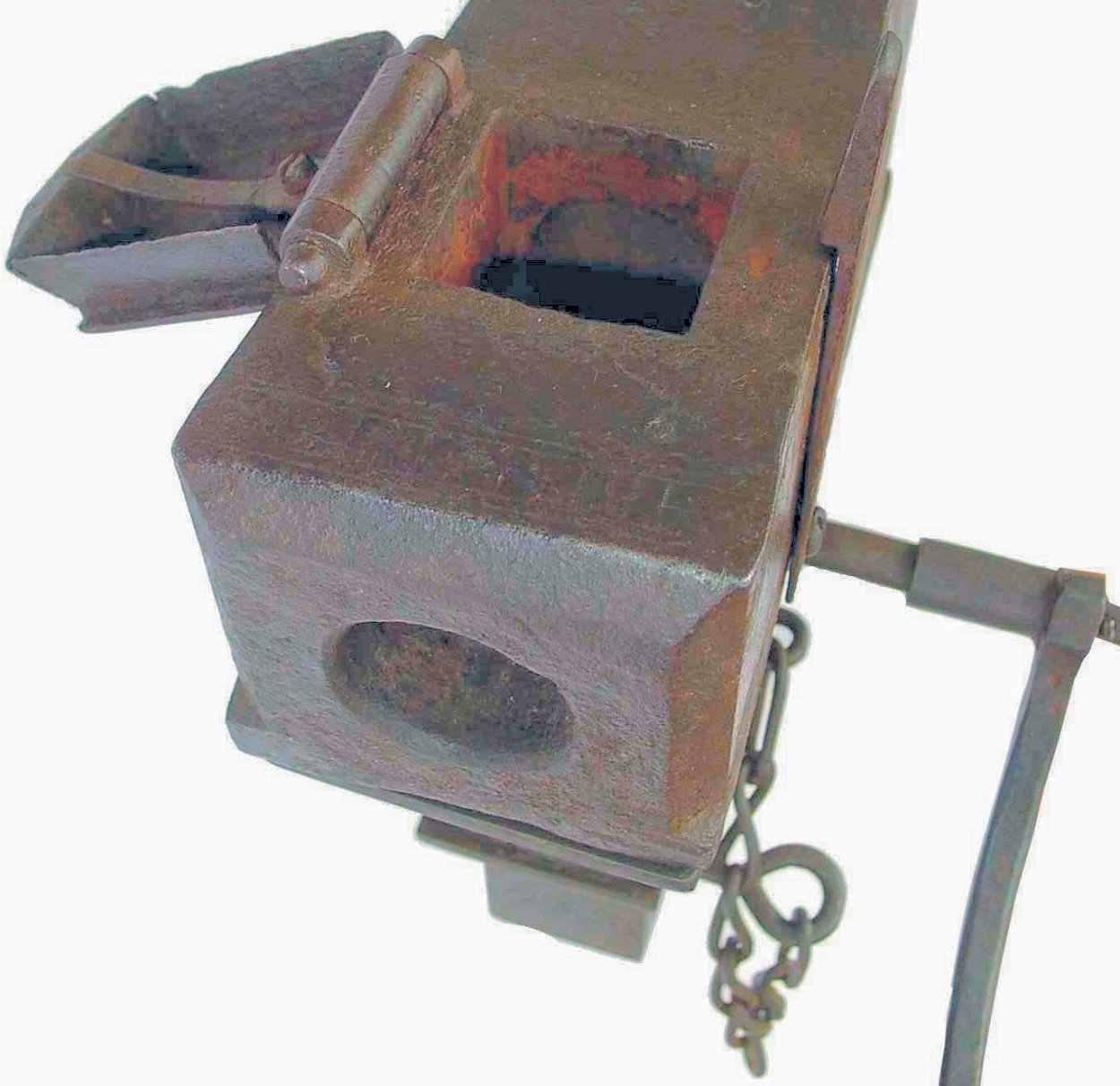

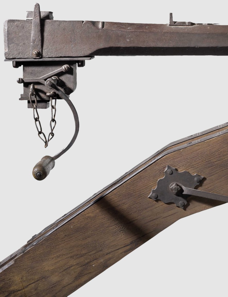

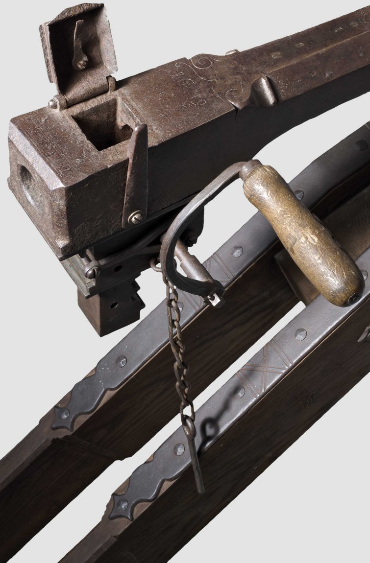

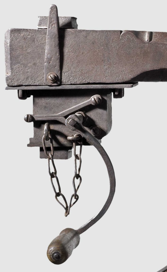

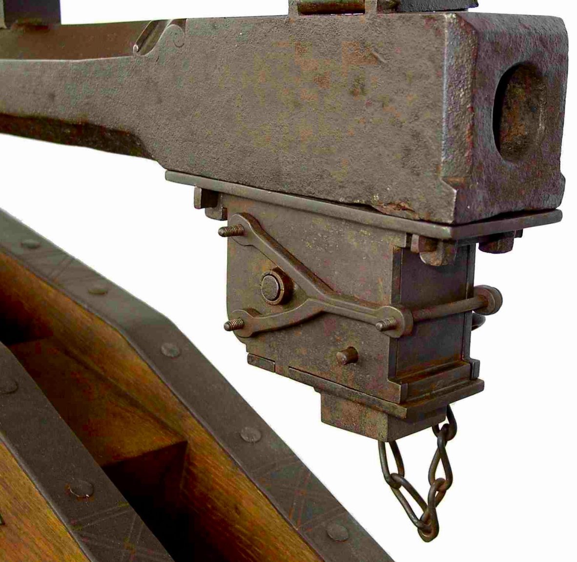

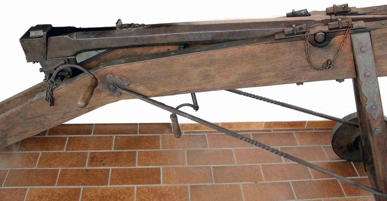

The breech block and its action.

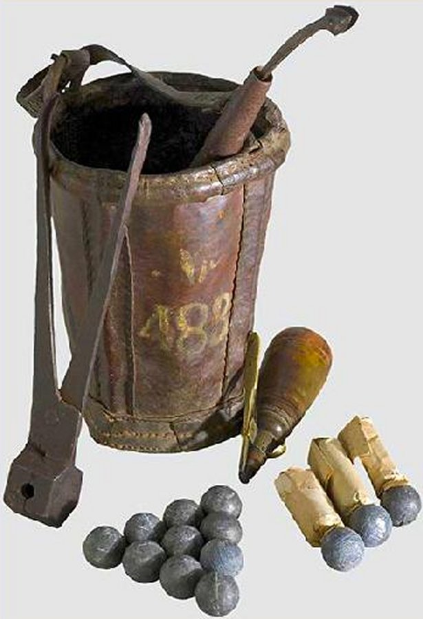

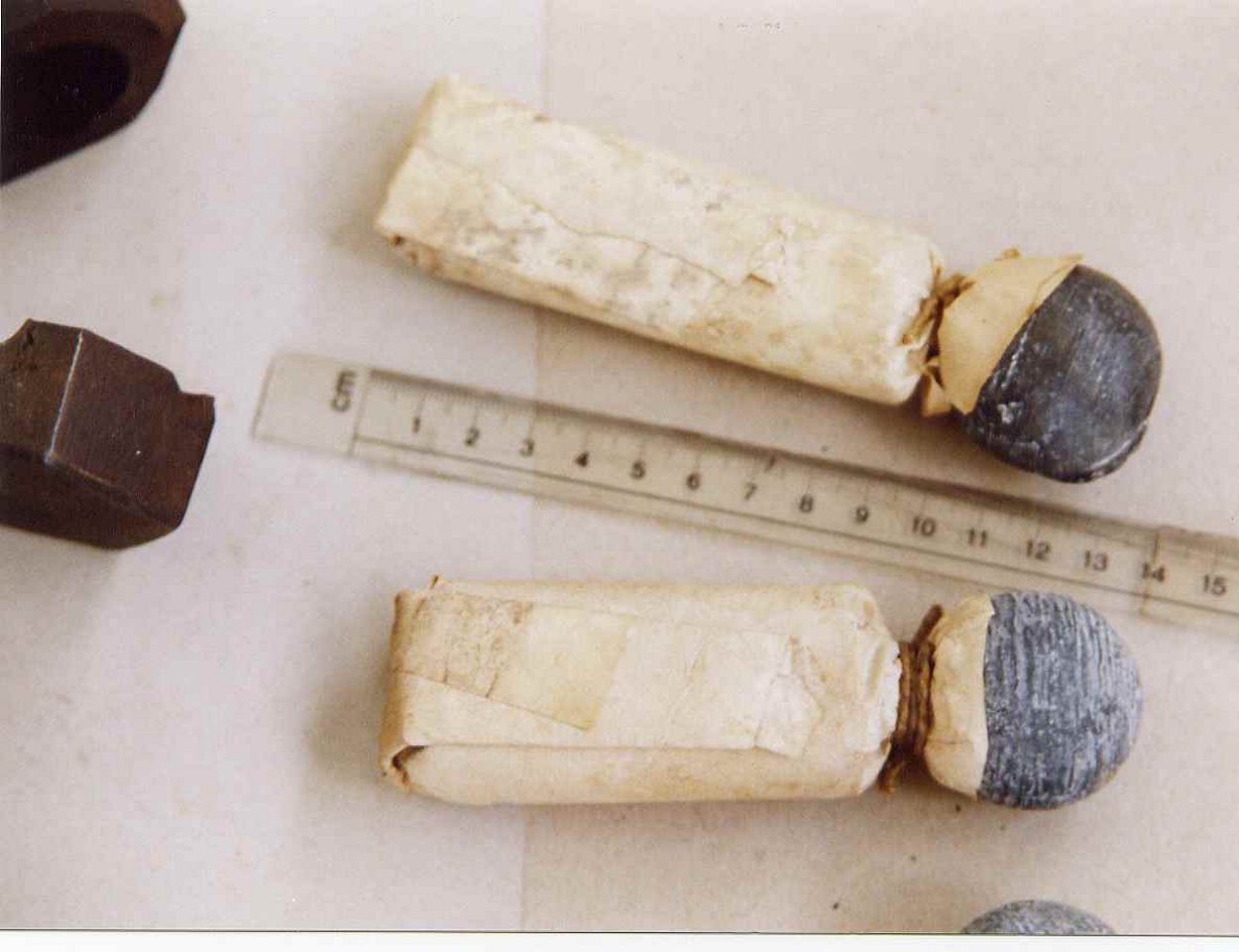

The balls in the illustration are all solid.
Do you have pictures of such small ammo (30 m/m) hollowed for grenade purposes ?

That breechloading falconet is magnificent!!! If i understand correctly, the powder and ball are shoved into the barrel from the rear. Would the load be secured by a ramrod from the front as well after loading was complete?
And that little bowl at the rear sight, i have seen this before on other firearms but never figured out what it is for (to reflect light or..?)
