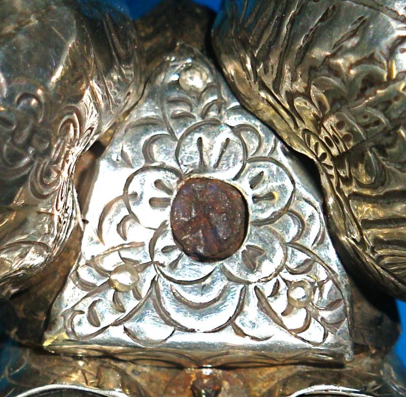

On other note: Robert, there may have been a silver plate on top of the exposed round tang sticking out between the ears. The only problem is that I don't see any nail holes to indicate one was present. I will leave this alone for now until I see something that proves otherwise (nail holes, research, etc). If you folks come up with any, please enlighten me........

Hi Jose, I would guess that the butt plate would have been a small piece of either silver or brass. It would have been fit over the round end of the tang and would have rested against the shoulder were it has been filed from square to round. The cross pattern on the very end of the tang would have been made by a small chisel and was meant to expand the end of the tang to secure the plate. By looking at the photos I would guess the the plate might have been kind of egg shaped with the whole drilled toward the center of the wider end. I do not believe that any nails were ever used to help hold the plate in place, but that it was held in place only by the expansion of the metal caused by the cross pattern being stamped into the end. I would also think that to make the plate more decorative it would have been incised with line patterns to match the ones carved into the horn around it. JMHO.

there has been most proable a butt plate. But I think this will be a difficult undertaking to replace this butt plate since the construction is like Robert explained. But maybe this plate can be glued.

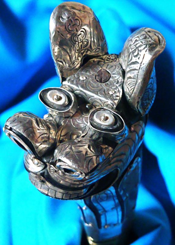

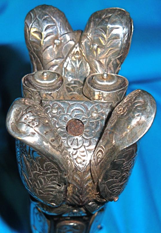

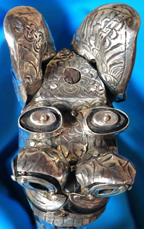

After your advice and my consultation with Miguel Diaz, I designed and made a plate for the top based on the floral motifs already present. I did have to make 3 silver nails to pin it down to the top, but made a hole to integrate the tang into the design, close to what it may have been.
Miguel Diaz also thinks that the "s"s on the blade probably represent nagas (which I agree) and the top plate in the form of a triangle is to represent a mountain, sacred to our ancestors.

Look good! And the pictures good as well!

Great work Jose, now the top of his head doesn't look naked.
