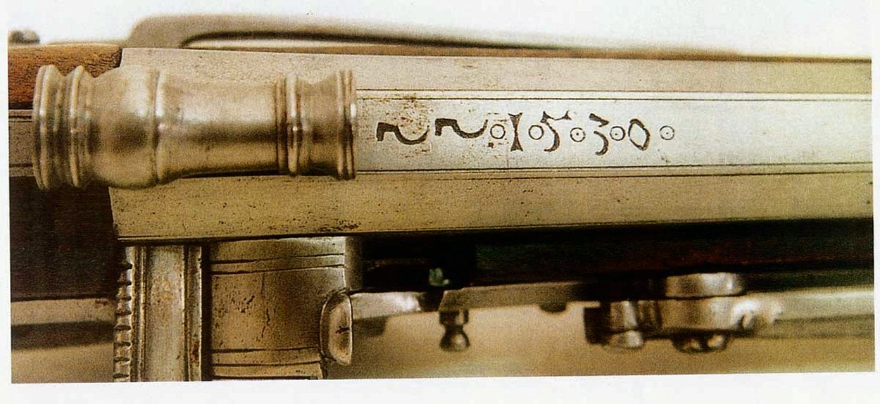

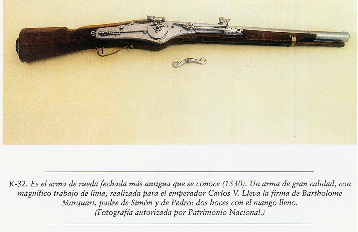

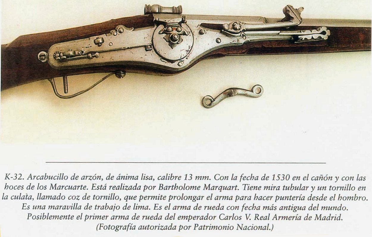

and the earliest known dated wheellock is an arquebus (a small and short gun), made by Bartholome Marquart of Augsburg for the Emperor Charles V, and now preserved in the Real Armería Madrid, inv.no. K32. It is dated 1530 (top four attachments) on the barrel.

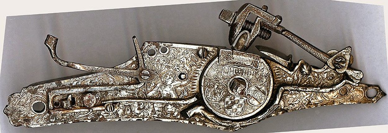

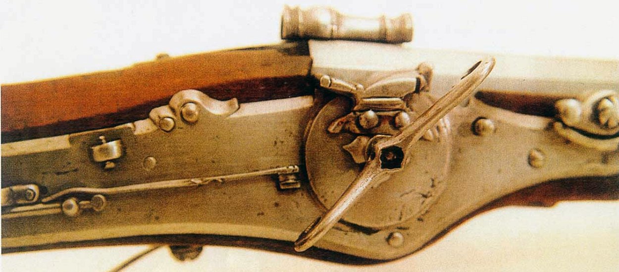

A sample of the earliest known piece of that kind of ignition is in my collection: a detached North Italian wheellock mechanism of ca. 1535-40, from a combination weapon, most probably a war hammer or axe combined with a wheellock gun:
http://www.vikingsword.com/vb/showthread.php?t=7094

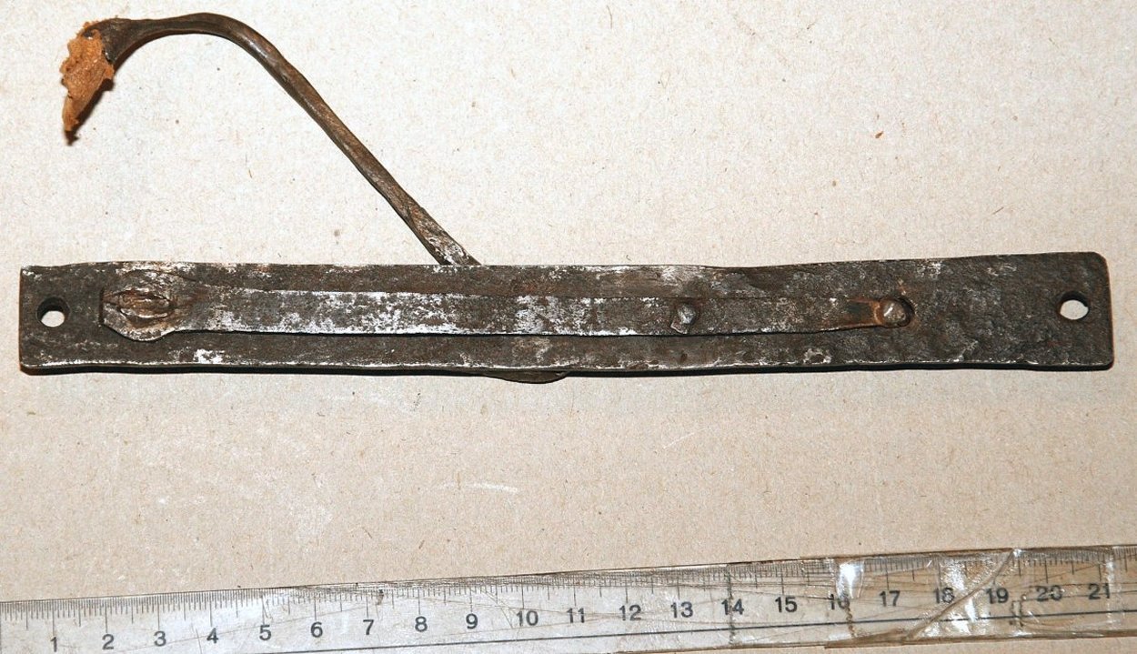

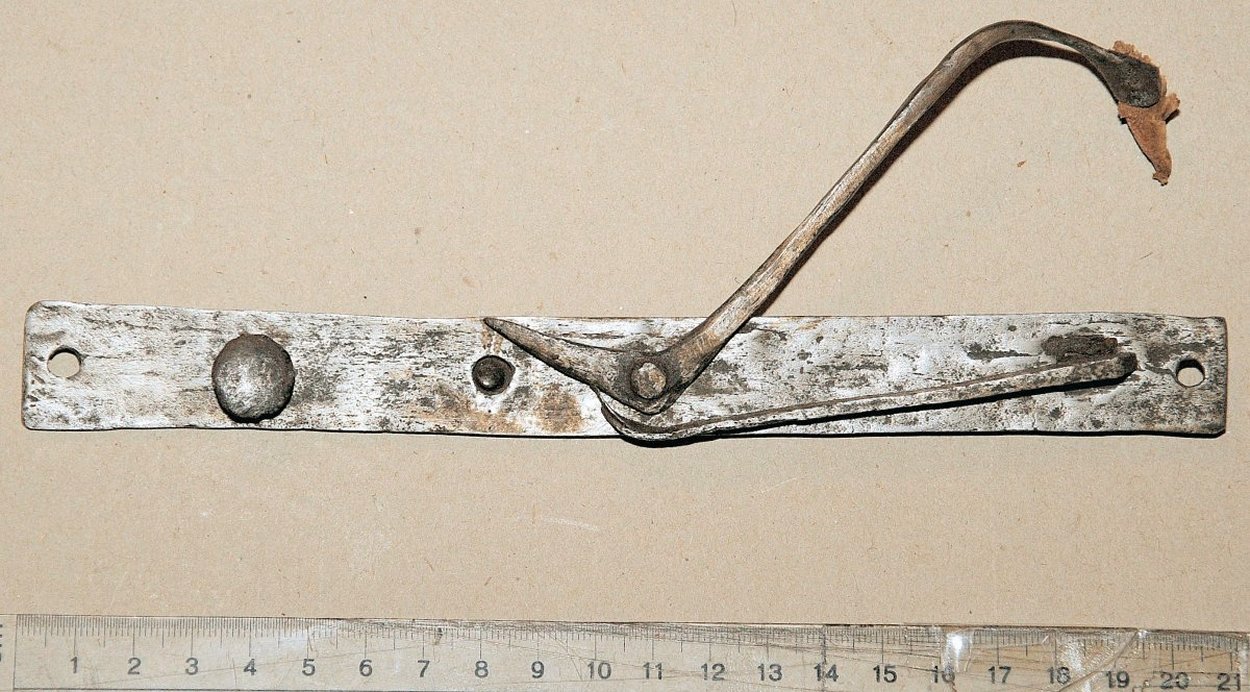

This settled, I should put it straight that the tinderlock doubtlessly was the earliest mechanical ignititing mechanism on any firearm. We have records of period artwork as early as 1411, from Johann Hartlieb's illuminated manuscript on war techniques, Austrian National Library (ÖNB), Vienna, cod.vind. 3069 (attachments #5 and 6).

The tinderlock, mostly used in a snapping version by the early 16th c. - a fine detached mechanism of ca. 1510-15 with lateral push-button trigger is in my collection, see attachments #7 and 8) - , stayed in use at least until the early Thirty Years War in the 1620's but is [B]often found in combination with a wheellock mechanism from 1532 (a dated arquebus in the Musée d'Armes, Liège, attachments at bottom):

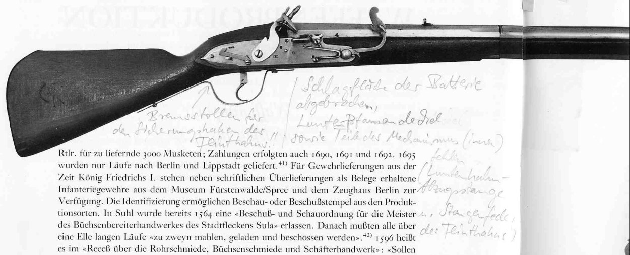

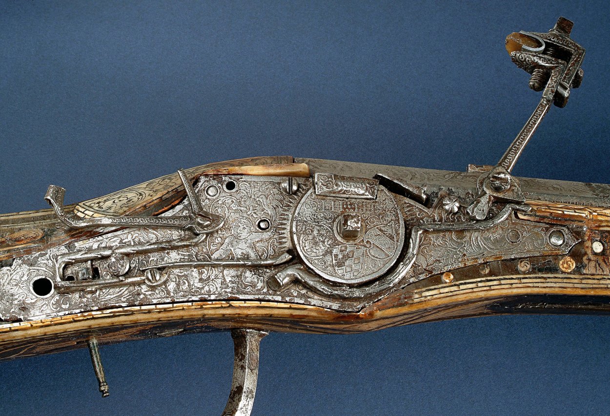

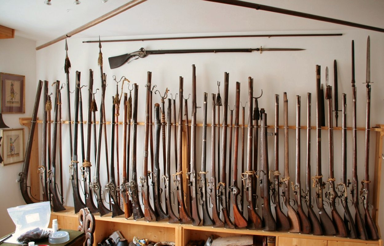

In my collection there are 4 military wheellock muskets (dating of ca. 1590, 1600, 1640 and 1652-3 respectively), 2 combined wheel- and snap-tinderlock muskets (Suhl, dated 1602 and ca. 1660-70 respectively, overview photo attached), plus a number of fine detached wheellock and combined wheel- and snap-tinderlock mechanisms (top attachment, see next follower post).

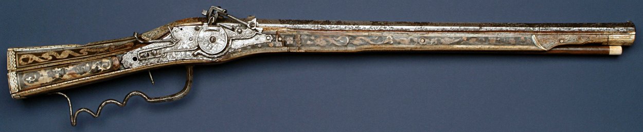

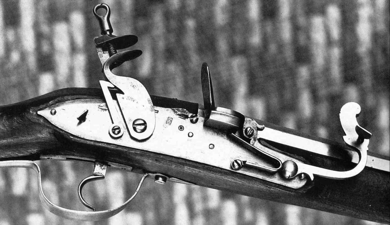

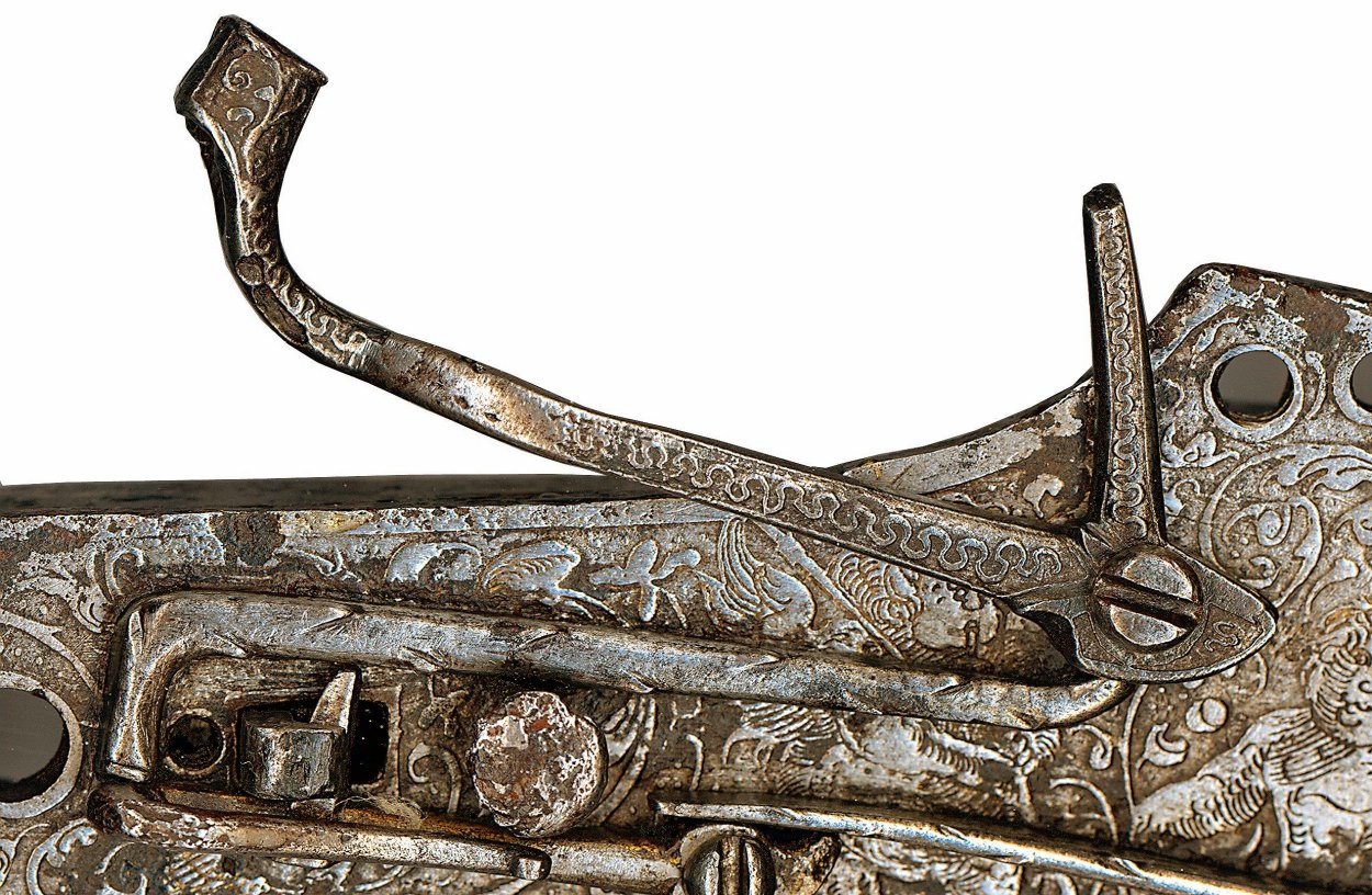

Please see an unusually fine Suhl specimen dated 1602 in my collection (attachments #2 and 3 in next follower post).

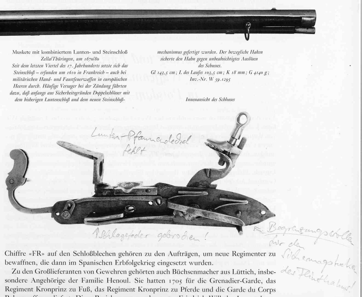

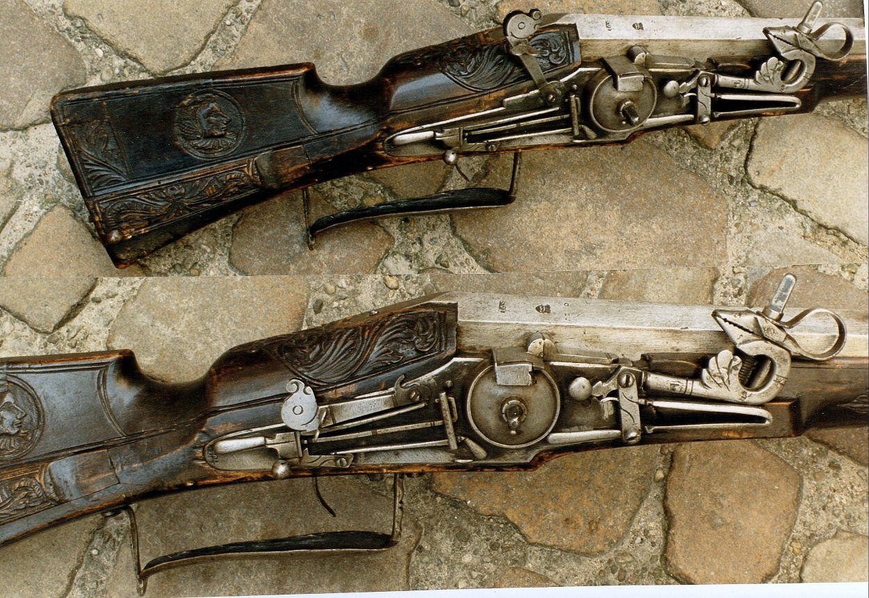

Even as late as ca. 1660-70, the wheellock as the sole ignition system was little trusted and it was combined with a matchlock mechanism activated by the same single trigger and using the same ignition pan and touch hole:
http://www.vikingsword.com/vb/showth...lock+matchlock
Also the first military flintlocks of ca. 1655-70 were little trusted, and they too were combined with the well-established matchlock mechanism.

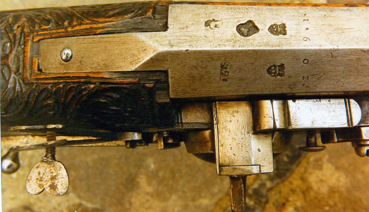

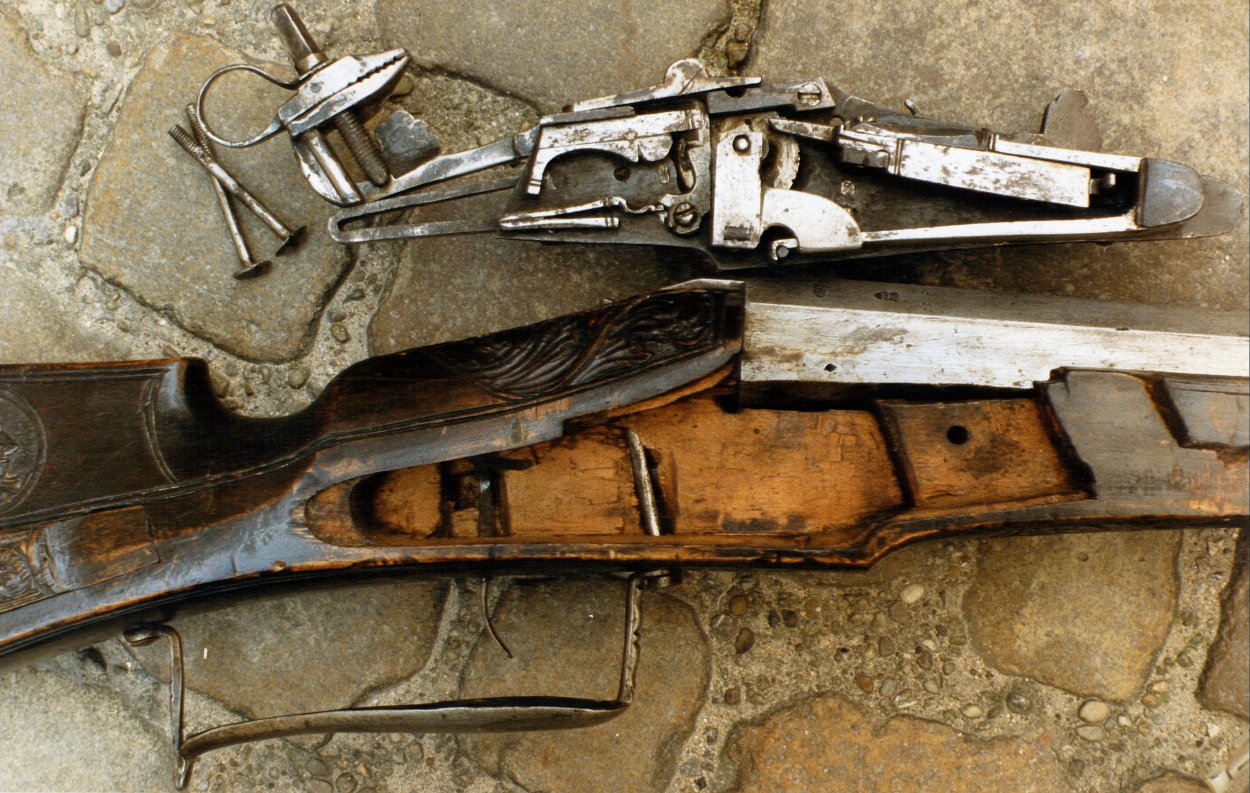

I think that says it all (attachments #4 and 5 in next follower post).
