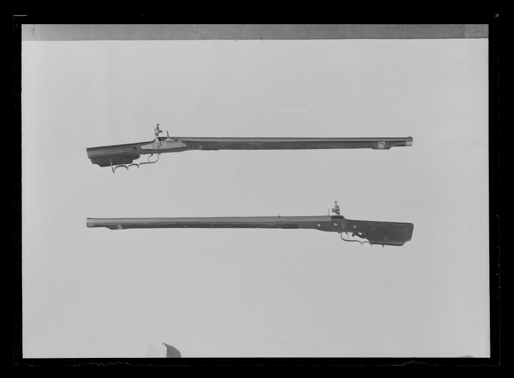

Very interesting flintlock arquebuses from Poland (now in Sweden ). Looted on 30 August 1655 in Warsaw. They are described as haiduk guns. We know that when king John Casimir escaped Warsaw, he left behind one company of musketeers and 100 haiduks on garrison. As the city had almost no fortifications they soon surrender to swedish army. So it is quite possible that those guns are indeed haiduck ones.
They are very interesting as those are clearly soldier guns, not state of the art. Very early soldier guns with true flintlock (in fact I don't know any older army issued true flintlocks).
They are held in Livrustkammern - inventory numbers 3025 and 3026.
Both guns:

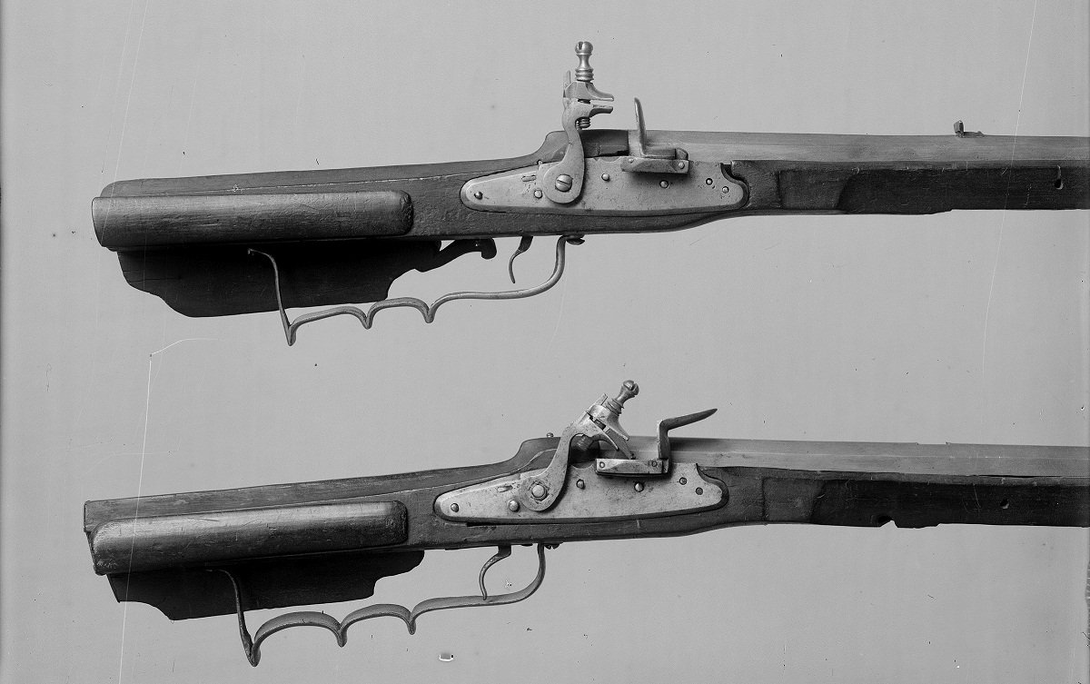

Locks close-up:
