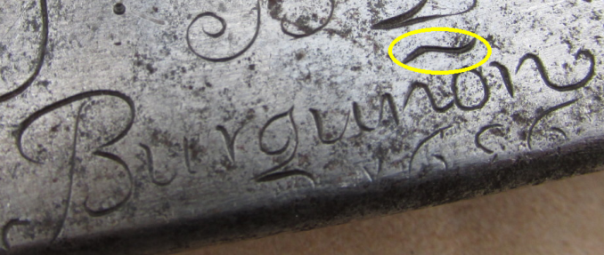

How about BURGUŅON ... Spanish for Bourguignon .
Why not consider that arabesc as a tild accent .

A valid assumption Fernando
Burgundy had a Spanish duke during 31 July 1621 to 17 September 1665 (Phillip VIII).
Louis XIV became king only after 1643 so a Spanish name for Burgundy might very well be the case here. thank you
