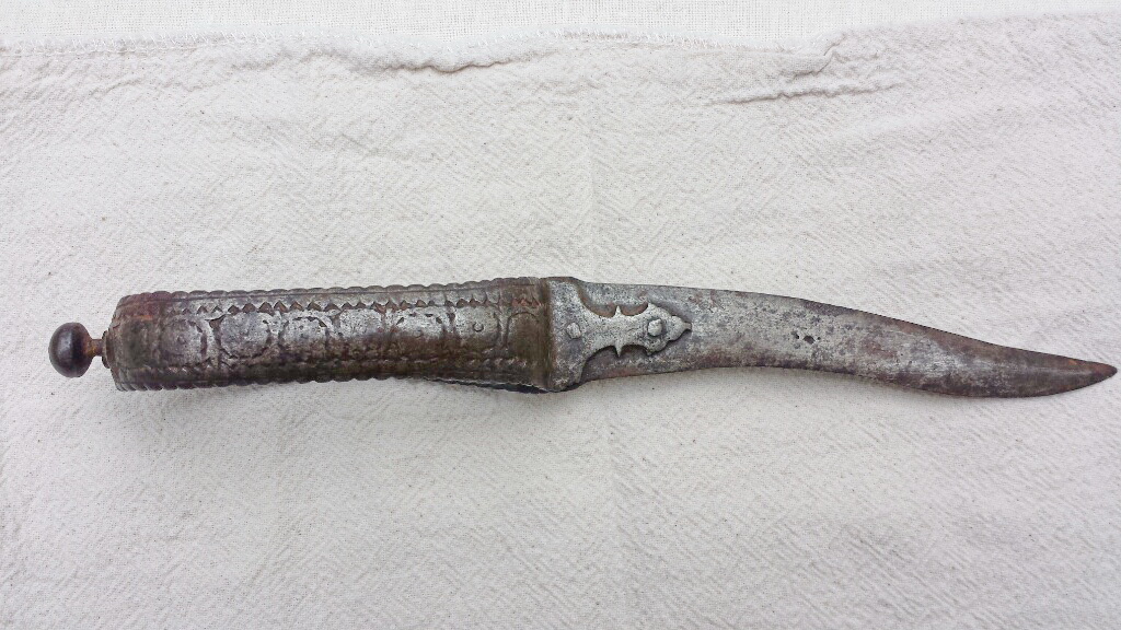

Hi Guys,

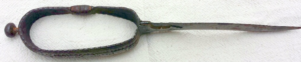

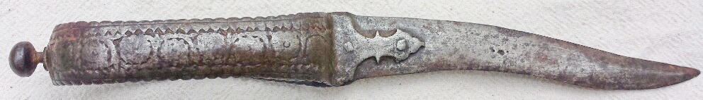

I picked up this Bichwa on eBay late last year, incorrectly listed as a Keris. I have wanted one of these for quite some time. I would appreciate thoughts and opinions about this, particularly if anyone could make a guess as to its age.
Cheesr - Russel

Dimensions:
OAL 240mm
Blade 135mm
Thickness 2.4mm widening to 4.1mm

Hi Russel,
I have tried to make one of you pictures lighter, so it is easier to see the details.
Jens

Thanks Jens, that makes the detail a lot clearer, I must start editing my images a little better.

Russel, a good close up or two of the floral motif and dentated borders on the grip will really help.

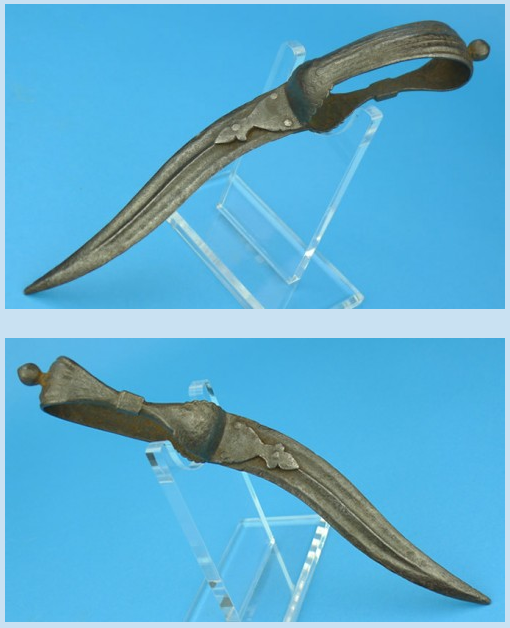

Your bichwa and this one from Runjeet are very similar, to me they have the same blade attachment style as katar labeled as Tanjore. Runjeet described his as
from the 17th or early 18th Century, and probably from the Deccan area of India.

It probably is comparable with Runjeet's example. Details of the decoration will make it possible to confirm it.

Thanks guys, I'll try to post a few better images in the next few days.

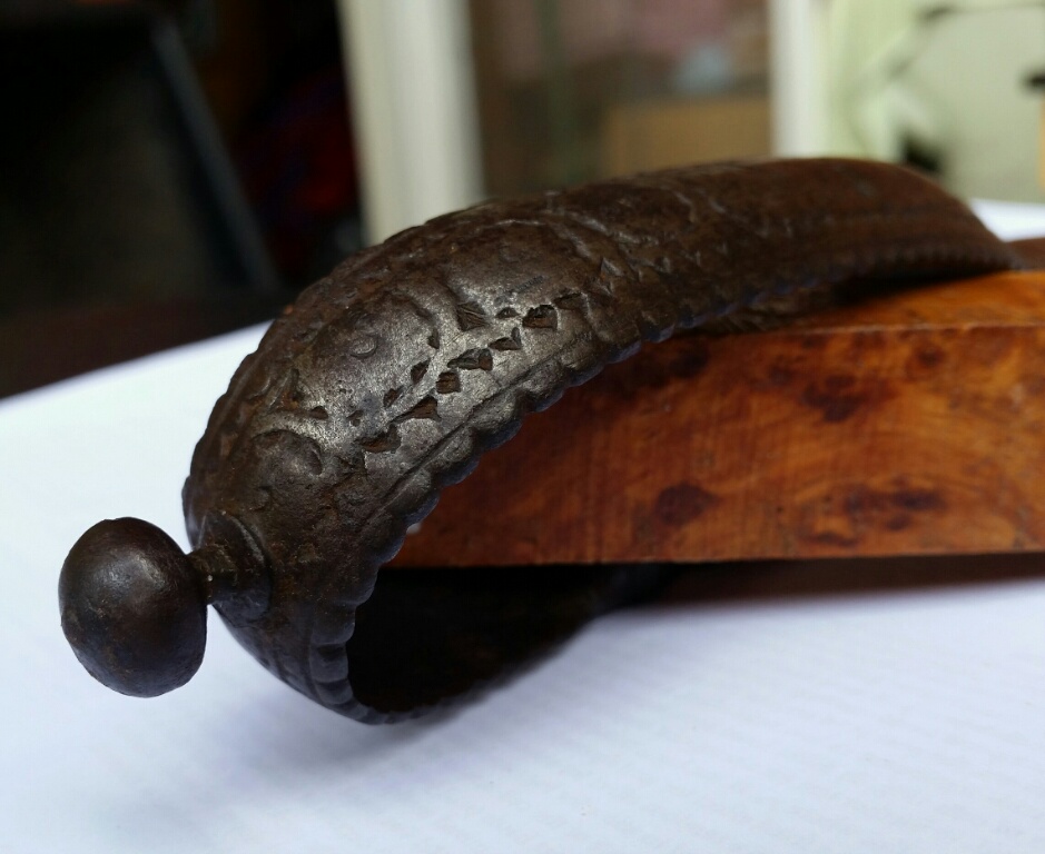

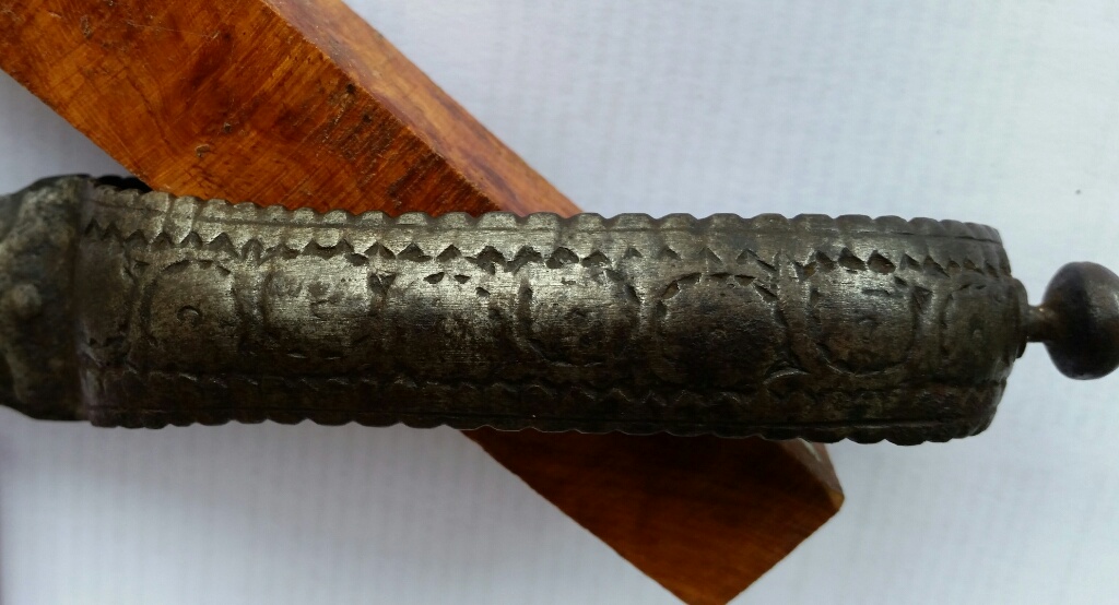

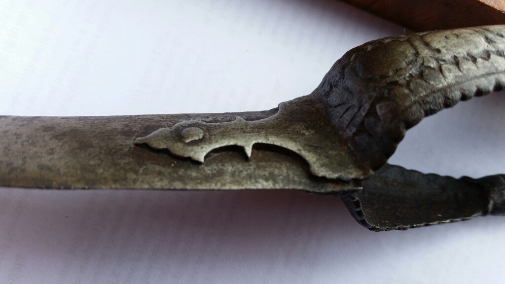

Here are a few more close-up shots.
Old 22nd October 2014, 04:21 PM   #12
Oliver Pinchot
Join Date: Sep 2012
Posts: 468
Good pics, Russel. The motifs are well-chiseled, if worn.
Its origin and dating appear to be comparable with Runjeet's.

Thanks guys,
Great to read your assessment. That makes this little beast almost certainly the oldest item in my collection! I was quite sure it had some age to it, but I imagined early 19th Century, I certainly didn't think it may be as old as 17th Century!
I have read that Bichwa fell out of favour and become somewhat uncommon, does anyone have any thoughts on what was the predominant period of use of these?
