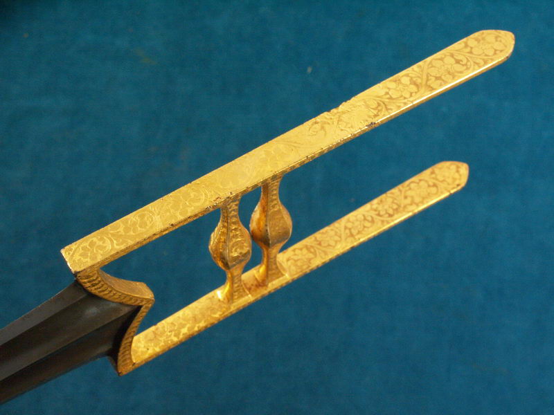

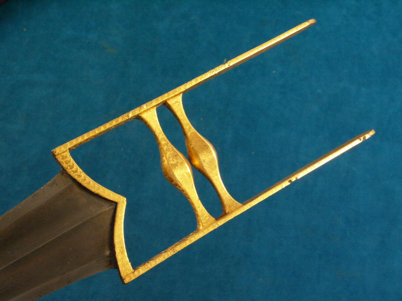

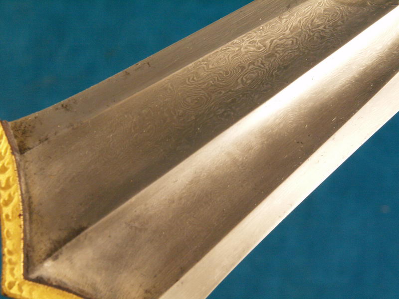

Indian weapons are a bit outside my main interests, but I really liked this katar. I know very little about it and katars in general. Per Pant, it would appear that the correct name is jamadhar, but katar seems to have become the accepted term among collectors, so I am sticking with it. My guess is that my is from Northern India, Rajasthan perhaps? It has a wootz blade (always hard to photograph for me), and a hilt with gold koftgari decoration. Unfortunately, the hilt is in rough shape, with losses to the koftgari. There is an inscription below the guard, but I doubt anyone would be able to read it as it appears some of it has been erased. The scabbard is missing the chape, but at least it looks like it is the original scabbard.
Can the Indian weapons experts venture a guess on age (mine would be early 19th century) and area of origin?
Thank you,
Teodor

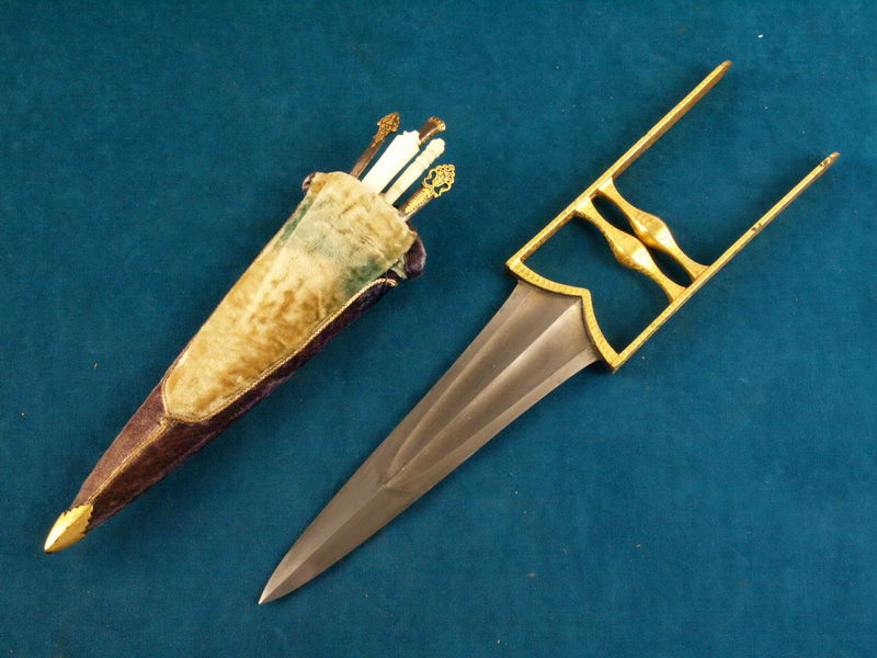

Posts: 80

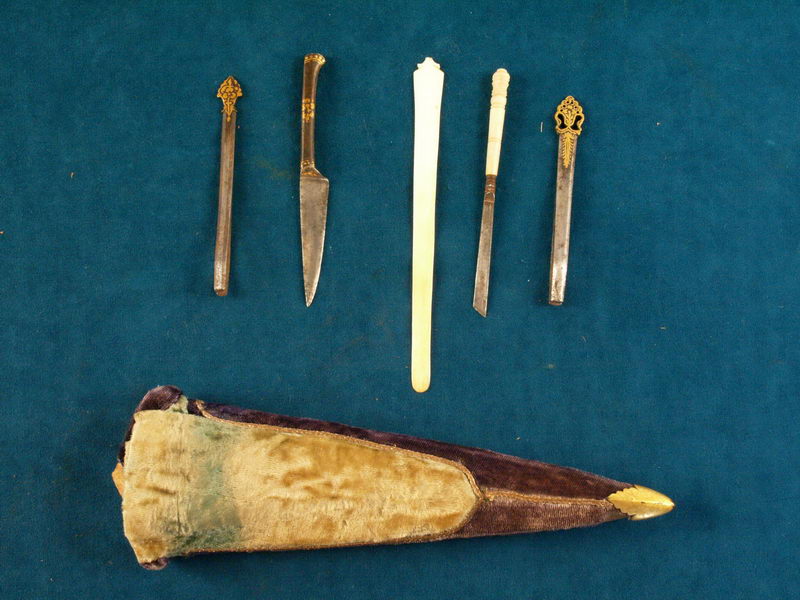

I would agree with a 19th C. dating, possibly earlier. It's quite uncommon to find one with Devangari writing in koftgari, which yours appears to have remnants of. The form and shape are similar to one I had a few years back. I would imagine they would be more likely to be from a similar area. The tools on the one that I had were overlaid in a very similar style koftgari.

Thank you ArmsAndAntiques, the example you show, while much finer than mine, is very similar in form. Interesting to see all the utensils as well.
