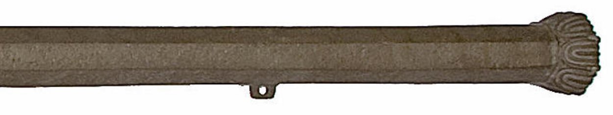

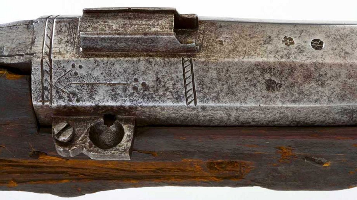

I found this hackbut barrel at a old auction, it is claimed to be 15th century but i found a similair one at Hermann Historica auction 62/63 lot 14. the one at Herman Historica is dated 17th century and French.
I am confused, 2 century's is quit a big range

Hi Marcus,
Thanks for sharing but: what auction is this from?
And this matchlock petronel: http://www.vikingsword.com/vb/showth...169#post164169

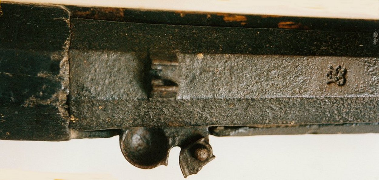

This hackbut/haquebut barrel you posted, on the grounds of its general shape and some clear formal criteria, can be safely dated to ca. 1530-40 and is, in all probability, neither of Nuremberg nor Augsburg nor Italian make but possibly Swiss, French or Netherlandish.
The dating criteria are: of rounded shape throughout, no clear sectioning except for the muzzle, small square backsight at the extreme base of the barrel, elongated, swamped and round muzzle section with roped freeze and square muzzle (often found on barrels from the Netherlands), bead foresight, long and slender hook and small right-hand side ignition pan, the pivoted swiveling pan cover now missing.
On the underside of the rear barrel base there ought to be (or may be missing) a round loop for a transversal stock pin; the other, forward pin went thru the hole in the hook.

Hi Michael,
A thousand thanks, the barrel was still for sale apparantly but doublled in price since the last auction
This one can be found at the 40th auction of Czerny's auction house. A very nice auction house, it sold the Matchlock rifle i showed earlier just a few weeks ago as well.

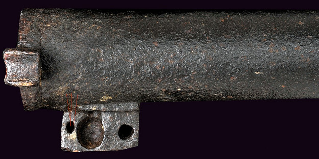

Here is a postscript to my comment on that haquebut barrel:
I just noticed that a former fire shield is most probably missing from the pan as well. The left hole must have been meant for it, and it must have been riveted where I marked the spot in red. The hole to the right of the pan trough was for the riveted pivot of the missing, formerly swiveling pan cover.
As there obviously was no side view provided by the auction house I cannot tell whether the rear loop is still there or not.

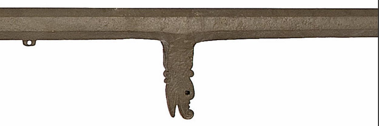

This wall hook should actually not be called 'rectangular'; it's rather rounded, basically very much like the one on that Czerny's barrel, and figured as a sea monster.
As I have tried to state several times, the earliest - and actually rectangular - wall hooks on barrels seem to have appeared in ca. 1430; they evolved a certain degree of staging after ca. 1450, and after ca. 1510-15 they seem to have taken on rounded (Renaissance-type) shapes.
Wall hooks had normally disappeared by ca. 1600 but are found as late as the second half of the 18th c. (!!!) on special types of wallgun barrels.

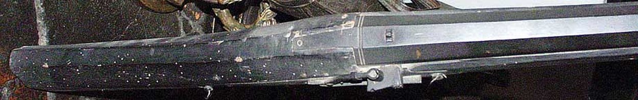

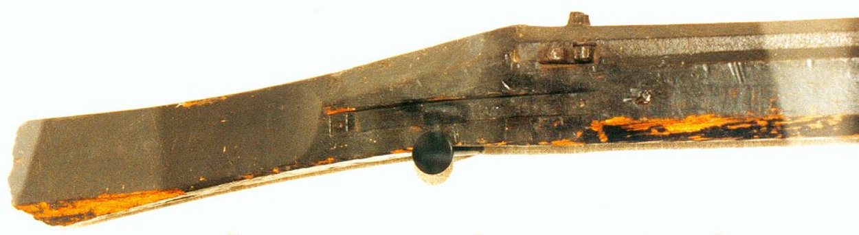

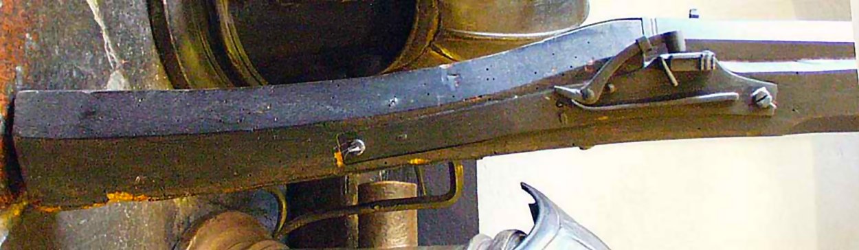

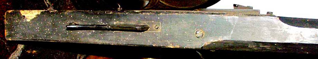

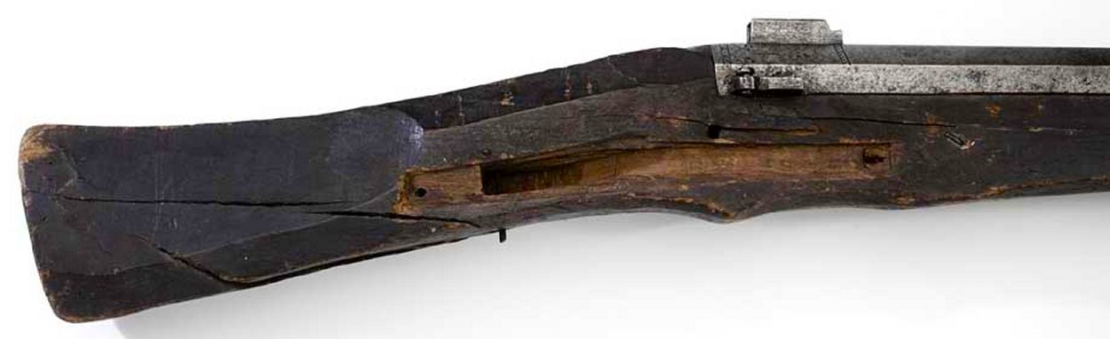

Default A Good Nuremberg Hackbut, ca. 1540, in the Army Museum Stockholm

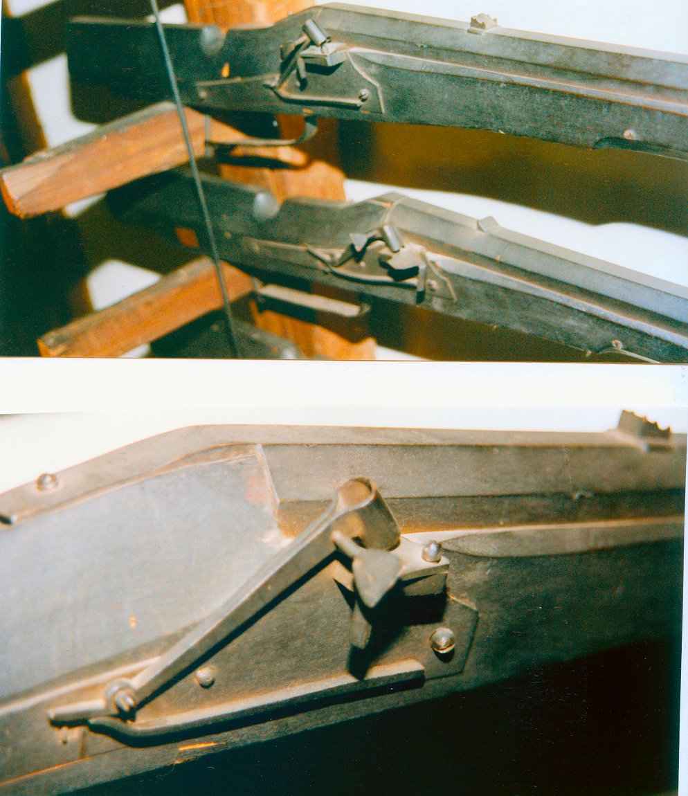

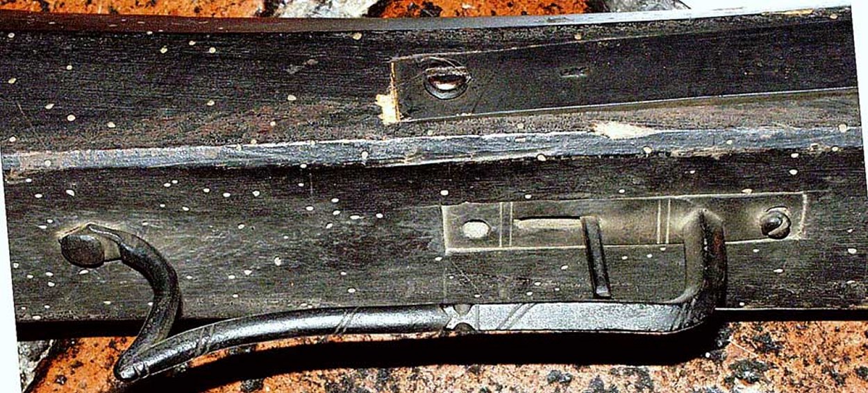

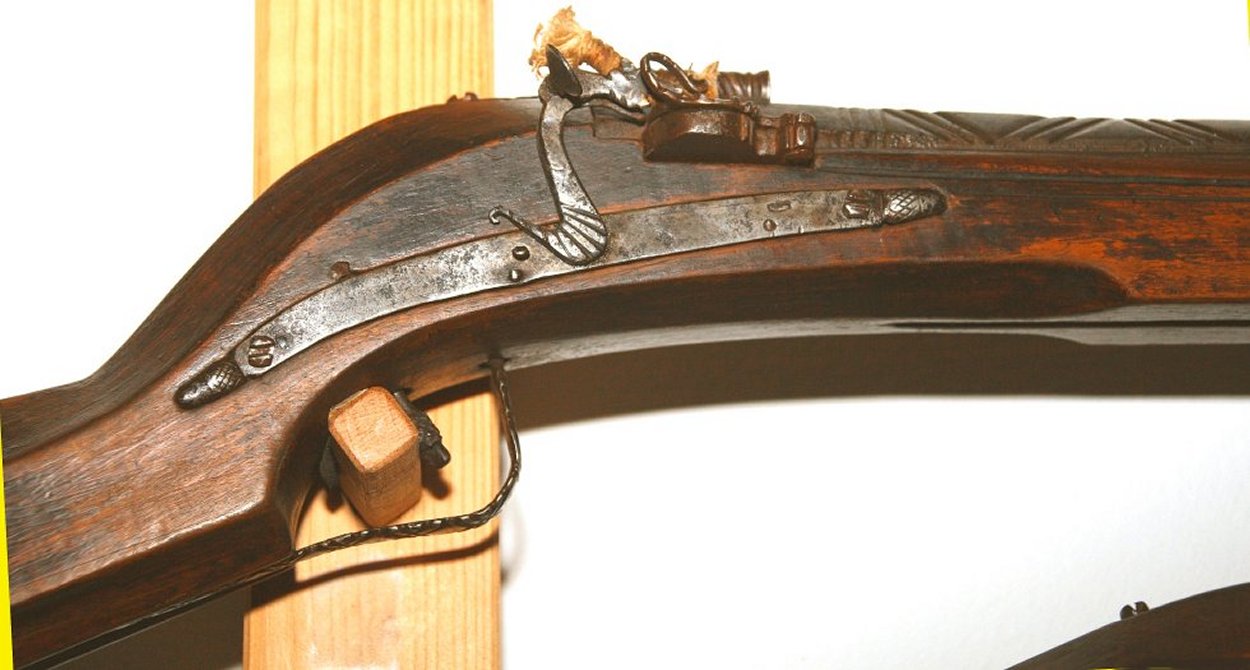

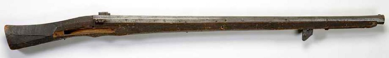

Although the snap tinderlock and swiveling pan cover are missing, the finely preserved lime wood or pear wood full stock will convey a good impression of what such pieces would look like when complete.
The second, the blackened fir wood (!) stock heavily wormed, dry rotten and probably not to be saved, the lock mechanism also missing, I photographed in the famous Oberhausmuseum Passau, Lower Bavaria, a bit over 100 km east of where I live.
Regarding the stock, I must add that I offered them to consolidate and conserve it right at my first visit there some 35 years ago. They did not show the least interest though I warned them that it would dissolve before their very eyes. When I got there again a few years later, they had soaked it in crude linseed oil thru and thru, resulting in severe wood losses. That was a final treatment, nothing can be done about it any more. All it is now is a sticky, almost amorphous mass. I would have given that stock hundreds of injections of a hot watery solution of bone glue for days and weeks, and the surface would have been unharmed and unchanged. Museums ...
Anyway, you remember I hold some fine Nuremberg hagbut/haquebut/hackbut barrels coming from that museum during WW II in my collection.

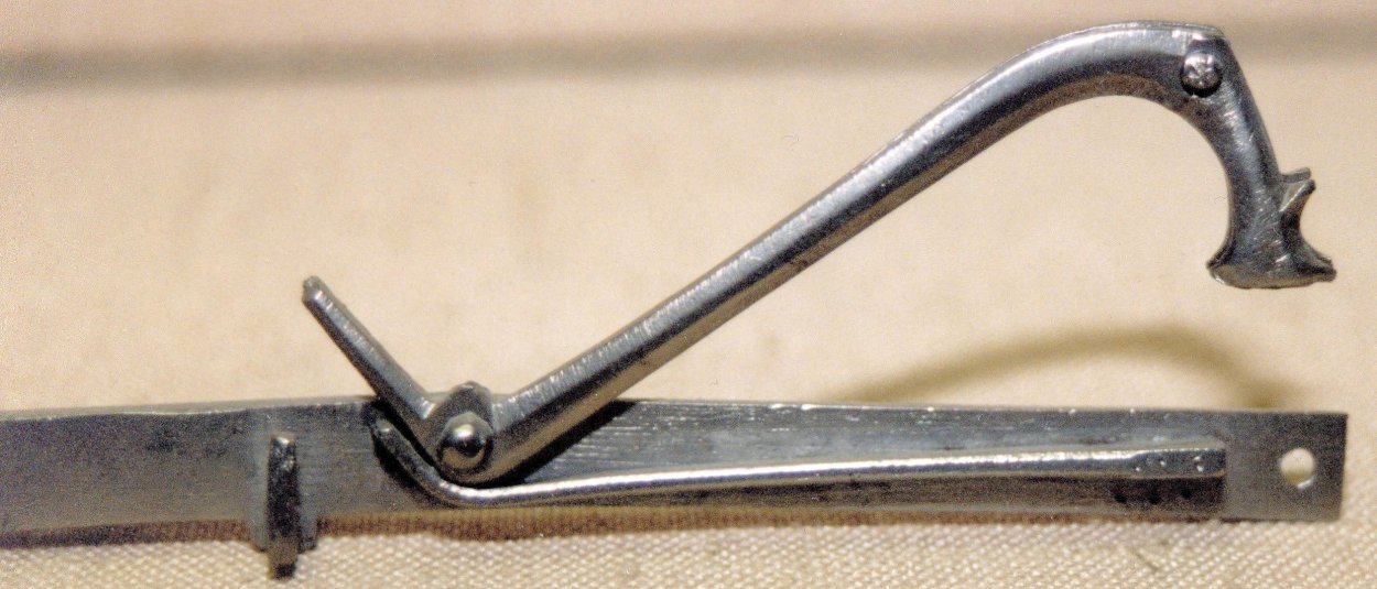

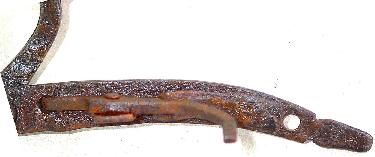

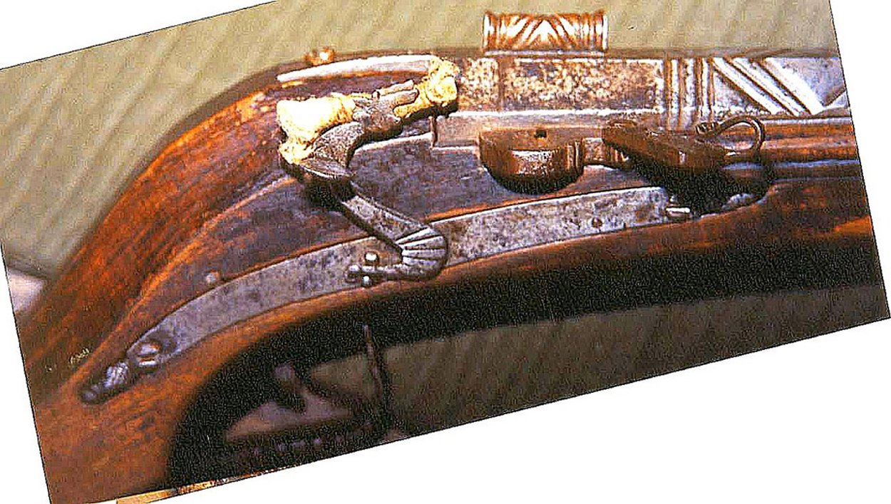

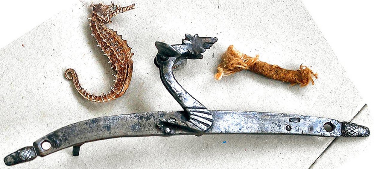

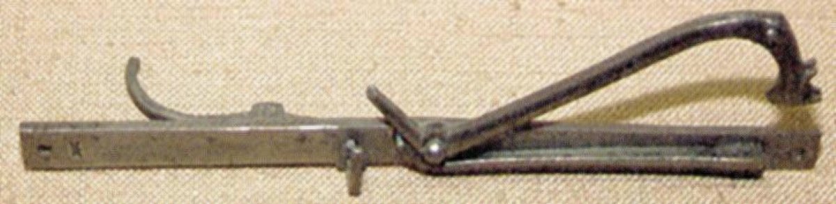

Also attached find a snap tinderlock, Nuremberg, ca. 1540, made by Hans Koler (the hourglass mark should be attributed to him), of exactly the type missing from the Stockholm and Passau pieces. The wing nut is missing from the serpentine. That lock is preserved in the Bavarian Army Museum Ingolstadt, 30 km from my home; it belongs to an arquebus of ca. 1540, the barrel marked by Hans Mörl, who shared a workshop with Hans Koler in 1537. The museum staff do not realize (or even believe) that the mechanism belongs to the gun ...

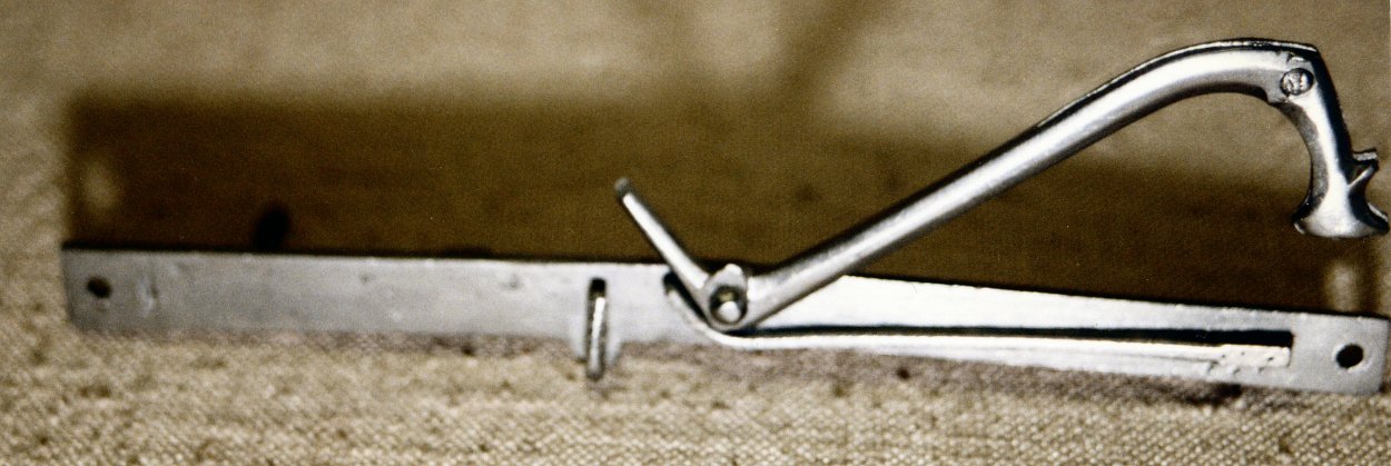

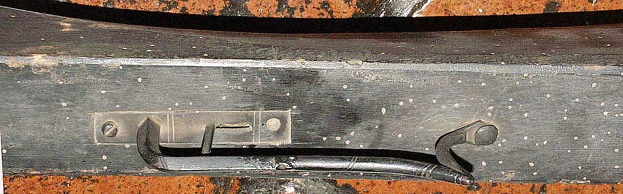

The snap tinderlock mechanism.

Thanks Michael,
Do you also have a picture of the inside of this mechanism?
I imagine a spring on top holding the sear in place rather than underneath the sear like those in other matchlocks?
edit:
O wait, i already see the spring attachement inside the lockplate on one of your pictures. The spring was situated underneath the sear, only at the other side of the pivoting point (i think?)

No, Marcus,
If I had one I had posted it, it is in a class case that the BAM will open for nobody. But from what I can see the spring must be located under the sear, just like on a wheellock mechanism. Your editing thought was pefectly right!
I attach images of the similarly construed lock of my Tusco-Emilian (Brescia) snap-tinderlock arquebus of ca. 1525-30, the serpentine shaped as a seahorse.

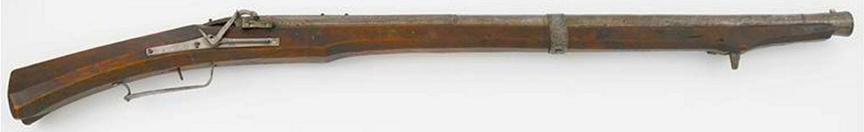

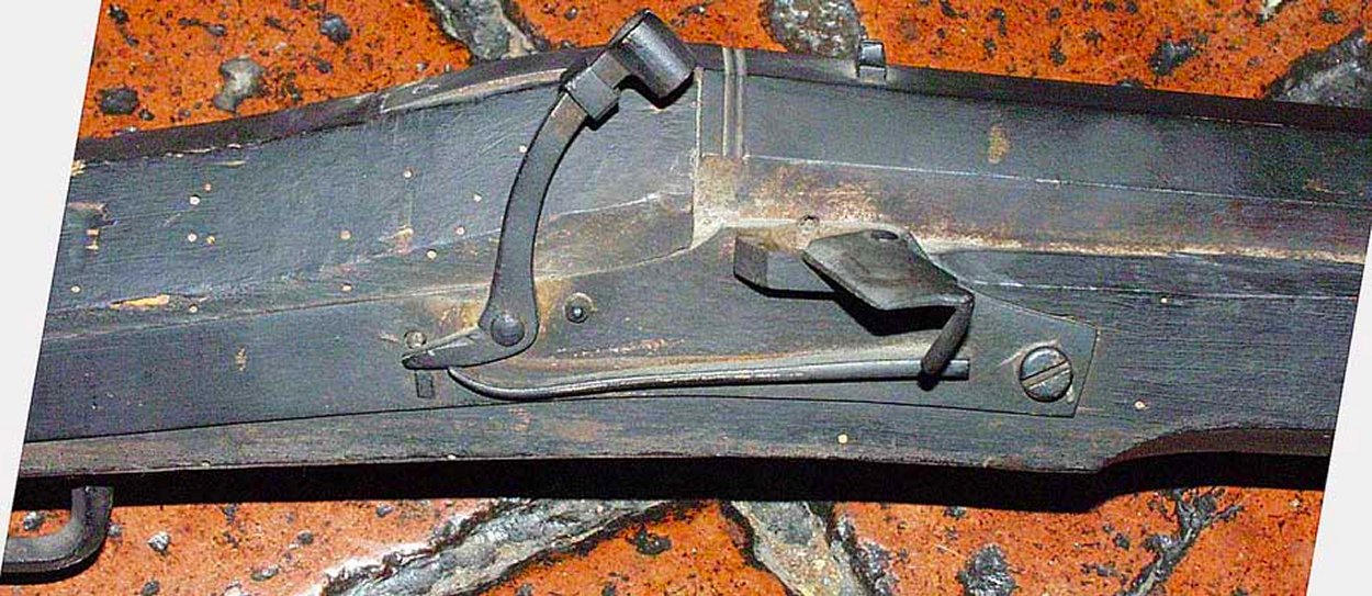

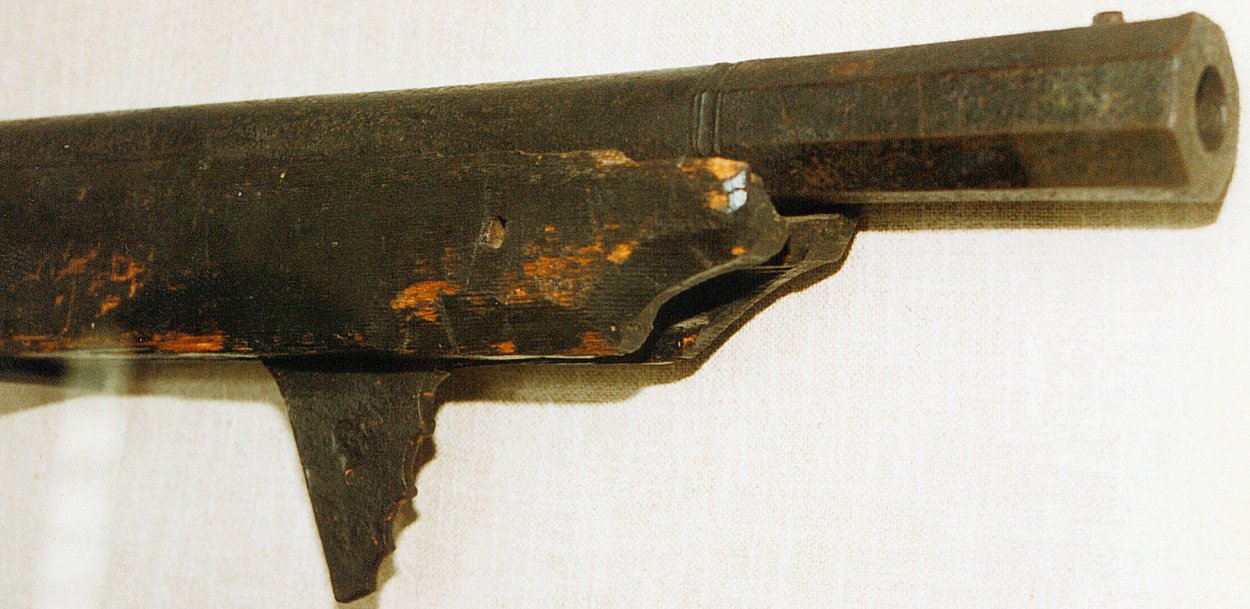

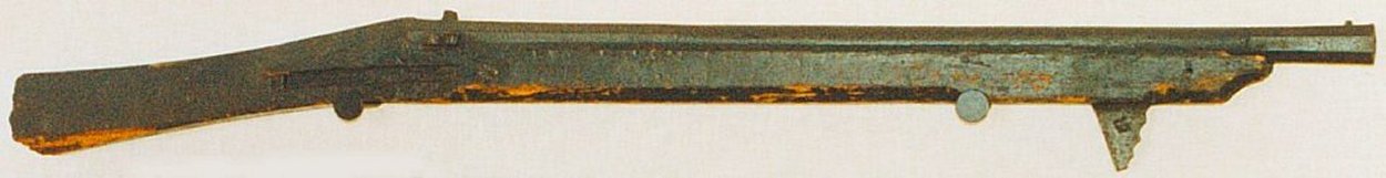

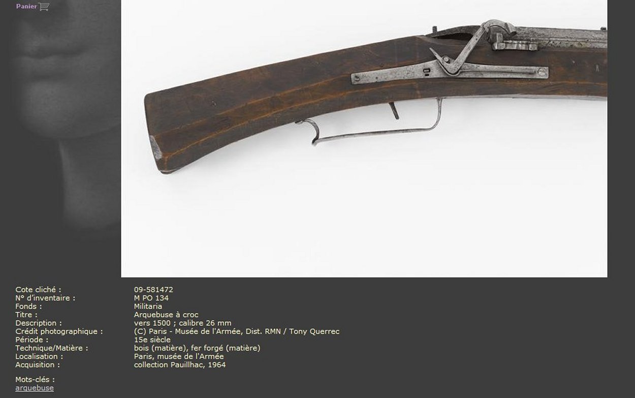

The Musée de l'Armée in Paris holds this perfectly preserved specimen of a Nuremberg hackbut of ca. 1535-40, complete in all its original parts; it was never fitted with a ramrod.
You can see how close I got to the original by choosing the Ingolstadt lock mechanism as an adequate association. Interestingly, the tinderholder on the Paris piece is a movable clamp, instead of a wing nut.

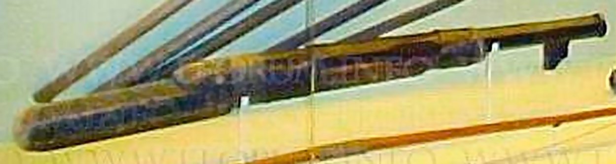

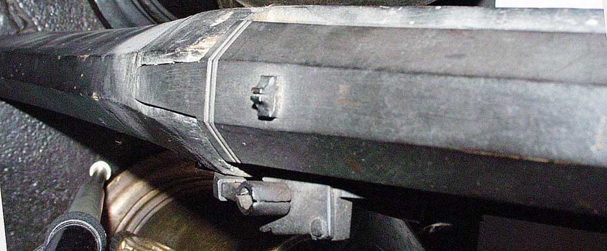

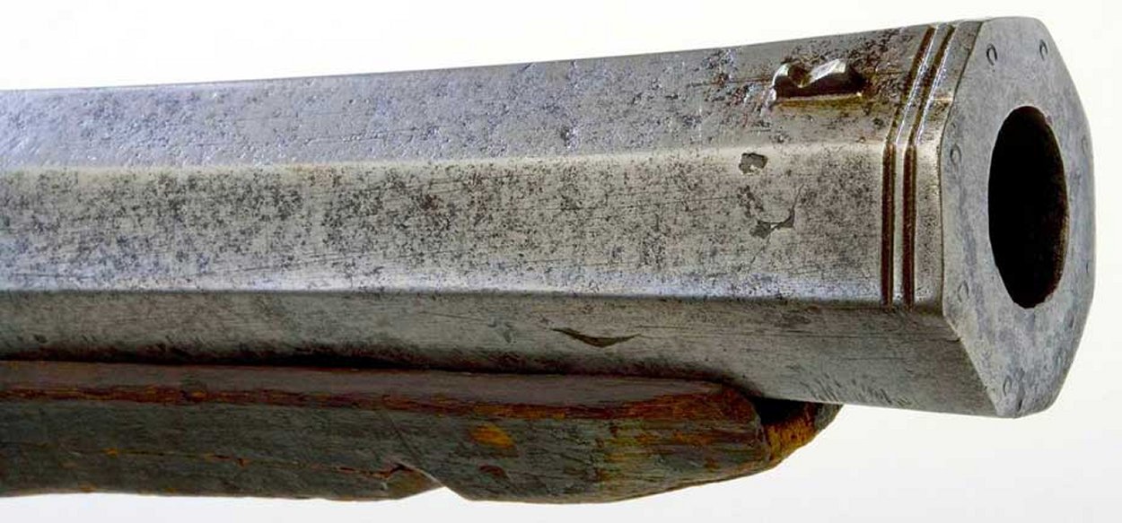

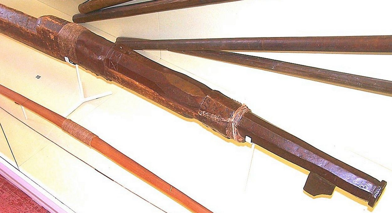

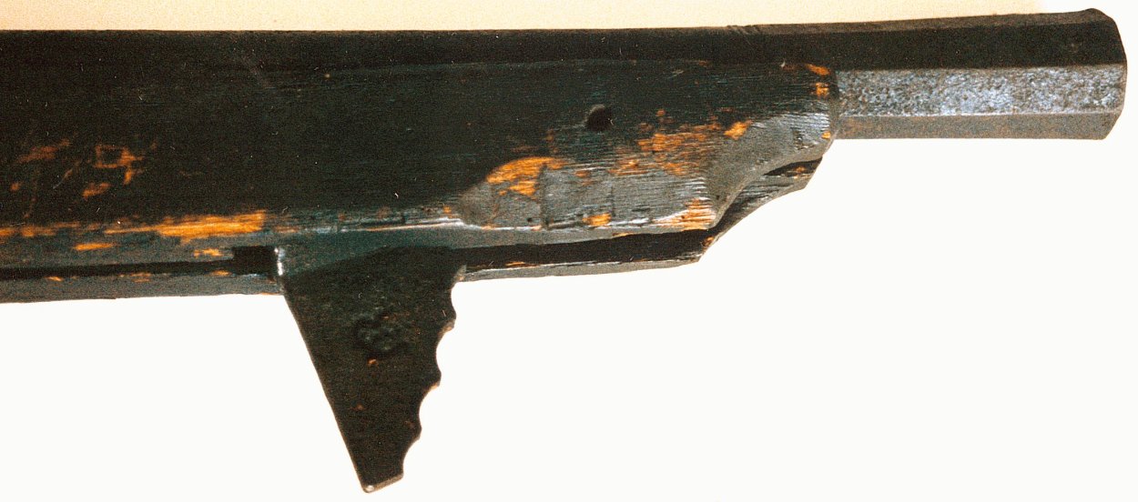

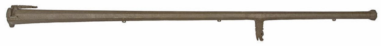

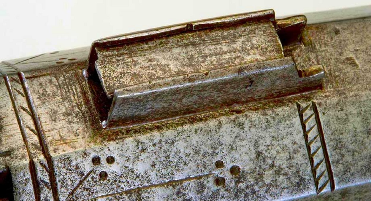

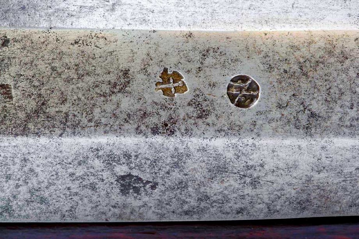

An early hackbut with unusually finely preserved three-stage wrought-iron octagonal barrel, ca. 1460-70, at the museum of Granson castle, Switzerland. It retains its original stock but never had a lock mechanism.
m

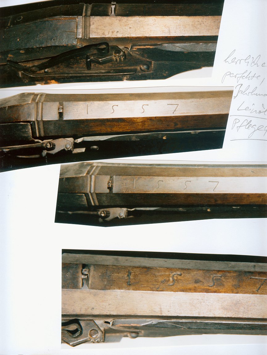

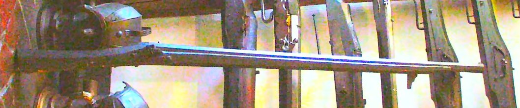

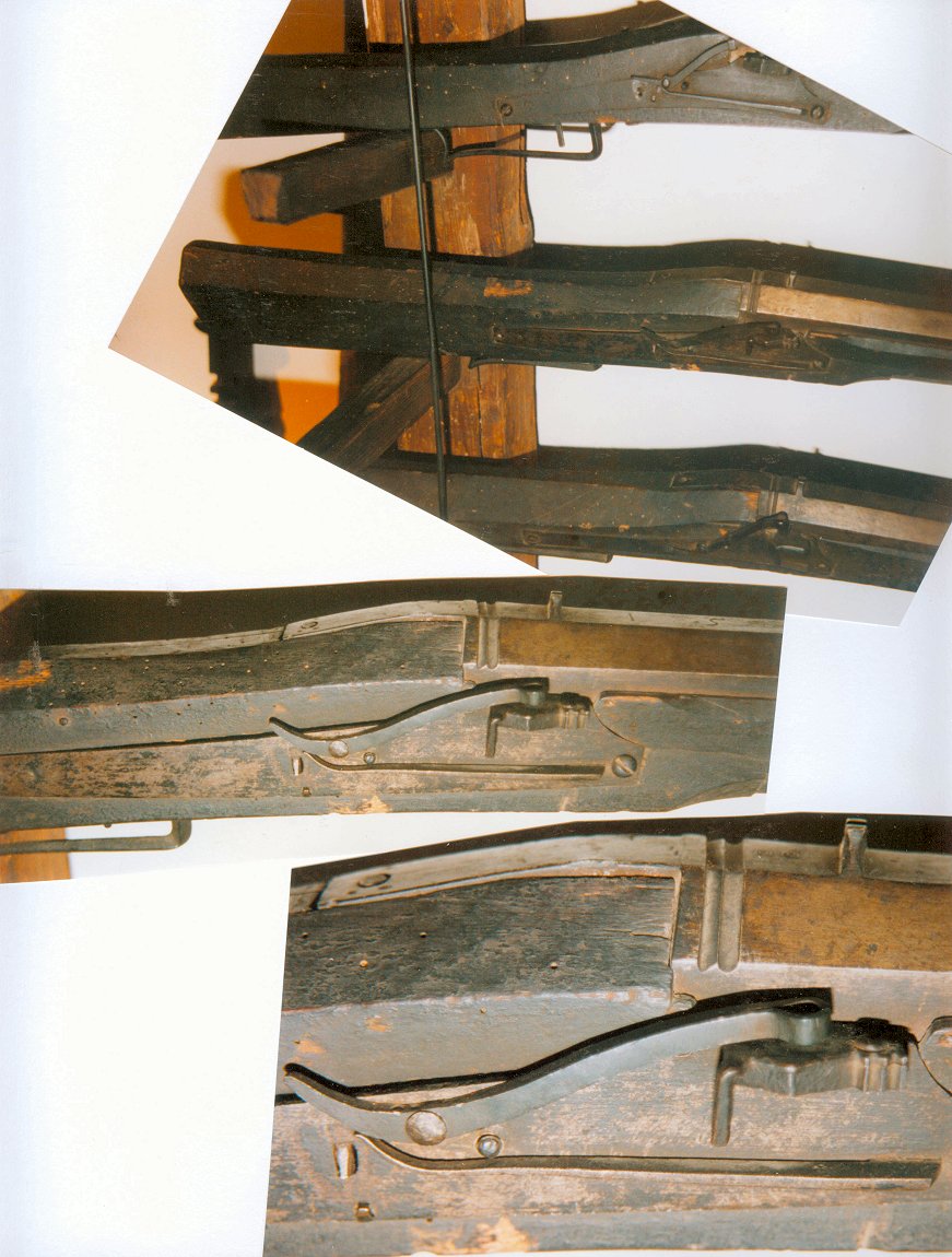

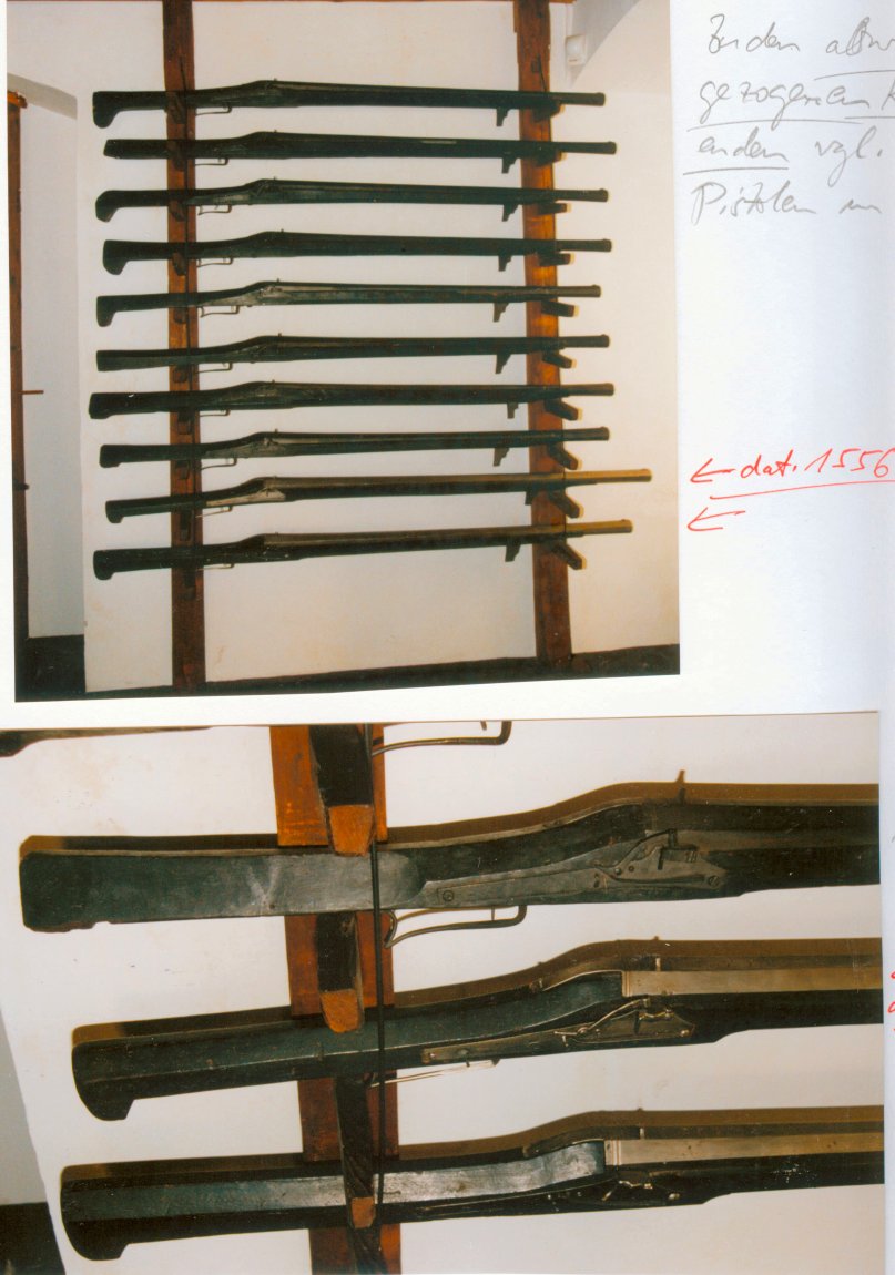

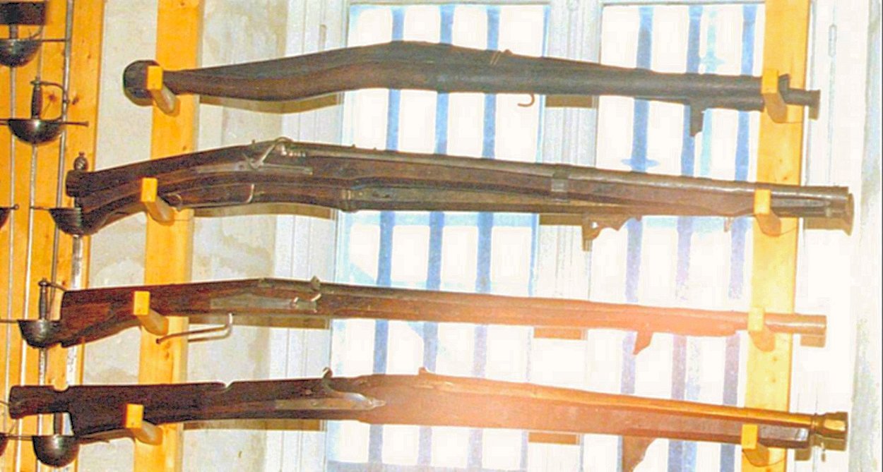

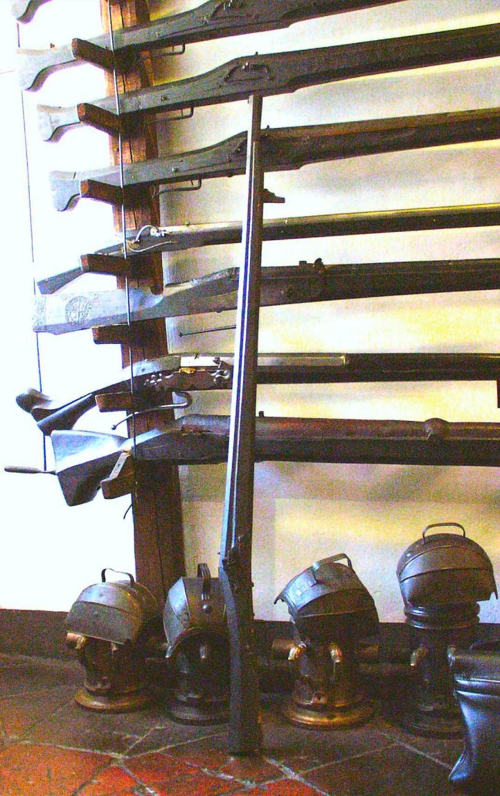

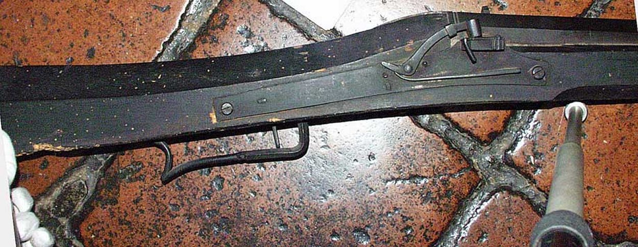

Default Completely Preserved Tinderlock Hackbuts of the 1550's in the Landszeughaus Graz
Most barrels from this series are dated, the earliest year being 1554; one of the most common dates, i.e. when especially many pieces were bought from the gunmakers, was 1557, but years of the 1560's until as late as 1587 are also to be found.
The highly figured, blackened full stocks are of pearwood (!), which is highly unusual for large and heavy pieces, and fitted mostly with snapping tinderlock mechanisms, their main springs mounted on the outside of the lock plate, and fitted with a provision against cocking the tinderholder too far.
Many of the tinderholders are fitted with a wing nut but mostly just a movable clamp is employed.
In my collection there is a good, detached barrel dated 1557 from that Graz series, preserved in all its virtually 'untouched' patina.
m
Old 2nd January 2014, 11:18 AM   #24
Matchlock
Matchlock's Avatar
Join Date: Sep 2008
Posts: 4,310
Four more.
m
