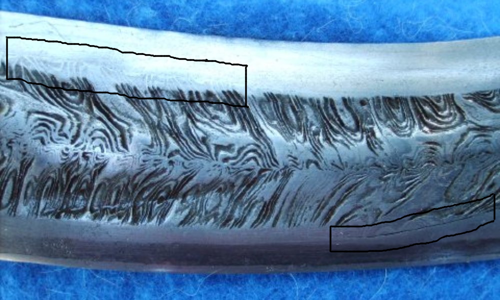

Dave:
I will give it another try and be more explicite, as I see, this question really bothers you.
There are very rare twistcore krisses, where the pattern and welding are so perfectly done you can't tell difference between a pattern created by simple etching or a real pamor at first glance. I very much like your kris, Dave, yet it doesn't belong to this category.
Please take a look to the picture below: the marked area on the left side clearly shows the twisted bar leaving the topographically etched middle fuller. Actually the Pamor here is very clear, despite the polished surface.
The marked area on the right side shows a forging flaw, which is where the twisted bar meets the core. The welding failed here.
I don't understand very well, what do you mean by the sentence:
"I have used a high magnification lens and examined the valleys made
by the etch. I see no evidence of nickel pamor at the bottom of these
valleys."
I understand it like the bottom here is without any pamor activity. I don't recognise these places to a sufficient extent on the pictures, yet these most probably would be the places where the twisted bar has been forged or chiseled or etched through and the core has been exposed.
Actually for this information you don't need a blacksmith, becouse this is ABC if you really are interested in pamor techniques. By chance I have had conversations on the matter of pattern welding with a smith, who is quite well versed in twistcore techniques.
To recapitulate the forging&topographical etching matter: the sentences regarding topographical etching from the book of Newbold are handling exactly this subject. The pattern welding technique with subsequent topographical etching (including wax reserve) absolutely isn't something unusual and rare, not only in Philippines and not only in SEAsia.
Gustav

Gustav: In your closeup pictures i can now see where the nickel threads
disapper into the deep etch. In fact it is easier to see this in your
pictures than when the kris is in my hand. I now have a bit better
understanding of how this technique could have been done rather
than just guessing. We have something like 15 or so twist-cores
in our collection and when i get the chance i will post some of the
others. Thanks again for being patient with my questions....Dave.

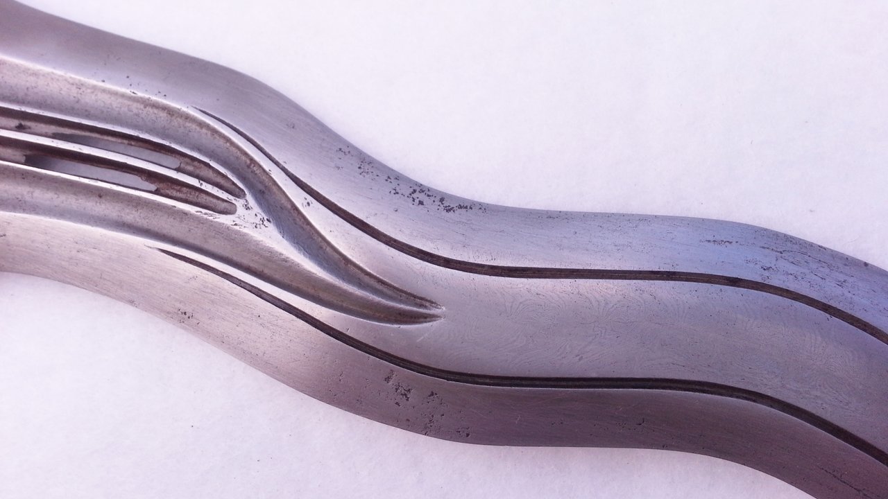

Gustav,
Thank you for a very clear explanation on this subject. on this statement though:
i've attached a couple of twistcore pictures below. is that what you're talking about, or if not, would you happen to have a picture/pictures of it?
kind regards

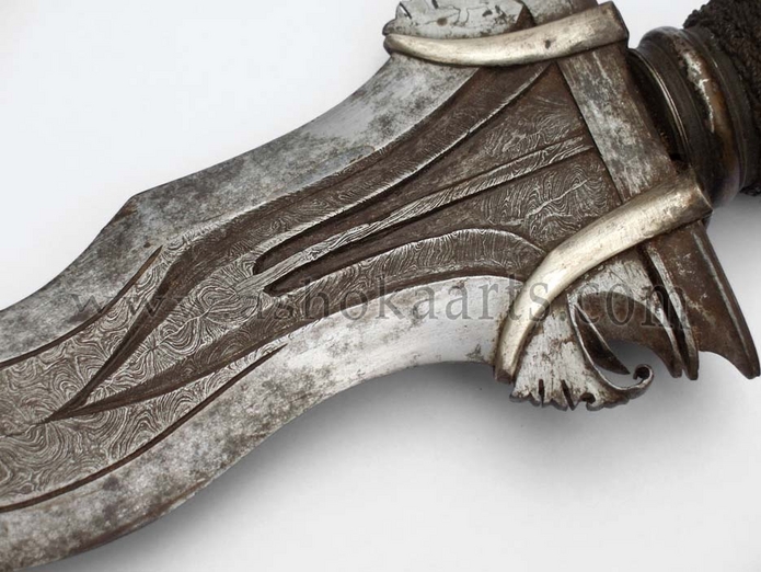

Ron,
indeed a very fine example of a twistcore! Iron must be of very good quality to allow such fine texture without any blowholes, caused by impurities and air pockets. The torsion of both bars has to have almost the same frequency to become the pattern almost symmetrical as it is in this case, the welding in areas depicted is very near to perfect.
Becouse of the theme of this thread I thought more of examples, where the central twistcore panel is etched. I have found three examples in the Forum, yet there should be more perhaps:
http://www.vikingsword.com/vb/showthread.php?t=798
http://www.vikingsword.com/vb/showthread.php?t=1267
yet especially this one:
http://www.vikingsword.com/vb/showthread.php?t=8641, #19 and 28. Even more impressive in pictures from Ashoka arts.
Actually you (almost) always see the difference between real Pamor and an etched one at the base of blade, and even more in area, where the twisted bar ends. To control a Pamor near the tip of the blade is the most difficult part.
Kind regards,
