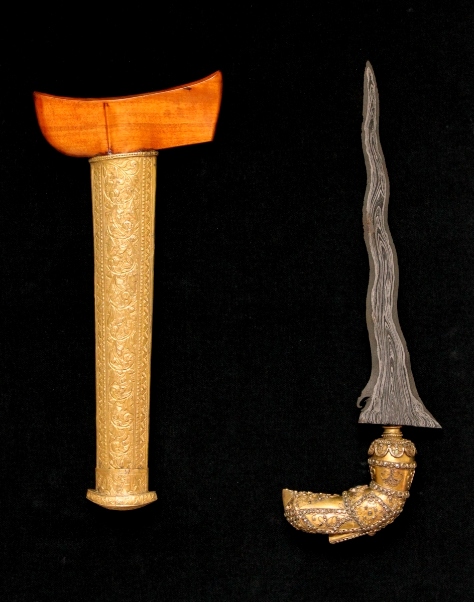

Dear forumites,
I own a number of small krisses from Sumatra (blade lenght less than about 10 inches or 25 cm excluding the peksi). All of them look original with one possible exception, and I would like to know for whom these pieces were made (women or children?). Your input will be welcome.
Their descripion is as follows from top to bottom of the pictures:
. Kris from Centre Sumatra?, blade lenght 19.5 cm
. Kris Minangkabau, blade lenght 21 cm
. Kris bahari, blade lenght 25 cm (possibly shortened)
. Kris Bugis East Sumatra, blade lenght 23 cm
. Kris from South Sumatra, blade lenght 22 cm
. Kris from South Sumatra?, blade lenght 24.5 cm
. Kris from East Sumatra?, blade lenght 24 cm
Thanks in advance and regards

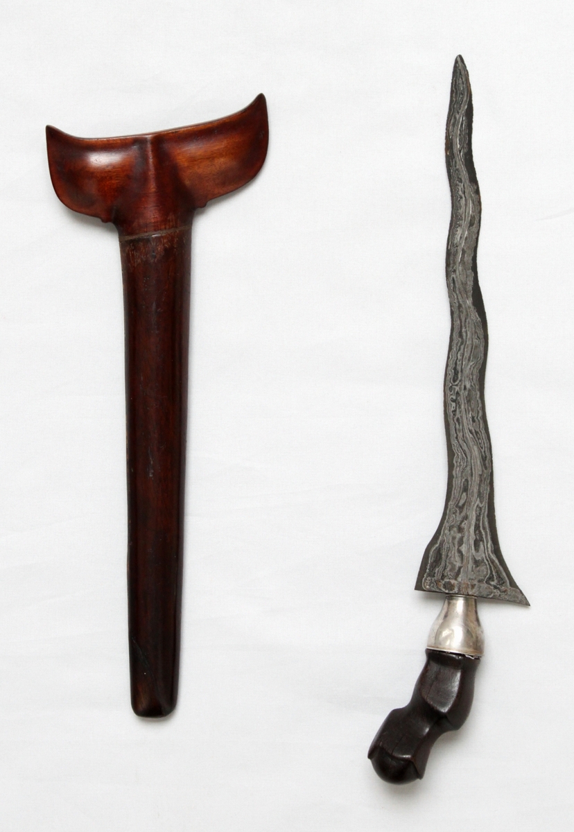

Additional pics

A nice collection of patrems. I especially like the first two. For some reason i really like this type of keris.
Forgive my ignorance here, but i have found so little written on these little blades. Is there a tradition in place of actually giving small keris to young children. Given one of it's traits as being a symbol of manhood that would seem odd to me. I would think it more likely that a boy would not receive a keris until he becomes a man, at which point it would seem an insult to present him with a purposefully smaller blade. Of course that goes right out the window with the idea of a keris for a woman, but at least these are adult women. It has been suggested to me in the past the the patrem is reserved for woman of a certain higher status (perhaps why we don't see a ton of them). Since i am interested in them and own more than a few myself i would be really interested in what anyone might have to add about the cultural application of the patrem.

When I look at these pretty little keris that you have shown, I cannot help but feel that I am looking at something that has male essence. I would not expect such exuberance in a female keris.
I think i do understand what you mean here Alan. I have a number of patrem in my collection and have noticed that they do tend towards a less exuberant presence then most of these.
Do you have any comment on the notion that small keris may have been produced for young boys? This still seems unlikely to me given the nature of keris, but no one has yet to comment on this idea and this is not the first place i have heard such a thing suggested.
