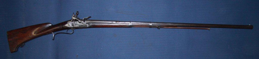

Default A miquelet escopeta for comments

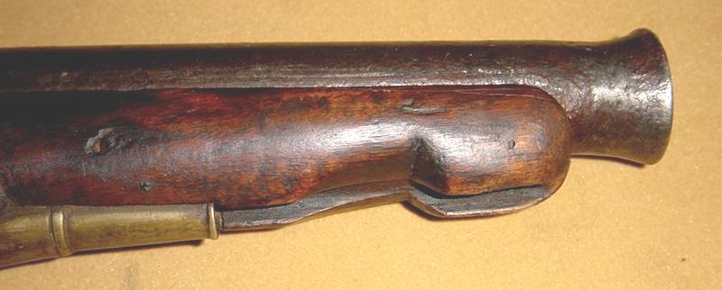

I recently bought this escopeta at auction and was hoping to learn more about it as this is my first flintlock. One of my areas of interest is the weapons used by Spanish colonists in the south western U.S. and this seems like a slightly fancy version of the sort of carbines that would have been used in that era and area.
What I know so far is that it has a miquelet lock, a Catalan stock, a belt hook and that is about it.
There is a signature of Castano with the last letter partly obscured by the mainspring and several gold lined markings on the barrel breach. One of the marks has lettering that is mostly obscured by the gold being a bit rough and thick but it seems to be three lines of letters with the second and third letters of the first line being NT.
The buttplate is a plain piece of steel that goes about three centimeters down the back of the buttstock. The caliber is .75 and the bore is smooth, there is no rear sight.
I will use the sellers Pics as my camera and camera skill are both pretty bad.
Any information that anyone has, especially about where and when it may have been made as well as how such a thing might have been used, hunting? Defense? Any opinion is welcome.

Nice gun you got there, machinist ... expensive too .
Probably a hunting escopeta, being half stocked; Fernando K knows better. Maybe he also has a record on Castaño, who doesn't come in Lavin's work. Apparently this is only the lock maker, once the golden mark on barrel is signed by someone else, probably a more well know smith. The two letters you discern will most probably be those of Antonio, but this is a name rather popular and is not enough to ID the owner.
Maybe you have a friend with photograph facilities and post a close up picture of the mark; maybe Fernando K or other member will be ble to ID it.

Fernando, A little expensive but I think it is worth it. Were you following that auction? One of the marks on the breach looks like a cross with a bifurcated, fishtail base, it seems common on such guns and I wonder what is it's meaning?

Hello:
I agree with Fernando, I think it's a shotgun. The name on the key (lock) I think it is Italian, if a key (lock) produced in Spain have the punch Manufacturer gold.
It would be interesting a photograph of the punch in the barrel (barrel) to see who produced it.
In short: I think it is a weapon produced in Italy, perhaps in Naples (under Spanish rule) and used a gun / barrel) produced in Spain
Affectionately. Fernando K

Hello Fernando K, This is interesting information, I was wondering why some guns where stamped on the lock, trigger guard, barrel, and mine was not.
I was wondering about it being used as a shotgun, it seems like it would be useful against deer with a load of buckshot.

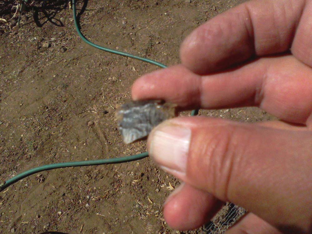

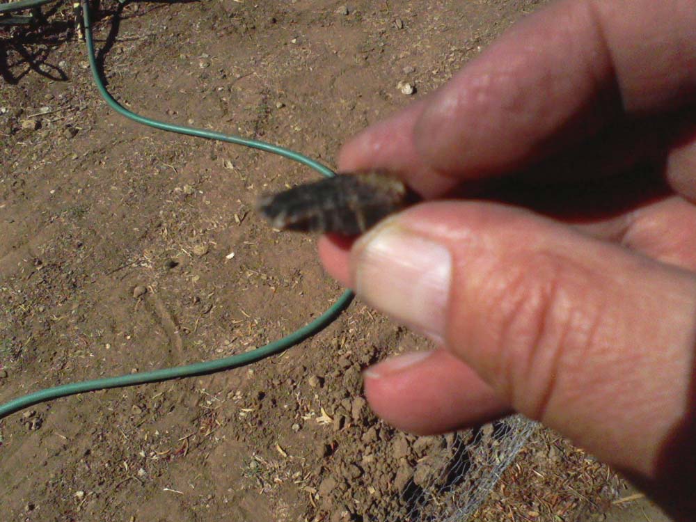

A few weeks after I got this I was setting a gopher trap in my vegetable garden and found a flint for it. Most European flints are uni-facially percussion flaked but this one is bi-facially pressure flaked much like an arrowhead so I believe that this is either a broken native American knife blade that just happens to match the size and shape of a flintlock flint or a native made flint for a Spanish weapon. I tried it and it sparks but not impressively.

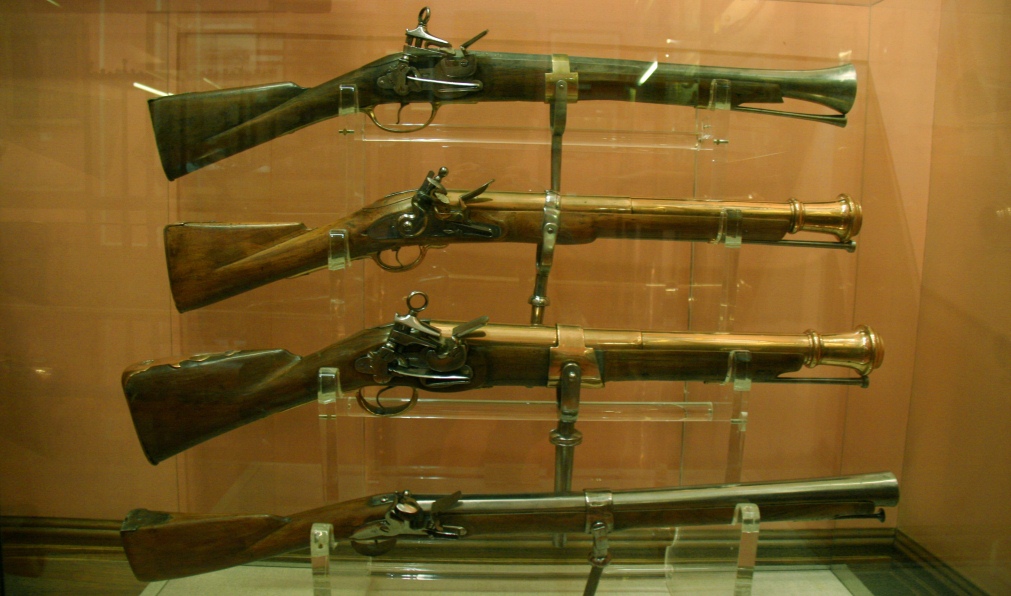

Old 13th July 2013, 08:54 PM   #14
Trabucos at the Madrid Navy Museum

Fernando, great shot of blunderbusses. Third one down looks to be the same as several at the old Royal Armouries at the Tower of London. I have a 35mm shot of them, somewhere amongst my albums.
