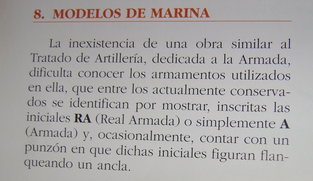

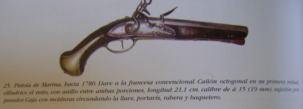

Try checking on Spanish Navy pistol circa 1780. French style conventional lock, 15 caliber (19 m/m). Barrel length 21,1 cms. The initial A stands for Armada (same as Marina = Navy).
J.L. Calvó Pascual ARMAMENTO ESPAÑOL DE LA GUERRA DE LA INDEPENDENCIA. Page 42 image #25.

Hi Fernando! Thanks for the info. With the anchor under a crown, and the letter A meaning Armada, it appears the pistols were made for Navel use.
The pistols do look Spanish military. Thanks again. Rick.

I guess you misunderstood Fernando K, Rick.
He meant to say that belthooks were common in both Spanish civilian and military pistols and not that the pistols you posted were not military.
Attached are pictures of the ID i provided. I realize there are no doubts when you compare both image and data.

Hi Fernando! No, I did not misunderstand Fernando K's response. I just did not respond to the belt hook. Which, now that I look at it, makes my response look awkward. It is interesting that the belt hook maintained such a large popularity in Spain through the 1800's. Even on short carbines. You see these on so many Spanish firearms.
Thank you for the attachment!! That is most helpful. Rick.

Read my post #4.
I had the privilege to have been offered a copy signed by the author. He was a documentalist in the arms museum situated in the Barcelona Montejuic Castle, which is now dismantled ... unfortunately
