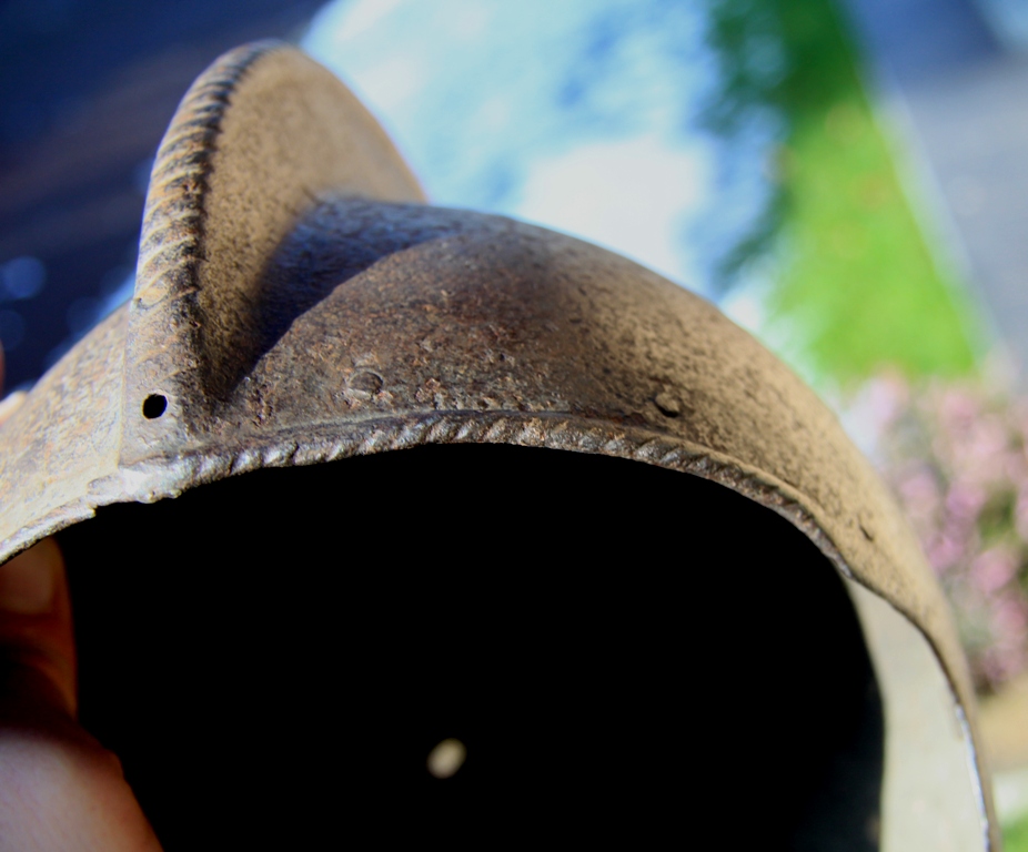

Hi everybody
Here some pictures from a 16th century burgonet .
Any comment on it will be welcome

last pics
Weight is 2200 grammes

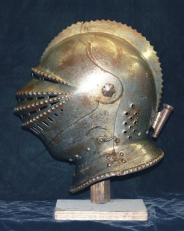

Cerjak, this helmet seems to be not a burgeonnette but a close helmet base on the location of the single holes on either side for visor hinge rivets. Burgeonnettes usually have pairs of holes set close to the browline at the point where it breaks a 90 degree angle about the middle of the ear. This thread demonstartes the usual location of the holes for hinge rivets for burgeonnettes http://www.vikingsword.com/vb/showthread.php?t=16224 and this thread shows and example of the typical location for the visor rivets for close helmets http://www.vikingsword.com/vb/showthread.php?t=16455 . Attached is a pic of a Maximillian close helmet I used to own that shows the location of the single holes on either side for the visor as well. This helmet also demonstrates a construction method that was not uncommon at the time but that I haven't gotten to see first hand much. The bowl is made in two halves, but rather than being simply crimped together along the comb ( this thread has an example of this construction method http://www.vikingsword.com/vb/showthread.php?t=16171 ) and lap riveted at the front and back of the helmet bowl, this helmet has been forge welded together along the comb and lap riveted at the browline at the front and back of the helmet bowl. I don't get to see this method of construction ( an expidiency between the helmet bowl hot raised from a single piece of steel or iron and the two piece helemt bowl od riveted and crimped construction )much.

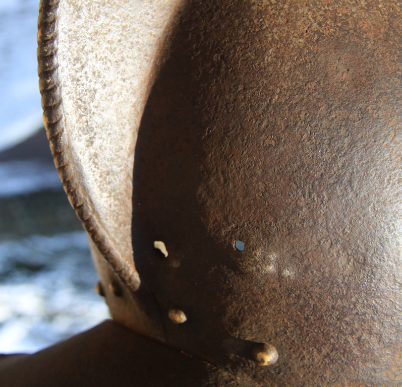

F129 a similar helmet said to be a "German barred Burgonet " I guess that the 2 holes in the rear side was a plume holder.
The holes at the back on either side of the comb are for a plume holder, the holes I was referencing are the hole to either side of the helmet in case I caused some confussion in my previous post.

Do you thing that it could be a 16 th century construction ?
The method of constructing this particular helmet had been almost completely eclipsed in favor of the quicker to make " crimped comb " method by the early years of the 17th century due to the need to make larger and larger quantities of gear for the ever growing protonational armies of a Europe in the grips of the Wars of Religion. I would say that the method of construction puts this pretty definitely in second half of the 16th century. Another tell is the roped borders, another element that disappeared rapidly in the 17th century as the every growing demands of bigger armies mandated quicker simpler manufacture ( roped borders was purely decorative and therfore not necessary to function at all and quickly went by the wayside in the 17th century ).

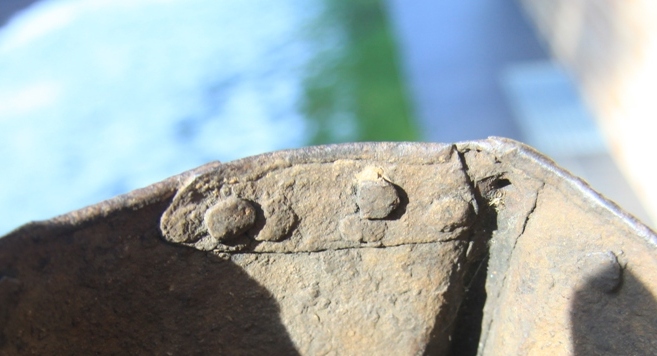

A last thing is this restauration made in the front side who seems to had been done in period time .
what is your opinion on it?
Cerjak, its possible that it was a working lifetime refurbishment. What it appears from the pics is that you had a section that cracked a bit on either side and was cut away ( it looks to have been done perhpas with a chisel and then smoothed out ) between and then a replacement piece flush riveted in ( you can see four smaller rivets below the two large ones ). Flush riveting is a technique where the rivet is piened into a hole that is slightly counter sunk so that it spreads out to fill the countersink making it smooth to the surface and then burnished. When well done it can be nearly invisible. The two larger visible rivets correspond with the other nearly flushed rivets that held the liner ( these are piened close to allow the visor or brim to come down without getting hung up on them ) and the patination seems to match closely that of the rest of the helmet. Working life reapirs of this sort were done but of course this technnique for replacing damaged metal on armour was also quite common for auction houses in the 19th and earlier 20th centuries as well. It's difficult to say with certainty from pictures but it is possible this repair was done when the helmet was still in use.
