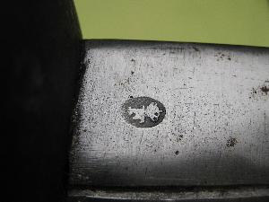

Old 12th April 2013, 10:36 PM   #8
hbhansen
Join Date: Dec 2011
Location: Denmark
Posts: 89
If it has got this stamp (Frederiksværk), it is without doubt a Danish M1849...
Best
HB
