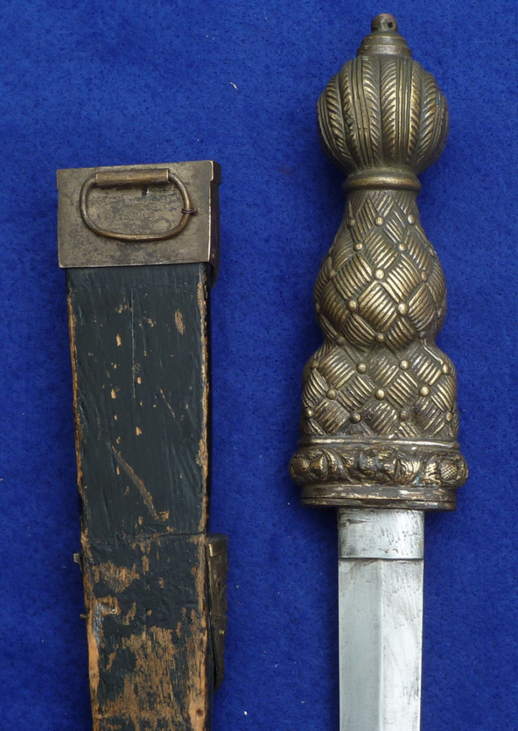

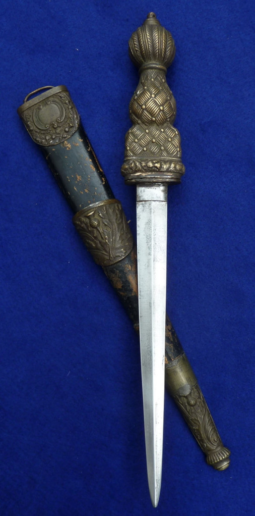

THIS RECENTLY CLOSED ON EBAY. I DIDN'T BID AS SOMETHING JUST LOOKED A BIT OFF TO ME. DID ANYONE ELSE SEE THIS ITEM AND IF SO WHAT IS YOUR OPINION ON IT. SORRY I DIDN'T GET MORE OF THE PICTURES WHICH SHOW IT MUCH BETTER.

Hmmm...agreed, Barry. Very unusual, but I don't know if its a fake. Most have the carved black wood with brass nails. Perhaps this is an 'undress-type' of dirk? Like the Japanese NCO swords with all-metal hilts rather than the wrapped silk over rayskin. Just thinking aloud. Awaiting others opinions

IMO the brass has an Indian 'flavor' to it, and to cast a reasonably accurate depiction of a thistle hilt from a dirk would have been an easy task for a brass sculptor on the subcontinent.
You'd be amazed (then again, probably not! ) at the diversity of (brass) forms I've encountered in the souks and bazaars in India, made during and for the British during the British Raj.
A couple other observations:
- The uneven patina on the brass hilt IMO speaks to an object that was hung, vertically, and more or less unpertrubed for several decades.
- The blade appears to have a hollow grind, similar to (though longer than) the Faribairn Sykes F-S stiletto and similarly profiled fighting knives that evolved as a result of the fighting style adapted & developed by Fairbairn and Sykes while training the Shanghai police during the early 20th century. There were several similarly-profiled fighting knives made during the 2nd quarter of the 20th century (and ever since!).

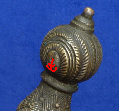

- While I am by no means sure, I perceive what might(?) be interpreted as an anchor on the side of the pommel. Might this indicate a naval association? Maybe a one-off commissioned by someone from the Royal Navy, as a 'bungalow piece' or otherwise?
I went and found the listing and pulled a couple additional photos, and have highlighted on one what appears as if it could be an anchor:

I'd also add that the suspension loop on the back of the scabbard seems far more suited to hanging from a wall than from one's belt.
Furthermore, the (awfully) flat back of the scabbard is as flat if not flatter than the sgian dubh scabbards which unlike dirk scabbards are actually meant to be worn agaisnt one's skin, though again, such a design would be perfect for hanging on the wall.

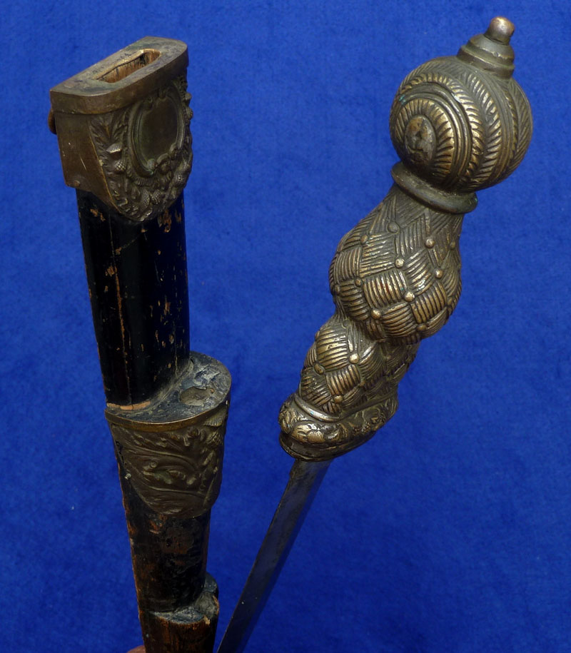

First, the vestigial pockets that would have housed a by-knife and fork are just that - vestiges of pockets - another likely indication this was made to hang on a wall, possibly with a surplus blade.
Second, IMO the person who spent nearly $500 on this got hosed. For half the price of a dirk, IMO they bought just that - half a dirk.
Then again, maybe it was a niche piece for a dedicated dirk collector, for whom $500 was probably money well spent on a one-off, even if made as a decorative piece.

Well (being a deep subject ) on the one hand brass makes sense for a naval dirk - resists corrosion.
On the other hand I am uncomfortable with the blade - looks too prestine to me as well as not the right form for a Scottish dirk.

It really looks like something made up for wall decoration...

Don't know how I missed this. Looks like a load of Victorian or later nonsense, everything is wrong. Might make a paper knife at a push. I am glad you didn't bid on it.
