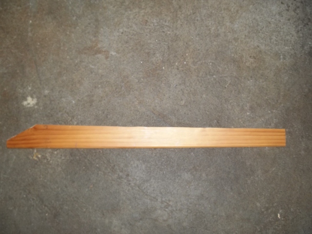

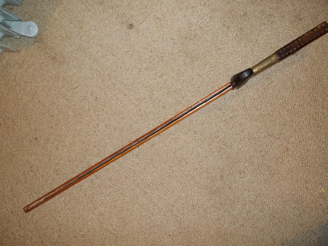

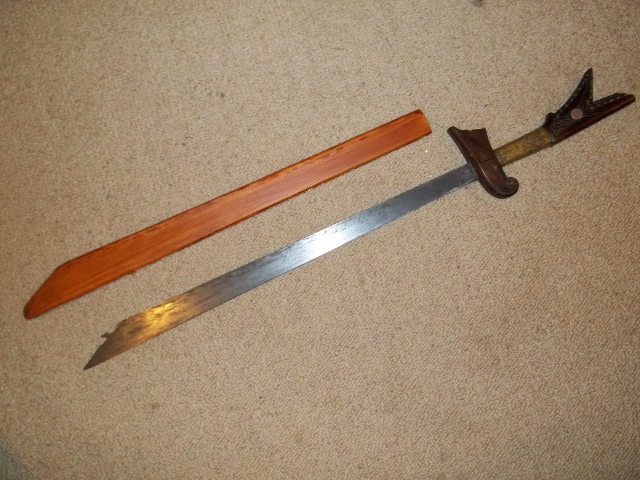

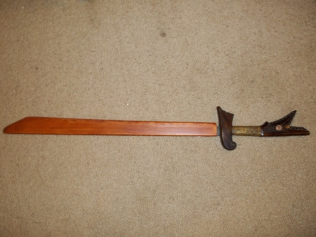

managed to make a scabbard from some wooden wall panelling. The groove was the right width for the blade spine. Used a drill in the end to create the space for the blade and have an opening for the blade to exit. The kampilan blade fits snugly and needs a bit of force to exit the scabbard. The next step is the hair additions. Have been doing the rounds of the malls looking for hair extensions and red hair dye "for my daughter, she's going through a phase".

Did you make a breakaway scabbard?

lol, good one! excellent job on that scabbard, is all i can say!

@Battara: whilst looking at some wooden odds and ends and formulating a quick process on how to setup and route my eye kept resting on the wooden wall boards which had been set aside as they had a bit of wet rot on the bottom. As I'm usually in a rush I decided for a quick and dirty option of using the solid board with an opening in the bottom. But I'm still formulating a breakaway scabbard using some plywood and a router but I'll save that for the other 2 kampilans as I'd need to approach the project with a bit more TLC.

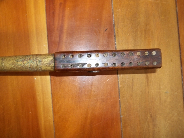

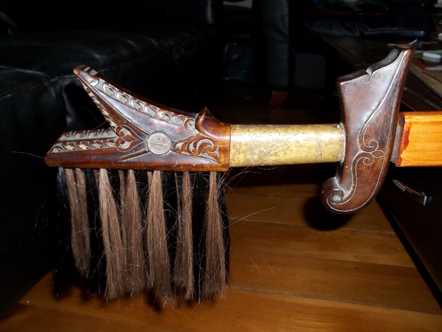

the hair extensions arrived today and the hair holes are ready.
Cato mentions that the hair tufts "generally measure six to eight inches in length". Does this seem to be the norm?

MOST I HAVE SEEN WOULD BE IN THE 5 TO 6 INCH LEGNTH. THE ONES WITH 2 TO 3 INCH ARE NOT LONG ENOUGH TO FLEX AND BEND AND DON'T LOOK GOOD AND SOME EXAMPLES HAVE FRAZZELED LOOKING TUFTS WHICH TAKE AWAY FROM THE NICE LOOKS OF THE SWORD.
I AM NOT SURE HOW THE HAIR IS PUT IN AS I HAVE NEVER GOT AROUND TO DOING IT. THE HAIR IS HELD IN BY A WOOD PEG BUT WEATHER THE TUFT IS INSERTED IN THE HOLE FIRST THEN THE PEG INSERTED OR THE HAIR ATTACHED TO THE PEG AND INSERTED TOGETHER ANOTHER POSSIBILITY IS IF THE HAIR WAS LONG ENOUGH SAY 12 INCHES TO FIND THE MIDDLE AND STICK IN THE HOLE AND INSERT THE PEG RESULTING IN TWO 6 INCH TUFTS PER HOLE. WHEN THE JOB IS COMPLETE THE TUFTS ARE CUT TO BE EVEN IN LEGNTH. I HAVE PONDERED THIS IN THE PAST BUT NEVER GOT THE MATERIALS AND GAVE IT A TRY SO I LOOK FORWARD TO LEARNING HOW YOU GO ABOUT IT. GOOD LUCK

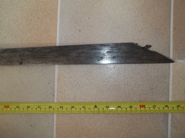

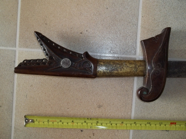

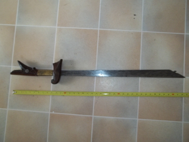

So I'm almost ready to apply the hair tufts but I thought I'd better verify the kampilan.
I was working under the assumption that the kampilan is a recently made piece (recent as in made in the last 10 years). But I want to confirm first as I was thinking the scabbard is an addition that does not alter the item but the hair tufts affixed become part of the item. I have taken a few additional photos and I was hoping that someone could be able to quickly tell that the kampilan is a recently made item.
The dimes do not show the year, but I thought it could be quite easy to get hold of a couple of old coins.
The kampilan is approx 39 inches / 1 metre long.

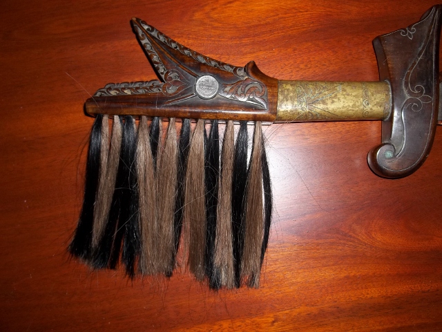

finally finished the hair tufts. Was going to dye the chestnut hair extensions a deep red but the daughter had managed to do some french braids whilst I was busy with something else. When I got her to undo the braids the chestnut hair had a nice wave to it so decided to do a combination of black and chestnut tufts.

VERY NICELY DONE A BIG IMPROVEMENT ON THE SWORD AND YOU GOT TO LEARN QUITE A LOT WHILE DOING THE WORK.

First, nice scabbard. Glad you got it done.
