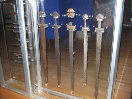

Your tulwar hilts are designed with the same intent as many viking hilts. The goal is to lock the hand in place. The wrist is disabled. It's less about hand size, but more about no little wrist flicks. Swords used in this way emphasize an edge moving closer to perpendicular to the target instead of parallel, to maximize contact between the edge and the target. When more wrist mobility comes into play, contact takes place in a more parallel manner.

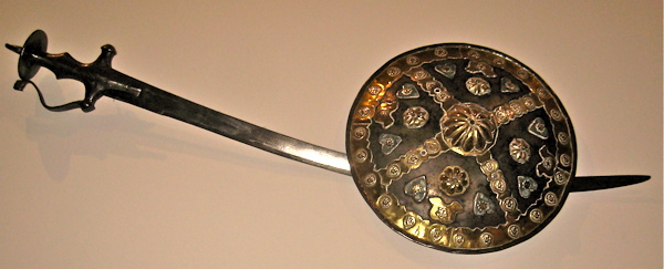

I now want an Indian round shield to go with my Tulwars! .
... I did it
both items have been found in 80's when I was in KSA,
I bought them in Jeddah, when the antiques shops were close the airport ... on that time
Very interesting!
A (very careful) enactment of the above, using the tulwar proves this statement very true. Of course, I am completely untrained in tulwar fighting, but I could tell the sword is not designed for wrist mobility; The user has to swing, or bring down his whole arm, a process completely contrasting to other sword designs and fighting: such as rapiers and fencing.
I thought I would post a photo of some Viking examples to note the hilt design and illustrate the similar process.
