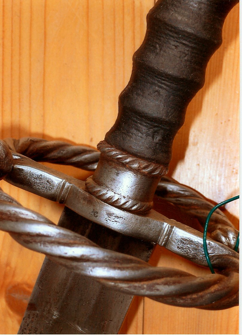

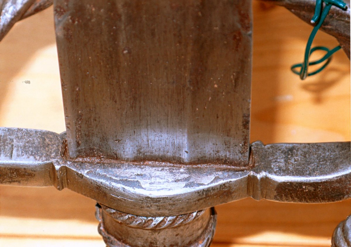

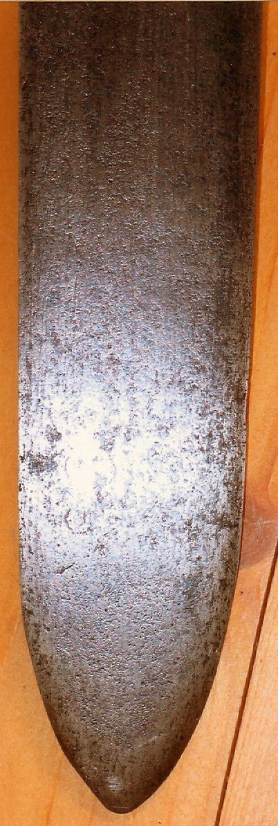

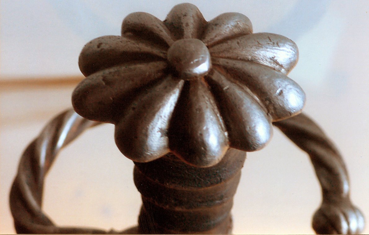

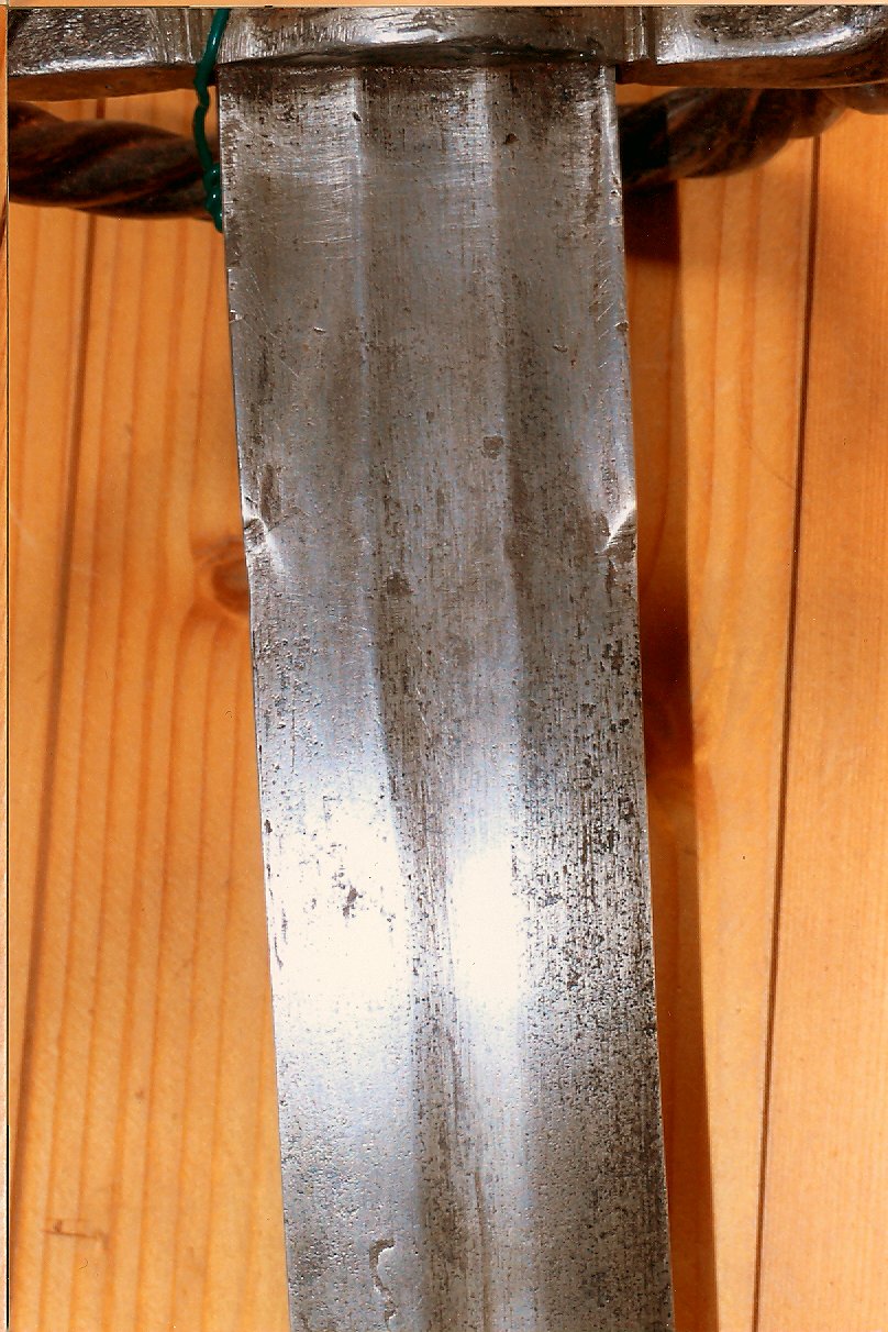

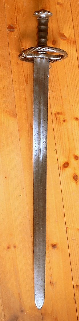

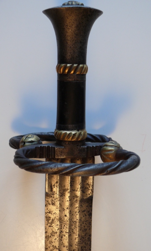

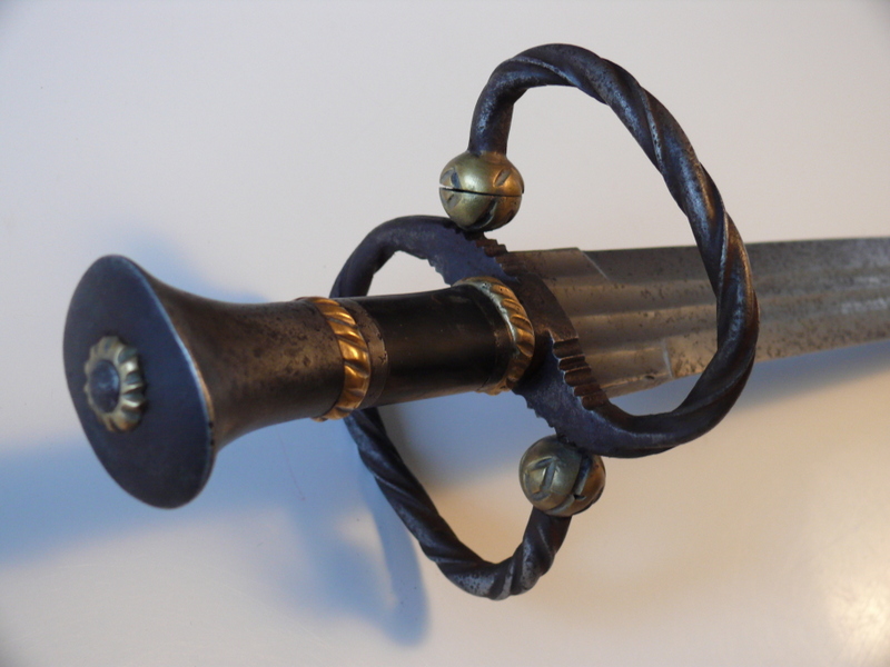

Dear Cornelistromp,
I know what is the clue -together with Michael- to identify with 'certainty' 19th century produced katzbalgers : the so-called 'pas d'ane' construction (stairs-like) of the hilt, a technique to work metal that did not exist in the 16th century but which existed in the 19th century and later on. This would be indeed actually a clue to formally identify later katzbalger replicas.
Importantly, you should be aware that the presence of some parallel lines along the groove of hilt does not always imply a 'pas d'ane' construction, and related later technology. I have carefully inspected under optical magnification the metal hilt of my katzbalger, especially focusing inside the grooves on both sides of hilt: the parallel lines that could be observed along the groove are NOT a 'pas d'ane' construction, but clearly hand-made file marks, that are more or less linear and regular, not continuous, more or less deep into the metal, depending on the part of groove you are looking at (orientation of lines sometimes left the groove itself further demonstrating unambigously it could NOT be a 'pas d'ane' construction !). These files marks -clearly identify as such- correspond to a hand-made finish of the hilt's groove with appropriate forgery instruments existing in the renaissance period.
Hope this would help in preventing of some mistakes regarding sword authentification,
jm
NB: To illustrate this, some parallel lines of hand-finish can be also seen in some pics showed in the new thread of Michael (see his period Saxon patrons) http://www.vikingsword.com/vb/showth...573#post136573

Hi JM,
Unfortunately this criterion alone won't do the trick. There is so much more to the problem: overall length, hilts, blades, marks, 'wolves', etc. And this cannnot be done by words of descriton but by photographic comparison alone.
Why do you not want to see this documentation? After all, it took me quite some time to set it up - and I did it especially for you ...

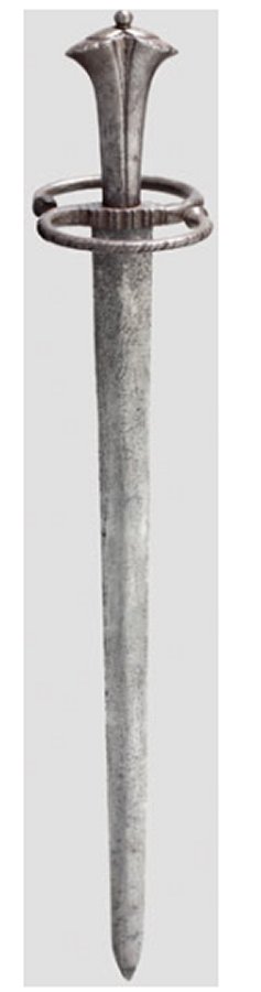

Please go to www.hermann-historica.com sale 64 lot 2394 for a similar katzbalger as yours.

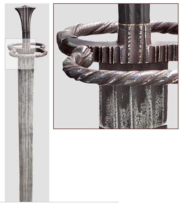

I have seen the historismus katzbalger you are referring to, for sale at Hermann Historica. Indeed, they look clearly similar at first glance. When looking more closely, they are still different (blade shape, markings and their positioning on blade, hilt and top of pommel).

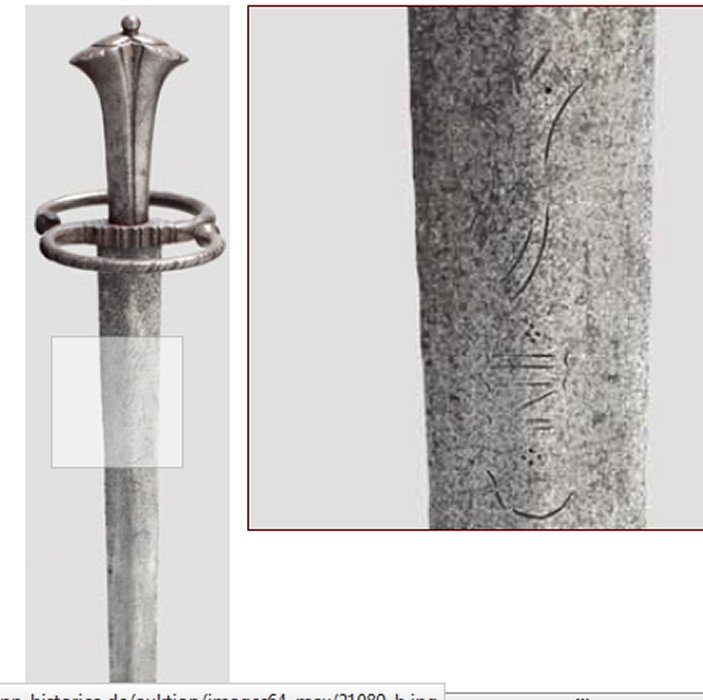

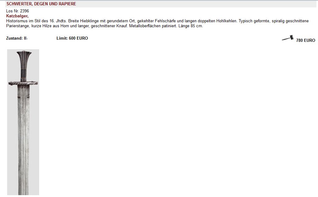

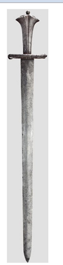

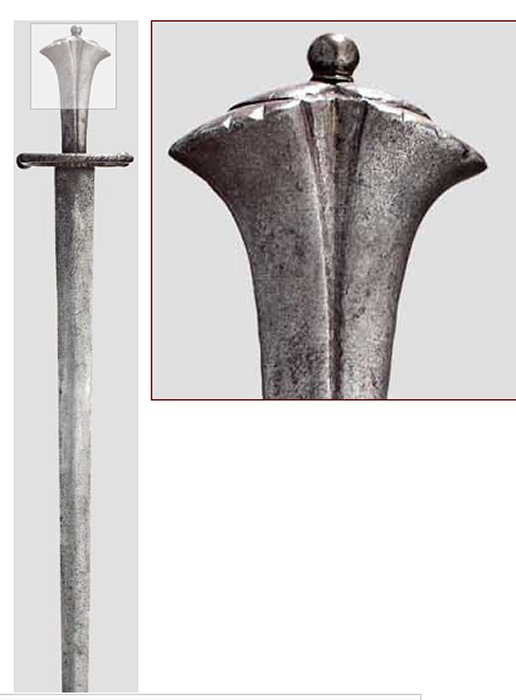

Hi Jean-Marc,
if you look at the Hermann-Historica katzbalger, the hilt is identical to yours.
The grip is the same (the tang-button is a separate small part and not belonging to any hilt) the s-shaped parrier guard is similar, even the decoration on this guard is the same. a pattern of 2 small incisions and 1 wide notch, only on the outside of the guard!!!which in itself hardly occurs
on katzbalger guards.
It is clear that Both of them have been produced in the same workshop.
The blades are probably authentic 16thc with subsequent/later engravings and subsequent damage. Actually it looks to me that somebody composed the katzbalgers from old and new parts.
If the katzbalger #2394 of Hermann-Historica is indeed historism or even later, then yours is most likely too. regardless of what various dealers on the basis of the photographs claim.
BTW have they recieved the complete information including the link of the Hermann-Historica katzbalger of sale of 64 lot 2394?
This could otherwise be retroactively mailed, I expect them to adjust the valuation on the basis of the above.
However it would probably be better if you can mail the 5mb pictures for valuation to Hermann-Historica direct.This certainly gives more clarity so why not do it ?
another track which can be successful, is to the trace the provenance.
From who's collection did it arise, where and when has this collector bought it.
Katzbalgers without verifiable provenance that have been recently popping up in the market are in advance suspicious.
your twohanders in this thread really are exceptionally beautiful so is the armor, but with this katzbalger I have serious concerns.
best,

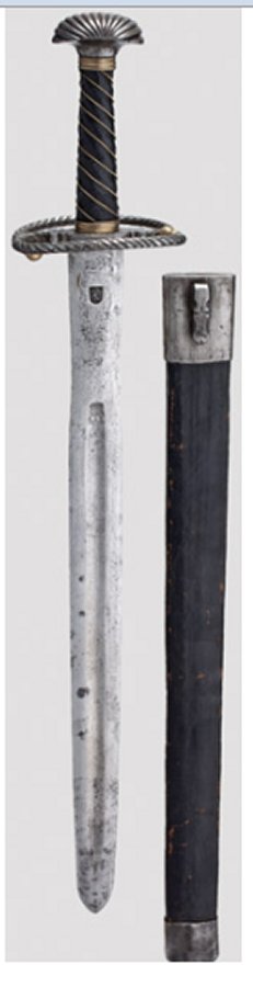

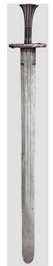

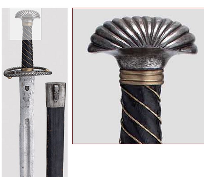

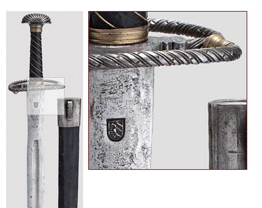

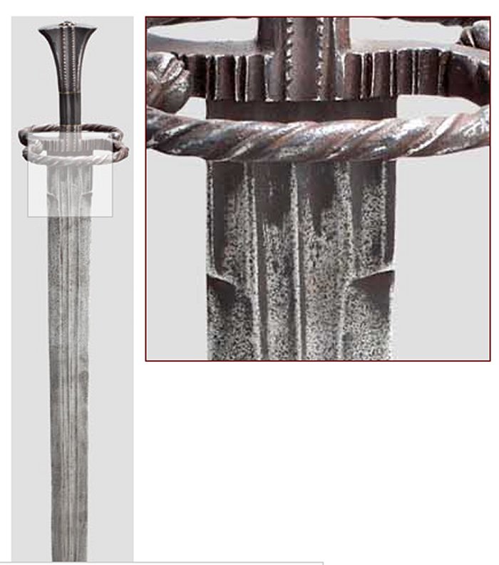

Default A Good Example of a Sumptuous 19th C. Katzbalger Copy
This item fetched the unbelievably high price of 10,000 euro plus commission at a South German auction.
It is a good copy of a 1530's style (Ottheinrich type) Katzbalger but all stylistic and decorative elements are overexaggerated, which is characteristic of a sumptuous Historismus piece.
The blade is struck with an imitation of a Brescian eye mark which however is located too high up for a genuine piece, just below the quillons. The etching on the blade again is typical of the Historismus period, showing a warrior all'antica.
With an overall length of only 85 cm the sword is also too short; genuine Katzbalgers are usually a bit over 90 cm long provided that they have not been shortened at some later date.

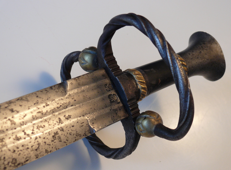

Posts: 1,064

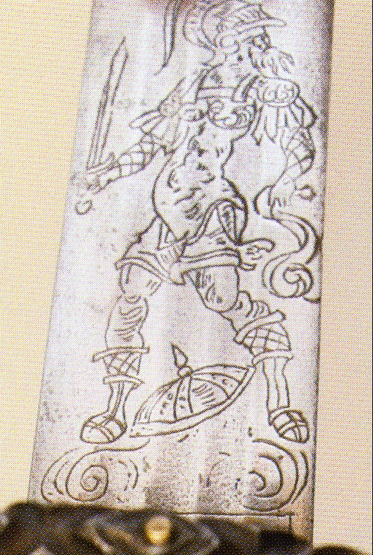

here I do not agree, this could well be a true katzbalger.
the blade looks at least good and authentic, both the position and the shape of the stamped mark, the length but also the warrior engraving probably of ABONIS and HIPORIS do look ok... 16th century.
I know at least 3 original 16th century swords with similar warrior engraving. swords from the 19th century with this type of engraving are unknown to me, but this does not mean that they don't exist.
For similar example of those warriors see Hermann Historica sale 64 lot 2312.
than the hilt, a similar, well almost indentical checked pattern at the s-guard with latten/brass can be seen on the katzbalger nr 95 published in Europaische Hieb UND Stich Waffen, Mueller, Koelling p.189. The grip is less convincing but this could be a later replacement or restoration.
best,

of course it is good to disagree sometimes and besides Michael you can always adjust your opinion later
here a magnificent 19th century (16thC style) katzbalger with good ricasso style characteristics. same mark as the 19thC katzbalger that you mailed me

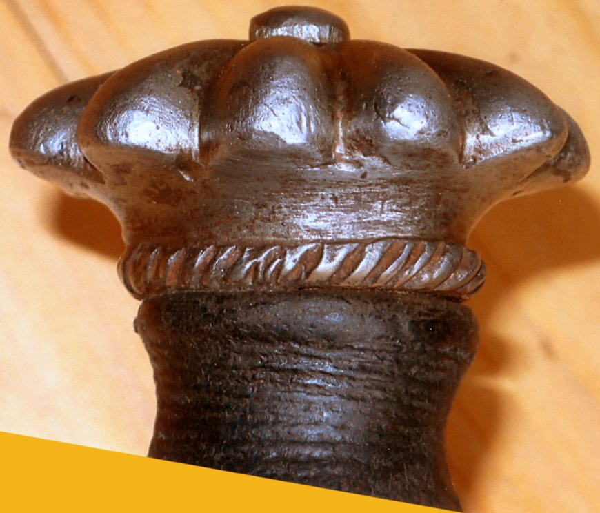

Another 'Katzbalger' in early-16th c. style, 20th century.
m

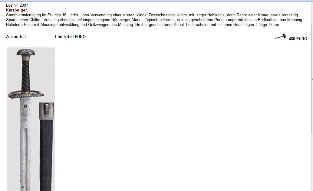

As announced in post # 54, here is my documentation on characteristic Katzbalger copies; they just ended at auction at Hermann Historica's.
The first item failed to sell.
