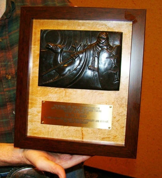

Stan, I used jbweld to attach the mounting bolts to the back of this bronze created by Tim that we presented to Lee .
I believe they're still holding .
