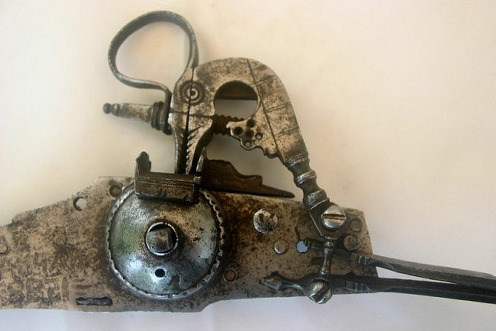

Here is a later (about 1580?) wheellock which has the sear engagement button, missing its head. The button is pushed out by a spring so it disengages the sear from the wheel. This requires that the button be pushed with one hand as the wheel is wound with the other. Must have been inconvenient on horseback!
The numbers on the bottom edge seem odd - perhaps they date from when it was made?
Best Regards,
Johnhb

Hi Johnhb,
This lock is almost certainly of Augsburg manufacture, ca. 1590-1600.

Hi Johnhb,
For better understanding I inverted your first image of the Augsburg wheel-lock to show its actual view.

Hola a todos:
Si se invierte la fotografía, la cifra 1588 queda invertida: me parece que era una llave (lock) para la izquierda....Además, me parece que arriba de la cifra 1588 hay una inscripción, que no puedo descifrar.....
Afectuosamente, Fernando K
Hello all,
Reversing the picture, the 1588 figure is reversed: I think it was a key (lock) to the left .... I also think that above the 1588 figure is an inscription that I can not figure out .... .
Sincerely, Fernando K

Posts: 4,310
Hi Fernando K.,
Thank you for remarking that. So it is left-hand lock which is very unusual, and I should not have inverted the image.
The number 1588 and the other cyphers are certainly old inventory nos.

Hola, JOHNNB
Por favor, tu que tienes acceso a la pieza, puedes reproducir la inscripción?
Afectuosamente. Fernando K
Hello, JOHNNB
Please, you who have access to the piece, can you reproduce the inscription?
Affectionately. Fernando K

Fernando K.
The inscription says;
"Very rare snaphaunce 1588"
It was written with a felt tipped pen when it was offered for sale.
According to the seller it was found in a French chateau during WW2 and brought home by a GI.
I am replacing the missing and incorrect screws following Matchlock's excellent
pictures as a guide. With a new axle and chain it should be good for another 400 years.
Best Regards, Johnhb
