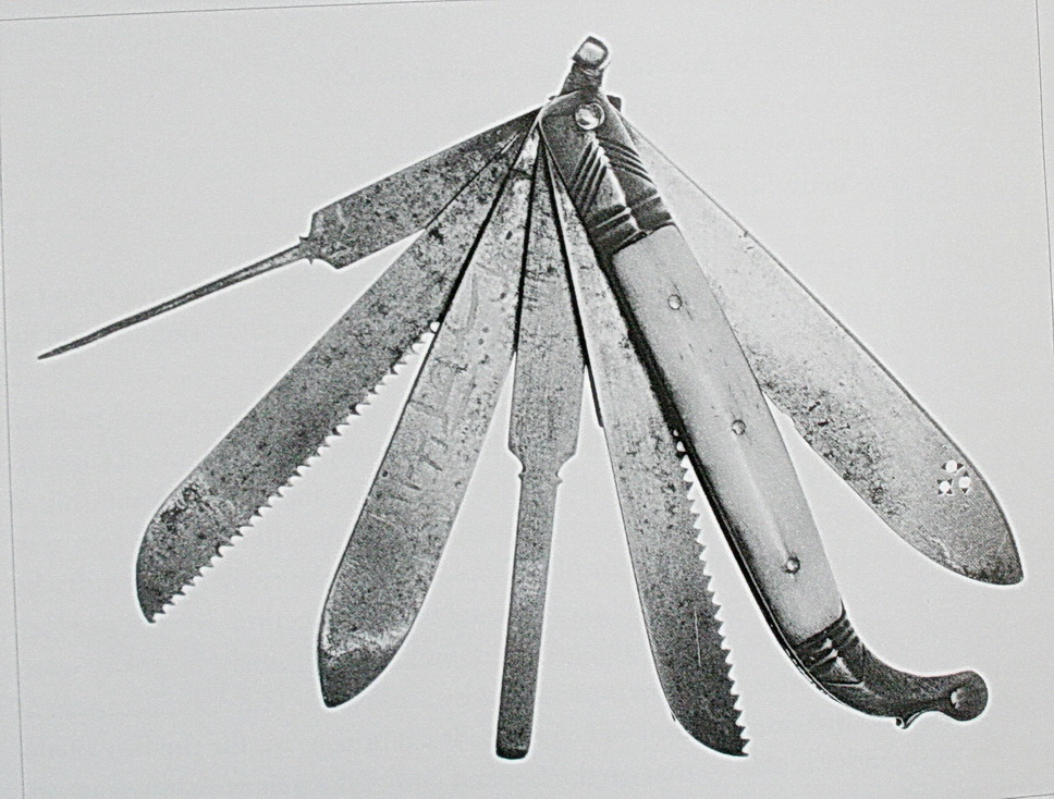

James Allen and Brian Guilmour: Persian Steel. The Tanavoli Collection, Oxford University Press 2000.
A number of folding knives are shown, but they are all 19th century, and I don’t remember if older folding knives are mentioned in the text. Attached is the oldest one shown, dated AH 1221 (AD 1806-7).
Sorry I could not be of more help.

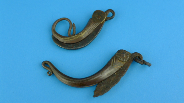

Folding knives of a sort, I have had these for a while. I believe they are South Indian Betel Nut knives, probably 18th Century, if not earlier. Pictured next to an Iphone for indication of size.
I have seen South Indian/Sri Lankan betel nut folding knives which I would consider 17th and 18th Century in the past. Some information on those lies in the book 'Ancient Swords Daggers and Knives in Sri Lanakan Museums' by Silva and Wikramsinghe.
Runjeet

I don't think that this are Betel knives, the betel nut is to hard that you can cut it with this knifes. Is it possible that this are old opium knifes?

I would think the old adage of form following function combined with the age-old practice of writing texts on (banana?) leaves would together support the likely of existence of such knives before European contact... Maybe the answer would more likely lie in the research of archaic practices of Brahmin scribes than in the search for a knife-reference per say?
Old 26th November 2011, 09:50 PM   #7
Posts: 10,867
Excellent call Chris!!!!
Often the information needed is found in literature outside the expected arms topics, in this case having more to do with the function performed than the implement itself. Spot on sir!!!
Excellent and fascinating illustration Jens of that compound knife.

Point taken Detlef. Sounds like you have experience in Betel Nuts!
The knife pictured by Chris is the kind of example mentioned in the book by Silva and Wikramsinghe, but no mention of really early ones. I do believe it is of traditional South Indian/Sri Lankan design, it is just finding the reference that may be difficult! I do have a nice early one somewhere with an inscription (just don't ask me to find it!), but not earlier than 17th Century
Yes Runjeet Singh, have been to India and tried it. Also from my travels to Indonesia I know how hard is the betel nut when dried. And I have a small collection of betel knifes from India and Indonesia.
