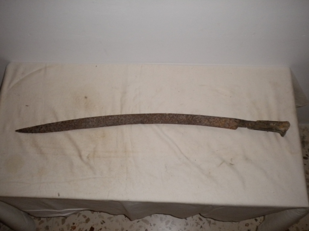

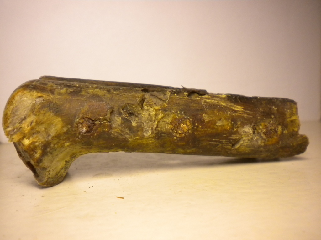

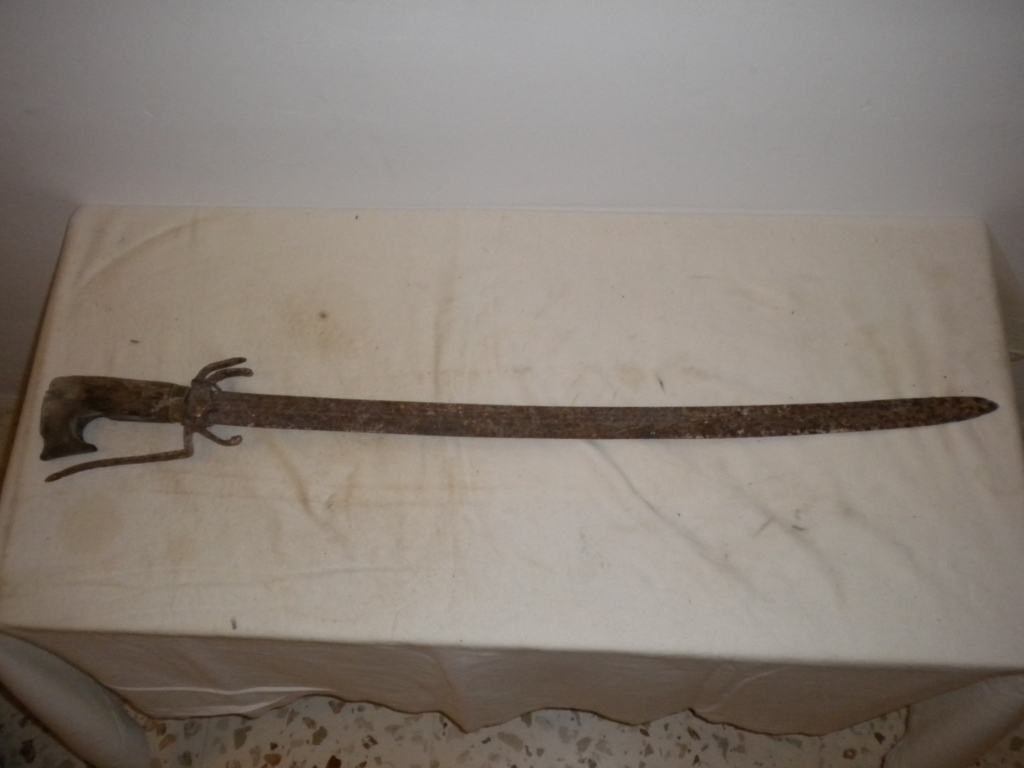

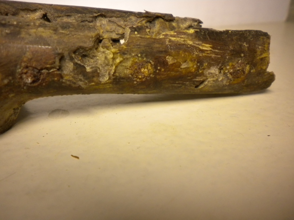

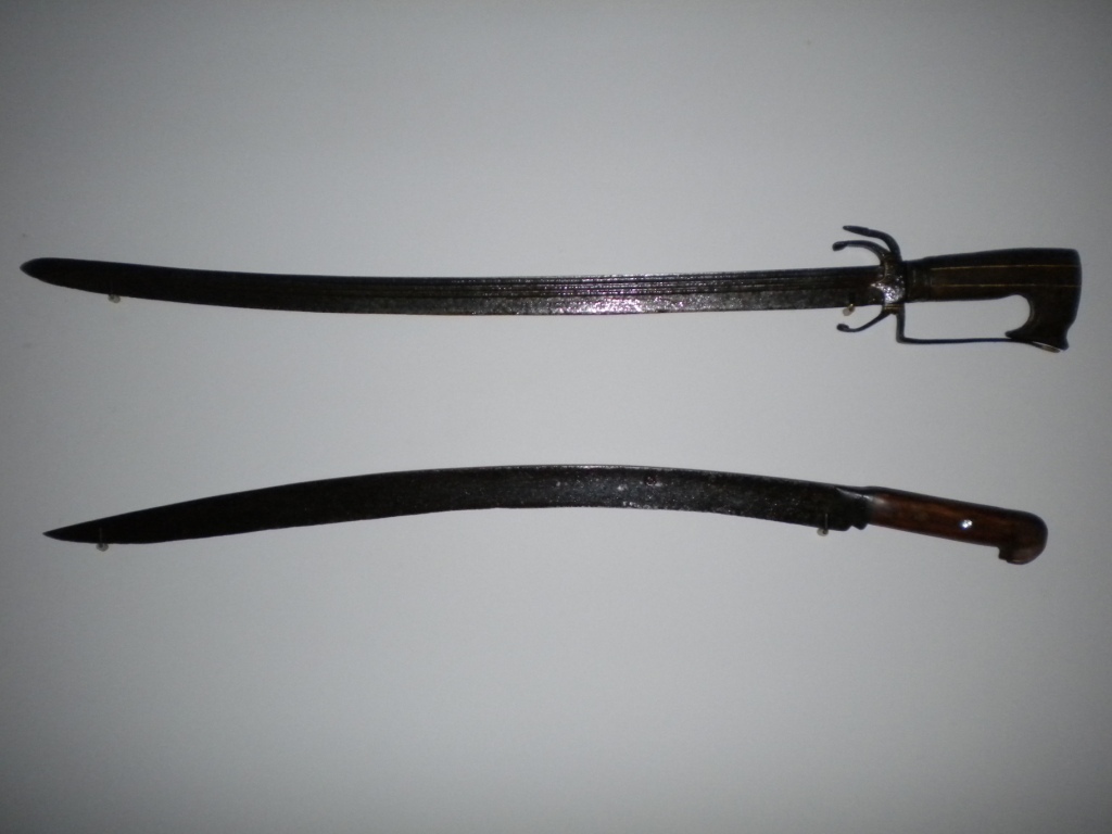

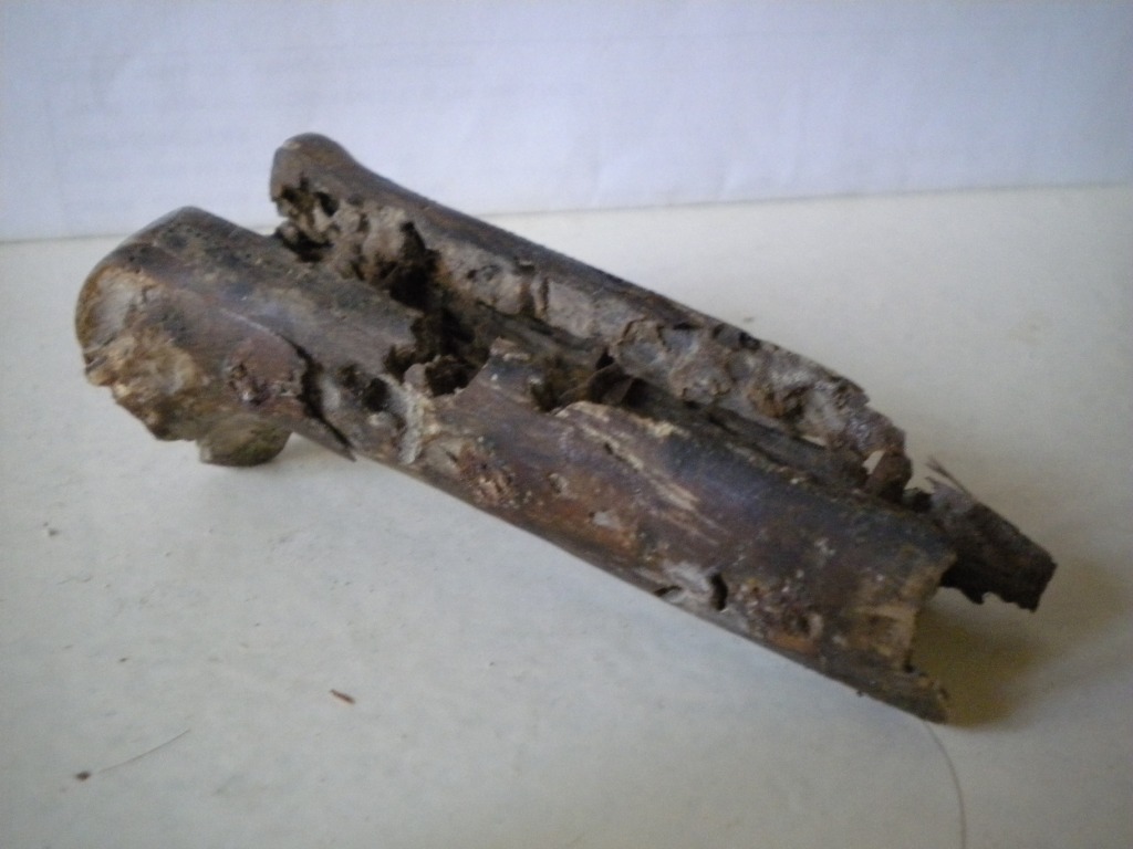

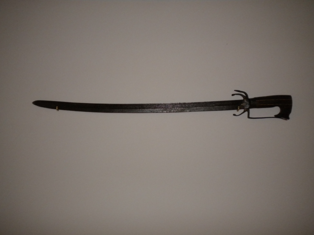

I have inherited two swords which have been identified as a Yataghan and a Nimcha.
Both swords were in a bad shape and have been restored. The Yataghan's wooden handle had to be replaced entirely.

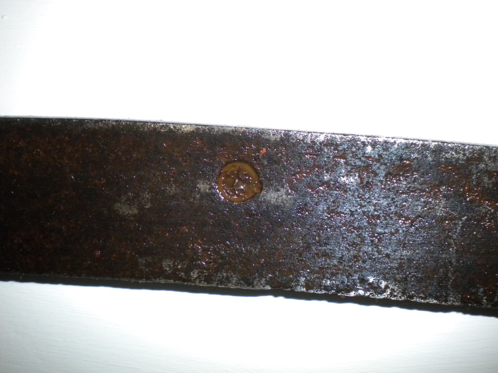

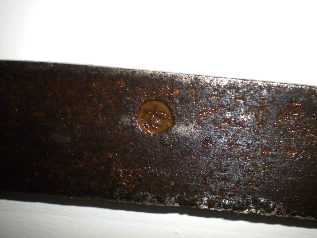

After removing the rust, it was brought to my attention that the Yataghan's blade had an armourer's mark. I have tried researching various sources but could not find a match.
Can anyone identify the mark and maybe from there guess a period in history?
All I know about these swords was that they were found together in some box by my father. The only thing he knew was the area they had been found in. The same area he mentioned lies on the route taken 497 years ago by the Ottoman army and thier North African allies during their retreat from the Siege of Malta back towards their ships. Close to that site was where the final skirmish between the Knights Hospitallers; a relief force of Spanish soldiers and the Ottoman force took place.
I am really hoping that these are relics from that siege but only a positive identification can tell if they were made in that period or not.
Attached are the photos. I apologise for the mixed up order. Basically they show the swords how they were before and after restoration; the mark on the yataghan blade and the original yataghan handle.
You can notice that the handle had very small decorative marks along the border and around the dowel pins.

Joe, welcome to the forum and congratulations on your inheritance. It is a wonderful thing to see the number of old weapons which seem to be being passed on, and the care with which they are being received by benefactors.
I'm glad you are working to restore and preserve these.
You are also fortunate to live in a region so rich in historical heritage, and the Siege of Malta certainly was a profoundly important event. Unfortunately these weapons post date that 16th century event, and are more likely to date in the 18th century at earliest, perhaps even into early 19th.
The sword with quillons is if course the well known sabre usually termed 'nimcha' by collectors, but more properly termed a Moroccan sa'if. While these are known to have been in use with the familiar hilt configuration in the mid 17th century, the blade appears to be of trade blade form of types out of Germany in the 18th-19th c. While these are regarded as Moroccan, they were seen often in maritime use along the North African littoral, and well known in the Meditteranean trade systems.
The yataghan also seems contemporary to the 'nimcha' and likely also of provenance to Ottoman regions in North Africa. The stamped cartouche resembles similar examples which seem to be either arsenal or acceptance stamps much like those seen often on blades of many Algerian nimchas (Briggs, 1965).
I am glad to see these swords have gone to a good home, and I think you may be assured that although not dating into the period of the Siege, they still represent a most colorful period of Meditteranean history.

What a perfect pair to represent the role of North African corsairs and the Ottoman empire in Mediterranean trade at the time!

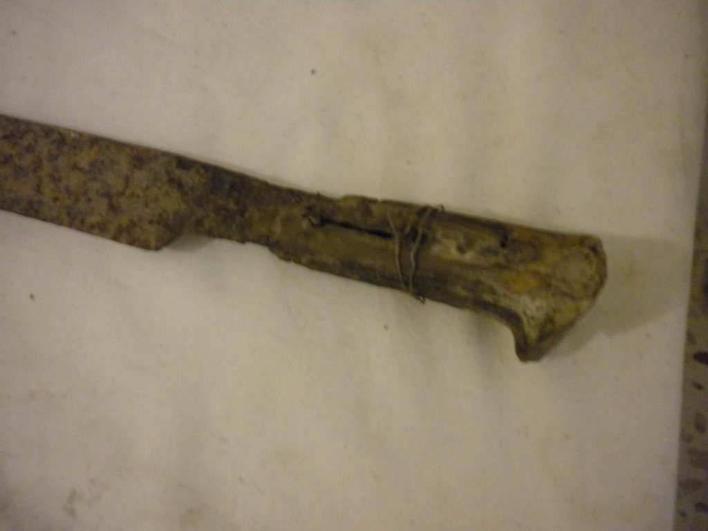

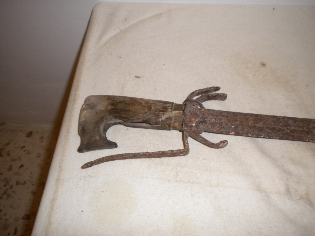

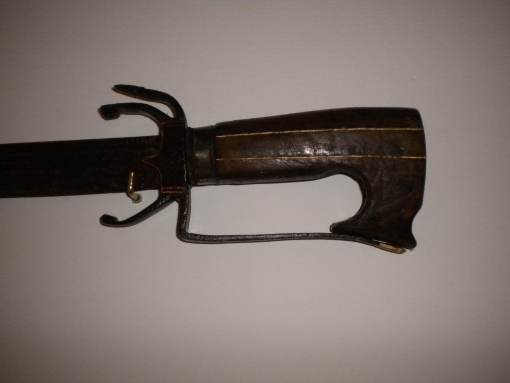

A question for Jim & Ibrahilm:
In the photo of the obverse of the nimcha - with the original hilt - there is some type of stirrup wrapped underneath the quillons on either side of the blade. What is this? I don't recall seeing a similar fitting on other nimchas?
Old 16th October 2011, 07:27 PM   #7
Posts: 10,803
Excellent observations as always Chris! I hadn't noticed that 'strap' or whatever it is. While there are several variations on these 'nimchas' with either pitones, or the so called 'Zanzibar' form with the ring loop over the blade, I cant say Ive ever seen a feature like that either. Would be interesting to learn more about this and if anyone else has seen anything like it.

To Chris and Jim: The "stirrup" feature you noticed around the Nimcha's quillons and handle had nothing to do with the sword. It was just a vulgar piece of metal wire wrapped around it in an attempt to hold the blade and handle together. You can see a similar attempt around the Yataghan's handle (when they were still together).

Jim Could you provide more information about the mark of acceptance you mentioned? Is it possible that any armourer marks are beneath the patina? - Don't worry, I won't dare remove it.

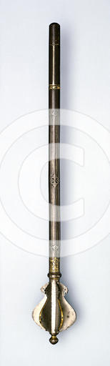

My apologies for digressing and hijacking your interesting thread but would it be possible, at some time in the future, for you to photograph in more detail the two Ottoman maces that are on the floor of the showcase in your second photo. I normally wouldn't presume to impose on you but I have just acquired an Ottoman mace and am having difficulty finding images of similar items. If it is not possible then I will fully understand.
Norman.

Although not being entirely sure, the marker's mark on the yatağan reads as "amel-i Muhammed" (made by Muhammed).
Norman.
I'll try to remember next time I visit the museum.
In the meantime below is a picture I found through a google search. It looks similar but I cannot be sure it is the same type of mace.
