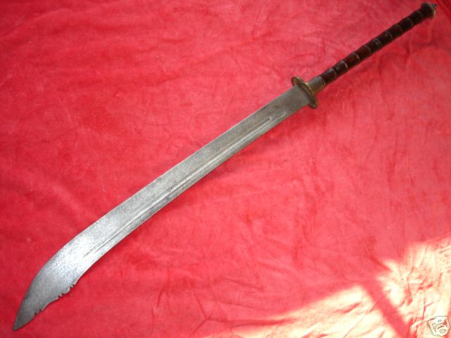

EDIT: here's more pictures I found on google...
http://img37.imageshack.us/img37/4083/yanchir1.jpg
http://img853.imageshack.us/img853/7898/yanchir2.jpg
http://img842.imageshack.us/img842/2387/yanchir3.jpg
http://img402.imageshack.us/img402/2874/yanchir4.jpg
http://img195.imageshack.us/img195/2921/yanchir5.gif

The yan chi dao is a variant of the willow leaf dao with a clipped tip. The better examples look like the ones you have posted, but a simple clipped tip is more common. According to Scott Rodell, the "goose wing" name is a Chinese collectors term, and he seemed to think that the name "phoenix wing" appears more often in the regulations.
The clipped tip brings the point in closer line with the hand making for a slightly improved thrusting ability. You have noted that the curvature is more subtle than that of most willow leaf dao, and a slightly reduced curve would also improve the thrusting ability. I do not see them as similar to yan mao dao in design because the reduced curve of the yan chi still makes them different form the yan mao which really only curves at the tip. Overall, I see them as a way to combine thrusting ability with a curve, so in that way they are similar to a yan mao, but still they are in the willow leaf camp.

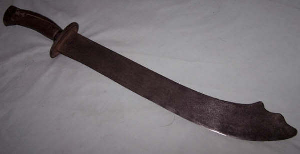

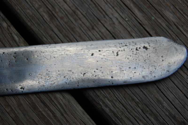

1. A Yi chopper in a style very similar to things seen in Song illustrations. Many minority forms are quite conservative and retain styles from much earlier periods.
2. A wavy tipped dao knowledgeable people have called “demon head”, “yanchi” or “yantou”.
3. A village jian shaped dao.
I hope this helps.

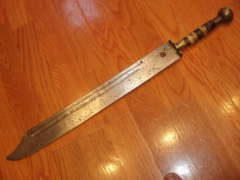

Here is one along the same lines, I think from memory is was listed as an executioners sword now with a New York collector.
To my eye, clearly a cut down pole arm.
