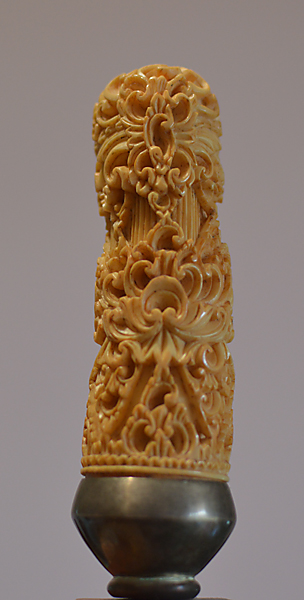

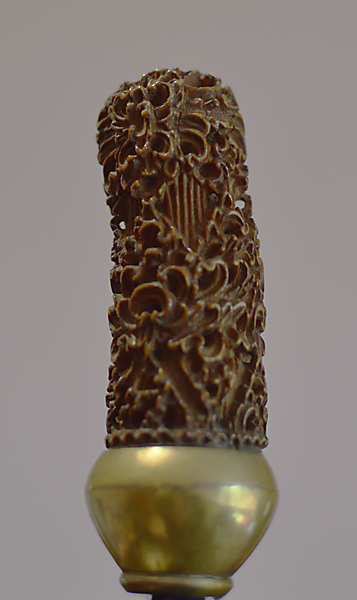

Alan's remark above on another thread (the hilt-selut combination of Sirek's keris enclosed below, pict. #1) reminded me to bring up this matter that has "disturbed" me for some time.
The first time I saw a Donoriko with this kind of hilt was at a Danish auction house several years ago and I laughed about it and believed it to be a local upgrade by a dealer or an enthusiastic collector. About a year after I saw the same combination at a dealer's shop in Paris and was a bit disturbed about it but thought that maybe two dealers had got the same idea. Some time later I saw it on eBay from a seller in Florida and this time I bought it for myself (see pict. #2).
A couple of years ago one of the Singapore or Malaysian collectors of this forum (Shahrial?) published pictures from a visit to the National Museum in KL with another example (see pict. #3). Thereafter I have seen it a few times in other collections and now on Sirek's keris in Holland too.
So when I read Alan's comment I agree in "taste". But after having seen it so many times and on keris distributed all over the world I find it hard to shrug it of as a dealer's combination.
Anybody else who has the same experience?

Hello Michael,
To me, selut specimens #2 & 3 do not seem original (they do not fit well) and they look low quality pieces from the pictures, but specimen # 1 is a different issue. Of course this is my personal and uncontrolled opinion only.

So, I guess the question is:- are selut of this type a correct and original part of Madura keris dress?
Based upon what I know, and upon what I have seen, it is my opinion that they are something intended to facilitate sale to people from outside the Madura community.

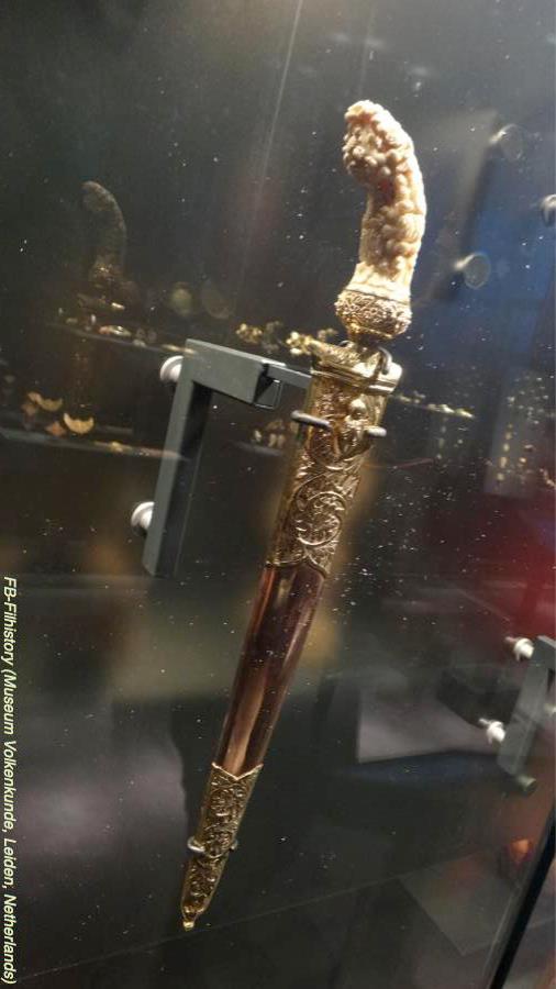

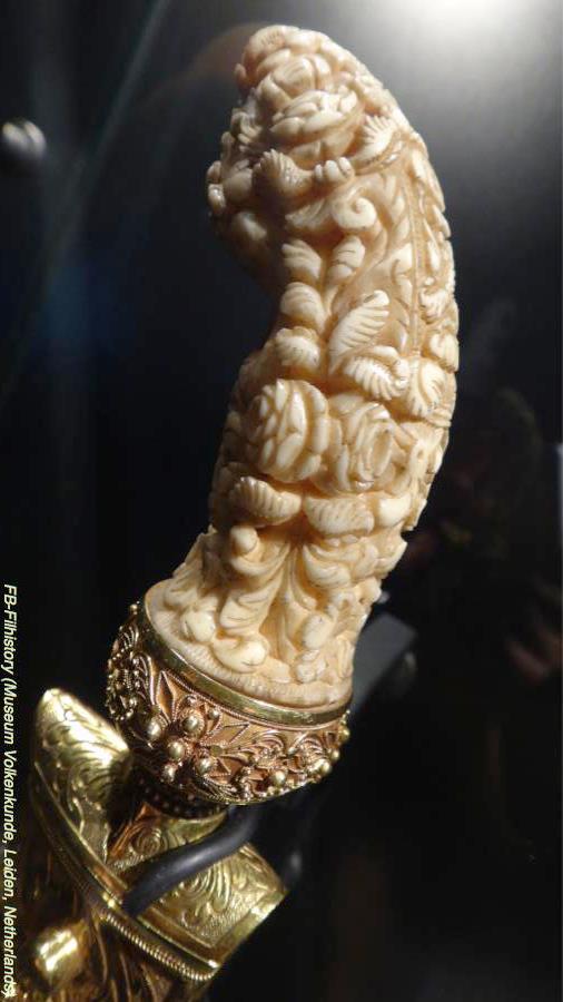

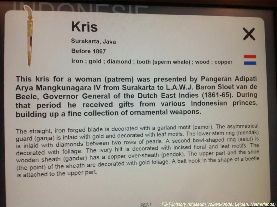

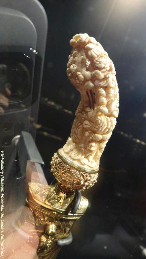

I found these pictures from Leiden's exhibition at Lorenz' site and was puzzled to see the pimped selut - donoriko combination again.
But this time it is with date and provenance.
Maybe this, less kitchy, selut was the inspiration for the later "upgrades"?

In the museum section of the Mangkunegaraan in Solo there is a case with perhaps 6 or 8 of this type of dagger along with some other very fine weapons. You cannot photograph them, and you can only enter this section of the Mangkunegaraan with a guide in close attendance, I mean at your elbow the entire time. None of these daggers have hilts that look like the one in post #9, the usage shown in post #9 is neither fish nor fowl, it is a dagger type that is found in the Mangkunegaraan, but it is fitted with a Madurese keris hilt, altered to make a pleasing ensemble for a European.
The Central Javanese rulers were not above a bit of mixing and matching if they were trying to create a prestigious gift. This hilt no more belongs on a Central Javanese piece than wings belong on pigs, but the attitude was, and is:- whites don't know anything, so give them what they want, and we know they like nicely carved ivory. This hilt is a keris hilt and is incorrect for this type of dagger, but that doesn't matter:- it was prepared for a European, the objective was to please the white man, not to prepare something that was culturally correct.
The example prepared by the Mangkunegara as a gift for a European is no more an authentic Madurese usage than are the seluts of remarkably poor quality that are in the previous photos, but it is of very much higher quality. The Mangkunegara is the minor prince of Surakarta.
Attached are a couple of pics of Madura hilts with seluts. One is from a similar dagger to the one shown in post #9, one is from a pedang; one was prepared for sale pre-WWII, one was prepared for sale in the 1970's; both came from the same source. Both were fitted to the weapons in Central Jawa, specifically for sale to tourists.
Mixing and matching was not limited to shonks working out of Central Javanese markets, nor to forgers in Singapore and Jakarta, nor to UK arms dealers in Birmingham. It was and is very widespread.

Yes, it is obvious that the keris hilt does not belong to the dagger either.
But what puzzled me with this case is that these kind of selut upgrades seems to have been around for a century longer than earlier discussed.

In "Court Arts of Indonesia" on page 163 there is another almost similar dagger (to the one in #9) with Madurese hilt (without selut). The description says:
"The kris was put together around 1880 and belonged to one of the daughters of Pakubuwono IX."
