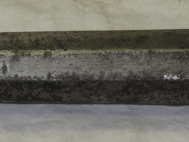

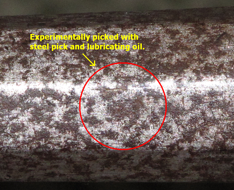

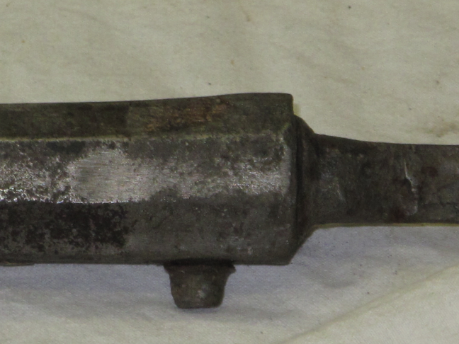

A quick update. I've just come away from a small experimental session with a fine steel pick, lubricated with a coating of common 3-in-one oil. The result? The rust is, it turns out, much softer than the steel (not surprisingly), meaning it can be picked out - it will take an awfully long time to do the entire barrel, but it can be done. The picture illustrates the difference; the circled area has clearly enjoyed a sort of topographical reversal, with the rust (formerly proud of the barrel's surface) now diminished sufficiently to be at least level with the walls of the pits it has made in the metal.
The second thing that I've determined is that this will take, almost literally, forever. But, if I'm careful, I should be able to avoid damaging sound metal. I think this might be the (extremely slow, painfully laborious) way forward, coupled perhaps with gentle use of 0000 steel wool and yet more lubrication. (Yes, I take the blame for rising fuel prices.)

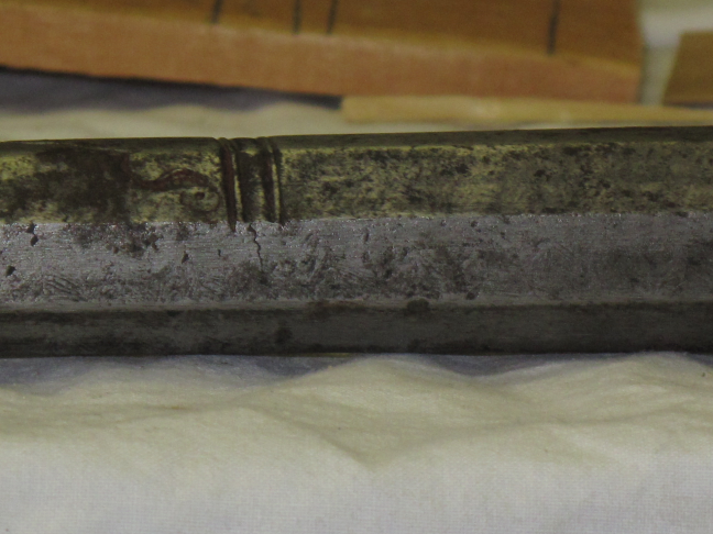

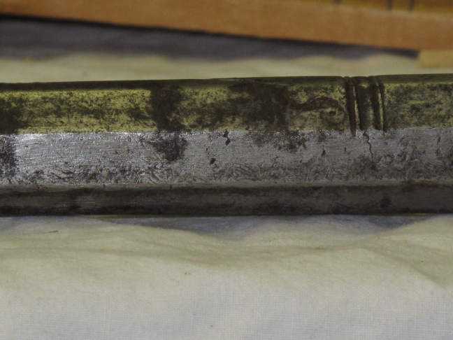

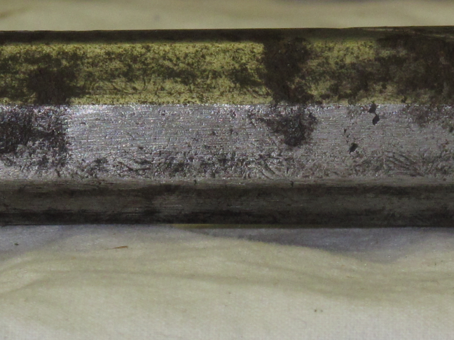

Ward, I appreciate that acid should chomp through rust just as it will cause the appearance of the watered pattern by removing some of the softer iron. What I still worry about is whether the effect will be what I desire. To give you an idea of why, I discussed in an earlier thread the effect of Renaissance Metal De-Corroder on the watered steel of this barrel and various other objects. The results were varied. Rust went, but so did lustre, and I find myself unsure of whether repeating the process - bearing in mind that this stuff is, as far as I can tell, an aqueaous solution of hydro-oxycarboxylic acid - is a good idea.
Some pics, herewith, of the areas of this barrel I treated with this acidic solution. The pattern remains visible, one way or another, but in the tang area (which was subjected to the longest treatment) the shine has vanished from the steel. A consequence which, along with the low visibility of the pattern, I wish to avoid.

Old 23rd April 2011, 11:10 PM   #8
RDGAC
RDGAC's Avatar
Join Date: Mar 2010
Location: York, UK
Posts: 167
As an aside, I apologise for being so over-cautious, and for asking questions over and over again. The thing is that I feel very much responsible for this gun, not only in a personal, but in a professional sense. I don't think I'd ever really forgive my own ill-judgement were I to ruin, by carelessness or omission of action, a wonderful artefact that has stood the test of, in all likelihood, centuries. So thanks for being so forbearing. If I can get my concerns cleared up, I think this barrel will look truly beautiful once restored fully.

Old 24th April 2011, 03:33 AM   #9
ward
Join Date: Feb 2006
Posts: 637
Default testing
ok use the bottom of the barrell it will never be exposed after reasembly. just mask off around it. you can test your various acid test on it. then no harm no foul

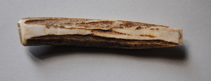

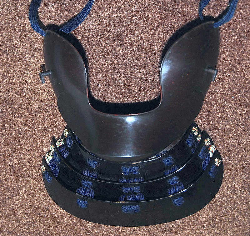

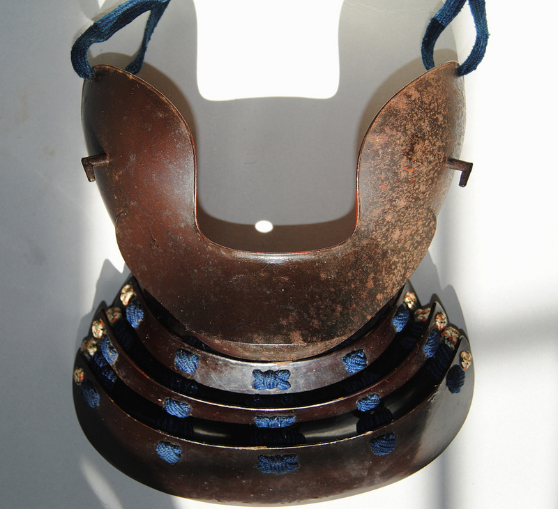

Here is a rust removal process used by Ian Bottomley (Curator Emeritus of Oriental Collections at the Royal Armouries Museum based in Leeds). This was originally posted on the Samurai Armour Forum, Ian has had a lot of experience stabilizing and restoring Japanese armor, his process my be helpful to some forum members.
All, I thought I would just publish details of a russet mask undergoing cleaning. The mask in question was very badly spotted with secondary rusting, some of which had developed into quite bad active rust encrustations. I used my usual mixture of boiled linseed oil thinned with white spirit in a ratio of approximately 50 / 50 - it isn't critical. The mixture was applied with a paint brush over a small area and allowed to soak in for a few minutes before rubbing the area with a chisel shaped piece of stag antler. You can see that it is working because the secondary rust comes off and forms a brown slurry which you need to wipe off with tissue. Some of the bad rusting was particularly stubborn and needed considerable pressure on the antler and repeated applications of oil to remove it. You can tell when you have managed to get the area clean because the antler slides smoothly over the surface. When finished it still looked a bit marked so I resorted to lightly rubbing the oiled surface with fine wire-wool. Again, more rust came off and gradually a fairly clean surface was obtained. I will give it a week or so for the oil to oxidise then I will finish it off with a coat of wax.
Ian Bottomley
I did think long and hard about how to treat these pieces as well as the consequence of doing nothing. I include a picture of the surface of the helmet which I have yet to tackle. You will note the extensive patches of secondary rusting, some of which are beginning to become serious. Rust is hygroscopic, attracting moisture from the atmosphere and converting more of the iron back to its stable oxide. Left alone, this secondary rusting would eventually have destroyed all of the original russet surface. I could have just covered the whole thing in a sealing coat of oil or lacquer, but to my mind it would have looked terrible. Yes, the treatment might take off a minute amount of the original russet, but very little if done with care. I also include an image of the surface of the mask which has had as much cleaning as it is going to get. You will note the slight etching of the original surface where the rust patches were. Sadly there is no way of restoring this damage, only making it as inconspicuous as possible. I will give it a light coating of wax in a couple of weeks which will help. When new, the helmet and mask would not have been covered in unsightly blotches of rust and I see no logical reason to keep it that way. The only downside may be that the surface looks slightly darker. Even this sis debatable since the original russet would have been oiled or lacquered to preserve it. The ultimate fate of all iron is to revert back to its stable oxide. Short of keeping it in a vacuum, all we can do is to try and prevent it reacting with oxygen and water. This treatment will only last a certain length of time, but at least it delays the inevitable.
Ian B

Hah! I got as far as getting the FeCl, but have yet to get round to trying it. Partly this was from caution, partly from lack of a suitable workspace, and partly from a lack of time. We're hoping to get a Heritage Lottery Fund grant for a refurbishment, so (in the hope that we will), lots of frenetic admin activity has been taking place over the past 14 months. It's all excitement and adventure, at least until the money runs out.
I like the look of this process, estrch. I've met Ian - he very kindly came to look at our small collection of Japanese swords from the 2nd World War - and he's a thoroughly good bloke, not to mention exceptionally well-versed in all matters Japanese arms and armour (as you are doubtless well aware). Any preparation with his seal of approval probably deserves a crack; this one, moreover, sounds a lot less potentially invasive than the acid route, albeit far more time-consuming. Only one thing puzzles me - where the hell I'm going to find a bit of deer antler...
- Meredydd (aka Harassed of York)

Antler technique sounds intriguing. New one to me! There seem to be plenty of antlers about on UK eBay. I'm in a rural area myself and shouldn't have a problem to get a piece. The results displayed look promising, however I would imagine steel wool and oil would get the same result?
Not sure. I've worked this barrel quite extensively with wire wool and oil, and although it's removed the looser rust on the surface, it seems to have minimal effect on the tougher, older deposits. It also struggles to remove rust from pits in the steel. Presumably the antler, especially with that shape, is better for scraping it away without being hard enough to damage iron or steel.
The thought has just occurred to me, too, that these "antler" things have been known to fall off strange, quadruped beings known as "deers". Being a city boy, I doubt such things really exist; however, I hear one can actually pick them up in places, if one knows where to look!

Me as well. I sometimes use sharpened pieces of wood, but antler makes sense. It's softer than steel, but harder than rust. Sometimes I coat the surfaces with BreakFree CLP penetrating oil and let the item sit for a week, before I "take the knife" to it. My feeling is that the oil will sufficiently penetrate and soften the rust in that time-span.

Bone would likely be easier to get; antler isn't exactly easy to acquire here nowadays, it seems. I'm tempted to see if I can find an old antler walking stick and trim the handle off, but a lot of these are probably plastic nowadays.
