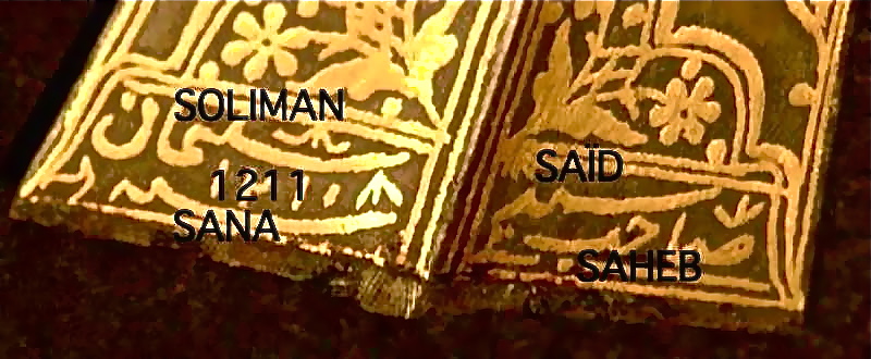

a while ago i stumbled upon this very nice jambiya. The piece is of wonderful workmanship: gold plated silver handle and sheath, wootz blade (sorry for the lousy picture) with gold inlay, ... Unfortunately the blade / tang is broken, but I'll figure out a way to repair this.
If there is anybody able to translate the text on the blade: it would be very appreciated.

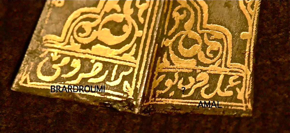

I couldnt read the first inscription fully but the first word is عمل which means: Work of.
the 2nd inscription reads صاحب سيد سلمان 1311 which means: owner Sayed Salman Date 1311 hijri which makes it a 19th century piece? think the 3 could be 2 but i'd leave it to someone with better eyes

Very nice Ottoman Jambiya with wootz blade. Congratulations! I think the date reads 1211, which is 18th Century (1796). however, this type is typical of mid/late 19th Century Balkan jambiya. Good luck restoring the tang, definitely worth the effort. Make sure not to overheat the blade!

Salam Aleikum "alnakkas"
the name of the blacksmith was might be Persian,
the second word is "brardroumi" and there is a sign illegible in Arabic
for the digit 2 and 3, me too, at beginning I was confused,
but almost of time we found the character is like in printing,
not in form writing
Arabic English
SAHEB OWNER
AMAL MADE BY
SANA YEAR
à +
Dom

Wa'alaykom elsalam
its interesting that they write it in the printing form rather then writing form. great info!
