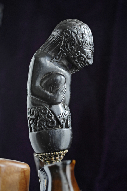

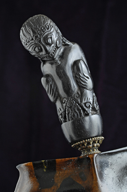

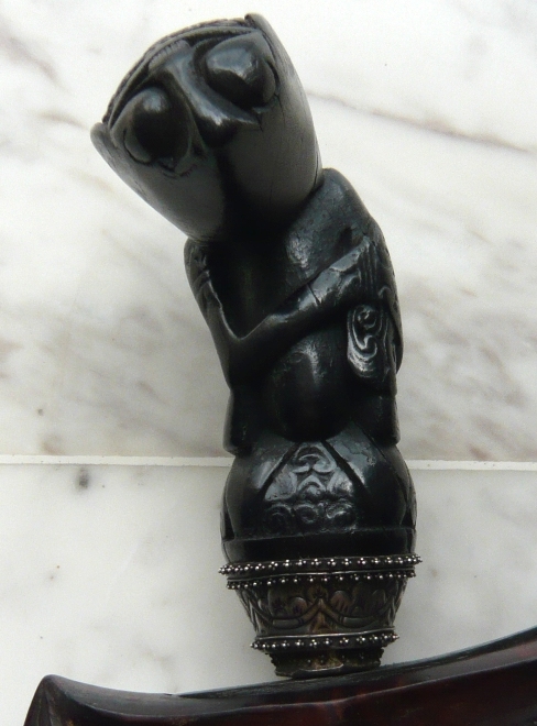

OK, everybody did pretty good with the Jamberooni hilt.
Here's another little mystery.
I've always thought this one was from somewhere around Alpha Centauri.
Anybody got any other ideas on origin?

I'm surprised no one has responded to this post yet. I certainly don't have an answer for you Alan, but i do like this little fella quite a lot. Love the face, the eyes...definitely something alien about them...

No idea here either but I'd say the answer to origins is not so much in the figure to start with but more perhaps in the floral triangular motif to the base...

OK, I venture on the opinion that this piece comes from Lombok and that it is not a kris hilt but used for a dagger or a betel nut crusher. I would not swear that I am correct of course!

Thank you gentlemen.
I'm virtually certain that it is not a pelecok handle:- too big, the hole fits a keris tang well, is too big for a pelecok, it came off a keris that came into Oz a long time ago. Regrettably I do not remember what sort of keris it came off, it was one I bought maybe +50 years ago that needed a lot of work on it, and at that time I was not interested in the same things with keris as I am now.
So --- where have we seen that triangular floral motif before?
Any more suggestions?

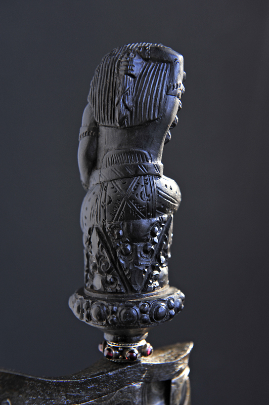

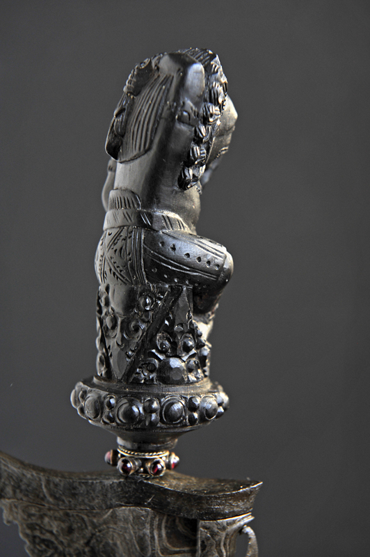

I see variartions on this triangular floral pattern often in Bali hilts and i believe as well in some hits from Madura.
Old 3rd December 2010, 09:55 PM   #8

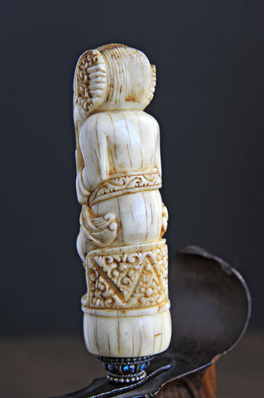

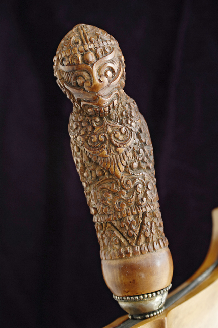

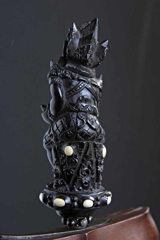

Here is a hilt that i am fairly convinced is from Madura.
Old 3rd December 2010, 09:56 PM   #9

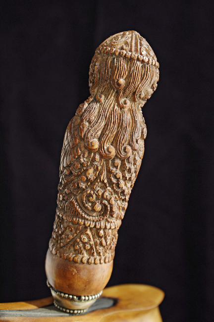

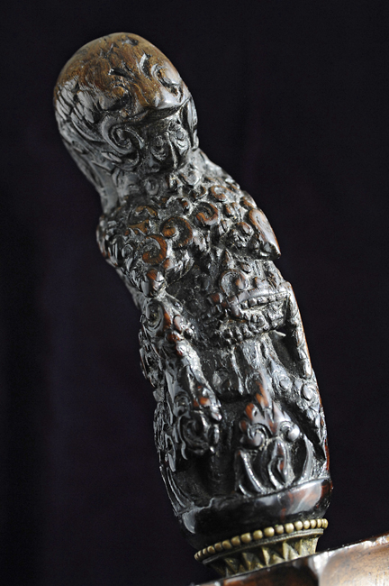

Posts: 7,303
Of course i think one could also link the pattern on these Javanese hilts to the first example, so it seems to be a pattern shared by the 3 islands at least.

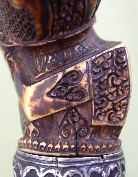

Posts: 7,303

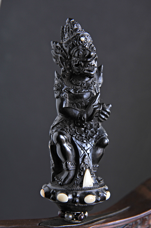

Here's another Bali example, this time, unfortunately, not in my collection...

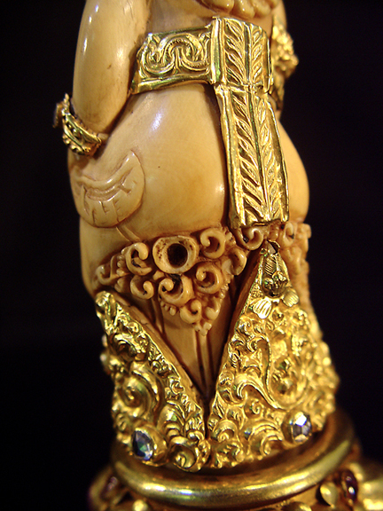

Posts: 1,180
Not just Sumatra, but also in N. Peninsula (see silver coteng pic at the bottom), but the thing is that the form of the motif is not the same. In Sumatra/N Peninsula, the motif is fatter/rounder. Anyway, the hilt Alan posted has a style that does not seem to be from the Sumatra/Malay side of the Archipelago, but more of the rounder, more naturalistic forms I thought is usually found on the western side of the archipelago. Ok, this is my guess, but let's see how far off I am.

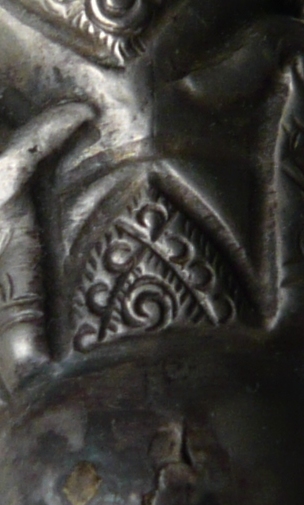

Would anybody care to look closely at the execution of the carving and and the way in which this tumpal motif has been rendered?
Perhaps these things may provide a clue.
This hilt is 124mm. (a little under 5inches) long.

Alan, what is the line around the lower abdomen seen on the front view, is it a belt or just a ridge.
david
Old 4th December 2010, 04:46 AM   #16
Posts: 7,255
David, that photograph is deceptive.
It looks like a line, or maybe even like a kangaroo pouch, or the top of a sarung, but it is none of these things. Its just the protruding lower abdomen and the way the light strikes it.

Posts: 7,255
Jean, I cannot see anything Hindu at all in this hilt. The tumpal motif goes back a lot further than the Hindu influences in Maritime S.E, Asia.
I really do not know where this hilt is from, so I'm just looking at it the same as everybody else. However, I do have a couple of small advantages:- I've got the thing in my hand, and although I've forgotten what sort of keris it came off, I do know that at the time I got it, I was buying mostly Bali & Lombok keris.
It is too big for a Jawa keris, and that makes it too big for almost any other keris, except Bali & Lombok.
It lacks the refined quality of even a village standard Bali hilt & the overall feeling of the carving is very much like a lot of the stuff that we see coming out of Lombok.
I am very much inclined towards a Lombok origin for this hilt, but I'm more than ready to listen to any other suggestions, especially if a little bit of supportive evidence could be included.
