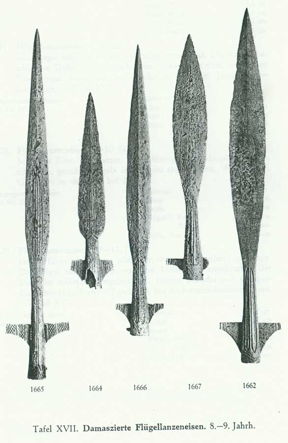

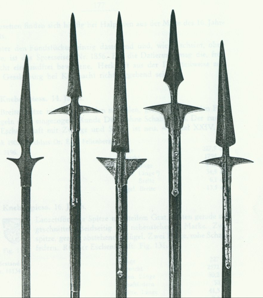

Flügellanzeneisen, according to Rudolf Wegeli, Inventar der Waffensammlung des Bernischen Historischen Museum in Bern, vol. III, Stangenwaffen (hafted arms), 1939, were the older and basic forms, 8th to 9th century. Straps were not present yet.

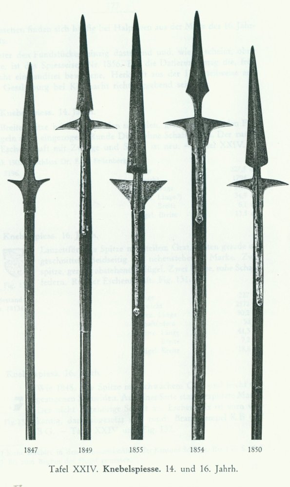

What Cesare illustrated were their followers, called Knebelspieße, Swiss and Italian, 14th to 16th centuries, with haft straps.

Hi Michael,
Wow, the Knebelspiess labeled 1855 looks almost exactly
like Cesares pieces.
Only difference is that the straps are located
on the broad side. Maybe that gives a hint on where and when they are produced?
Putting the straps on the broad side makes the lance
more robust agains winding forces after the target has been hit. The way Cesares lances were mounted would make them more robust for slashing attacks.

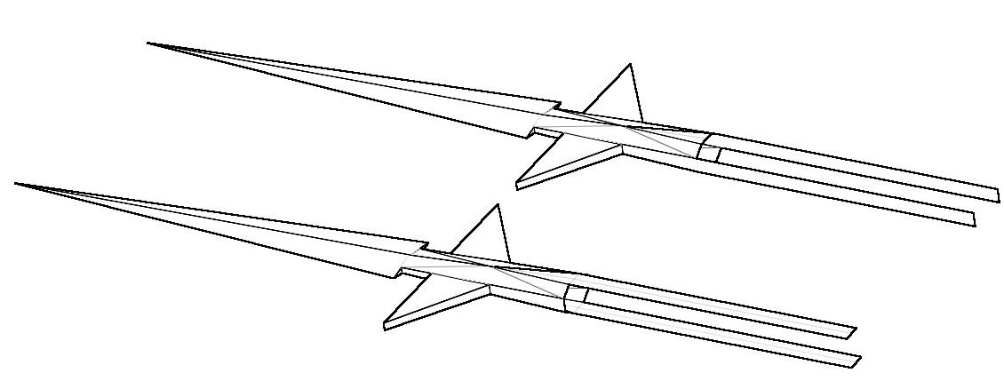

What kind of drawing do you have in mind?
Something like this?
mrwizard is offline   Reply With Quote

Exactly!
The most important thing is that they clearly show the different places of the straps, as mentioned by you.
m

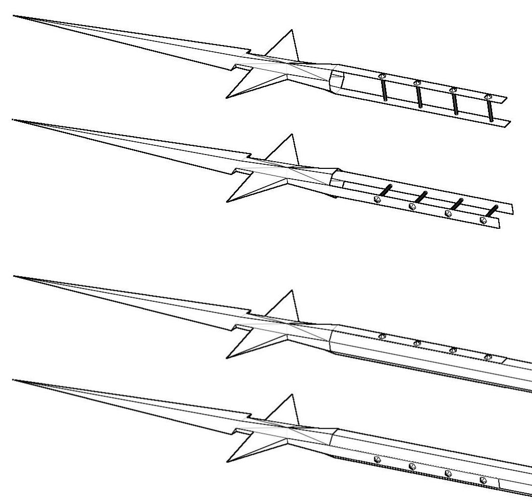

3D-modelling is fun, so I just made another image with rivets attached and with the shaft attached.

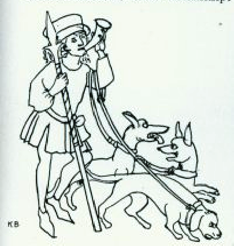

Picking up Michl's post #3 ...
...That guy blowing his horn and holding his dogs (Fig 130 from Bern manuscript by Boners Eldestein) suggests some familiarity between the lances being discussed and those used for hunting. The first of such lances had no "wings" or "ears" and date from classic antiquity. As very often they penetrated to deep into the game's body, allowing the animals that used to fight back (bears and boars) to reach for the hunter, a cross bracket was developed in order to retain the lance head at a limited depth. This device was implemented in Portugal by the XIII century, some later than in other countries.
This tipe of hunting lance was called in Portugal "Ascuma", a term that tends to disappear from modern dictionaries. This word derived from the German "Asc", meaning "Esche" or "Ash", due to one of the selected woods used in their shafts.
Illustrated are a boar hunting scene by Gaston Phoebus (XIV century) at the Paris National Library and an engraving from the Tryumph of Maximilian (1526), showing bear hunters with long ascumas.
Can one actually consider these hunting lances predecessor to chiaverine?

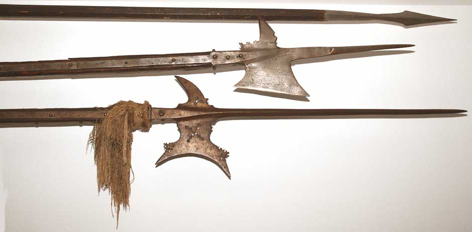

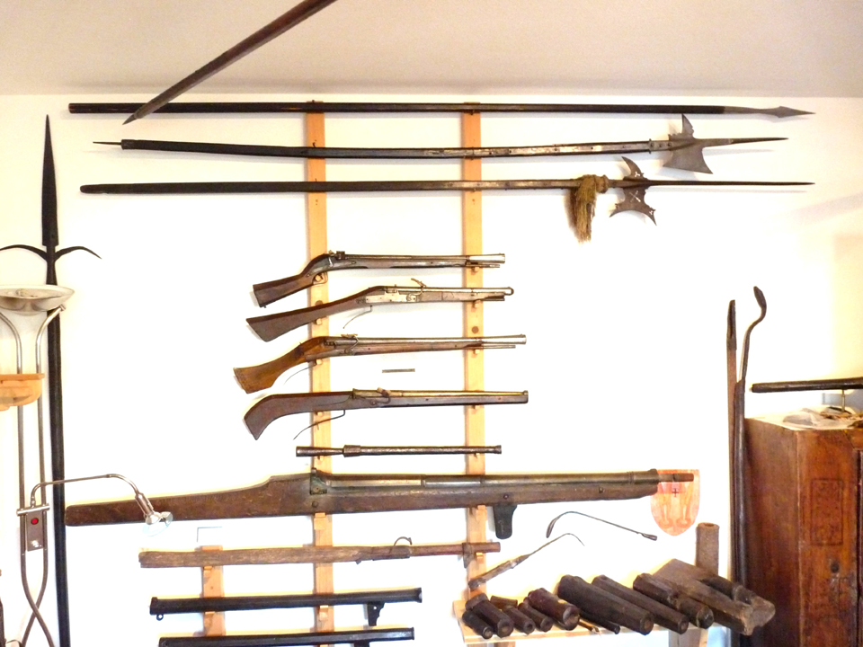

Clever input indeed, 'Nando,
Though I am not expert enough by far to competently answer your query I am sure that the spears shown by Gaston Phoebus were the formal predecessors of the so called Froschmaul-Spieße (frog's mouth spears) that came in use in the times of Maximilian I, and the heavy bear or boar spears depicted by Hans Burgkmair in the Triumph of Maximilian were widely in use for hunting from at least the 15th to the 18th centuries.
I attach images of the Maximilian frog's mouth spear from the Graz armory, ca. 1500-20, and cut down to 2.60 m in the 1560's, in my collection (on top of the halberds).
Michl

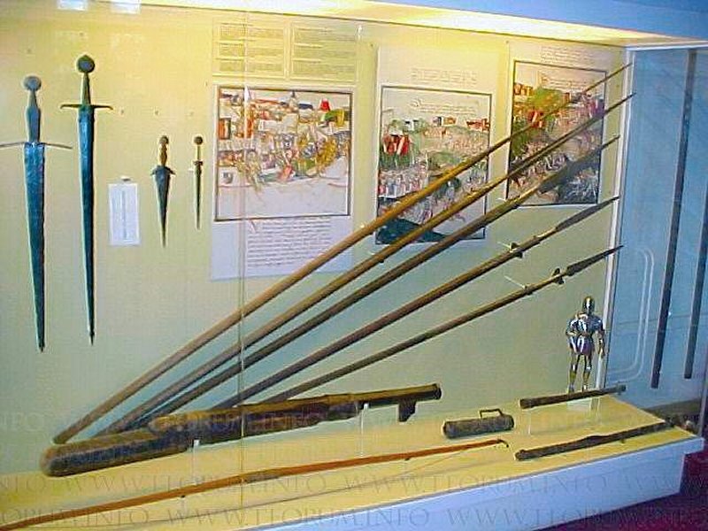

Matchlock
Matchlock's Avatar
Join Date: Sep 2008
Posts: 4,310
Two more Bohemian earspoons, ca. 1460-70, in the museum of Schloss Grandson, Switzerland (the two below the group of pikes).
m
