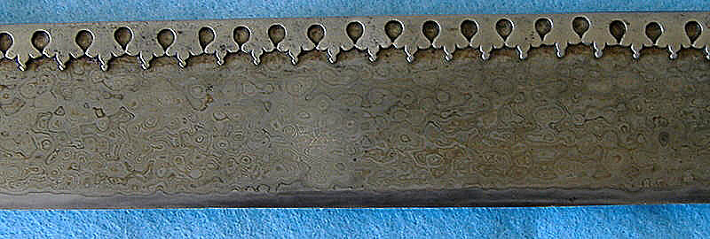

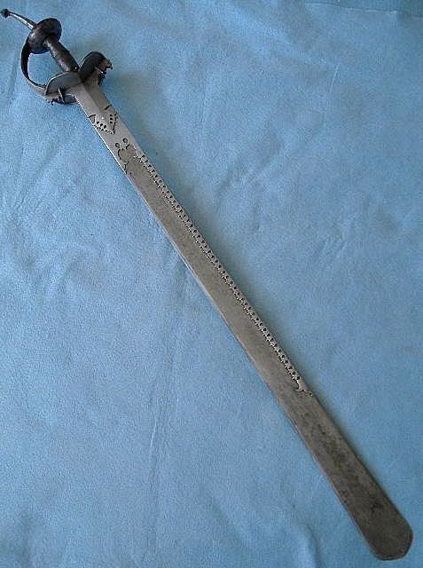

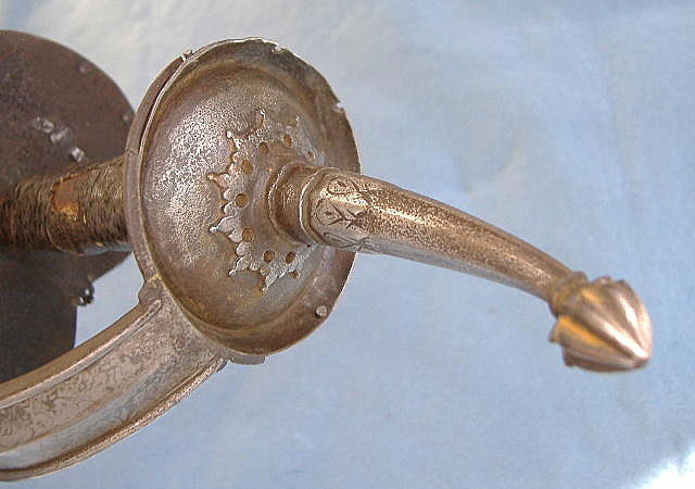

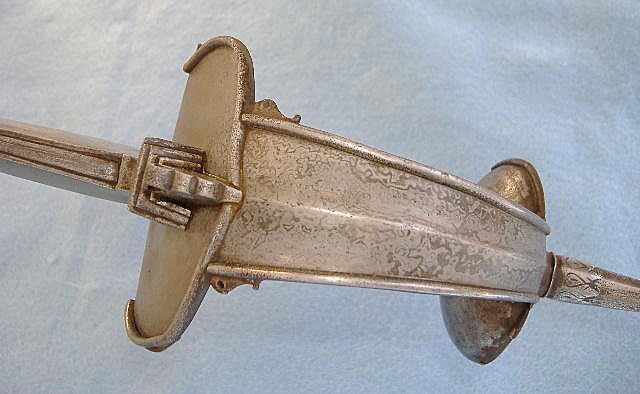

Here you go.

Its beautiful mate! Is that the much emulated 'birds eye/raindrop' pattern?
Seriously, its jaw dropping! Whats the overall length?
Old 8th November 2010, 10:53 PM   #5
Lew
Lew's Avatar
Location: East Coast USA
Posts: 3,191
Will need to measure it when I get home but my guess is the blade is 32-34 inches long. Yes it's a form of birds eye but more random then the modern stuff.

Nice pattern welded work all over, made by a craftsman. It's likely to be Deccan, and maybe it is 18th century, but it could also be older.

The sword is quite solid the blade is thinner than I imagined it would be at about an .125 inches thick. The edged is quite sharp even the tip has a cutting edge. The hilt is quite comfortable even my big hand fits with no pinching or binding. The sword is heavy but not unwielding. Grasping the back spike with my left hand helps stablize the sword when swinging it.

Lew, this is a stunning example, and I would go with the 18th century attribution in the classical blade form, and wootz above all!!
The spatulate blade is an especially nice feature as well, but then there are so many here. One of the nicest of this period Ive seen for a while. The sharp edge on this type point is because the Mahratta greatly favored wide shashing cuts in thier sword technique.
I very much agree with Jens (of course!) on the Deccan attribution.

The blade is pattern welded

Nice to see the patterning in the guard too and the blade does show a good tight pattern.
