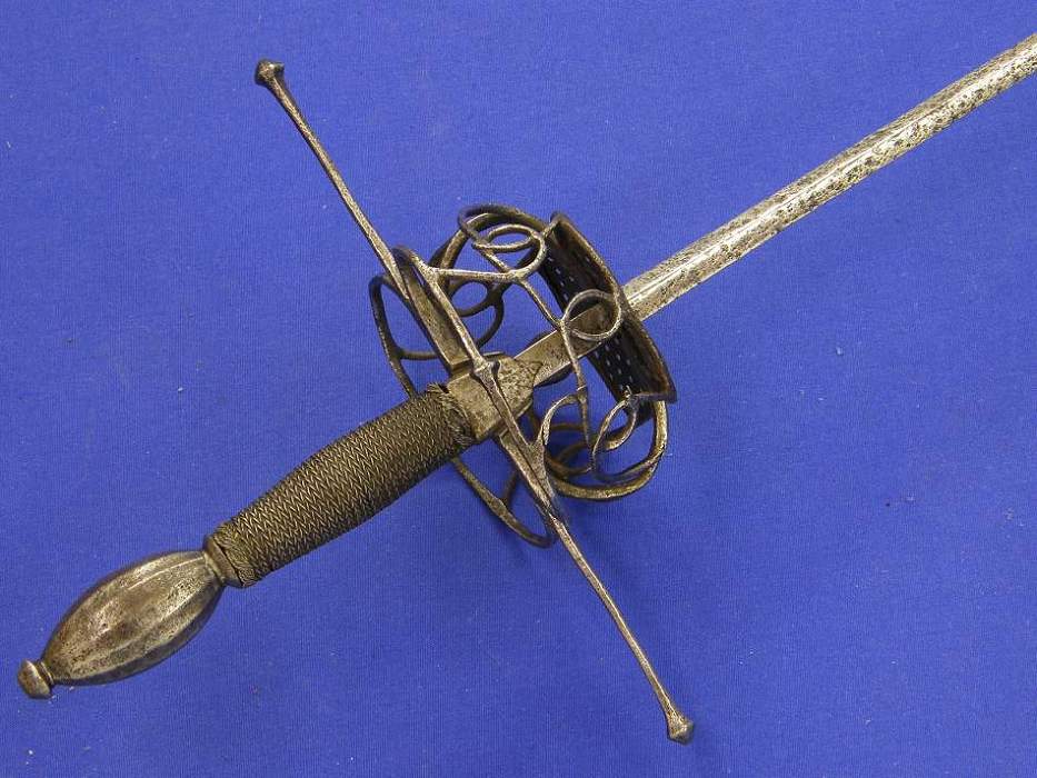

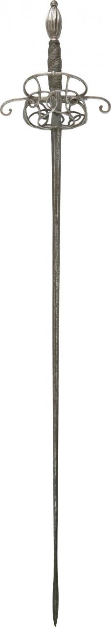

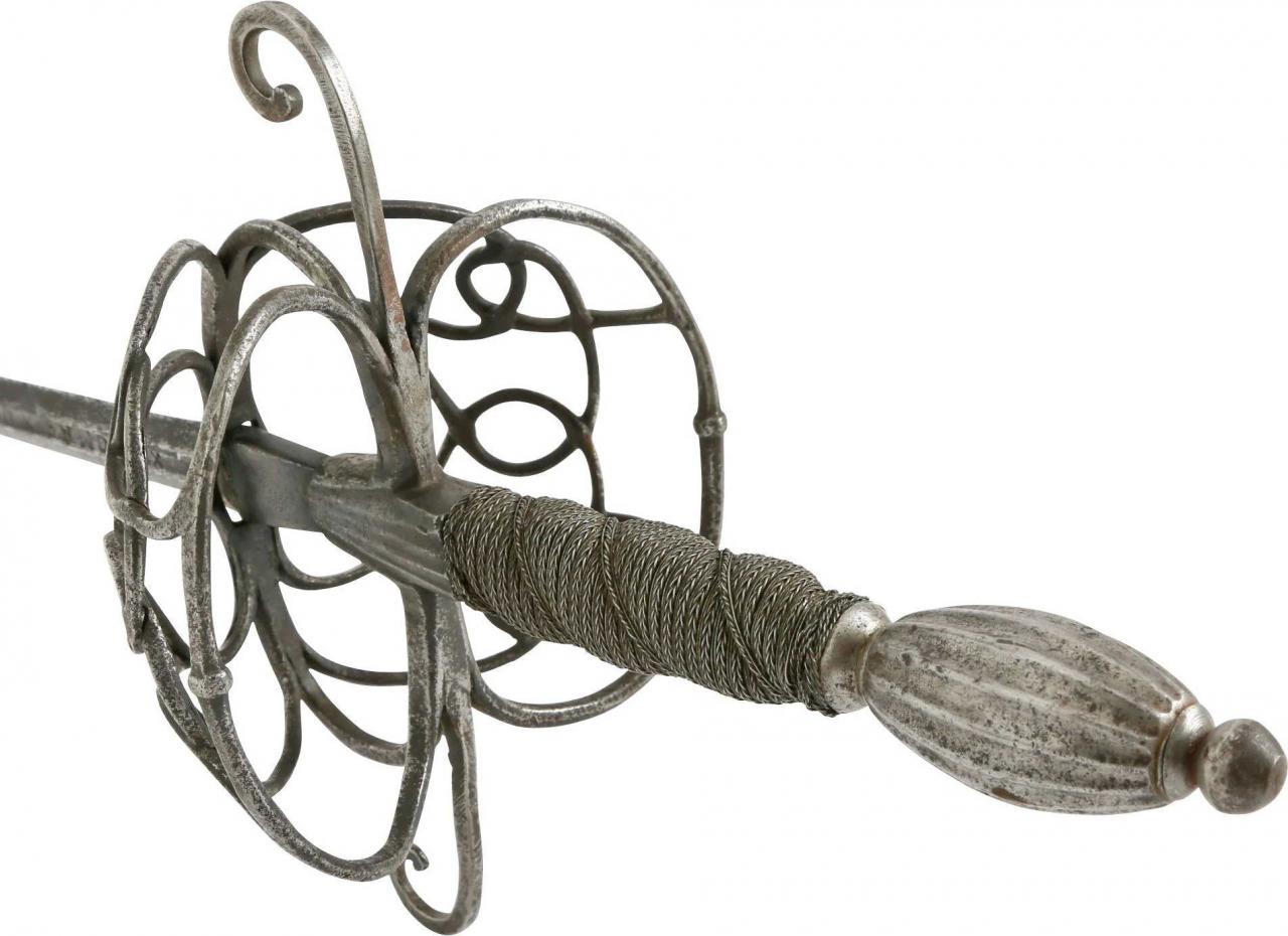

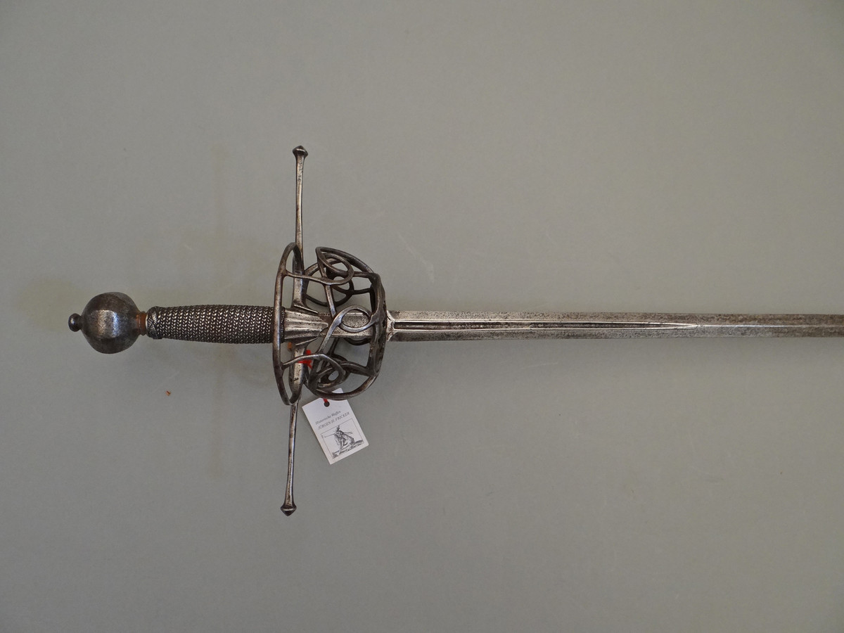

Would you agree this is a XVII century "Milanese fencing school" rapier?
The estoc blade has a diamond cross section and measures 107 centimetres (over 42") not counting the ricasso; with a width at forte of about 13 mm (1/2") and a thickness of 7 mm ( less than 5/16").
Single deep fuller in 1/5 of its length and point of balance 5 cms (2") from the guard.
Do i see a Pappenheimer touch in the guard little basket ... married with a swept hilt (lace) concept ?
But what do i know ?
I am not even at home to check on Norman's, to try and classify the pommel; a sturdy one, by the way!
Any coments on tis piece, Gentlemen?

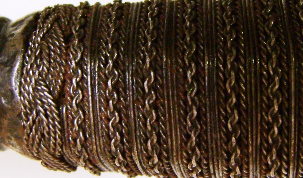

It is no surprise that the wire wrap may not be the original one, as so often happens. I don't think however that it is a modern work, but has probably taken place during its service life. It is a perfect job, with a rather intrincate wiring and embelished with two little turk heads.

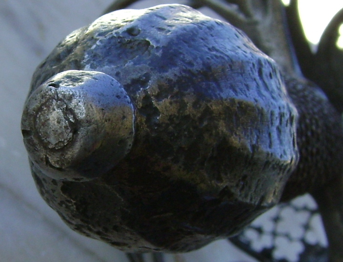

The pommel obviously is in excavated condition as compared to the rest of the iron parts.

Herewith a couple close up pictures of the grip wire wrapping, to help try and discern its possible age.

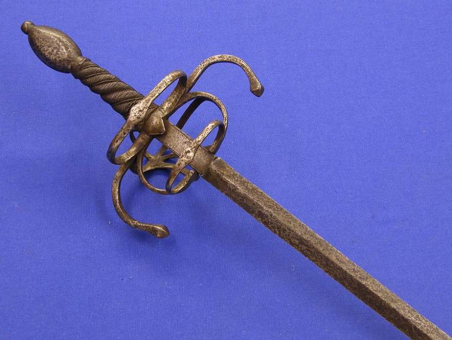

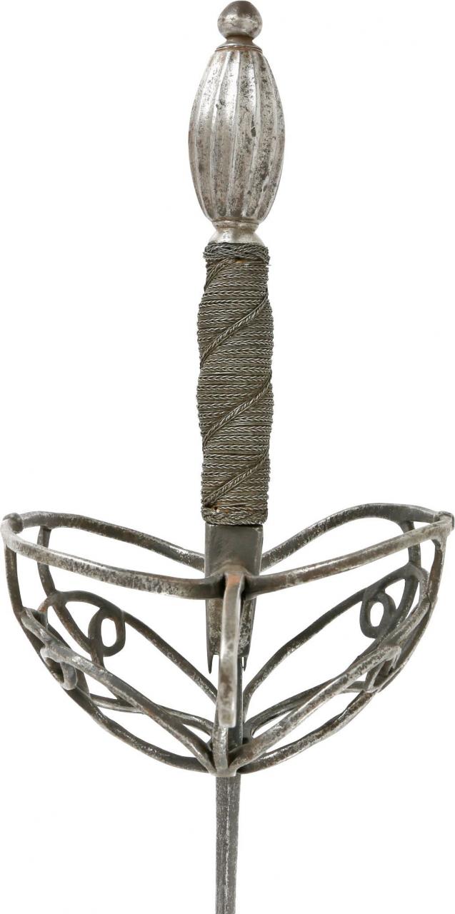

herewith some pictures that will help you to digest the matter of the pommel
and also helps me to confirm the German origin.
best regards

No kidding ... you have just convinced me; this now becoming easy to digest .
Some of the details are extremely familiar.
What references have you on this example; does it belong to your collection?
You know ... it even looks like the quillons in mine were also originaly straight, having been bent at a certain stage, to please some later owner's tastes.
What do you say of this?

The fact remains though that the pommel is in excavated condition and could never have originally belonged.

Because mostly the pommel is touched over the time by hands here one sees more severe pitting.
This kind of deep of deep und irregular, but not crisp pitting is typical of excavated finds that were heavily grinded with sandpaper in order took better. The main part of the pommel is almost never touched by the hand, just the grip binding and hilt are. The homogenuous surface color seems to be a good repatination probably using olive or crude linseed oil and a yellowish lacquer. It can be achieved within hours.
In contrast, the surfaces of the blade and pommel of the piece you posted are obviously homogenuous and belong.
Not necessarily so.
Such judgement may well be most influenced by the quality of pictures, which in many cases tend to distort the actual colour of objects.
These were taken by night, with flash, so achievement is not close from real .
Looking at the lower close up picture in my post #10, we observe a more stabilized situation ... though yet not perfect.

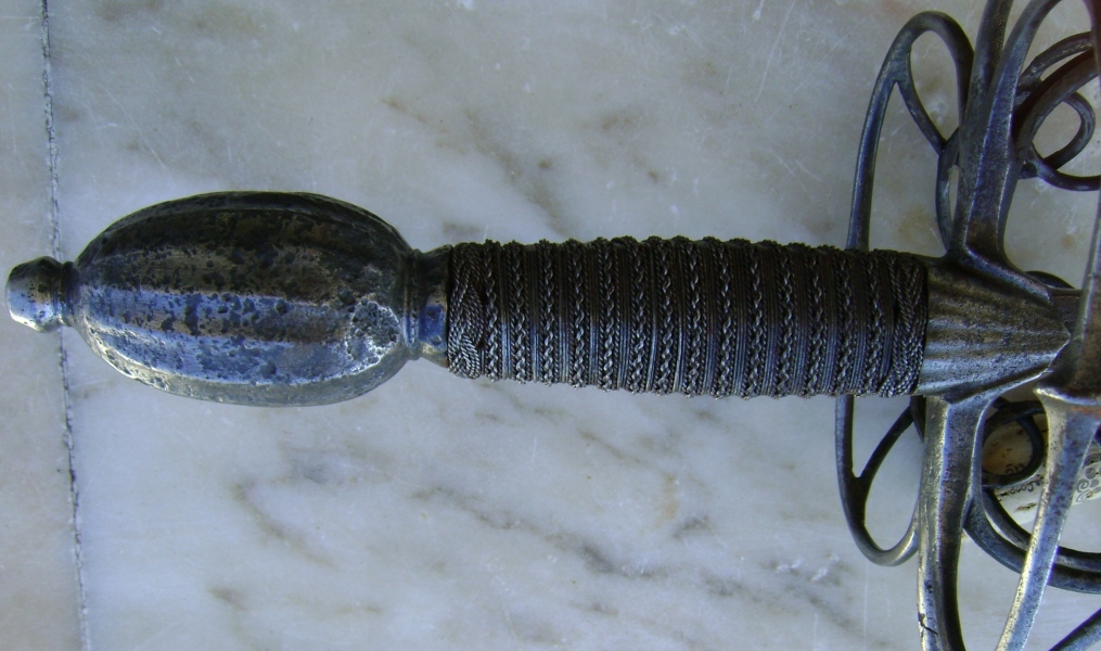

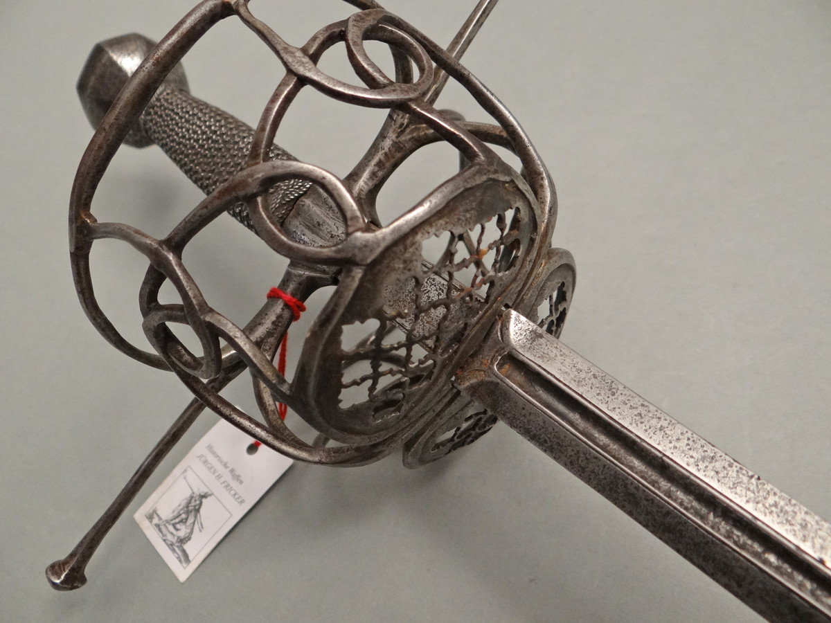

no, my vote goes to ORIGINAL.
the color of the metal and the pitting is consistent with other parts of this rapier.
Very well put and shown, Cornelis.
Old 3rd November 2010, 09:22 PM   #28
Matchlock
Matchlock's Avatar
Join Date: Sep 2008
Posts: 4,310
Originally Posted by cornelistromp
That exactly the right size and type of pommel is found is way too coincidental.
There are hundreds of detached original pommels in various conditions on the market every year, and almost all of them are purchased by dealers and forgers. Can you image the reason?
Old 3rd November 2010, 09:38 PM   #29
cornelistromp
cornelistromp's Avatar
Join Date: Mar 2009
Posts: 1,071
Hi Michael,
of course I know and see a lot of replaced pommels, especially on medieval swords. recently I noticed a cast one at a London auction house which gave
some discussion just before the sale.
I must admit it is very amusing to see that you changed your mind on this pommel from an inapt English ground find to "maybe" belonging to this piece
Kind regards from Holland
Old 3rd November 2010, 11:00 PM   #30
Matchlock
Matchlock's Avatar
Join Date: Sep 2008
Posts: 4,310
Hi Cornelis,
Please remember we all had to rely on photos, and almost anything is possible ...
Though I usually have a well based opinion at the point of posting, I try not to be too dogmatic.
Good night and be well,
