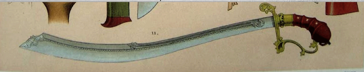

I started looking into info on these and got a page from a book by Schmeltz about these weapons. Mine seems to be almost identical to the one pictured there. The book is from 1892/94 I think so my guess was that this BB or PN was from that time or older.
Is there any more info around?
When did they appear and untill when were they used?

Here is the picture I meant from 1892/94 in the text by Schmeltz.
Regards, Erik
