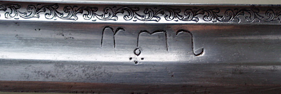

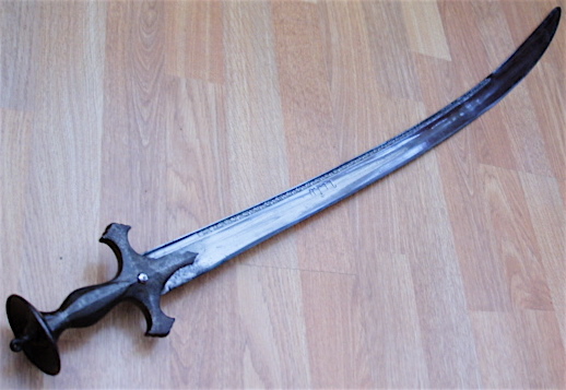

Hi Andy,
I wonder if you could show the attached to your friend Farid. So far it has defied translation, the text may or may not be inverted! Many thanks in advance.
My Regards,
Norman.

Hi Norman,
I have taken a picture to show Farid, hopefully I will have something to tell you tomorrow!
Andy

Hello again Norman, sorry, no luck with the translation- Farid failed to recognise the text but his offer still stands and is very willing to help where he can. Regards Andy.

Hi Andy,
Many thanks to you and Farid for giving it a go.
My Regards,
Norman.
