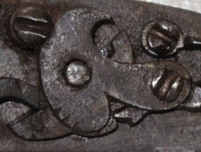

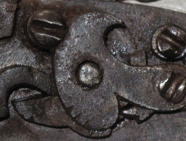

As requested, some pics of my new toy. While working on her today I have found a curious problem: this breech obstruction, which seems to defy explanation.
My first thought, as one would expect, was that I had found some powder and shot. This seemed to be confirmed when the first thing I fished out of the barrel with my rudimentary auger was a piece of canvas-like cloth which was, presumably, acting as wadding. I poured water down the barrel and, with some tapping, it disgorged a tide of black powder, rust and probably many years of fouling into the sink. So far, so good. However, at that point things became weirder. The ramrod simply will not go all the way down the barrel ramming end first; it sticks around an inch from where it should be. Likewise, my copper cleaning brush stubbornly refuses to hit the breech plug. However, the thin end of the ramrod will go all the way to the bottom of the barrel, making a satisfying clank as it does so. My first thought was a ring of fouling obstructing the passage of the much broader ramming end of the rod, so I set to work with the brush, rasping away in the hope of dislodging something, and poured boiling water into the barrel three times.
This, strangely, has merely deepened the mystery. There definitely is a constricted area; the brush was having the devil of a time passing it, though I think the combination of hot water and vigorous scrubbing has dislodged a great deal of whatever it is. The water emerging from the touchhole and muzzle was pretty damn mucky, brown with black flecks in it, throughout this process. But the brush, in turn, stops dead about half an inch short of the breech, as does the ramrod's ramming end; yet the narrow end of the ramrod will still pass the obstruction. Perhaps a corroded ball, I thought - but a ball so loose as to let water flow past it, out of the muzzle, would surely either roll out of the barrel or be dislodged by a few good knocks. Fouling? If so, why is there nothing impeding the thin end of the ramrod even when I press it against, and can hear it scraping, the barrel wall down to the bottom? Very odd. Any ideas, chaps?
Anyway, as promised, some piccies. I expect I've bought a complete dud, but I love her anyway; a real fixer-upper's opportunity, with character and a fighting pedigree.
Pictures are:
1) Barrel bands. 2) Interior of lock. 3) and 4) Interior of stock in lock and breech area. 5) Overall of stock showing carvings. 6) View of carving just behind barrel tang. 7) Exterior view of lock. 8) Trigger guard. 9) Overall, showing underside of stock. 10) Overall view, right-hand side. 11) Top view. 12), 13), 14) Barrel bands and fit to barrel, also pan, frizzen and tang. 15) Muzzle and ramrod. 16) Muzzle. 17) Left-hand side of stock, including the Immovable Screw of the Kandahar. Ramrod shots are self-explanatory.
RDGAC is offline   Reply With Quote

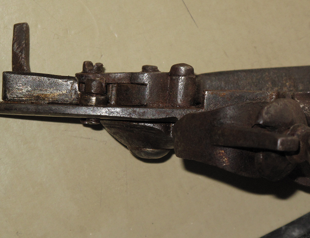

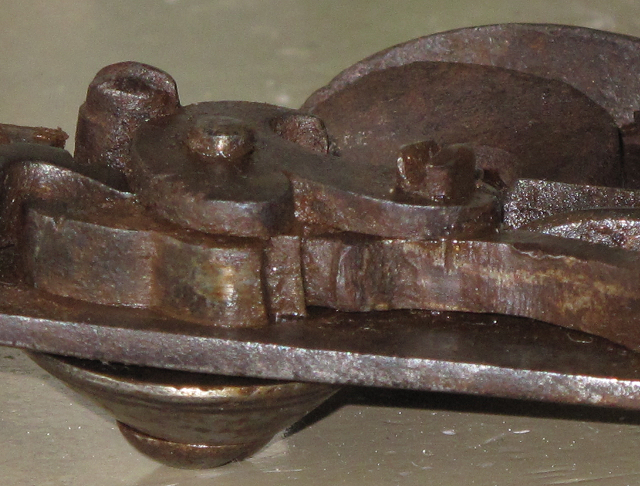

And more pics, as per list above. Sort of. They've got muddled to hell, but I hope you can work them out until I get back from kendo.

The slot in the small end of the ramrod was undoubtedly intended for twists of tow, or patches cut from rags, for wiping the bore and applying preservative oil.
Stuck screws are a bane of antique gun repair. Often the slots in the screw heads are so worn that it's hard for a screwdriver to get a good grip. In these cases it would be helpful to "refresh" the slot with a very thin file (gunsmiths and machinists have special screwhead files for this purpose which may be ordered from specialist catalogs). Good screwdrivers are a necessity, for gun work the blades need to be ground with parallel faces (not the usual taper). You can modify a screwdriver yourself with small knife sharpeners embedded with diamond dust (they're made for sportsmen to carry about easily in pocket or tackle-box) if you don't have a set of hollow-ground gunsmith's screwdrivers. Ideally you should have a screwdriver whose blade fits each screw precisely, and with old guns there is no real standardization so the more the merrier. The wonderful thing about the UK is that you can still find those old Victorian-era cabinetmakers drivers with the bulbous wood handles and flat shanks (ideal for putting a wrench to if you need more torque) -- you can get them in second-hand shops for next to nothing and for this purpose they work better than anything made today.
When a screw is stuck it could mean one of two things (1) the threads are rusted and/or (2) the shank is frozen in place by hardened grease. Applying penetrating oils and WD40 can work, although you shouldn't let too much of these soak into wood fibers. Judicious application of heat often does the trick. A propane torch with a tip which brings the flame to a micro tip is handy providing you don't singe any wood. An electric soldering gun often transfers enough heat to either expand the metal enough to "crack" the rust, and soften hardened gunk. Light taps with a brass hammer can also help dislodge rusted threads.
I'm at a loss to explain that odd obstruction at the bottom of your bore. If it were a ball, it should have come out after you pulled the wadding, and before you reached the powder. From your description I imagine a "donut" of some hard stuff that just admits the small end of your ramrod down its center. What is the caliber of the barrel? Do you have a "worm" attachment for your cleaning-rod -- the thing that looks like two heavy corkscrew points turning alongside each other? If you used a worm that's pretty close to your bore diameter, its points should be able to dig into the donut and if it's lead, some telltale shavings should fall out to confirm what the thing really is.

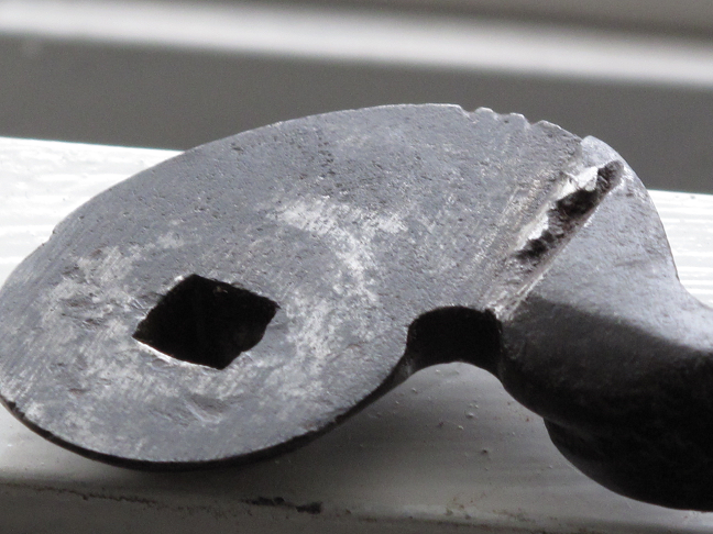

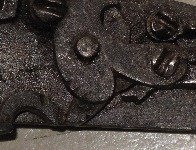

Now, on to the malfunctioning lock. What you have is severe wear on the tumbler notches and the sear nose. The full-cock notch needs to be carefully filed so that it has a square "step", not the rounded hump that's there now. The sear nose must also be shaped to mate with this indent precisely (carefully note the position of the two components when the lock is in a full cock position, to guide you in making the angles in the detent and on the nose just so.). The half-cock notch needs to be undercut slightly to allow the sear nose to lock into it. (there is a diagram on p. 150 of Lister's book).
If the hammer catches on the half cock detent as it falls, it means that the radius of the tumbler is worn out-of-true. Try and correct the sear nose and the full cock detent first, then work on the half-cock. By restoring the full undercut in the half-cock detent, you'll be filing the radius of the tumbler a bit smaller in the area between full and half cock (i.e., setting the radius closer to the axis-pin.) You can then dress down the radius below the half cock, reducing the diameter of the tumbler at that point (but not so far so as to compromise the undercut). This adjustment of the radius is usually enough to cure the "half cock grab" syndrome.
You might also want to be sure that the mainspring and tumbler move with out undue friction against the lockplate, or against the tumbler bridle. Minimize friction and the lock becomes "faster" and that helps prevent half-cock grab, too.

Philip, thank you very much indeed for that useful information, in particular for putting me on to Lister's book; surprisingly it seems it's relatively easy to get hold of a copy (I'm looking at one going for ten quid, used) and I have no doubt that it shall serve me well.
Regarding the tool you suggest, I'm not really very well equipped, and nor is work; we don't actually own a vice (nowhere to put it even if we had one; our behind-the-scenes areas are based in a three-story Georgian townhouse) and I've been pondering whether a small G-cramp would be strong enough to hold the mainspring in place, to allow me to remove the tumbler. Having buggered up the barrel I'm in no rush to do the same to the lock.
In any event, I think I can probably manage to scrounge up the materials you suggest; a small hacksaw and the like will doubtless not be expensive, allowing me to cut the way you suggest. Whether I can do it well enough to make it work is another matter, but I did buy this guy intending to learn about working on flintlocks, so I guess I'll have to learn by my mistakes. A thought occurred to me last night, too: would a long, hollow metal tube with a sharpened end be useful? My theory was that a good steel cutting cylinder might allow me to cut the copper strands and/or the fouling (or whatever it is, which was definitely starting to give under repeated jabbing with my auger), and permit the whole lot to drop out of the muzzle.
Regarding the lock. If a G-cramp is strong enough to hold the mainspring in the right position, what of the sear return spring (is this the correct term?) and the frizzen/pan lid spring? I'm not eager to do this and then find I can't get the bloody sear or frizzen back on the lockplate; speaking of which, I'm fairly confident that the cock is rotating pretty freely. There's a good, wide clearance between the two, and the cock certainly moves smoothly when the trigger is pulled, despite snagging on the half-cock notch.
Incidentally, it's good to see that I have a well-worn lock; it makes me very happy to know that this old beast has seen some serious use!
Edit: A thought that occurred to me over lunch is that the threads on this lock are, by and large, adequate at best. Indeed, as mentioned, the fore screw of the lockplate is dire, with the thread barely cut into its end, giving it very little purchase on the lock itself. Interestingly, however, the tang on this barrel is threaded into a small hole just above the plug, and seems to have been made fairly well (it certainly holds together, when suitably tightened); a later addition, perhaps. I'd suggest, as an explanation, that perhaps cutting the large, deep threads necessary for a threaded breech plug, with sufficient consistency in quality to form a reliable gas seal, was beyond the ability of most local metalworkers, if the evidence of their smaller screws is anything to go by. Indeed, the tang screw on this jezail is square in section for most of its length, and none too straight at that.

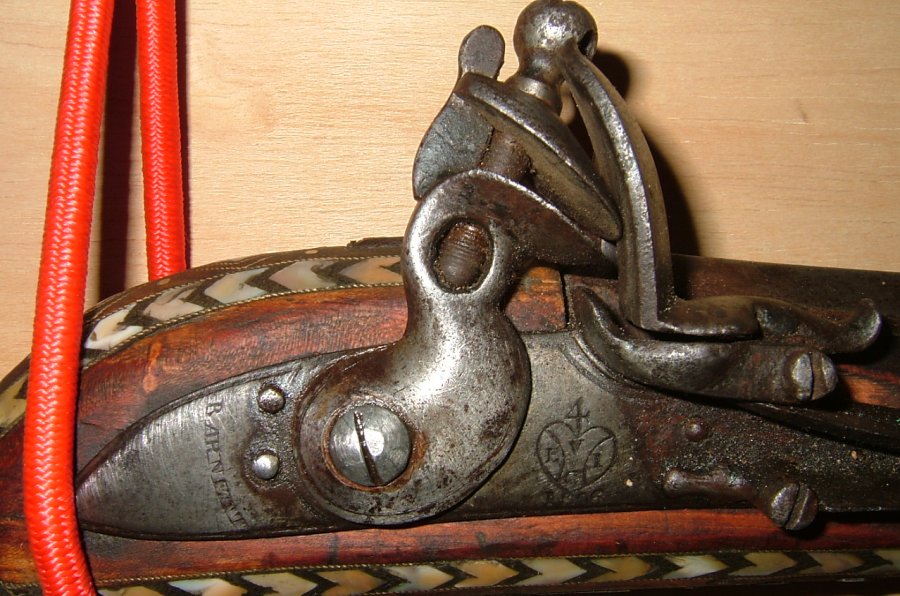

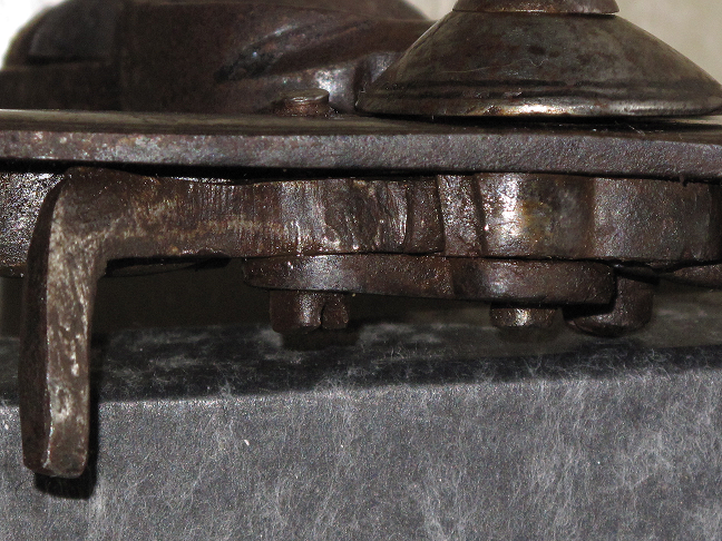

Herewith some photographs of the lock, courtesy the incredibly dimwitted works camera and a lot of patience. I've been test-firing the lock a couple of times, and discovered a couple of points:
1) Having removed, oiled and partly cleaned the cock, it moves smoothly and with a minimum of friction, so far as I can feel.
2) The half-cock notch appears to be both corroded and clogged with god-alone-knows what, but removal of some of this with a small steel pick has not improved results; the sear still grabs the half-cock, and halts the firing movement unless the trigger is kept depressed.
3) If the trigger is depressed, the gun will snap to half-cock and then discharge from there, albeit very quickly - the cock scarcely has time to slow down, but there are two distinct, audible clicks as the sear first releases from the full-cock position and then catches the half-cock notch, so far as I can tell.
No doubt I'm teaching my grandmother to suck eggs, but I hope that the photos show the asymmetrical wear on the tip of the sear itself and the very heavy wear on both the half and full-cock notches. I'm also concerned that the toe of the mainspring is barely being held in place by the tumbler in the "fired" position, which may explain why bringing the gun to the half-cock takes a surprisingly strong pull; certainly much more than the works percussion jezail's lock, which may of course be rather later and is now in better nick.
Edit: And, as promised and somewhat late, the pictures. In order:
1) Lock in full-cock position. 2) Lock in full-cock position, from bottom left and showing wear to notches and sear. 3) As #2 but from bottom of lock. 4) Lock in half-cock position. 5) Lock in fired position. 6) Lock overhead view, showing clearance between cock and plate, fired position.

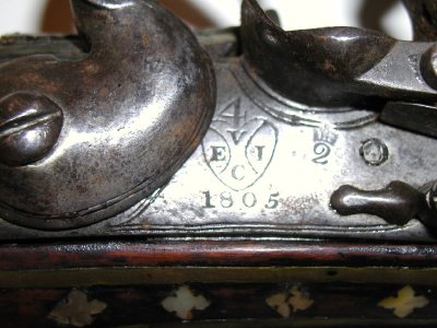

Congratulations on this outstanding piece of history.....which is clearly every bit as rugged as the Khyber regions from which it came!!! This is all the better as it obviously has stories to tell.
Its fascinating watching you going through the disassembly and working on the restoration, and as a complete novice at guns, the information provided by Philip, is pretty amazing in the detail......this is probably why I know so little on guns!! way complicated, and me with zero mechanical skill.
What I do have is my ever present curiosity on markings, and this old balemark is amazing. The old heart topped by a 4 was the old East India Company 'balemark' , which was a merchants mark used to identify goods.
These were typically placed on the locks of guns as well. What is interesting is that the typical EIC balemark seen has the heart quartered, with the initials VEIC in the quarters (United East India Company, the V is seen as a U).
The configuration seen within the heart on this is the much older EIC balemark, interestingly applied with other than EIC initials. The 'I' character is not only applied flanking the 4 within, but in a five place sequence on the lock where 'TOWER' would have been.
The 4 was a key element of merchants balemarks as it was an often used cabbalistic symbol appealing for protection and good fortune and as such on the marks hoped for the best as materials were transported. The individuality of the markings and initials in them of course were identifiers.
What this signifies to me is that this lock was either faithfully reproduced by a native locksmith, interpolating symbols or characters that were known to him in interpeting the old markings seen on other early locks. As we have discussed, such markings were often seen by natives in thier own talismanic perspective, and as such must have been imitated with some of thier own application. Since this early form of balemark was from around mid to somewhat later 18th century, it sets the mind to wonder just how long this old flintlock was around.
I think there is far more to the story of this old 'camel gun' than we yet realize, and need to think more on it as this intrepid restoration continues.

I just wanted to add my 'concurrent thread' to add some comments that I have discovered after my last post, and addressed to RDG. I wanted to add them here rather than editing them into my last post so as not to be overlooked.
As I previously noted in my last episode, these markings appear to be based on the earlier flaunched version of the EIC balemark. The two key characters selected to place within these markings are the 'I' and the '4', and where the TOWER mark would have been, the I is placed in a sequence of 5, in the same curvature and configuration.
I would suggest that the prototype for this lock's markings may well have been from an earlier East India Company gun from regions to the south in Sind, where the Company was well present after the mid 1750s after securing diplomatic relations with Talpoor. The East India Company heart shape marking in variation seems to have prevailed into the mid 19th century with the Scinde Dawk stamp, however weapons by this time were being marked with the rampant lion.
It seems quite feasible that flintlocks with the old flauched heart balemark ended up to the north in Khyber regions, and were probably remounted numerous times as well as copied by local gunsmiths. The gunsmiths of Darra Khel are world renowned for thier work at fashioning modern style guns with only the basest tools and technology. This type flintlock was probably done sometime in the early 19th century by a local artisan in Khyber regions.
Like Rick, I cannot stop thinking of Kipling's quintessant words, 'ten rupee jezail' ! Beautiful !!! History in your hands RDG.

Aha - I did wonder when Jim would smell interesting local markings Like leading a mouse to cheese... and once more I learn. I'd no idea these were referred to as "balemarks" for a start, let alone that this enormous, engraved "4" was something more sophisticated than a local artisan's attempt to replace something he couldn't copy - I really rather feel I've unjustly maligned him, long dead though he is, and it just goes to show the danger of letting preconceptions run away with you. This is especially poor, on my part, since he obviously made the rather elegant border around the periphery of the lockplate as well.
Now, as to the age of the lock, it does rather set the mind wondering, but here we come up against another question: although this duplicates a style of lockplate decoration seen in the mid-to-late 18th Century, at what point did the Khyber gunsmiths acquire the skill of making the flintlock? In fact, another question must be asked: am I wrong in thinking that the reason many jezails made during the 18th and 19th Centuries used a captured British flintlock was that its mechanical complexity (or some other aspect of the design) taxed local gunsmiths beyond their means, for some time?

Bravo, I think you've come up with a potentially workable solution to that stuck brush: cut the bristles with the sharpened edge of a metal tube! The copper wires aren't very thick, after all. How about filing the end of the tube into saw teeth, get them as sharp as you can. It'll be a variation on the "crown-saw" that locksmiths use to bore holes in doors to install doorknob kits (or what surgeons use to drill holes in our heads to get at the gray matter inside, haha!). Lemme know how it works!
Now, I don't recommend using C-clamps to compress those V-shaped springs. The clamps are just too unstable on such surfaces, the main- and frizzen springs are pretty powerful. I suggest that you buy a mainspring vise, available through suppliers of gunsmith tools and those firms selling supplies to shooters of black-powder replica firearms. These handy and inexpensive devices are articulated to fit just about any size of flint or percussion mainsprings and frizzen springs (they will do also on wheellocks, but won't work on the huge external mainsprings of Spanish or Near Eastern "miquelet" locks due to their size and the way they're mounted, but the average collector has little need to disassemble those locks). The small sear spring can be restrained with a pair of needle nosed pliers. Just pinch the spring enough (use tape on the plier jaws) to relieve pressure as you back the screw out just enough to allow the spring to rotate free, then release and continue unscrewing.

Thank you for noting my post RDG!!! and you're right, when it comes to markings, Im there.
I have continued researching of course, and while you guys get the restoring and gunsmithing dilemmas sorted out, Im still busy with this lock.
As might be expected, the deeper I study, the more I find out, and the history of these balemarks is of course a bit more complex than just a simple progression in form. I had thought, per various sources, that this quite different 'flaunched' heart with the initials was an older version of the EIC heart, and that does not seem to be the case. One of the best resources I have found has to do with the coins (Olikara would be proud!!
It is quite unclear exactly when these balemarks of either kind began appearing on arms, but it seems that about the turn of the century is a good guideline. I have seen coins with the quartered balemark, dating 1780s and 90s, but not on weapons. What is curious is that the flaunched balemark appears on a copper coin minted in Calcutta in 1786...before that they were using simply a quartered initials obverse...in 1787 they were back to the quartered heart.
The suggestion is that the flaunched balemark seems to have been concurrent with the quartered heart, and appeared on dated, marked EIC locks around 1806. It remains unclear what took place before that, and with the seemingly singular appearance of the flaunced design in Calcutta in 1786.
Therefore my idea of an earlier EIC gun or lock does not seem valid, and the appearance of prototypes that might have been copied by this artisan, probably Afridi from Darra or Adam Khel, were likely of the guns illustrated in attached here.
Interestingly, the makers names, in this case Barnett and Leigh, appear on the lock tail. For British government locks this practice ceased in 1764, with the word TOWER replacing the makers name.
The Afridi smith, of whom many who illiterate, likely used the stamps he had available in fashioning the marks on his lock.....the I letter placed faithfully in the same curve as the TOWER marking which he had probably seen on the British government locks, in the number of 5 marks. The design of the EIC heart he had likely seen on similarly marked guns he duplicated, again using the letter I and repeating the 4.
The suggestion here would now be that the lock was probably fashioned sometime in early to mid 19th century using an amalgam of British markings as models in this grouping.
Much as I once read someone said, the thing I love best about history is that its always changing
The two locks with makers names and the 'flaunched' (semicircular heraldic design) configuration; the more familiar EIC quartered heart; and the EIC rampant lion which began use c. 1808.

Re the spring....yes you only need to move it enough to release it from the sear. That should mean that it can be swung down (if of course you can not safely remove the retaining screw).

Today I have begun treating the stock, applying wood wax in order to try and give it some additional lustre, as well as protect it from further damage as best possible. Prior to this I applied a layer of lemon oil, which the wood seemed to absorb (or which evaporated) with remarkable speed, and effected some improvement. While doing so, I have begun to wonder about the three curious notches, cut with precision and even spacing, present on the tumbler. Any ideas, while I continue waxing?
Edit: Just observed some corresponding notches on the cock, as well as some very nice file-marks showing exactly where they finished it off. Photo included (for real, this time! ).
