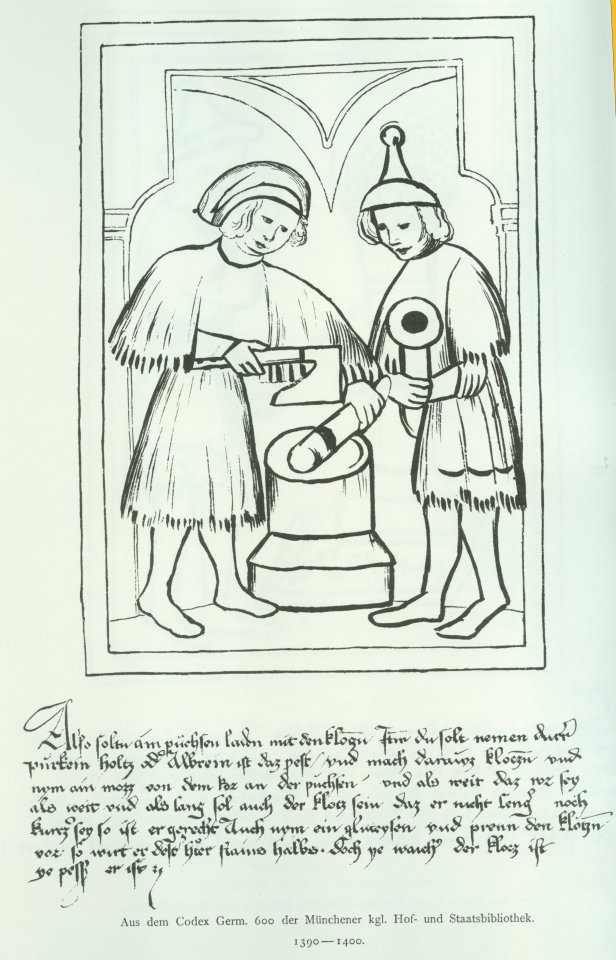

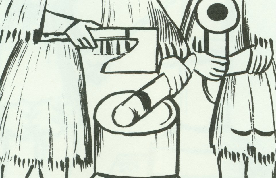

Chipping off wooden plugs or wedges for plugging the stone ball near the muzzle.
From Codex germanicus, cgm 600, Munich, ca. 1390-1400.

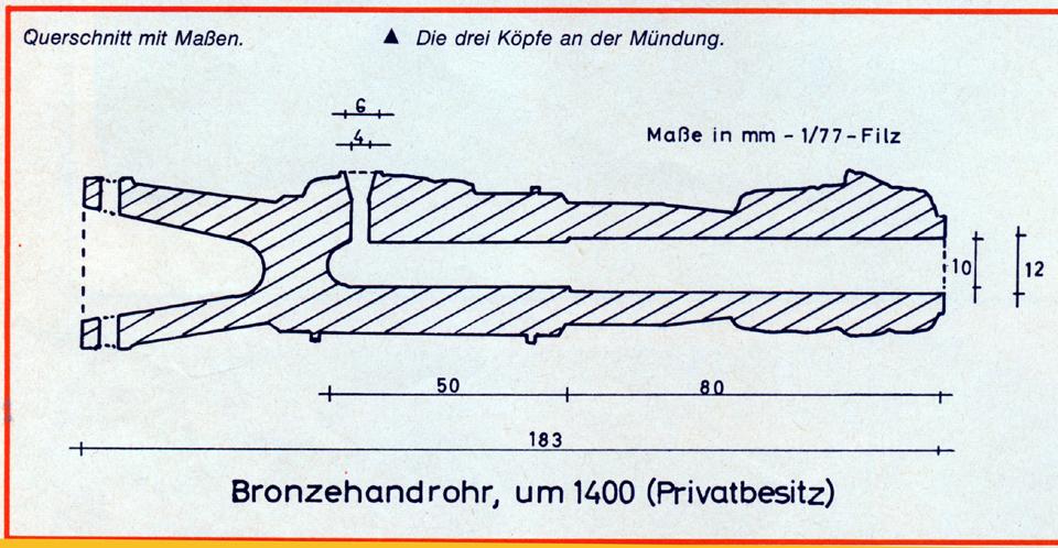

Here is a cross sectional drawing of a ca. 1360-80 small bronze handgun barrel which proves that the ball reservoir (or should I say ballroom? ) of this special gun is notably longer than the powder chamber.

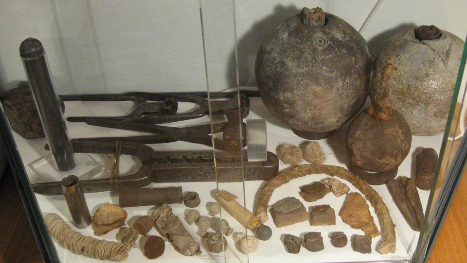

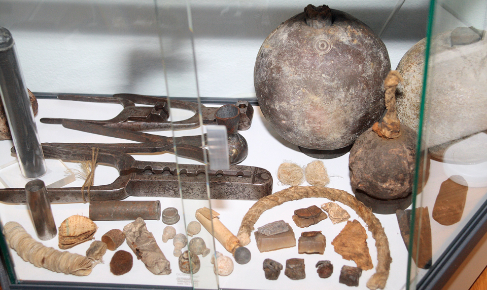

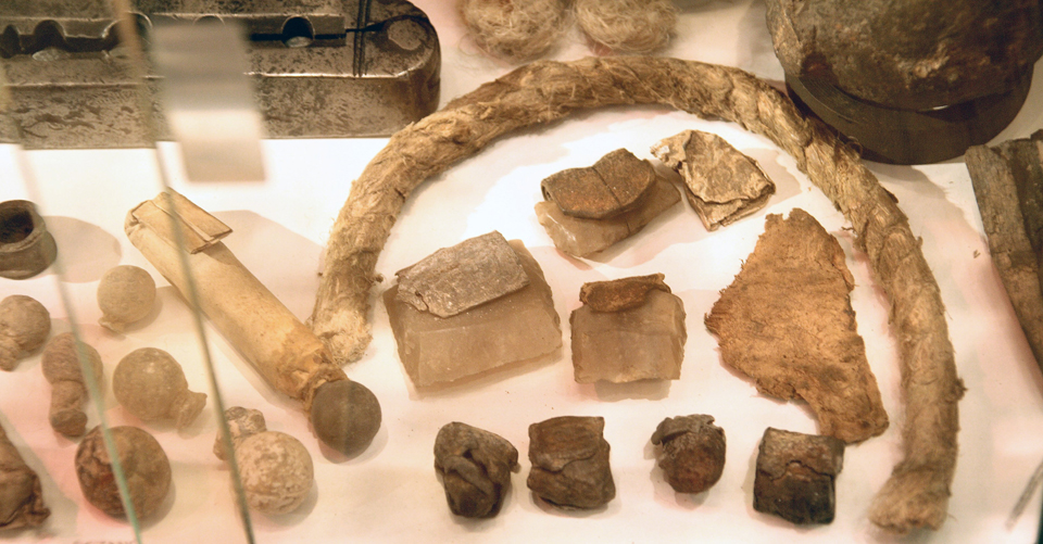

O.k., here are the real things from my collection - ammunition from five centuries:
- extreme left, standing upright: a glass with a ball and powder load extracted from a ca. 1470 Nuremberg bronze haquebut barrel; the powder pillar measures about seven ball lengths!
- next from left: ball moulds from ca. 1500-1580
- foreground left: linen patches, 17th-19th centuries, felt plugs (waddings) of the same period; paper cartridges, 16th/17th centuries, and cast lead balls retaining their sprue (German Gusszapfen) for binding into a paper cartridge
- foreground, right half: two hemp waddings, a length of matchcord, a piece of tinder, French 'blond' gun flints retaining their lead or leather linings, and excavated reddish brown pyrites for wheel-locks retaining their original lead lining (Bleifutter)!
- background right: earthenware grenades and a small iron hand grenade, Thirty Years War, all retaining their original fillings and fuses!
- a fuse cut sectionally, made from a thick dried grass stem and hollowed out to receive the powder line still present!
These are by far the greatest rarities ever to get your hands on, and not even available in the big museums!

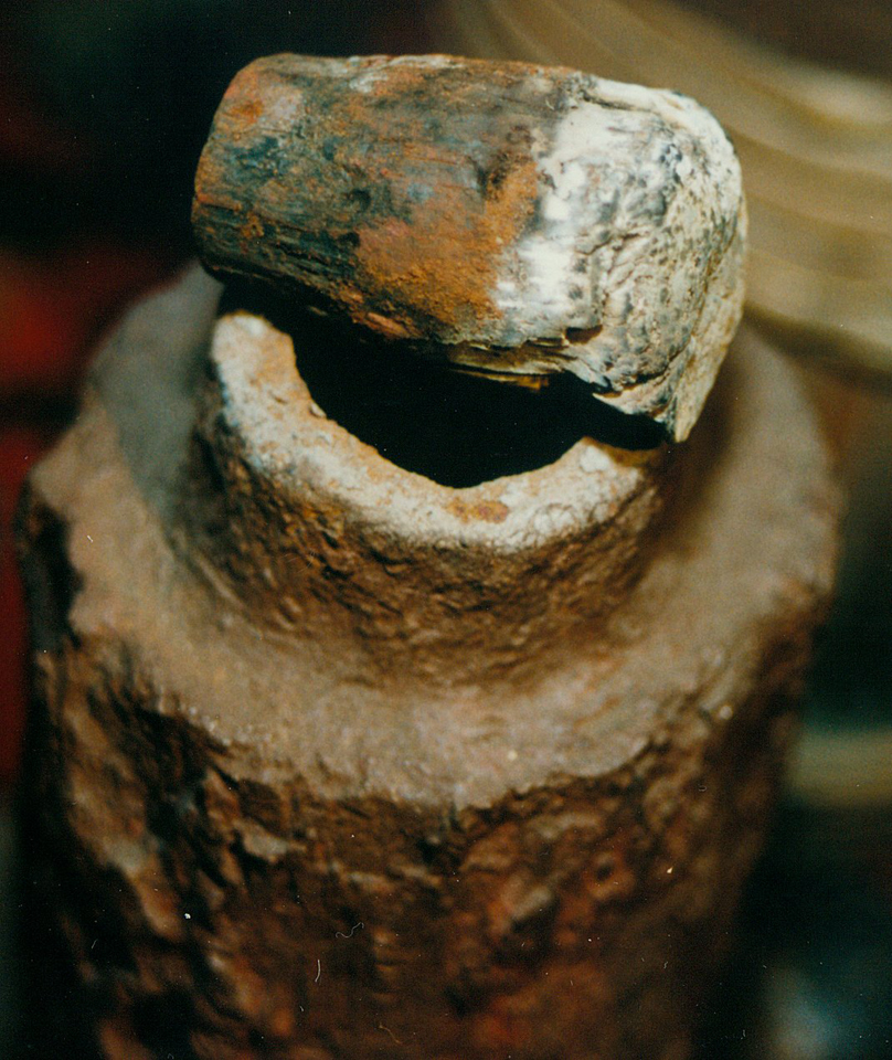

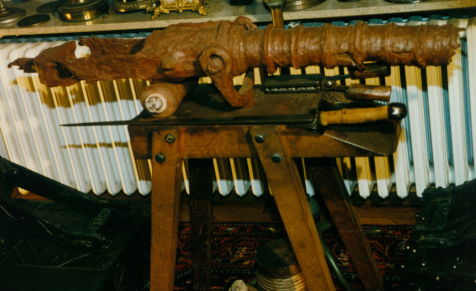

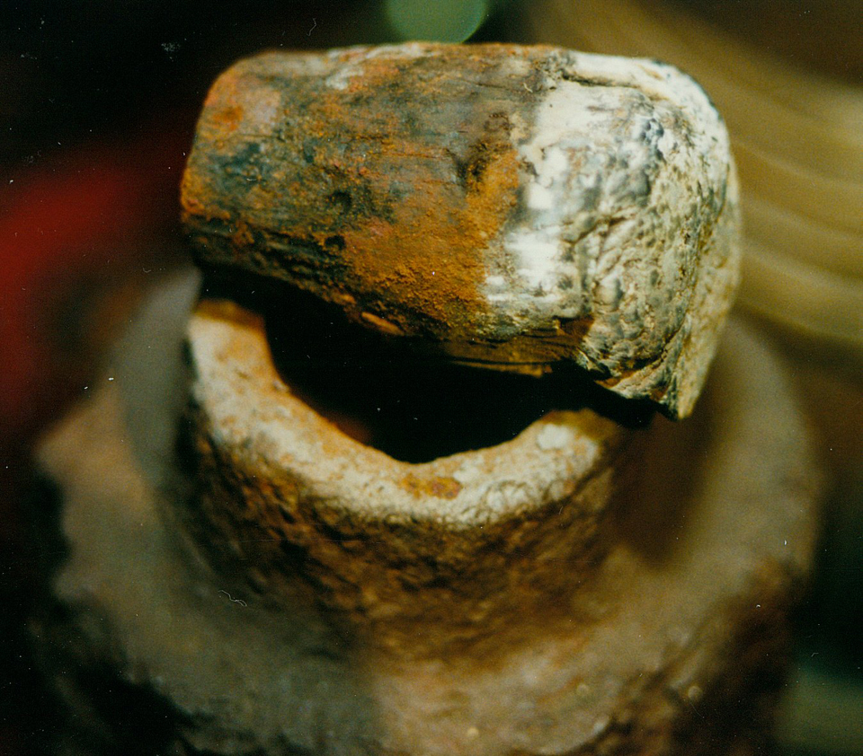

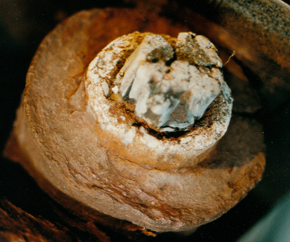

This a mid-15th century wrought iron breech for a breech loading cannon retaining both its original powder load and wooden wadding plug. In the case of breech loaders, the ball was shoved in the barrel from behind manually before the breech was put in and plugged by a wooden wedge at the rear.
Of course, this 15th century rapid firing method only made sense with a number of loaded breeches right at hand.

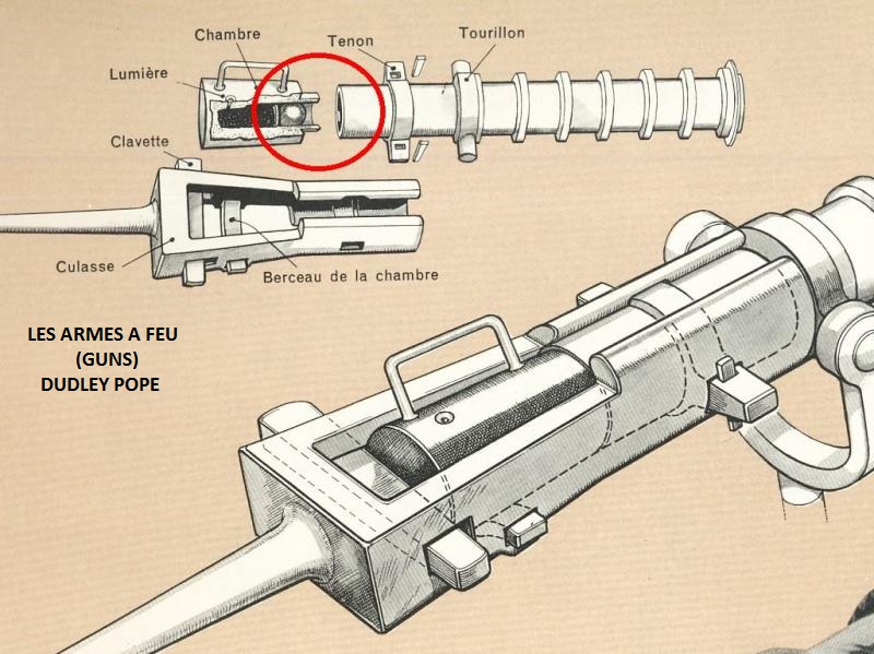

Say, wasn't there a version of chamber (breech-block) in which the ammunition ball was also plugged into its mouth, instead of shoved into the barrel?

Hi 'Nando,
Not to my knowledge. It's extremely rare to find such old things still loaded but the fact alone that these breeches are notably narrowed denotes that the ball must have been loaded separately.
In the late 15th to 17th centuries when small iron cartridges were used with breech loading long arms and hand firearms, they might have also contained the ball. All this is mere speculation though; I do not know of one single small iron cartridge that would still hold its load.
That should prove to all of us how little we actually know of these weapons.

History of Alexander about. 1459
Spiridonov is offline   Reply With Quote
Old 10th August 2010, 02:15 PM   #18
This is what partly influenced my doubts.
I see that probably D. Pope was giving wings to his imagination
Old 10th August 2010, 06:08 PM   #19
Spiridonov
Spiridonov's Avatar
Join Date: Nov 2008
Location: Russia, Leningrad
Posts: 355
written sources of the 15 th century (artillery manuscript) says that chamber was charged without the ball. I can find original text if you want
Old 10th August 2010, 06:42 PM   #20
No need Alexander; it is enough if you say so.
Also Michael has the same conviction.
This drawing was only to justify my query.
Old 14th August 2010, 06:45 PM   #21

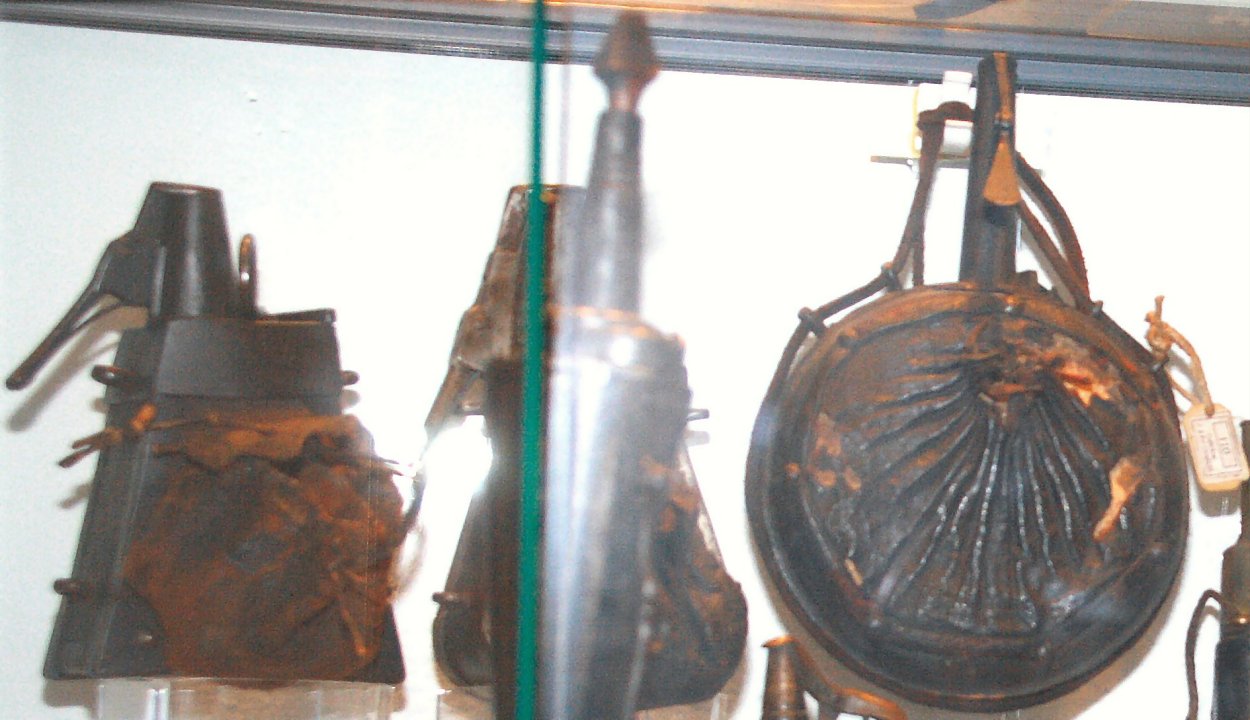

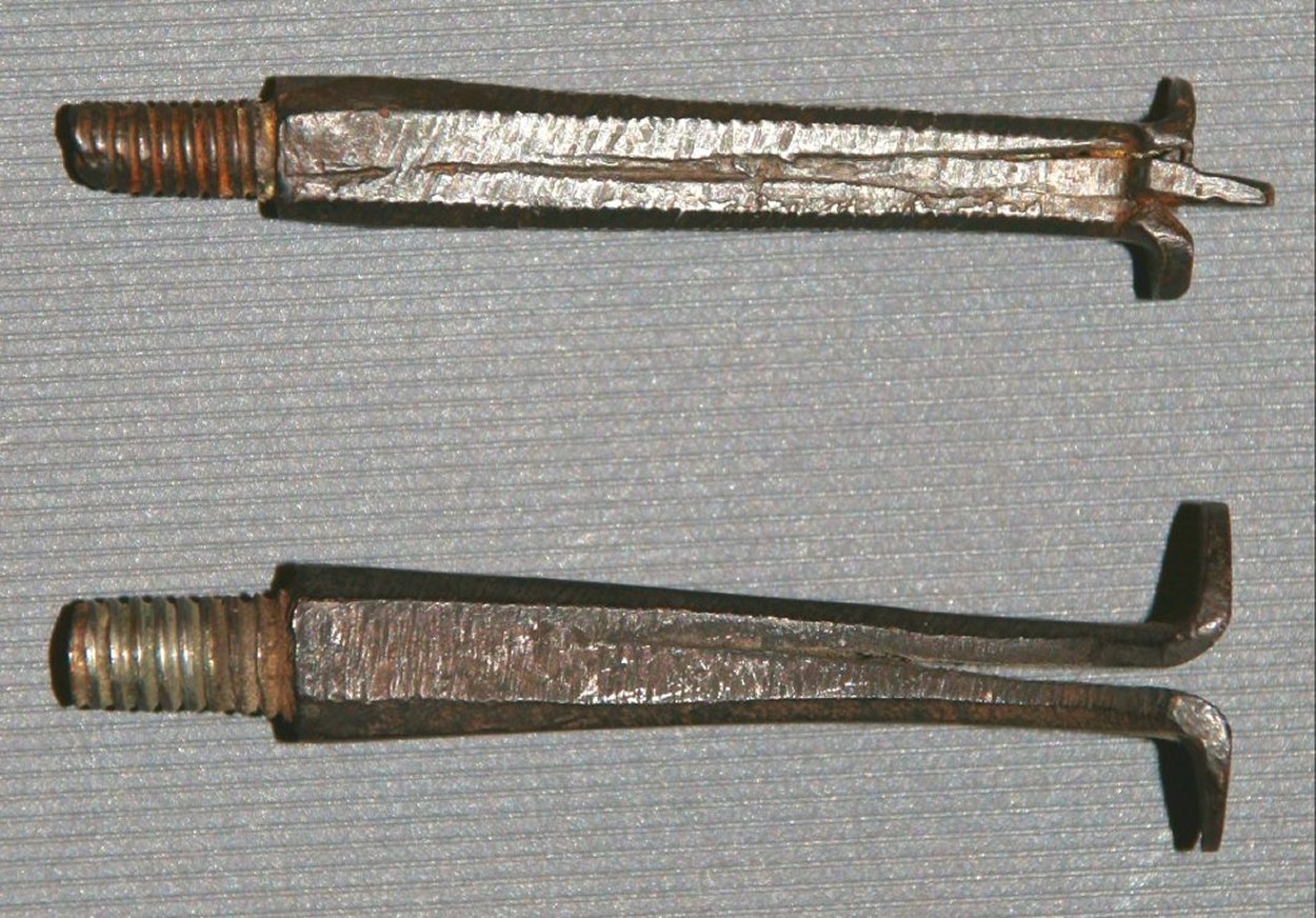

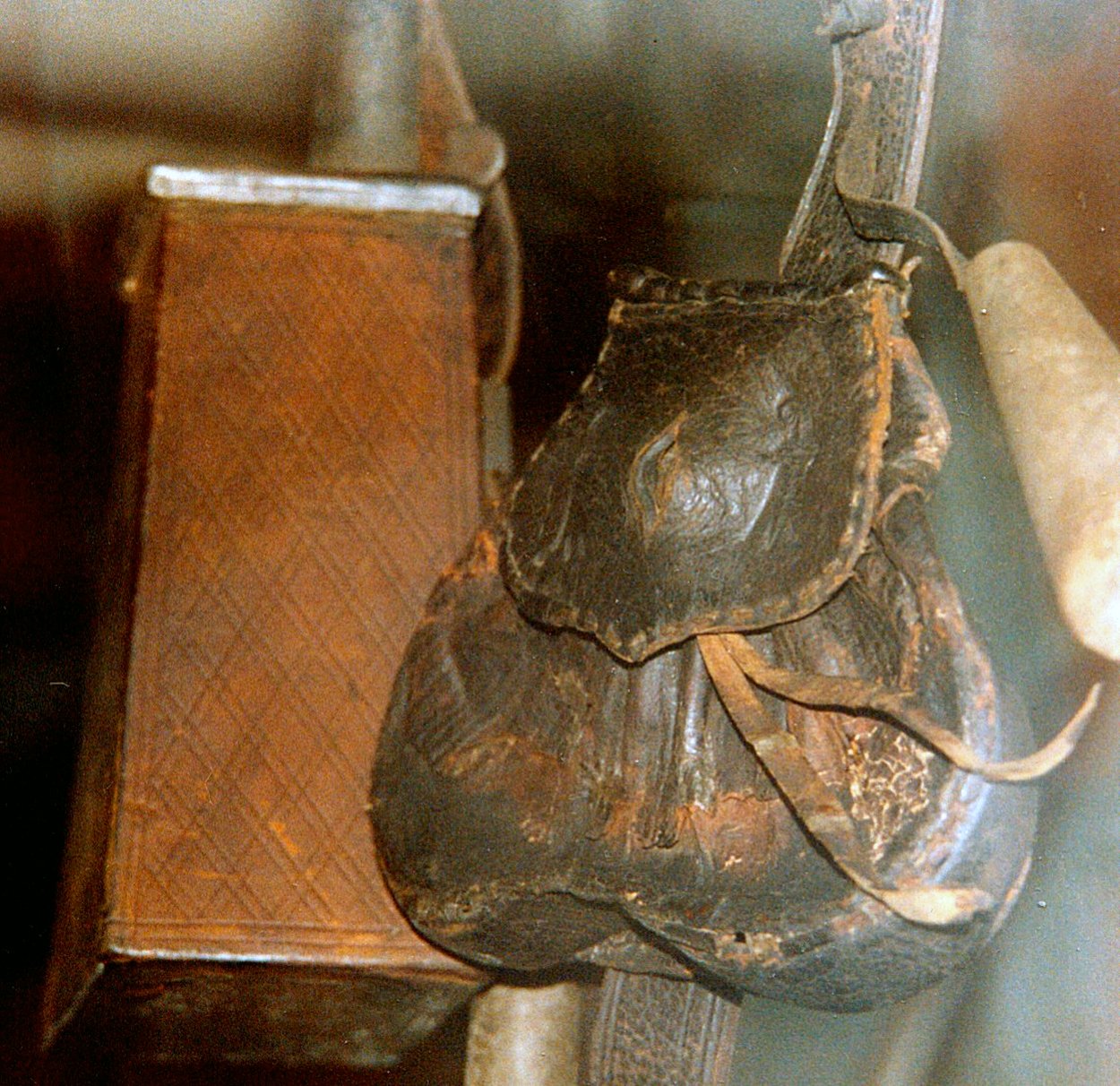

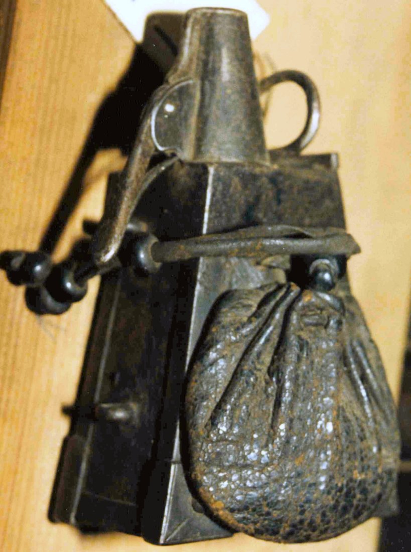

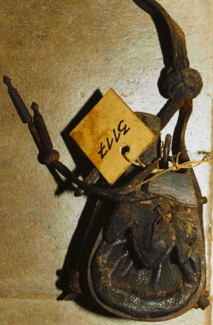

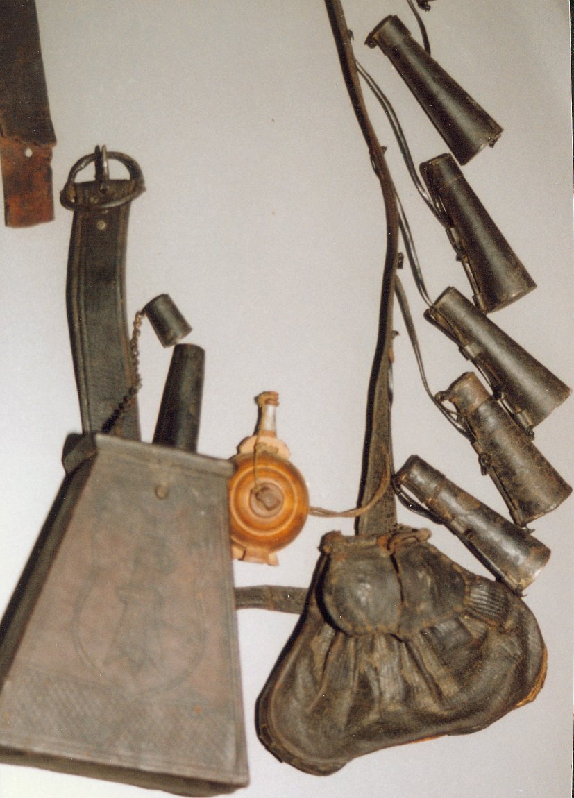

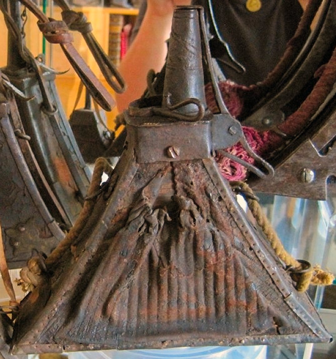

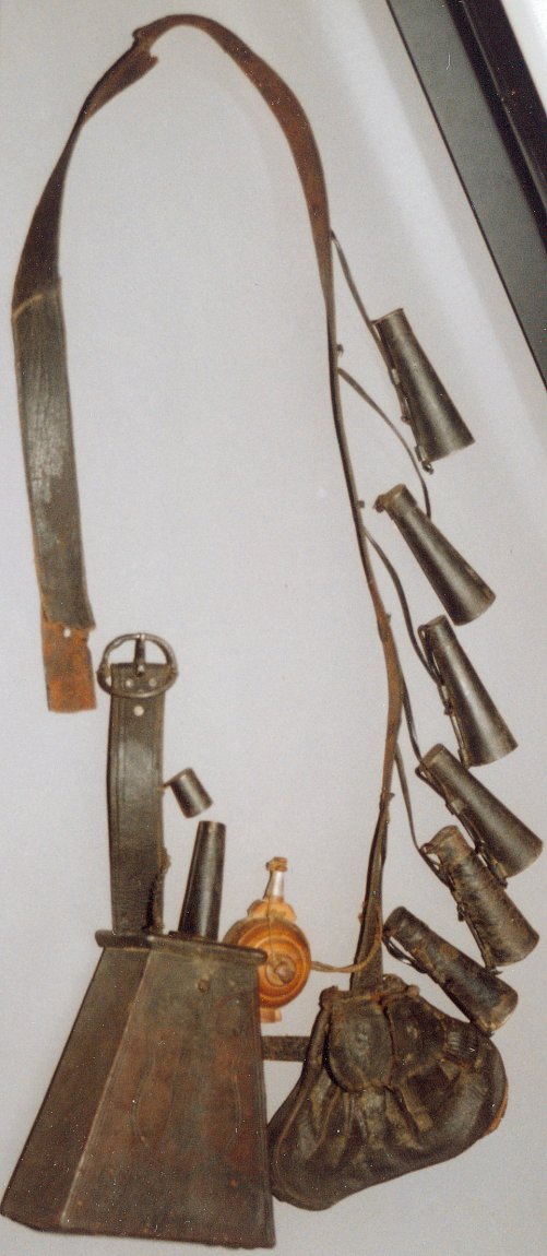

We may assume that the small pleated leather pouch which is found nailed to some types of 16th c. military powder flasks, ranging from ca. 1530/40 to ca. 1570, was also meant to keep wadding and little cleaning tools like scourers etc. that could be screwed to the threaded finial of the ramrod.
The general and ready-at-hand term 'ball pouch' proves fallacious and hasty on close examination; most of these pouches are actually so delicate that they were not even apt to hold several heavy leaden balls even then when they were fresh and new.
The same is true for some pouches on arquebusier's and musketeer's side bags (generalizingly but hastily called 'purses') and bandeliers that are divided into various sections.
I attached photos of three 16th c. powder flasks with additional leather pouches from my collection, plus two early to mid-16th c. Swiss arquebusier's bandeliers, their powder flasks decorated with the city arms of Basel, the episcopal staff; please note their spacious leather pouches that could hold various kinds of accouterment.

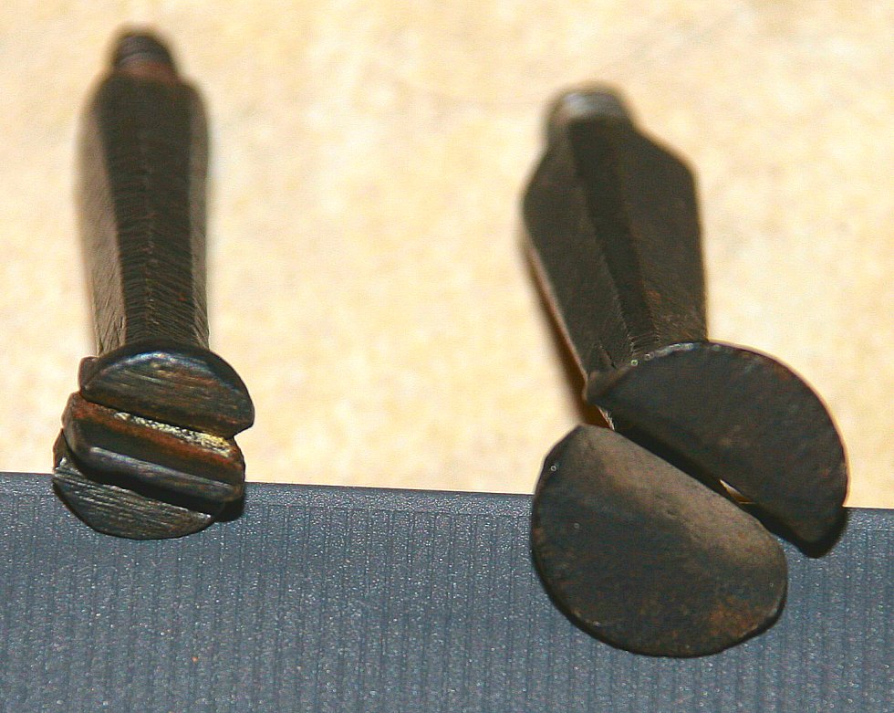

Attached at the bottom: two scourers for cleaning the barrel, ca. 1560-1600; length ca. 7 cm each.
Please see my threads
http://www.vikingsword.com/vb/showthread.php?t=18294
http://www.vikingsword.com/vb/showthread.php?t=16149
http://www.vikingsword.com/vb/showthread.php?t=15724
