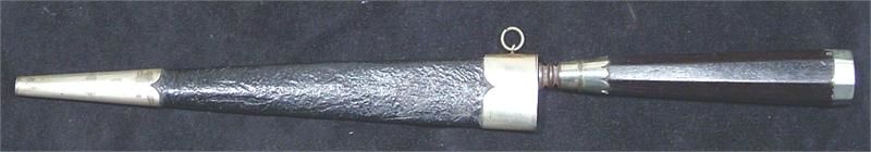

Well, after Wayne and I both expressed a wish to own one the other day......
One came my way (Sorry kronckew)
Stamped makers marks: 'Robert Badani Bastia'
Etched legend:
vai al cuore del nemico vendetta corsa
you go to the heart of the enemy. Vendetta Run
I'll take some better pics in daylight tomorrow.
So, anyone else want to show off theirs?

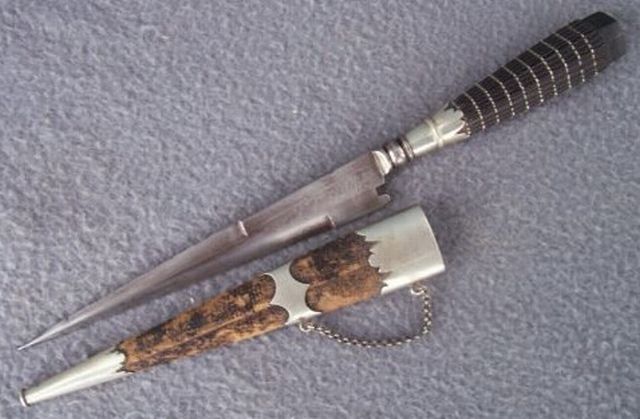

well, i've got a vendetta folder similar to that one, mine has horn grips,
i was thinking more along the lines of the fixed blade versions like these ones: (sadly not mine)

Hi bud,
Yeah the fixed blade ones are beautiful.
But I do like these folders, and they are the ones that tend to have the great inscriptions on the blades

Hi Chris,
Well, TBH I think you are being a bit unkind about the folders.
Absolutely they are 'souvenir' items (you can see mine has 'Souvenir De Bastia' on the grip), but then so really are many Spanish, South American, and many other blades of the same period.
I think you are quite right that they were made to also accomodate a tightening of laws as with Navajas.
As for the lack of a lock. The one I have would serve the purpose perfectly well without, having as it does a tremendously rigid spring that 'snaps' the blade into place. Its a full two handed job to close the damn thing.
As for use... well I can't see it being a good utility knife in all honesty, it feels like its made for stabbing and not much else. So I can't see them really being used or needing sharpening.
I'm certainly a novice when it comes to these, and although I've owned many 'navajas' over the years this is the first os these Corsican variants that I've owned.
So I can't comment on mainland French made versions, but this one certainly claims to have been made by Robert Badani in Bastia on Corsica.
I wish I knew a little more about him as I'd like to date the knife. It has the feel of folders made around 1900 that I've owned which would put it within an era where Vendetta fueds still allegedly regularly took place, making it at the very least an extraordinarily lethal contemporary souvenir of a somewhat macarbre piece of European history.
Which is why I'm suprised more people don't like them? Especially given the interest in plain old Spanish Navajas!
Best
Gene
